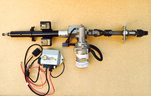

Do you have any good pics of the unit installed in your car?  I'm curious how it sets in between all the stuff on the drivers side of the engine bay.
Thanks
Not sure what you are asking here - the power assist hardware is on the new steering column assembly.  It all goes under the dash.  Everything past the rag joint is stock in the engine bay.
Share this post
As you can see from the pics above, it is a relatively easy install and doesn't get in the way of anything.  It has a dial so you can regulate the amount of assist from stock (zero) to easily turning the steering wheel while parked.  Definitely the way to go over messing with adapting a rack and adding hydraulic lines and ps pump.
