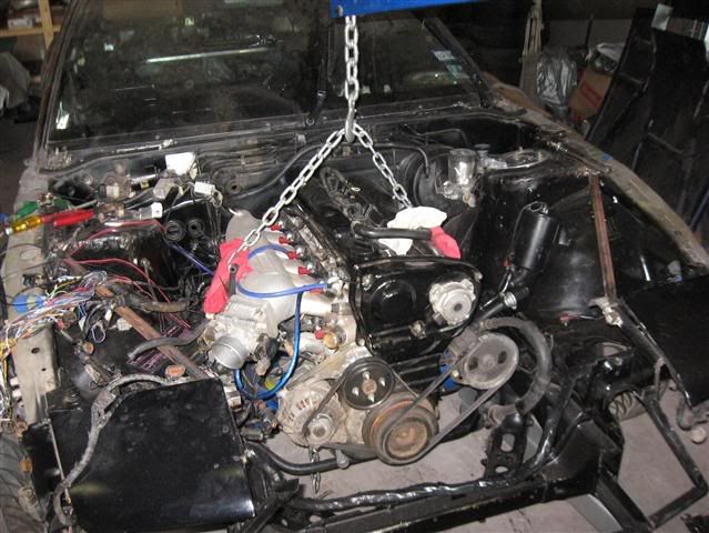

In the process I also removed the RB from the back of my truck where it has been chilling for a couple weeks and put it in the shop.
Pics:
Pulling it out
In all its beauty
The car, the engine, and the driver
Me using the RB and the Z as a recliner. More like failing to look relaxed while really being propped up on my hands so I don't dent the hood lol.

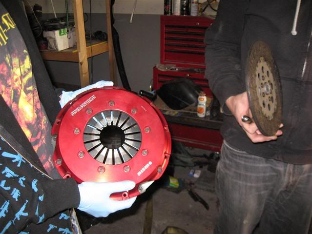

Yes! It is another RB25, but this one is better! I have history with this engine. This is the one out of the RB25 240SX drift car built by my girlfriend and I. For starters I've run this engine so I trust it. In addition there's all the goodies that it comes with...
Series 2 RB25
Cometic thick head gasket
RB25 RWD transmission
Nismo coppermix clutch
Nismo lightweight flywheel
Garret GT3076R externally gated
Tial 38mm wastegate
6boost turbular top mount manifold
Greddy intake manifold
Tomei 740cc injectors
Apexi power FC
Purchasing this as a package probably saved me a minimum $3-6k over purchasing it piece by piece. It also gives me virtually everything I need so far as engine mods minus my cooling, intercooler, and exhaust system.

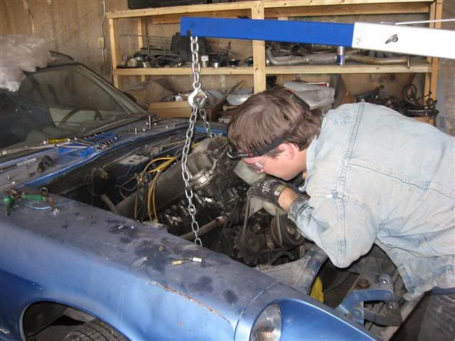

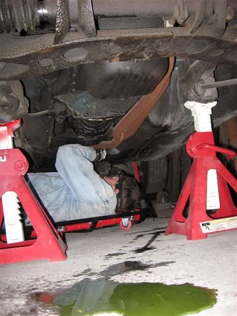

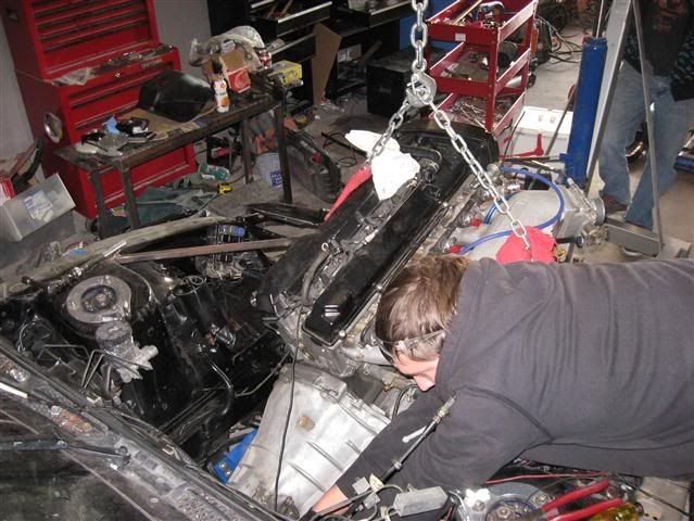

Today's project: Pull the L24 out of the engine bay. I had already taken care of most of the peripherals last week so this time I could get right on to pulling the engine. First though was putting the car in the air to get the driveshaft and exhaust off. This is actually the first time I've had the car on stands and it gave me a good chance to roll around under it on a crawler and really look at my frame rails and floor pans. I'm really pleased with what I'm seeing so far. VERY little rust under there which confirms my original inspection of the car. The only bit I've come across so far is the front right corner of the floor pan which I had seen from inside the car already. What I do have to deal with is a little bump up in the frame rails and floor pans. It looks like the car was high centered at some point which pushed on the frame rails which in turn pushed on the floor pans and while everything is solid and non-rusted, its kind of humped up in the middle. I don't know how I'm going to go about fixing that just yet... maybe a lot of stud welding and slide hammer work when I get the car on the rotisserie...
The day's work actually went fairly smooth, especially for working on a 40 year old car that is all-original. Exhaust came off without much of a fight as did the driveshaft. The engine complained a little but that was largely because of old heater hosing which was about as flexible as wood and didn't want to come off. A set of hose cutter solved that issue and the whole thing came out of the car in one piece. Have I mentioned that I love that long datsun engine bay which you can drop engines in and out of with the tranny in place?

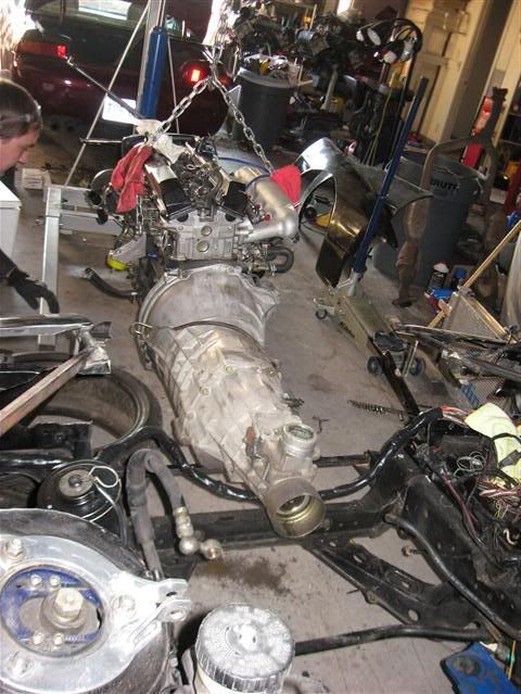

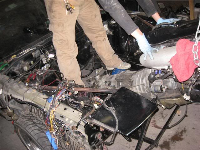

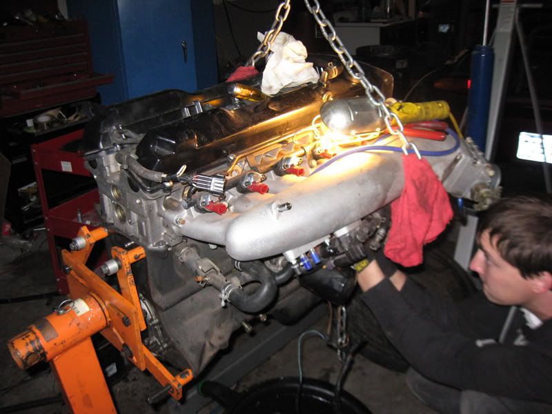

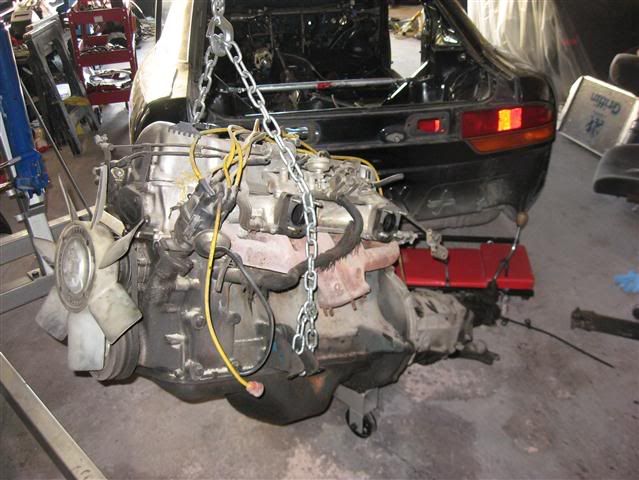

First off I'm going to back up a bit since I found some more pics of the RB coming out of the 240SX.
The engine in its old home
With the chains hooked up
On its way out
And... out

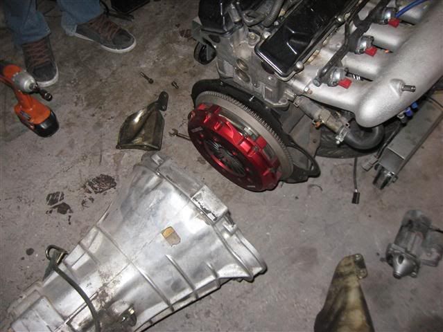

Splitting the engine and tranny. Look at the pretty nismo coppermix :D
Oooooh yeah

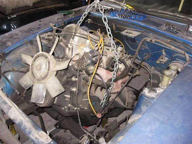

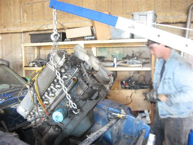

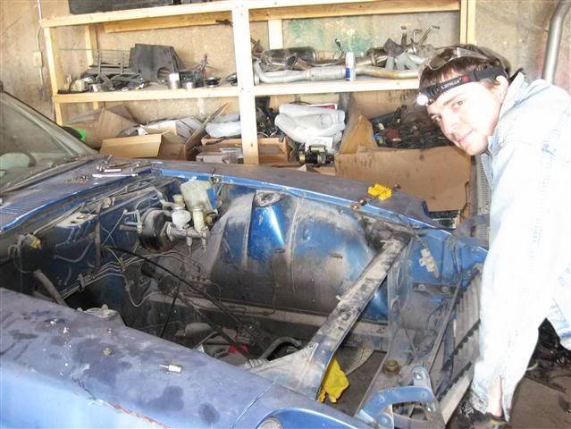

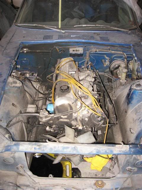

And on to the Z. That's what a 40 year old un-cared-for engine bay looks like
Me pulling the tranny crossmember
On its way out
Still hanging up on a few things

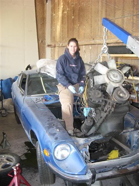

Looks like a sinking ship

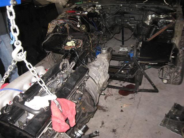

Ash rides the Z to help the tranny out of the bay
What a lovely engine bay ready for some brand new horsepower.

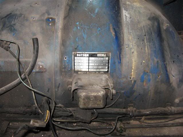

I love this old engine ID plate. I may make a new one of these for the new specs

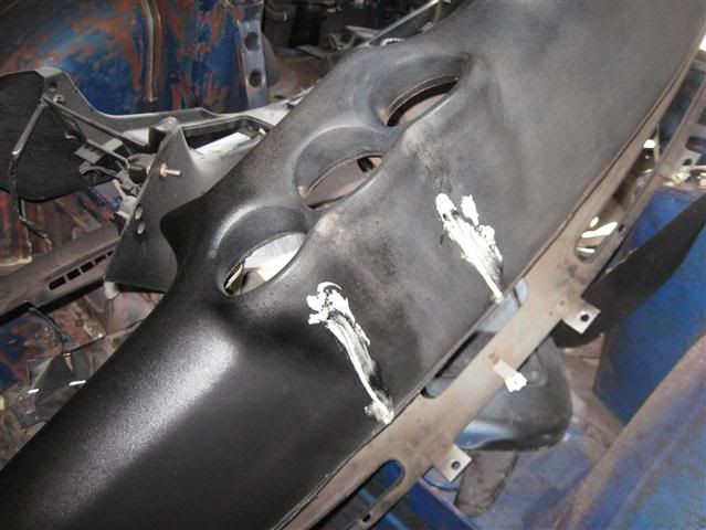

Since I'm working on a non-existent budget right now I decided to tackle stuff that I could do without spending anything. 1st up, the old cracked dashboard. I pulled the dash out Sunday morning. For a car that doesn't have a lot of systems under the dash there sure is a ton of heavy gauge wiring under there. Fortunately for my sanity none of the original harness is going back in. Virtually everything electrical on the dash is being replaced including the gauges, AC/heat panel, even the original ignition switch. Since so much new stuff is going to have to be wired in I'm taking the opportunity to replace the 40 year old wiring with fresh wires and a new modern fuse box. That though will wait till later, for now my task was restoration of a dash that has spent the last 20 years or so baking in the Texas sun.
Sadly I didn't take as many pictures as I should have to keep things interesting since I was focused on getting as much work done as possible before I had to leave for home so you'll have to make due with my after-the-fact pics.
Here's the dash after my work. You can see where I did a quick test with some vinyl dye to see how that worked to restore the fading. It did a wonderful job but unfortunately nothing is that simple. Before I can re-dye the dash I need to get those awful cracks taken care of. I decided to follow the advice of another HZ member (who unfortunately I can not give proper credit as I have not yet figured out where my thread subscriptions went with the new forum) and started on his restoration method. This calls for expansion foam in the cracks, a bit of dremel work to take the curled edges down, and some bondo brand bumper repair expoxy. I would have loved to have gotten that far but as you can see thanks to an 8hr dry time all I was able to get done today was the foam which did a wonderful job of filling the cracks as advertised.

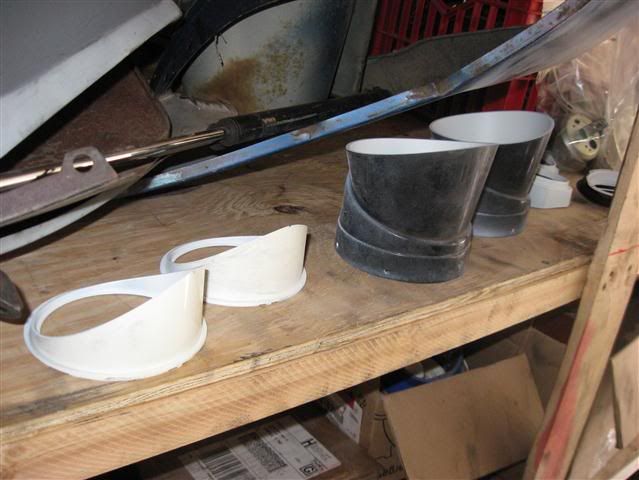

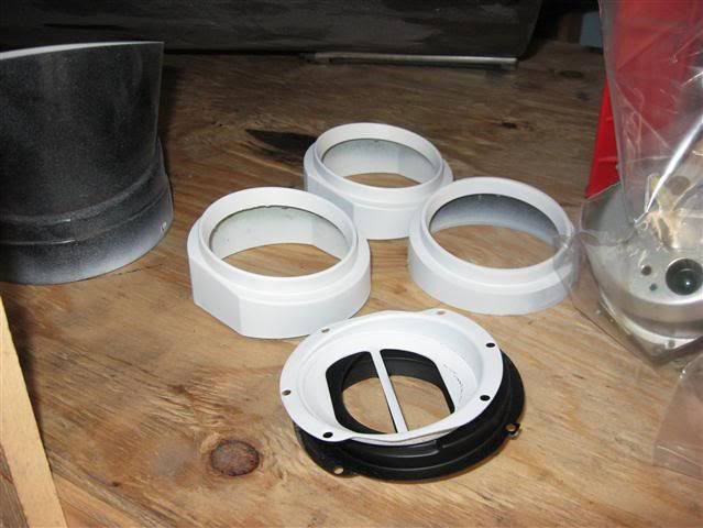

Since I couldn't continue with crack repair I moved on to disassembling the gauges and preparing the cups for the speedhut gauges that will be going in there.
I created a bit of work for myself unfortunately by going through a couple cans of primer before I finally found one that wasn't plugged up and spitting bubbles on everything I was trying to prime. No worries though, nothing that another couple of sanding sessions won't take care of. I primed one metal face for the small gauges before I doubly realized that I wasn't likely to me re-using those, and even if I do I will powder-coat them.

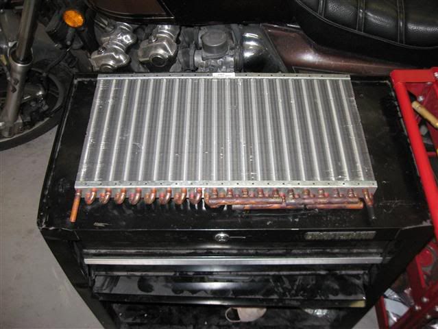

First up is this wonderful griffin oil cooler. I doubt I really need it but since I already had it and had forgotten about it I decided it would find a home here.

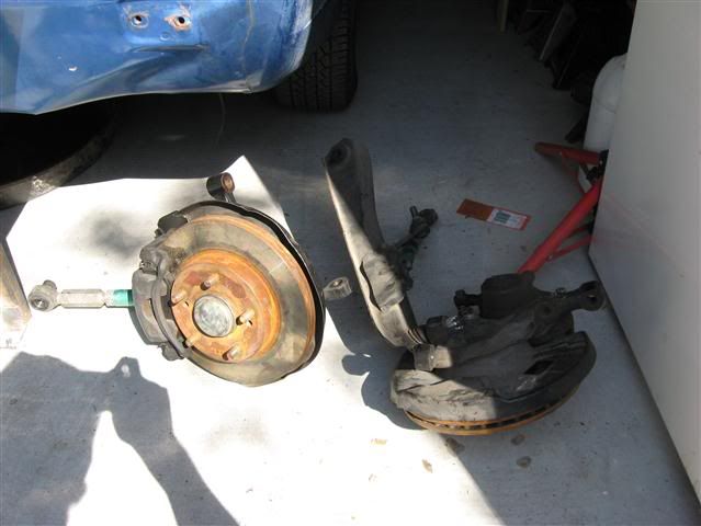

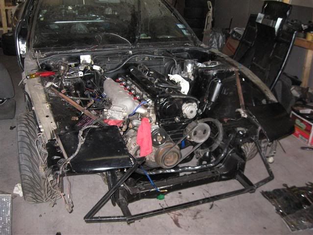

These don't look like much but they are the S14 front knuckles/hubs and S13 front arms that will be used with my S12 front subframe conversion. Nice pieces with fresh ball joints too! Might have to kill them though when I disassemble to run them through powder. :(

great job so far! im kind of sad to see a s13 being parted out for the Z, since i also have an s13 haha. how exactly are you planning to do the s12 suspension conversion with s13 knuckles? or did i read that wrong lol..
Actually S12 front subframe, S13 front lower control arms, S14 knuckles... I know - what a combination of parts, right? There's a method to my madness actually.
The front subframe is a S12, mostly becuase the S12 is the right width allowing the subframe to fit to the Z's rails. I plan on using the S13 front lower arms since I have a set that came along with my S14 knuckles with brand new S14 ball joints. I believe the are a bolt on fit to the S12 subframe and no matter what I use it will have to be shortened a little so I decided to go ahead and use the arms with fresh ball joints. All of this of course is pretty much dependent on how everything actually fits together when I get the car ready for the swap to happen. The S14 knuckles are for the 5 lug hubs that they come with. Rather than working within the limitations of wheel selection available for 4x114.3, I'm using my decision to use modern underpinnings to my advantage and doing the typical swap that S13's do to get 5 lug hubs from a S14.
I'm really looking forward to all of the custom fabrication to put everything together and make it work but I have to hold on for a little while. I'm currently working on the car in my Father's garage since I'm in limbo without a usable garage until I move back to Houston and the car has to remain able to roll for a little while yet. Once he clears out his sailplane from the other bay of the garage and the stuff he's currently got in front of the car moves over there I'll be able to put it in the air for a while and install the new front subframe.
