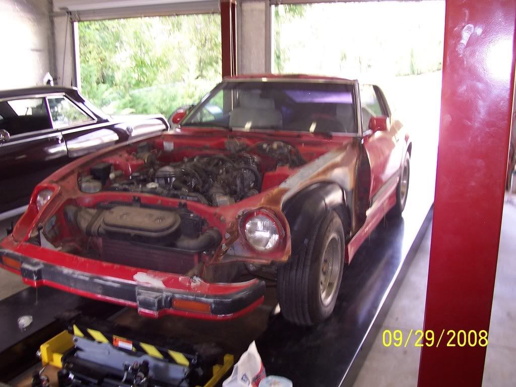

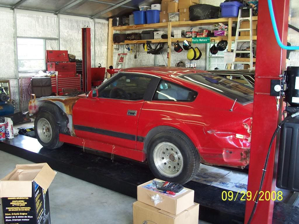

Well, some time passed and i started my first year of college. One day my dad calls me up and says he found another 260Z in the paper, and that i should give the woman a call. I call the woman and ask the most important question, how much rust... she says there isnt any. Turns out she bought the car brand new in 73. She drove it till the 80's then only drove it on occasion. Then parked the car for good in 1990. I went up there the next day to look at the car. I couldnt believe my eyes its the most rust free "Z" i had ever seen. Payed a down payment and came back the next weekend to have it hauled home.
The car when i found it in the garage...

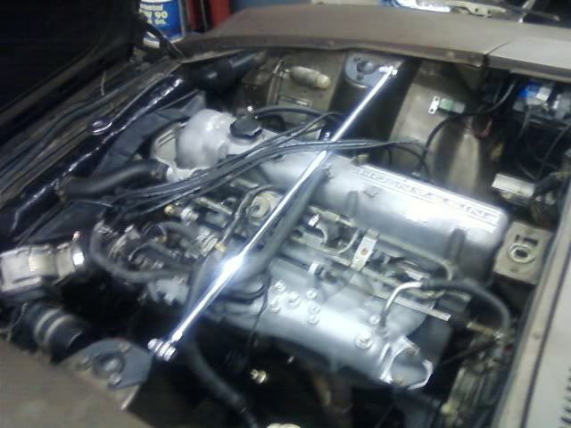

The next thing on the list was to get rid of the crazy Holley 4 barrel intake.
I went ahead and gave a call to Rogger at the zbarn. Made a trip to Maryville, tn to pick up a set of round top SU carburators for the car.
After i went through the carbs and rebuilt them, i put them back on the car. The car came right to life! I did all of the pittly stuff like changing the oil and checking over and bleeding the brakes.

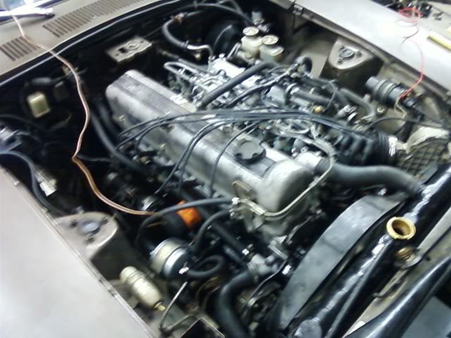

Some time inbetween, i buttoned up the carbs and engine bay, and was finaly ready to go after a radiator.

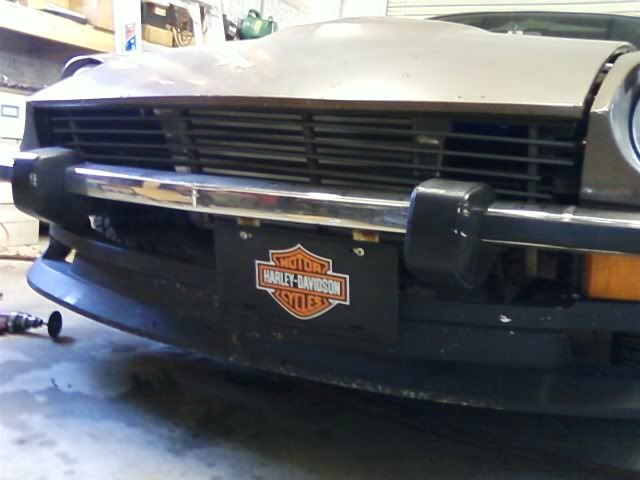

The next thing to be changed was the front "lip". The lip that was on the car just screwed to the top of the stock valence. It just didnt flow very well. It just so happened i had a perfectly good Xenon airdam that was on the wrecked 260(see a pattern here?) that would look perfect.
Mock up of the airdam (hense the silver lol) :
I took it off and primed it black so it wouldnt stick out like a sore thumb.
I drove the car with the new airdam for a week. Christmas had just passed so i had some money from that. So i ordered a set of eibach springs, some u-joints for my driveshaft and half shafts, some urathane bumpstops, bumpsteer spacers, and some urathane control arm bushings front and rear. Before i wrecked the other 260, i had just replaced the worn out shocks with some tokico HP's. I robbed them from the other car to save a little bank. lol

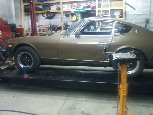

Got the car on the ground and boy did it sit good!!!!
Then the maiden voyage. Took it to a local dam, called Norris dam. boy it looks GOOOD!!!
lol, you can see dad in the car.
Not much has changed since then. just working the bugs out. Found out that the 15" bumpsteer spacer didnt fit, so waiting for a 14".

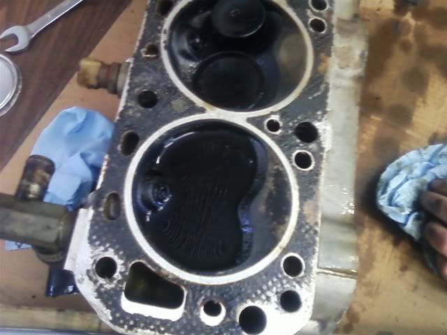

The next thing i did was adjust the valves. Found a not so pleasent supprise. The oil spray bar for valves 11&12 was bent... took it out and found some shoddy mechanic work. instead of straightening the piece out they decided to cut half of another gasket and silicone it together. I straightened the piece out. I mean really how hard can it be do do stuff the right way?

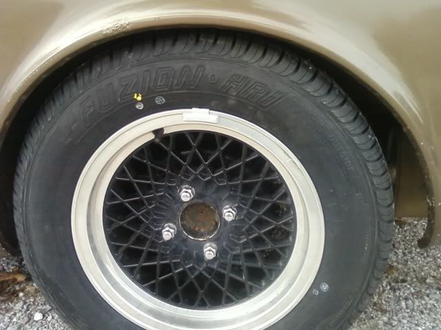

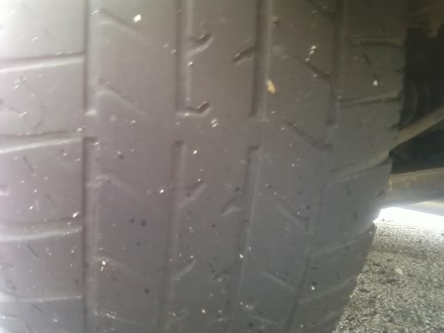

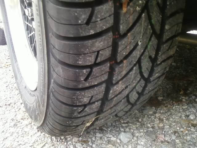

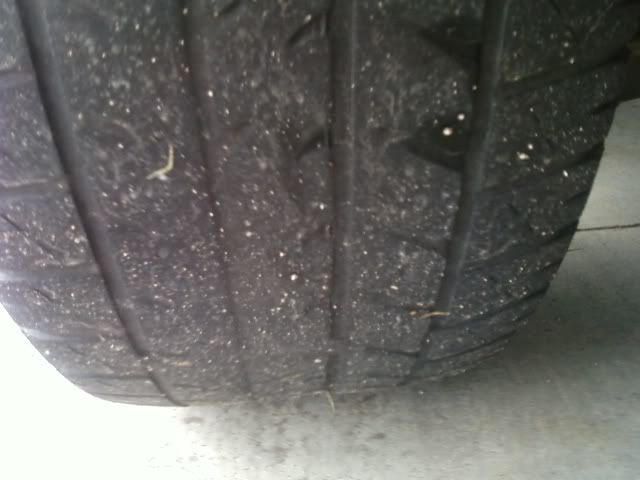

Well, as i said last time i was in need of some tires. Went to the local tire shop and decided on a set of Fuzion HRi all season tires. I could'nt be more happy with them the feel and response of the car has changed dramaticly. Here are a few before and after pics. lol
Bald rear tires!!
The new Meat!

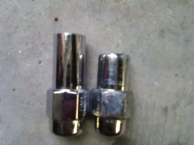

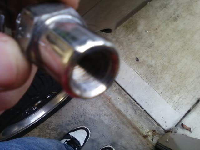

Well, i knew i had a problem with my front lug nuts for a while. When i had the tires put on they brought it back to my attention. The old lugs would only enguage about 3/8in of the threads. I picked up a set of lugs that were drasticly longer only to find out that they were too long and bottomed out on the hub. Luckily a good friend of my dad's, and mine owns a lathe. He cut them down for me and now im back on the road again with alot more lug holding my wheel on.
old V.S. new
The old lug with the threads on their last leg.

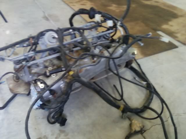

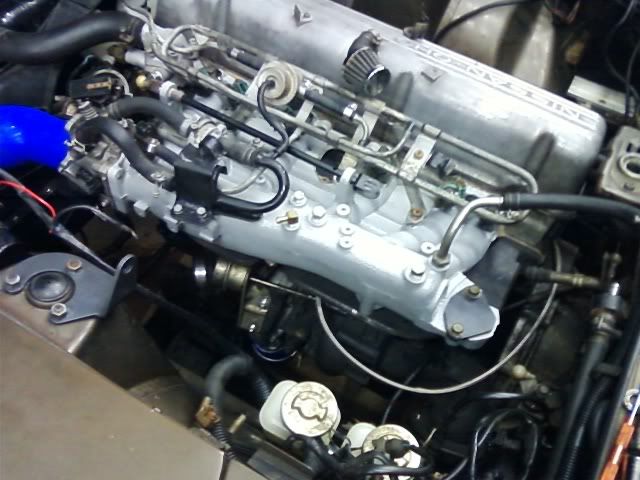

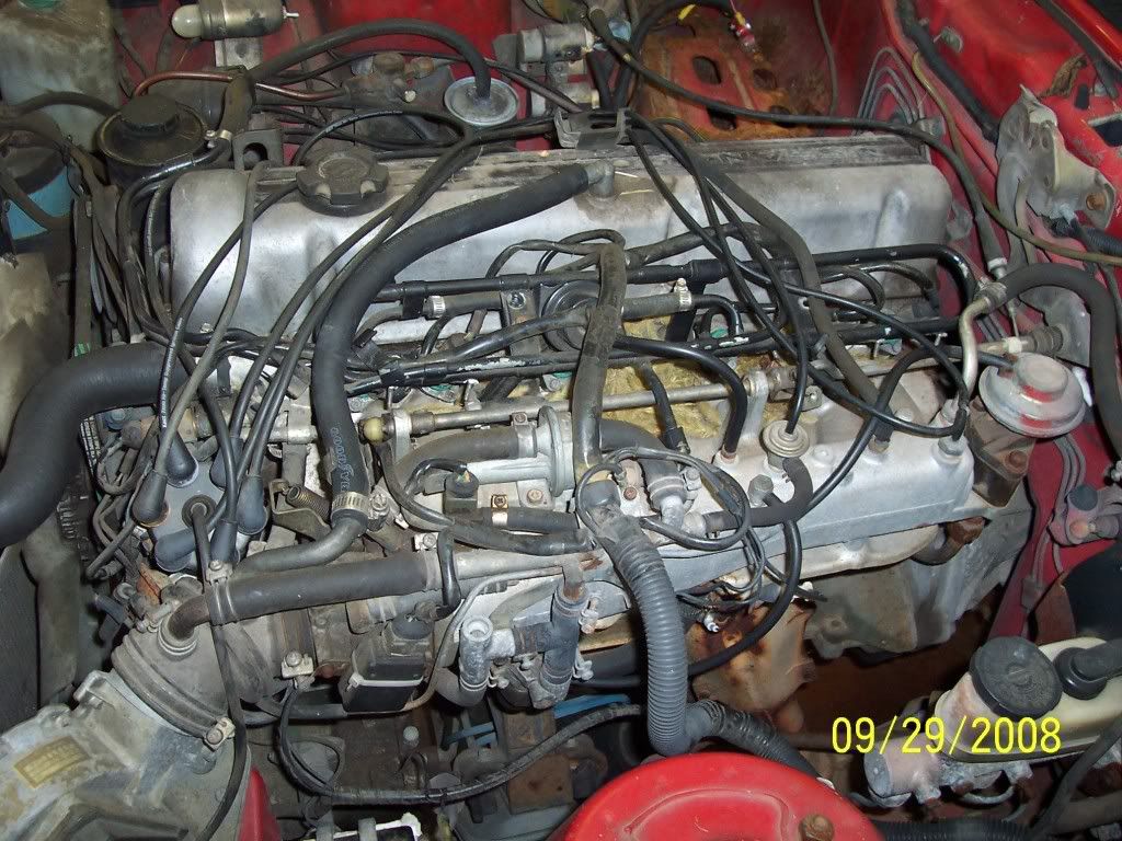

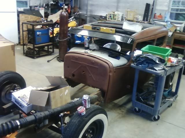

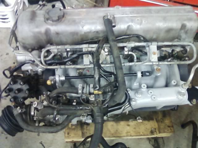

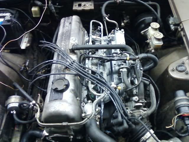

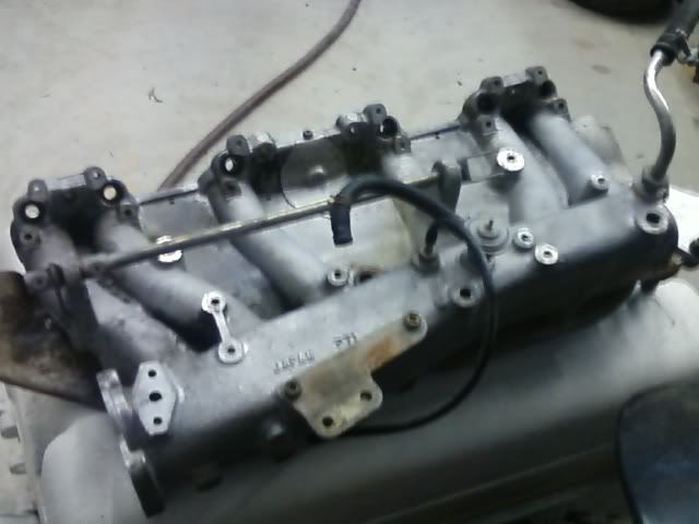

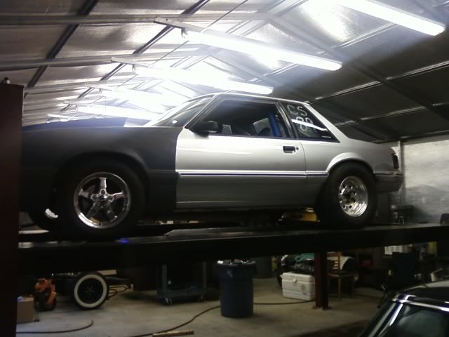

Ive been making some progress on the EFI conversion onto the l26. I pulled the intake mainfold off of the l28 i have in the garage. Stripped it down and am in the process of cleaning it up so i can powder coat it. The project has kinda taken the back seat for the time being. The majority of my time this passed week has been spent working on a good friends mustang drag car. I helped him replace his torque converter to try and improve his 1/8 mile time. He took it to the track today and ran a 6.00 on nitrous, he is looking to hit 7.58 so we are going to pull the converter again in favor for on that locks earlier. During the process i got struck by boredom and took some shots of the cars that reside in the shop.

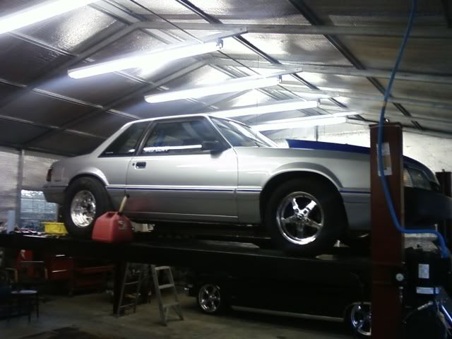

Wes's mustang
Daddy-o's nova
Daddy-o's 31 model A
The motor the intake came off of, Its a n42/n47.
The intake conglomeration with the wiring harness
Everything stripped off.

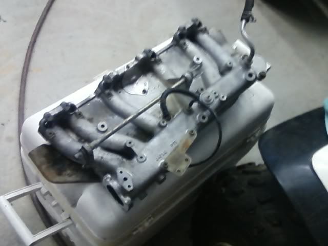

I finished sandblasting the intake today. If all goes well, it will get powder coated machine gray tomorrow.
I actually have a question. I plan on using a 280zx wiring harness and ecu to power everything. I was wondering what significance is the o2 sensor to the 280zx ecu? what does it control? does it have such a profound effect that it would hurt to not have it?

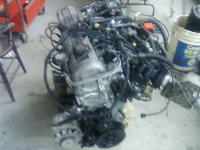

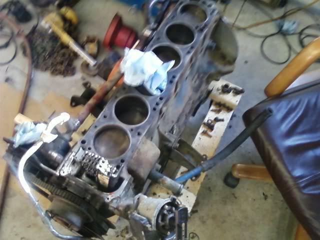

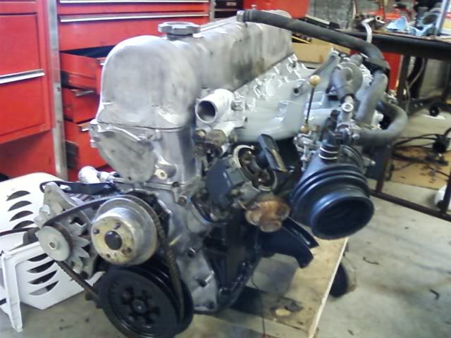

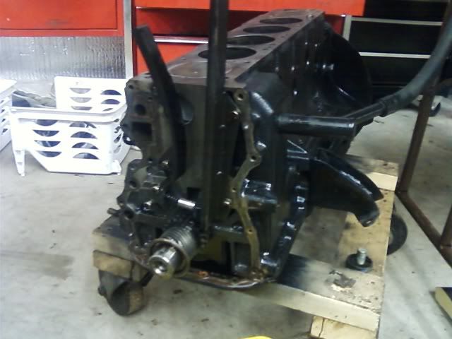

Well, I have once again changed the direction of the drivetrain for the car. I pulled the engine and transmission out of the zx parts car. I removed the head to find the cylinders in good shape. The head on the other hand needed a little work. With a simple leak test, my dad and i found out the valve seals for #1 were leaking pretty bad. So off to the machine shop the head went. Got the call the next day to come pick it up. Boy, i love fast turn around! Not much had to be done, just a valve job and a little trueing of the various surfaces. At the moment im currently waiting for the weekend to be over so i can call monday and have a head gasket kit and timing set ordered. On to the pics!!!
A couple pics of said parts car
The motor nested snugly in the engine bay
Out!!! and headless
The "Leak test"

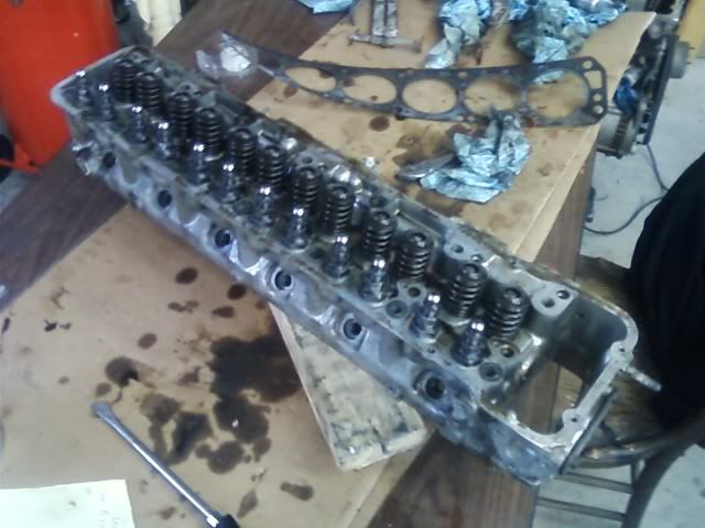

And after the spa day at the machine shop

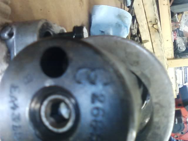

The cam was replaced in the motor and i have no idea who makes it. I have busted out the calipers and determined that it has less lift than a stock "A" cam. A pic of the markings on the end:
Im sorry for the picture quality diffrence some were taken with my phone and the rest were from a crappy digital camera.

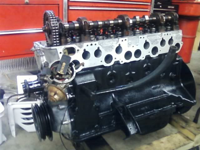

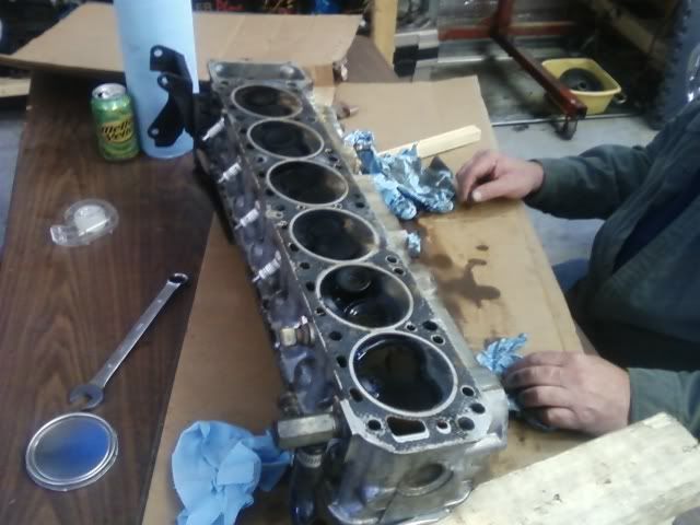

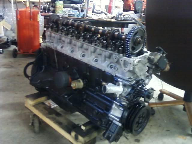

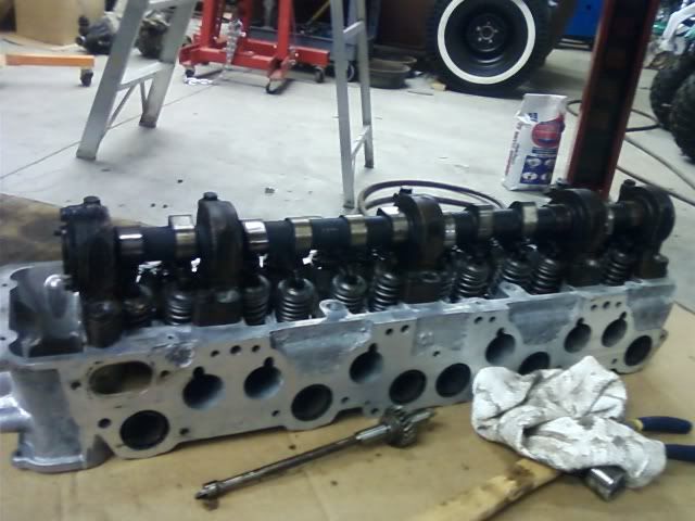

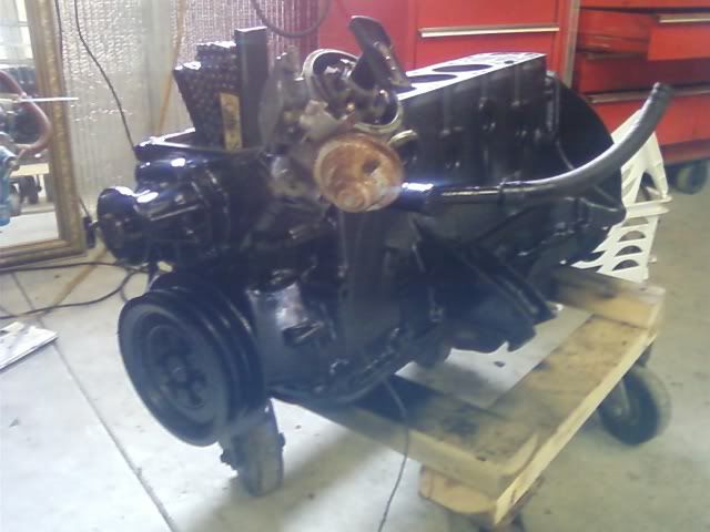

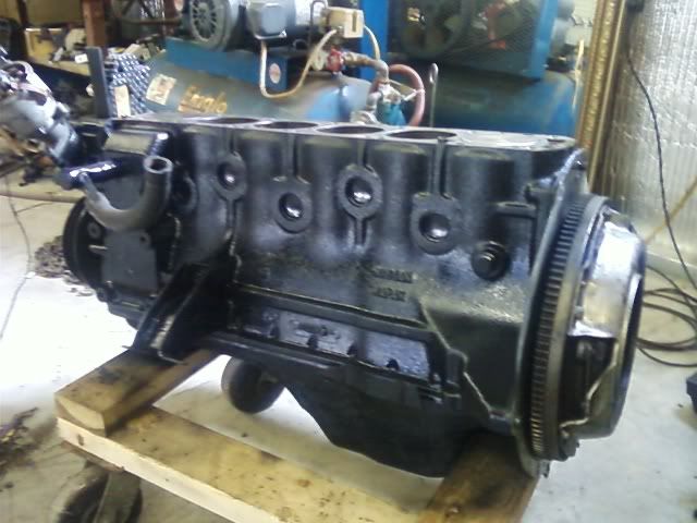

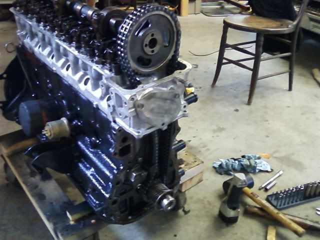

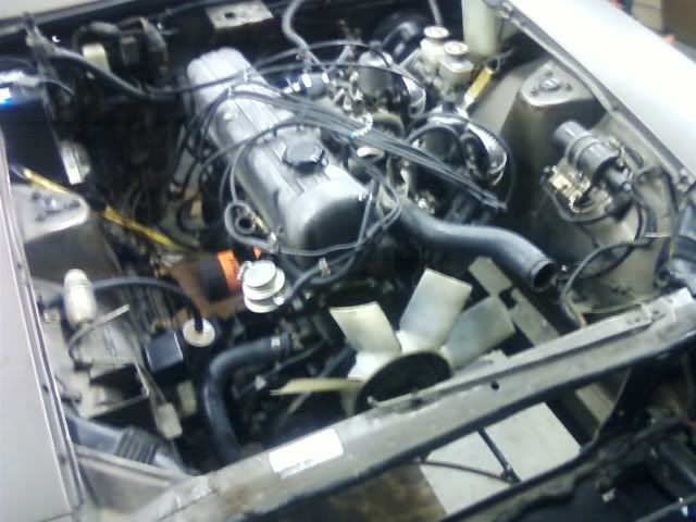

I have engine build pictures!!! Although it was more of a freshing up than a build. I decided not to mess with the bottom end because of the lack of funds. The cylinder walls looked good, and the rings proved suficient with a leak down test. So, as said before the head was sent off to get trued up and get a valve job. While away i painted the block:
After i got finished painting i realized that i would have to remove the front cover to replace the timing chain. A big Doh on my part, oh well. Took the cover off and stripped the paint. Then gave it a nice polishing with a wire wheel. I broke out the calipers on the replacement cam that was originaly on the head and came to the conclusion it had less lift and duration than a stock "A" cam. So i swaped the cam from the spare motor i have.
The spare motor that got its cam, rockers, and lashpads robbed.
The painted timing cover. :(
Head finally installed with the timing chain replaced.
Whoo front cover on, and mostly put back together!
I was getting excited, so i sat the valve cover on and loosely hung the intake.
Everything hooked up and ready to go!

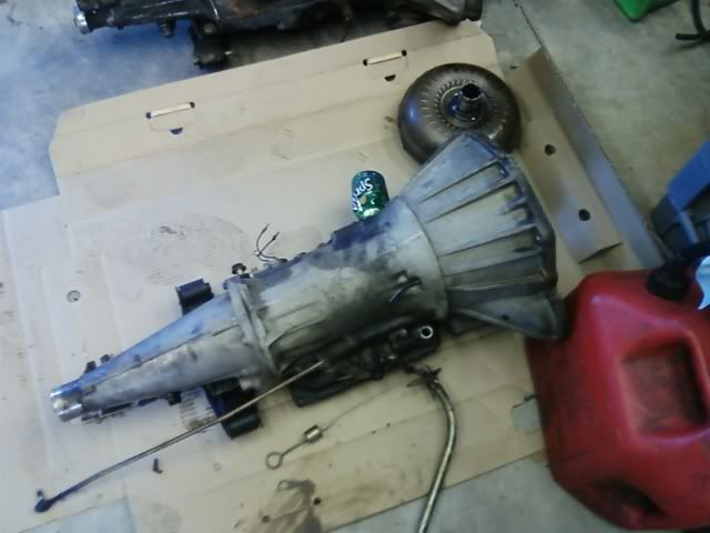

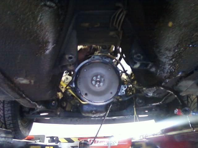

Well, i went head first into the biggest task yet. After accumalating parts for the last month, i finally had enough parts to do the L28/5 speed swap. Dropped the exhaust, drive shaft, and trans.
The slush box on the floor...
Whoo, no more automatic!
Next on the list was to 8-6 the L26.
Out with the old, In with the new.
Its just a shell...

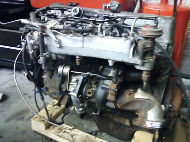

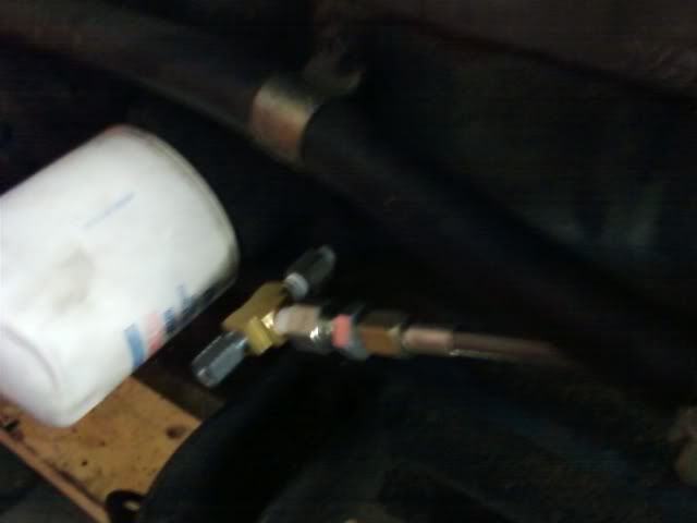

A few new pictures for everyone! The turbo is happily hanging from the mock up motor. I then made a wastegate bracket, and adjustable wastegate arm. I got an intercooler off of ebay, i made the mounts for it and am using it as a cold air intake till i has teh boost.
Everything is moving along pretty smoothly, i have then oil lines and tee fitting. Still quite a bit left, but im making progress!

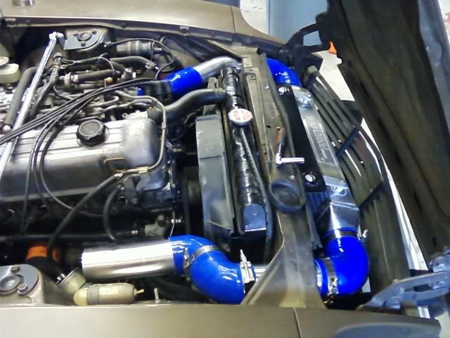

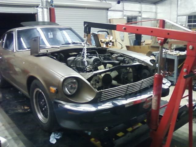

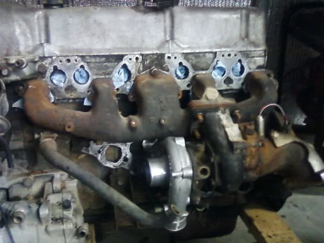

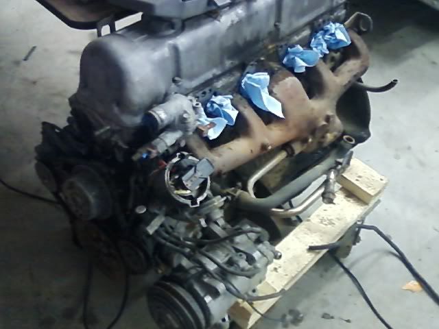

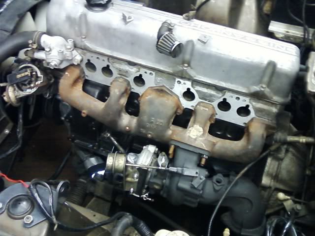

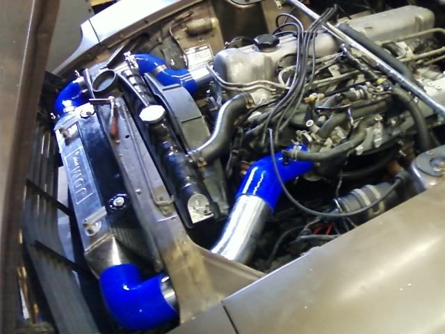

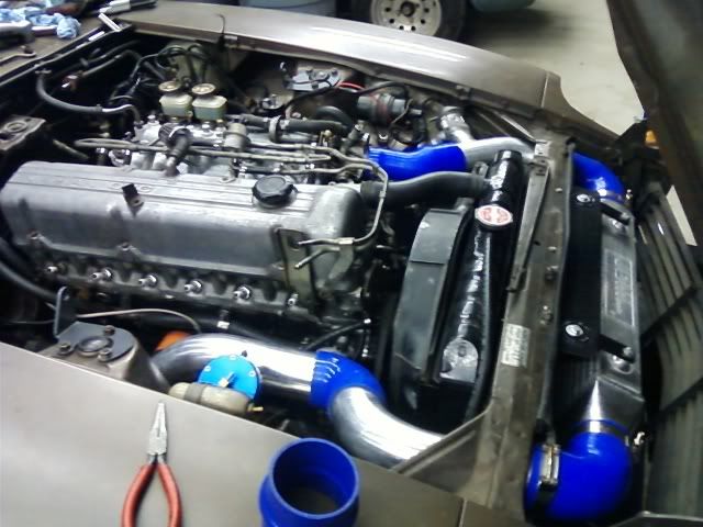

THE TURBO IS ON! I finished up the swap weekend before last, then finally got the exhaust last monday. I have to say im enjoying boost!
I got to tearing into it friday night, and by saturday night the beast was running.

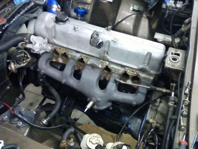

Farewell NA exhaust manifold.
I couldnt resist putting it on to see how it fit.
everything mostly back together.

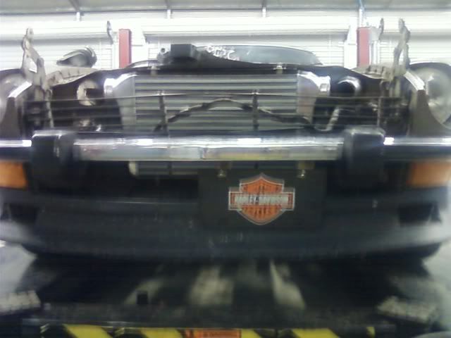

intercooler piping ran.
my set up consists of so far:
NA F54 block
P79 head
zxt exhaust mannifold
z31 watercooled T3
ebay intercooler
ebay piping kit
DSM blow off valve
-4an oil feed line
modified NA oil pan
12:1 vortech FMU
265cc ka24e injectors
NA ECU
mechanical advance locked
NGK wideband
3" exhaust
magnaflow muffler
Thats just about it i guess... Im currently running 8 psi
