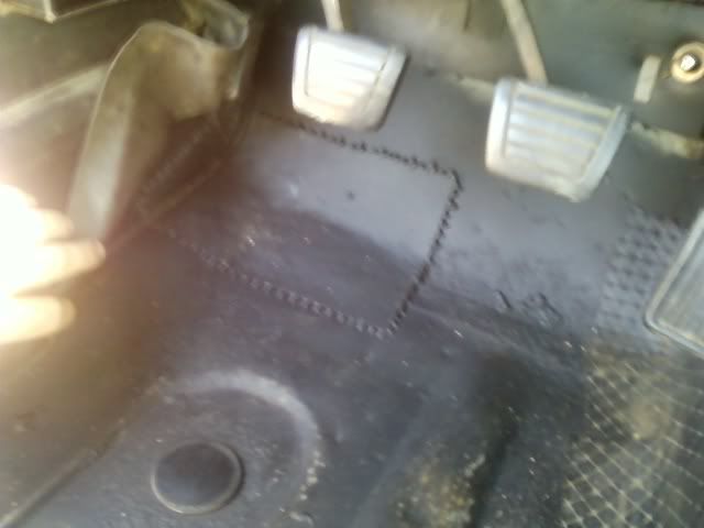

I finally decided to tackle what little rust was in the car. I only had a few place in the floor pans that needed replacing. I did'nt think it warrented replacing the entire floor pans, so i made patches to put in. I think that the patch venture went well. I cut out the cancer with an air saw, and formed some patches out of some spare metal around the shop. I sprayed rust converter on all the surface rust, tack welded around all the patches, then went underneath seam sealed, undercoated the new patches, then painted the inside with some black enamel to seal them up.

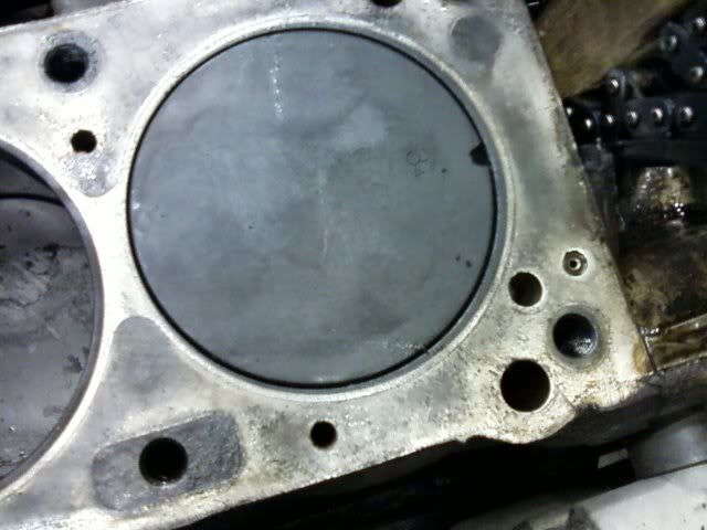

12 psi killed it! I broke two ringlands on the number one piston. I discovered the problem after an on boost run. I noticed a ton of smoke coming from the valve cover breather. Did a compression test and found that cylinder 1 was 70 psi while the others were 105-110. The plan is to get another piston and rings, and stab another piston in. I do plan on building a forged internal turbo motor, just not right now!
Taken apart!
intercooler is missing!
This was after draining my intercooler...
carnage
carnage yet again
#1
#2
#3
#4
#5
#6

does 105 110 psi not seem like very low compression to start with? my 8.5:1 1jz was 170-180 psi (dry test). For all the effort of pulling the engine apart, maybe gap and install new rings all round? Im no expert on L series at all, what are normal compression numbers?
Share this post
I wanna say around 160-170.
Share this post
Im not too concerned. I know this motor is nowhere near new and I dont expect it to have 170psi of compression. The thing that really matters is if the numbers are as close across the board as possible. But yes, there is a good chance im prob going to rering the entire motor while im at it.

hey man great car, saw your piston man and I just wanted to touch bases with you that those are N/A pistons. I don't know what you running now but if it's still a boosted na, save yourself some trouble and grab the next avail f54 block. :)
Tubo piston
Share this post
Tubo piston
Thanks! Yupp, they are indeed N/A pistons. It is an F54 block, but it is the N/A version with the flat top pistons. Im pretty sure the cause of the failure was the lack of precise fuel control anlong with boost out of the turbo's effiency range. Im still running the flat tops but now I have megasquirt to control my fuel and am running stock boost.

i dont think the turbo pistons are any stronger anyways. the f54 blocks just supposedly have stronger blocks. because it has extra "webbing" of some sort. i like your build though man. definitely keep it up. my z has been sitting for the last couple years and i plan on starting a build.
Share this post
You would be correct, there was a recent thread that gave the dimensions of the ringland for the turbo and N/A flat-top pistons. The pistons are nearly identical for the exception of the pin height and the dish.
