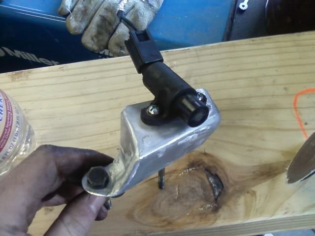

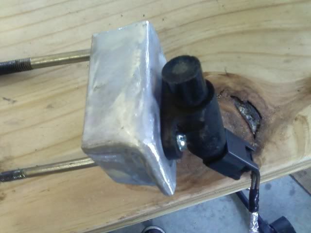

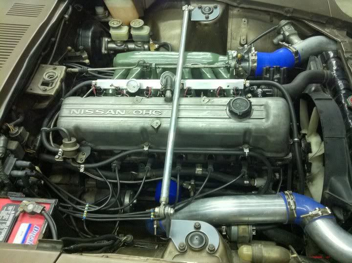

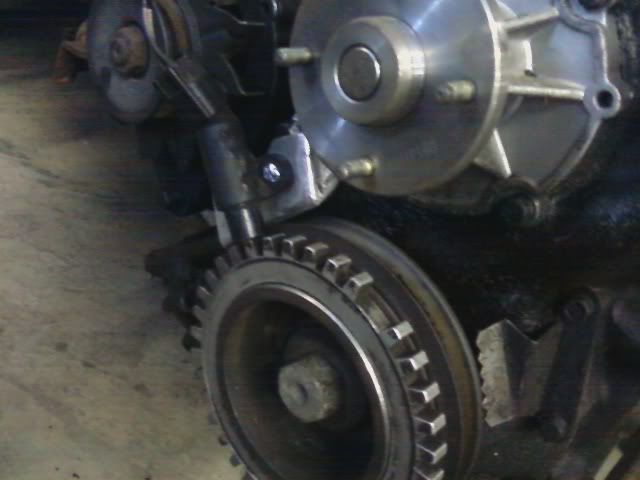

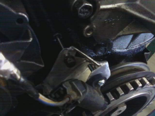

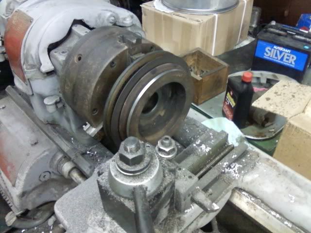

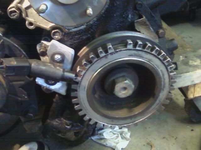

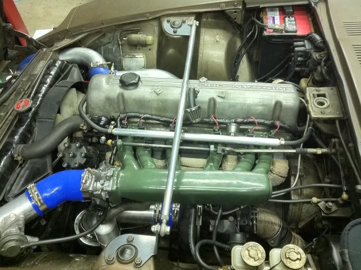

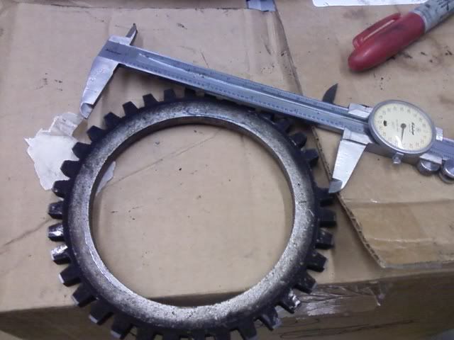

Next on the agenda I needed timing control with this holset, so I figured I would hook up an 8 pin gm hei to hold me off until I went edis. But low and behold, Im apparently inept of wiring the output mods for the hei with ms2 extra. So I finnaly bit the bullet and picked up the trigger wheel from an escort, the vr sensor, and the module from an explorer. I took the dampener off of my L26 and chucked it up in the lathe, Took down the front pulley. Fit it to a .005 interference fit with the trigger wheel. I Then made a bracket to fit the vr sensor. Turned out well, I mounted the module infront of the battery. The coil was mounted on the firewall next to the battery. It turned out really clean.
And a video of the car at 15psi: I was short shifting at around 4500 to avoid boost creep passed 15psi.

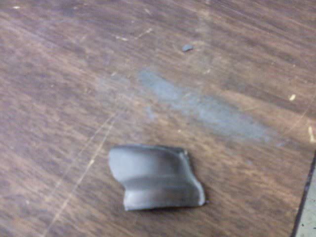

But as in the words of bigphil "my car's name is trouble". I destroyed another flat-top piston at 16psi...
But up until then, It ran like a scolded dog! I had been tuning with the new holset and my edis system. My ignition map is really conservative and AFR’s spot on. I didn’t hear any detonation; of course It doesn’t mean it wasn’t there. The only indication that something was wrong was a little bit of a miss at idle and a few puffs of blue smoke (which I thought was my turbo’s oil seal).I limped it home, and the compression test told all; 120 psi across the board except for number 6, which was a meager 45 psi. Added some oil to the cylinder and retried, got 90 psi. I’m thinking the ring lands broke again.
Im considering swapping in the N42 that I have in the shed, topped with my p79 head for the time being so It will be a little more forgiving at pressure.
Next plan of action:
I have an N42/N47 motor sitting in the shed that came out of a running 280z. If the leak down test proves it to still be good, I’m going to put my p79 on the N42 and slap it in the car for the time being.

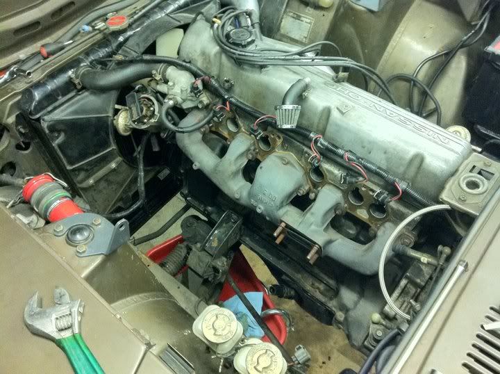

And just for an update, Im going through the n42 long block that I have, in prep to accept the p79, holset, and all of the other goodies.
Share this post
I forgot to update! My-bad!

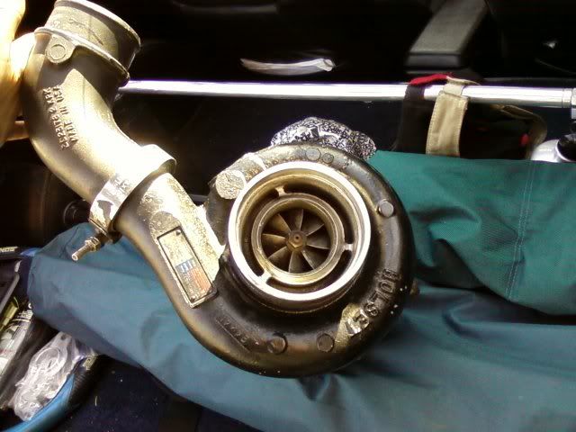

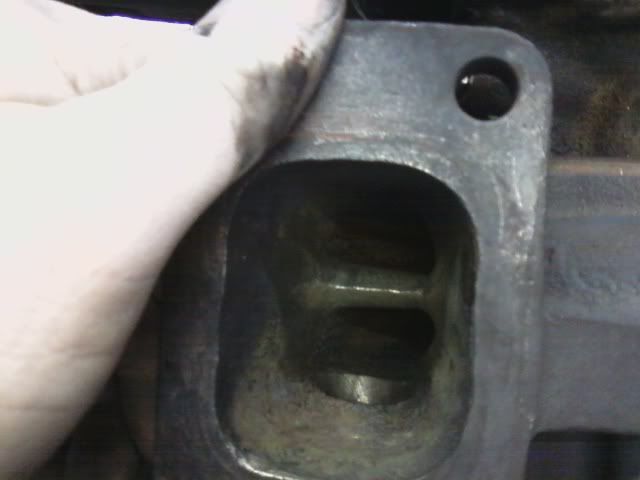

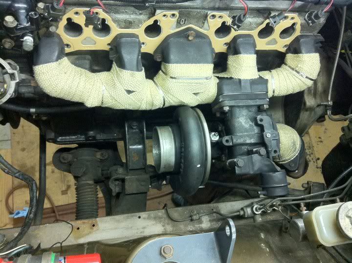

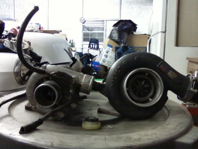

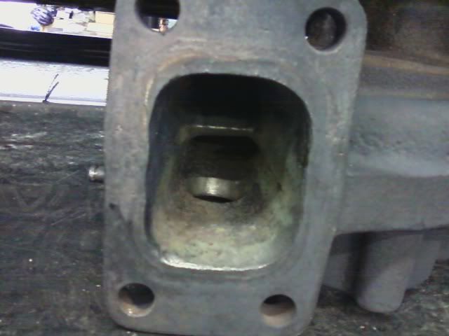

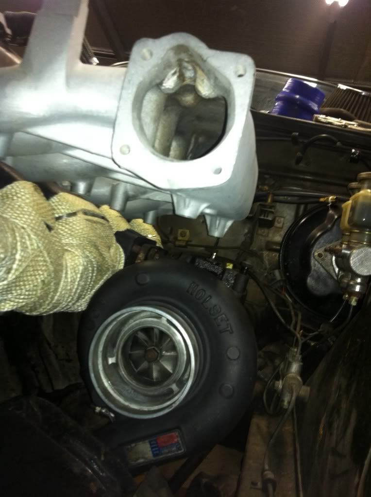

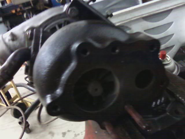

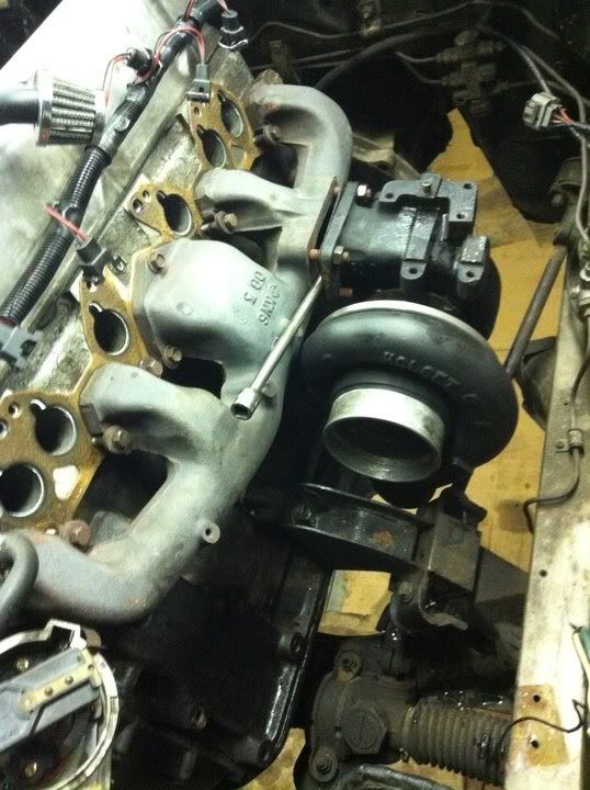

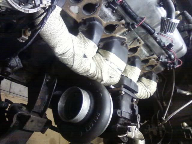

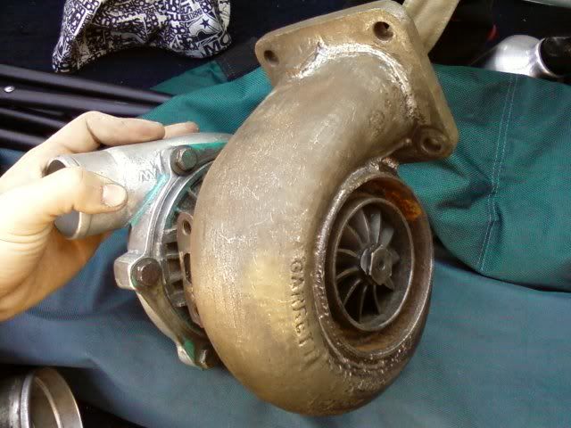

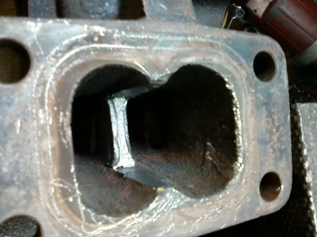

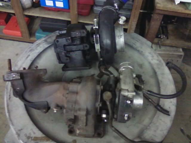

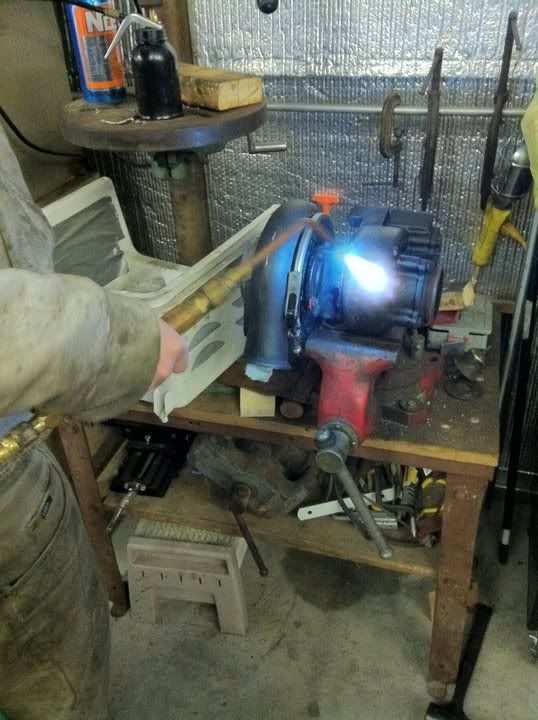

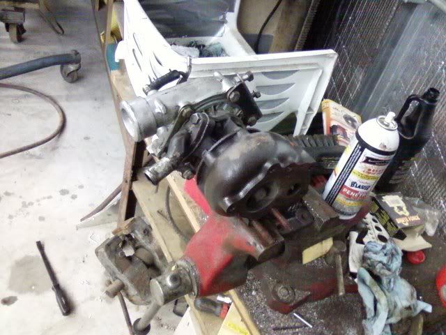

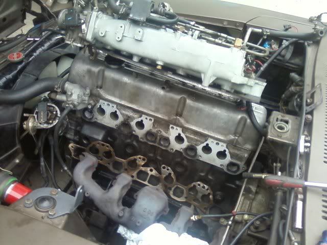

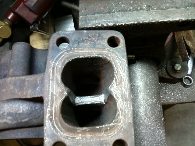

I went through the n42 removed the main and rod bearings on 1&6. The bearings looked new, I plastigauged them and both ends came within spec! everything else was a matter of swapping parts from one motor to the other. I replaced the timing chain and sat the p79 head on, and everything just fell together from there! I ported the wastegate on the holset more; to the point where it will barely seal. Out of curiosity I took the piston out of number 6 on the flat top motor. The compression ring fell apart in my hand... So it wasn't a ringland!

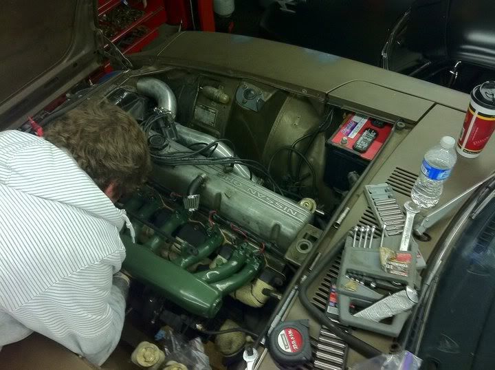

I got the motor back in the car with help from nate_82zx. The next day she was running!
Started tuning the following day. The port job helped, but the holset still has boost creep. I'm going to end up going with an external wastegate, hopefully sometime during the summer.

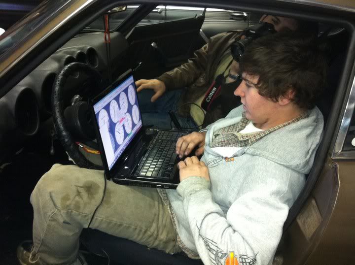

Any-who, I got a full day of tuning in, before the weather took a dump on me.

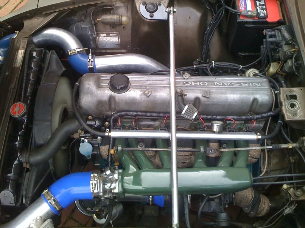

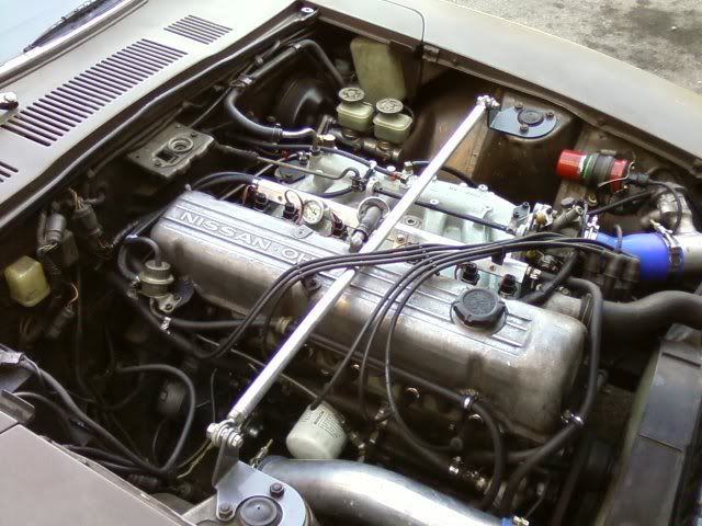

Then all of a sudden spring came! This week has been beautiful and I've been taking full advantage! I just about have the car's ve-table tuned with a rough timing-table. It pulls like a mule at 15psi! The lower compression is noticeable, you can definitely tell when your off boot.
And so I don't leave you hanging, I know how boring these post are without pictures. lol
What kind of AFR are you running in the ~10psi up area? A lot of people tend to run a 'safe' tune really rich and that can cause boost creep in some cases, especially with larger turbine wheels. Another thing is that with a richer charge in the chamber, the burn happens faster so what might be a conservative timing setting for 11.5:1 afr could be closer to knock at 10.0:1 AFR.
Share this post
Well, my AFR's are really rich. Its a consistent 10-10.5:1 up till 12 psi, hits a really rich spot of around 9.5:1, then goes back to 10:1. I haven't gotten to tuning up top yet, so far I have been dialing in my cruse, and IAT corrections. Hopefully I will have a chance to get the positive pressure region tuned by the weekend.

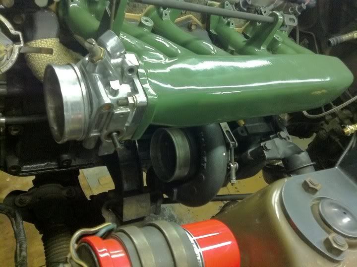

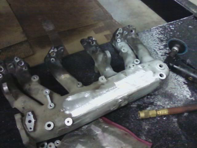

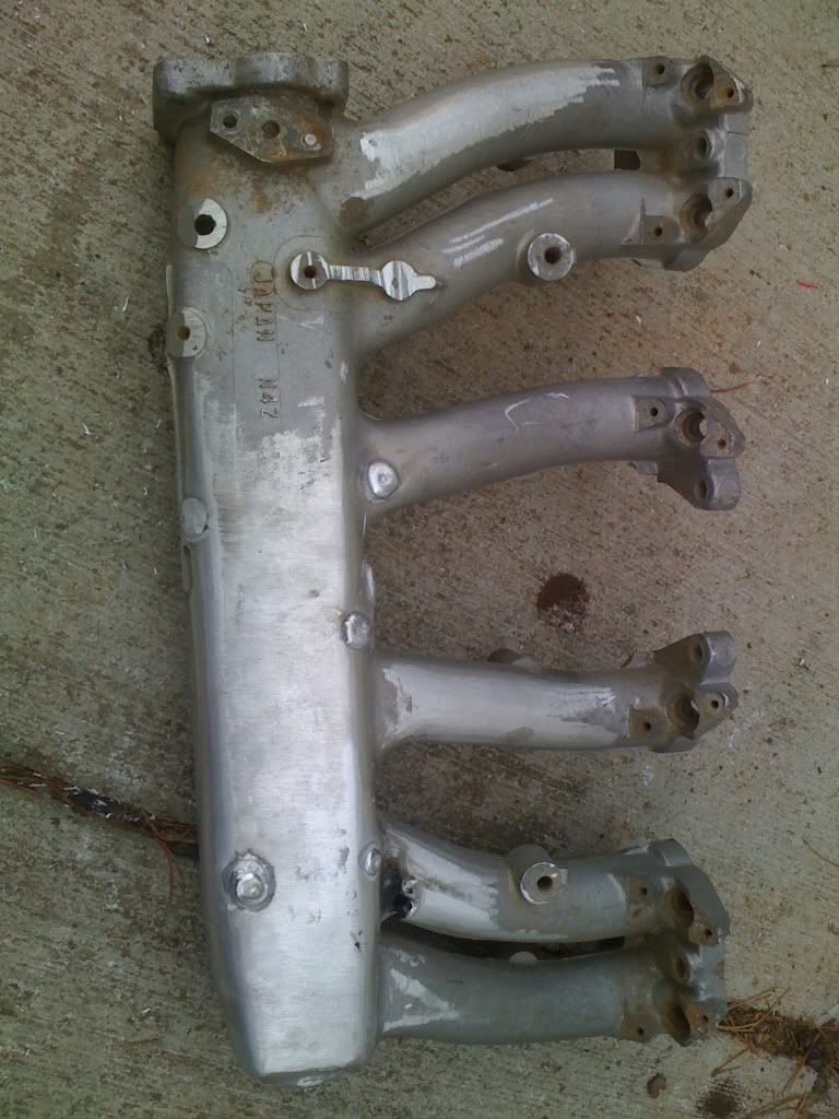

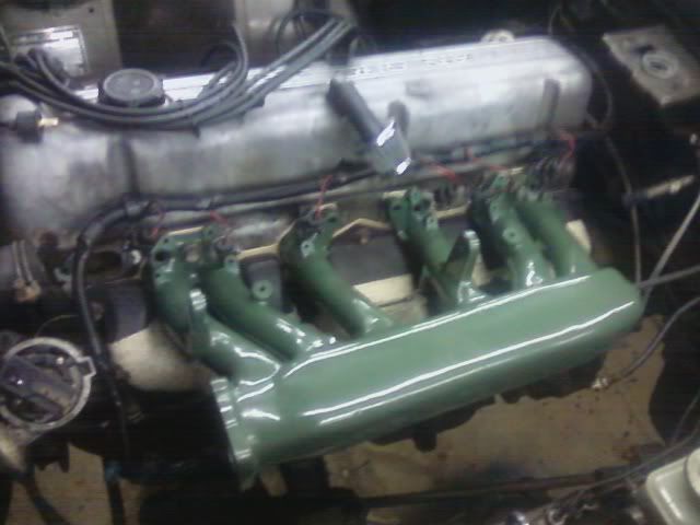

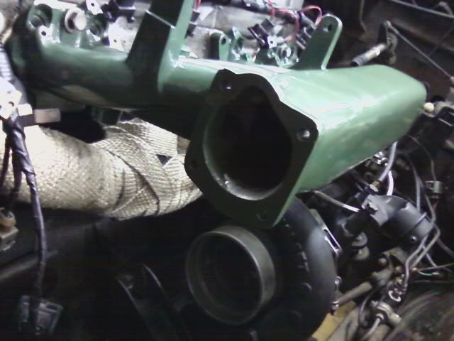

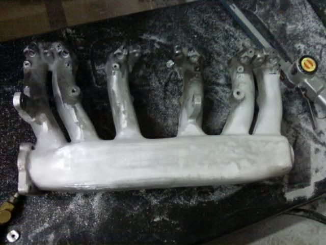

A month later... And the motor is still alive! Shocking given my track record! During the short period of time that the weather was nice, I daily drove the car. The cruise and part throttle ve tables are spot on. I still have the timing roughed in and very conservative. I had the chance to tune the positive pressure region too, but I don't exactly have it dialed in. The car was pulling 23mpg on dd duty including some on boost pulls. I couldn't be happier!

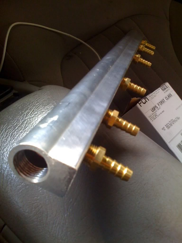

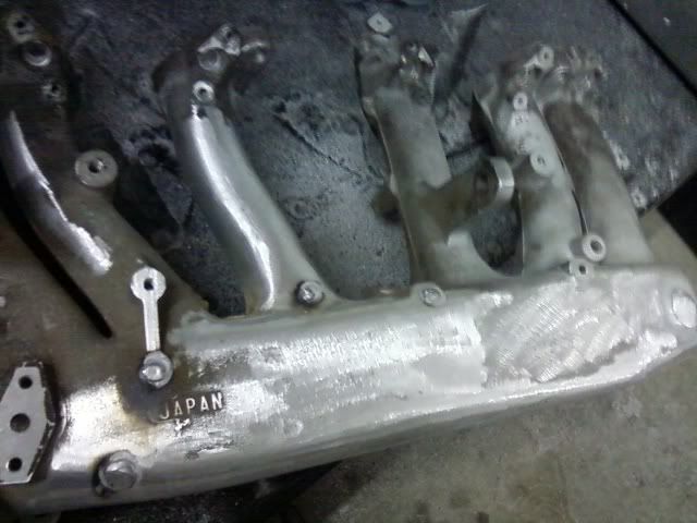

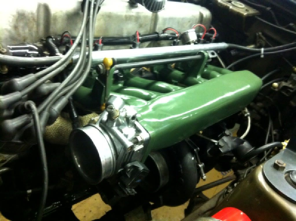

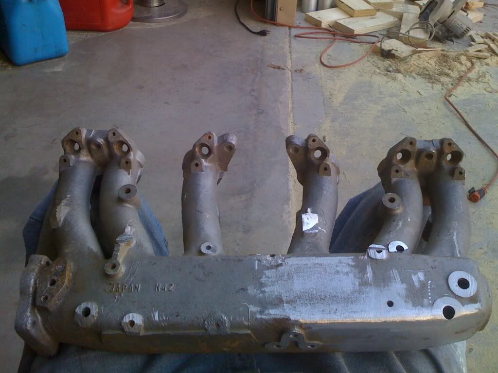

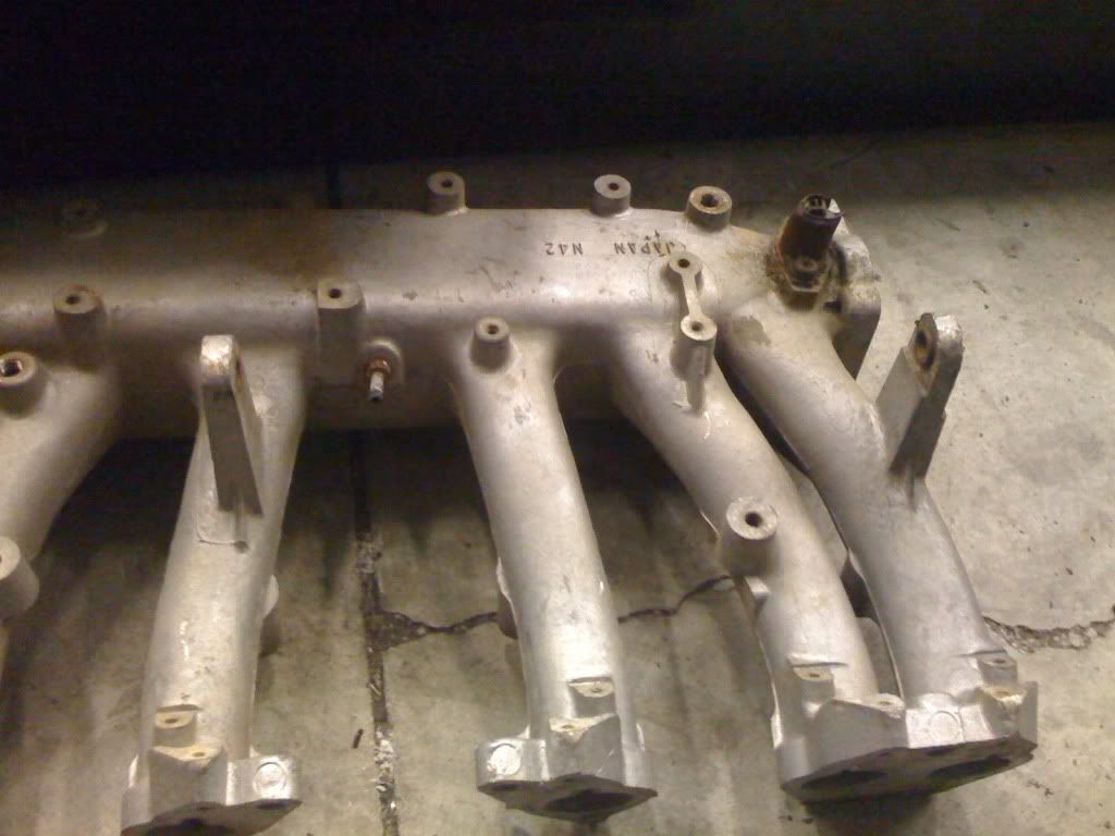

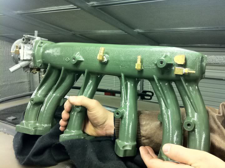

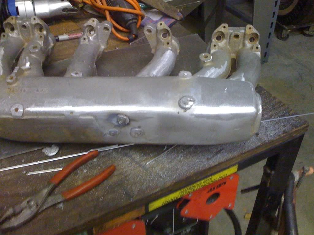

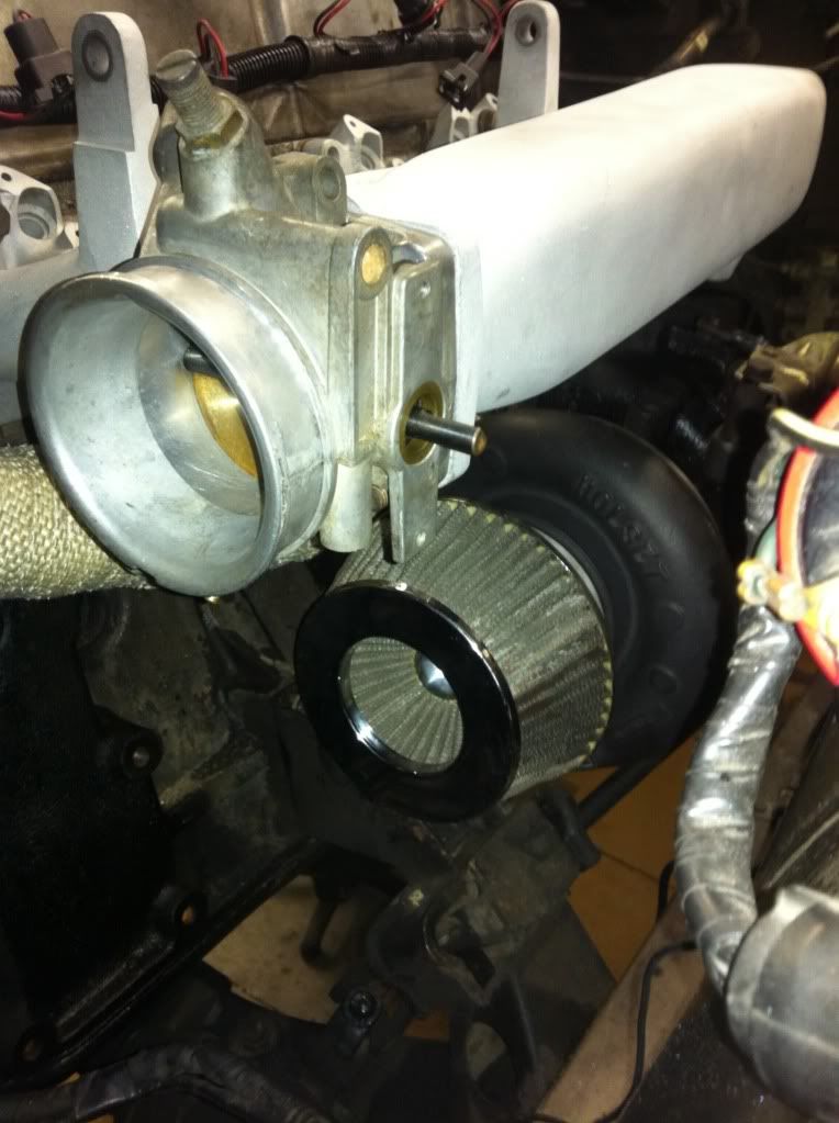

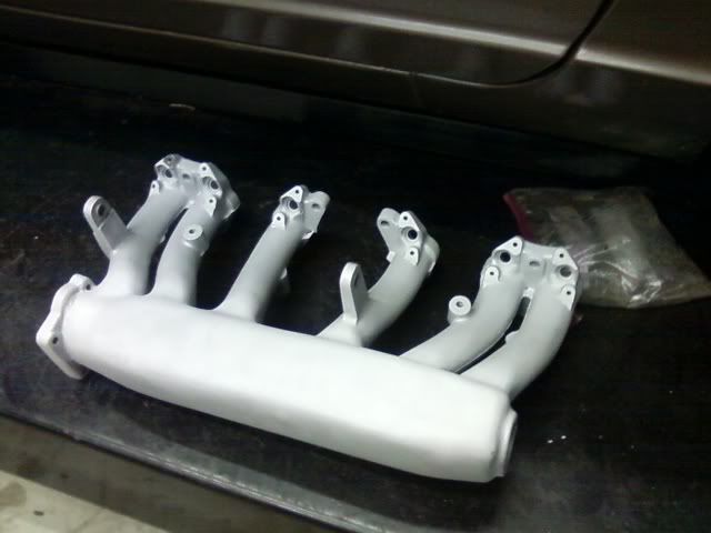

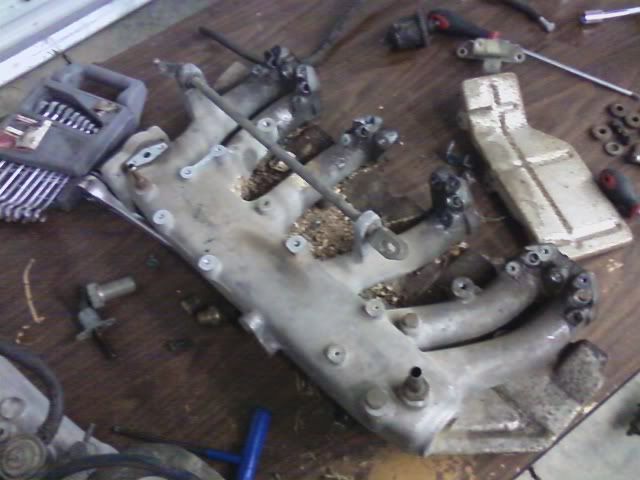

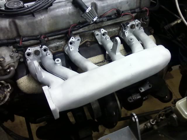

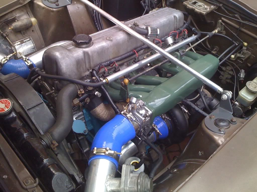

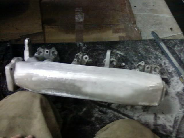

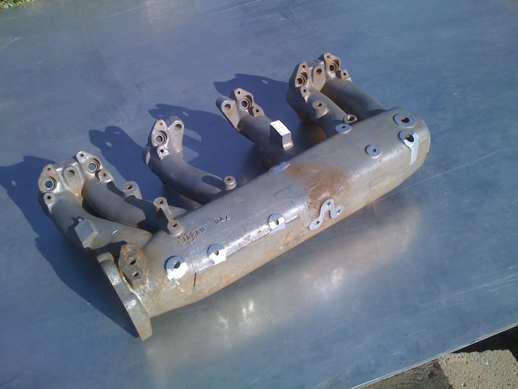

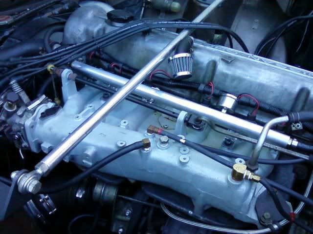

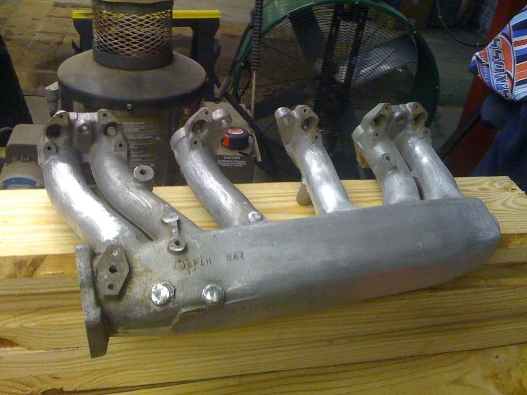

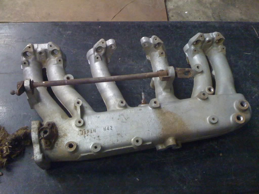

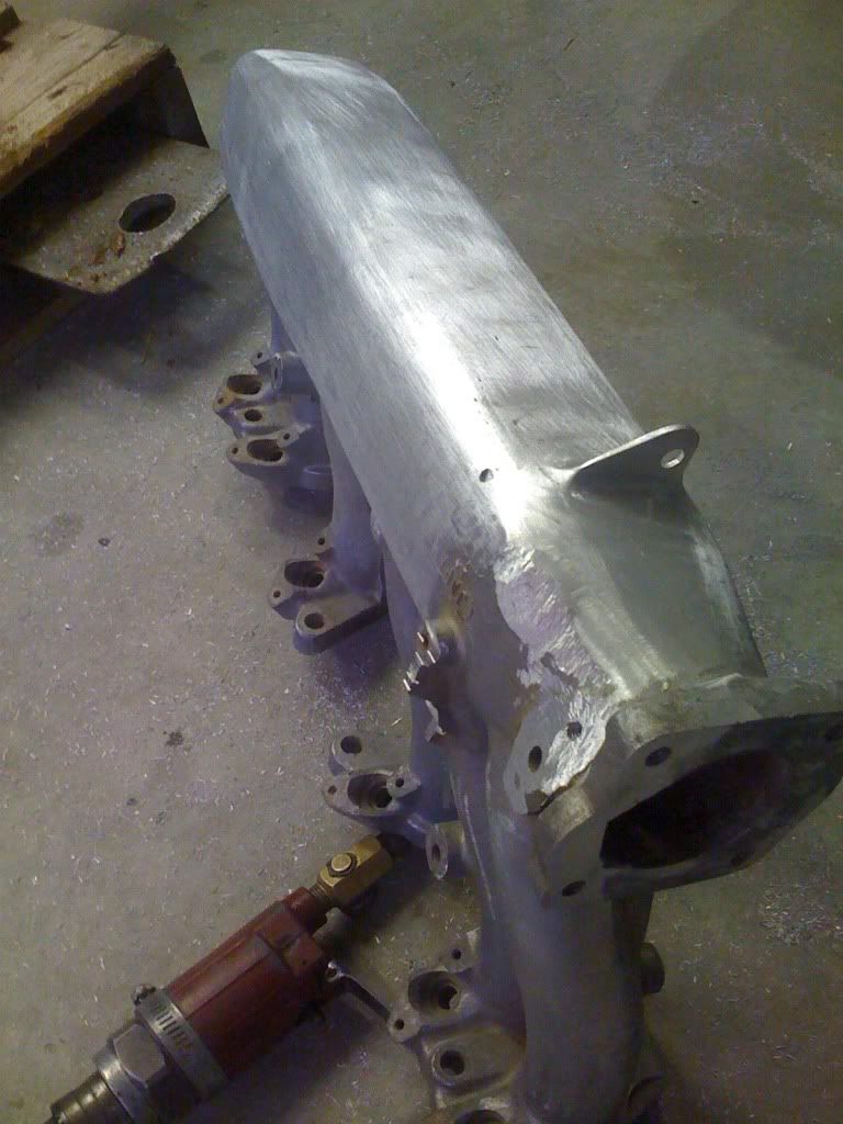

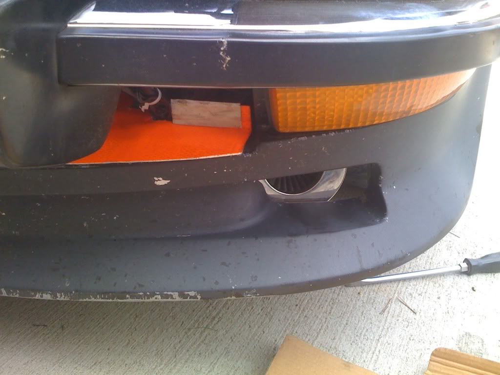

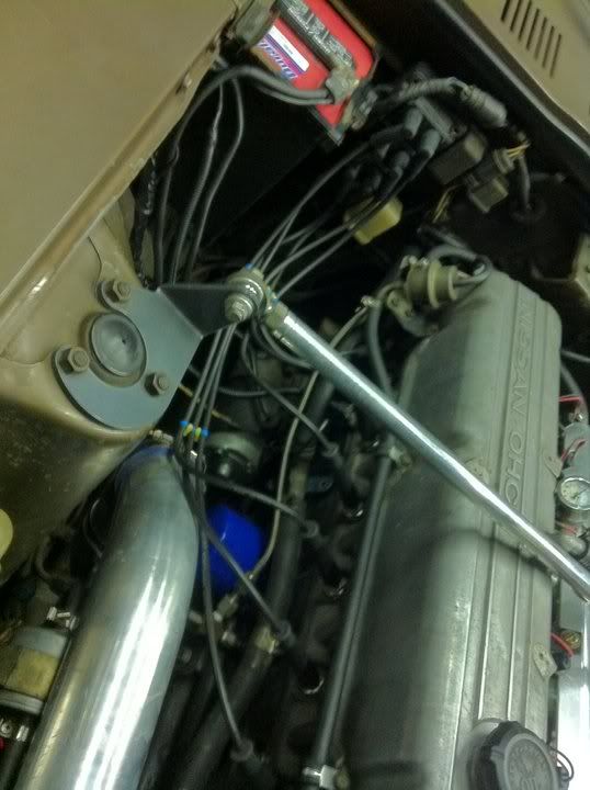

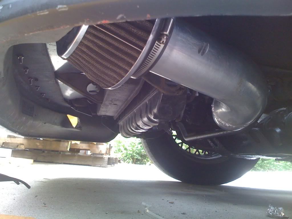

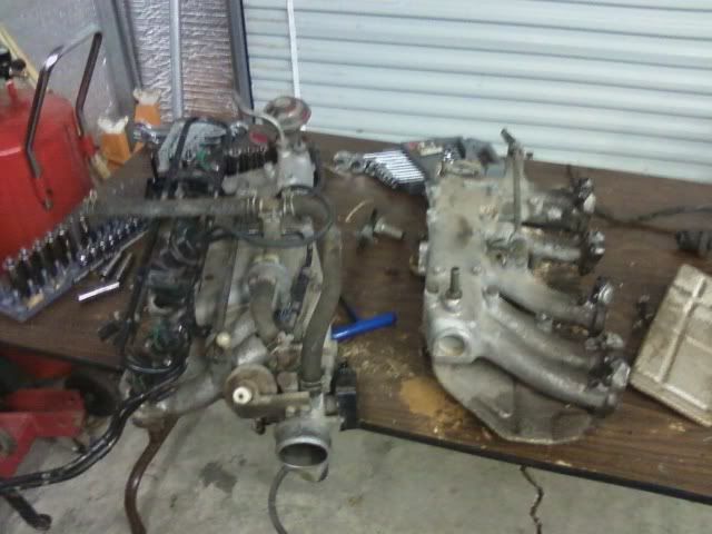

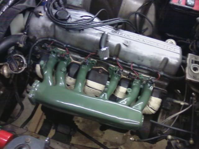

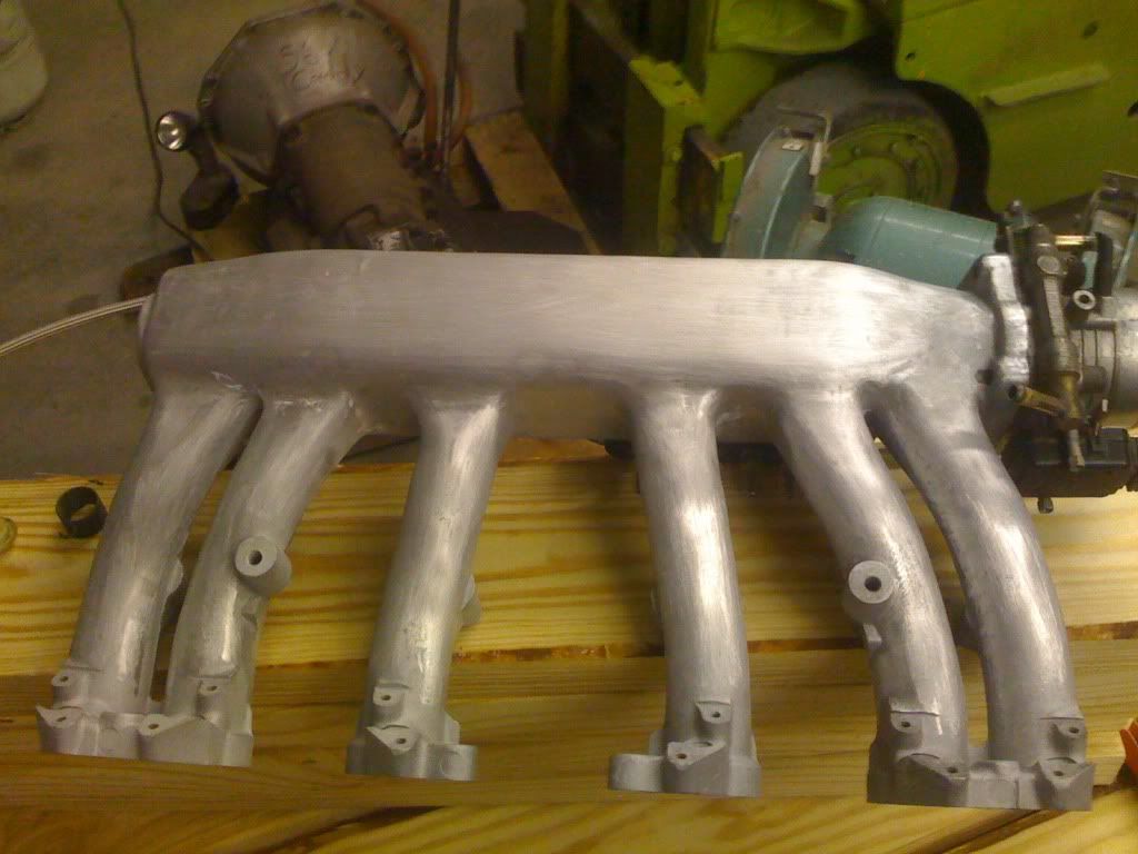

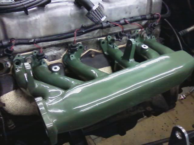

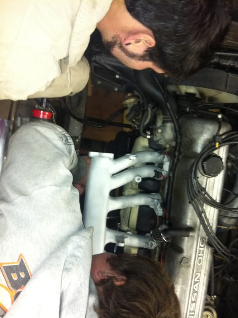

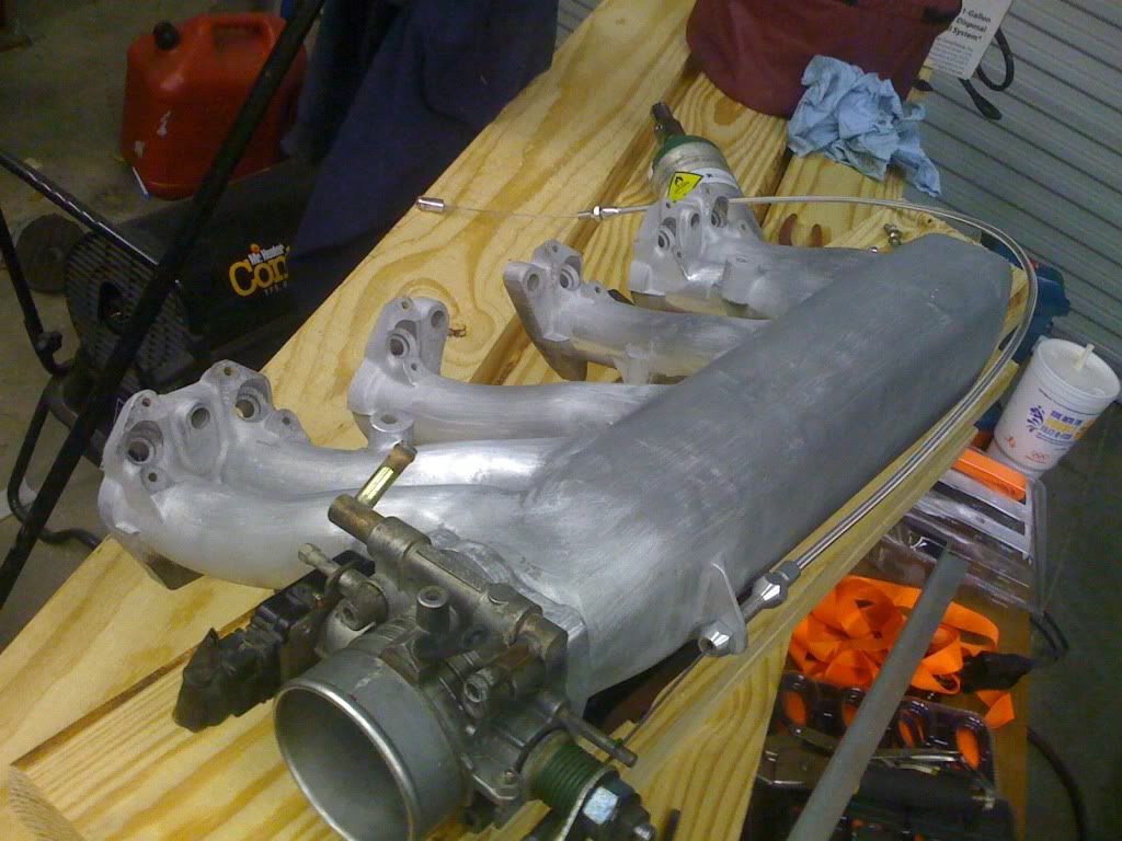

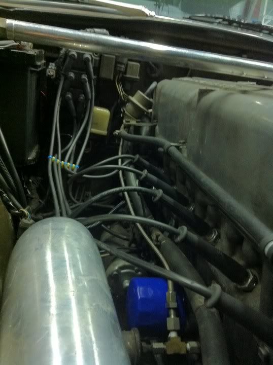

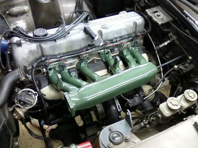

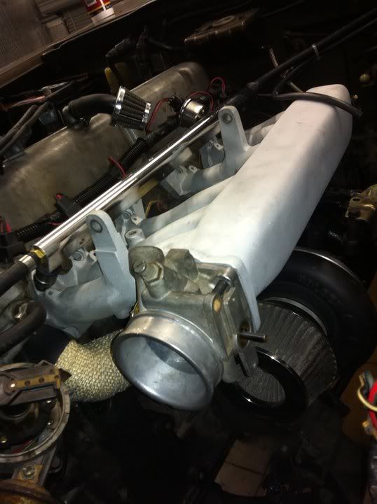

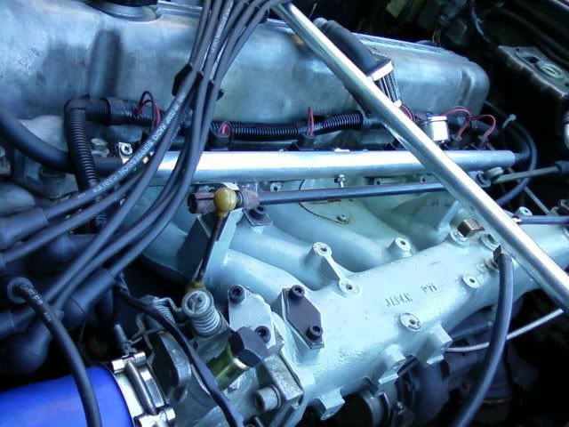

Otherwise I haven't made much headway on the car. I did fab up a "cold air" intake that draws from the driver side brake duct in the front valence. Other than that I have been doing a few odd jobs for nate_82zx. I shaved a non webbed n42, along with put some finishing touches on a fuel rail extrusion for him, pretty uneventful. The z currently awaits better weather so I can drive the darn thing!
"cold air" intake
Nate's intake
fuel rail

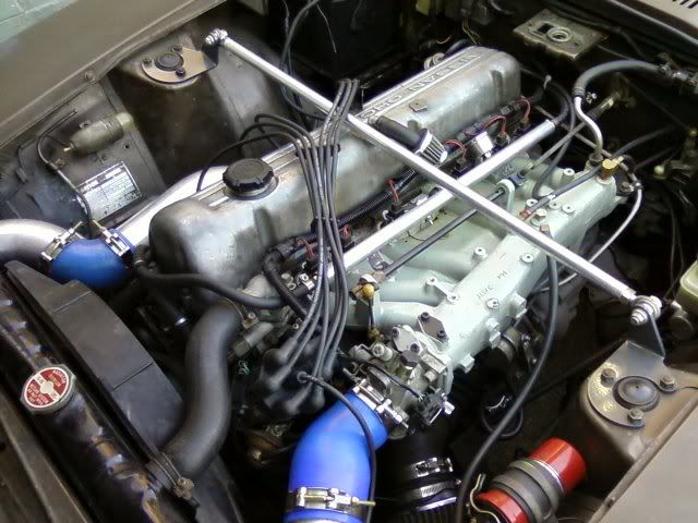

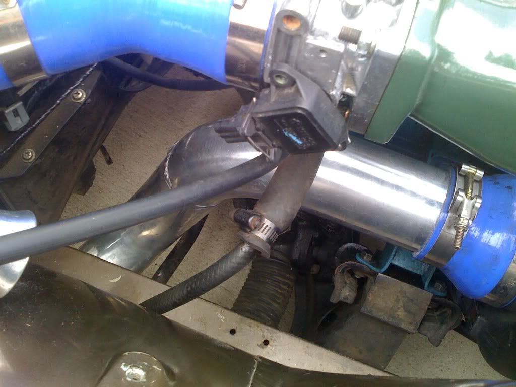

Hello, Hello! Update time!

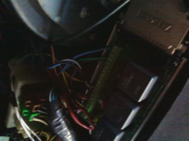

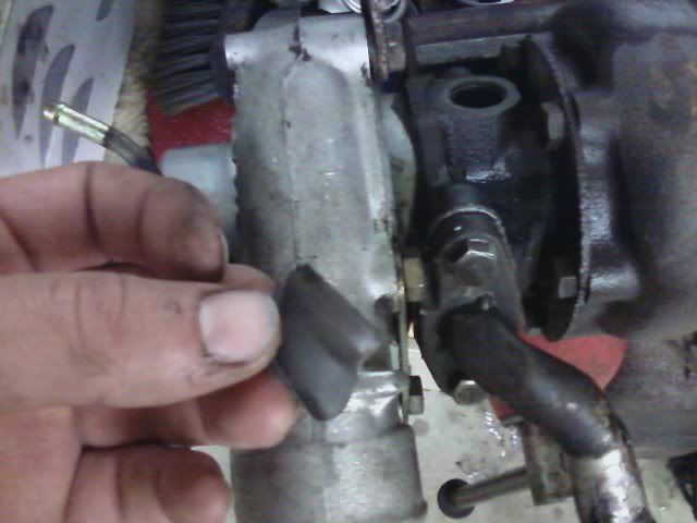

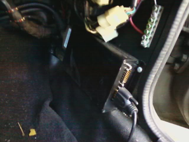

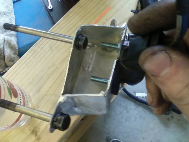

I had bought a Apexi turbo timer off of eBay, and finally received it from Hongkong. Install went fairly smoothly, I disliked the idea of splicing the ignition switch to install the timer so I raided a few late 70's pickups in the local pull-a-part for some connectors that I could make an adapter harness out of. Made the harness, and mounted the control unit in front of the map light. I ran into a problem with the ignition switch engaging the starter. I did some searching and ran across this thread: http://forums.hybridz.org/index.php/topic/84673-ignition-switch-starting-circuit-turbo-timer-install/page__pid__932223#entry932223 . I ended up installing a relay that cut the wire to the starter while the turbo timer was running, the details can be found at the thread I just linked. None the less, on to pictures.

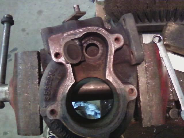

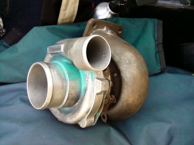

Other than that, I think I've found a solution to the boost creep! a 34mm internal wastegate flapper! A mere $30 and boost creep be gone, but I need the funds to buy it. lol However Its a more cost effective solution than going external. Till next time...

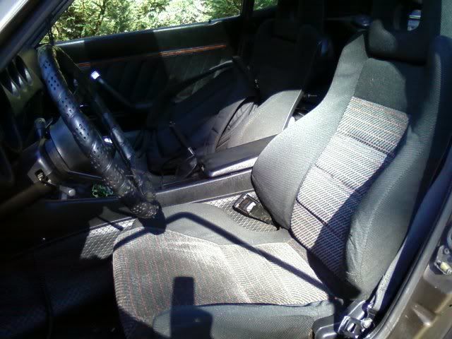

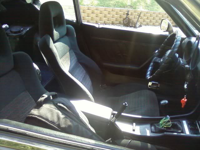

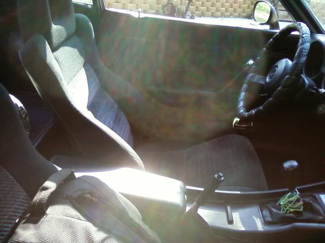

Ok, since I haven't updated in a while I'll get everyone up to speed. I installed a set of crx seats into the car. Fabricate a few brackets, use the datsun sliders, and we are good to go. I love these seats! The bolsters fit me so well and are so supportive! Pictures:

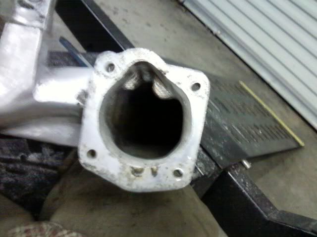

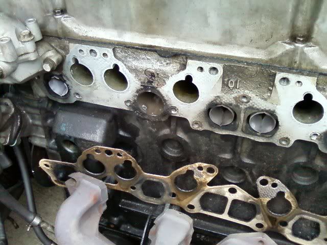

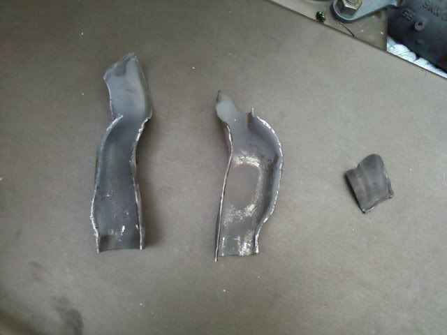

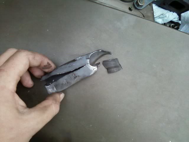

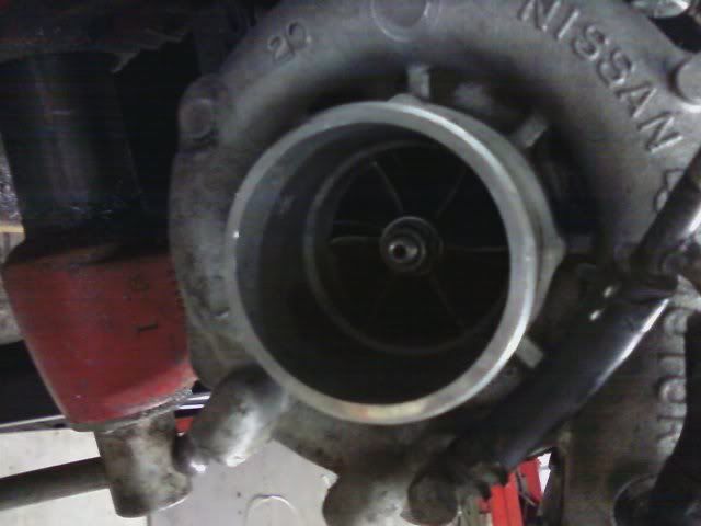

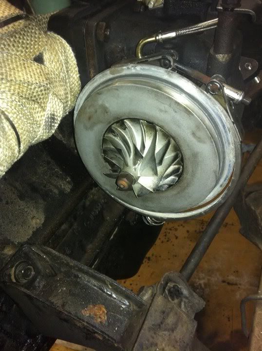

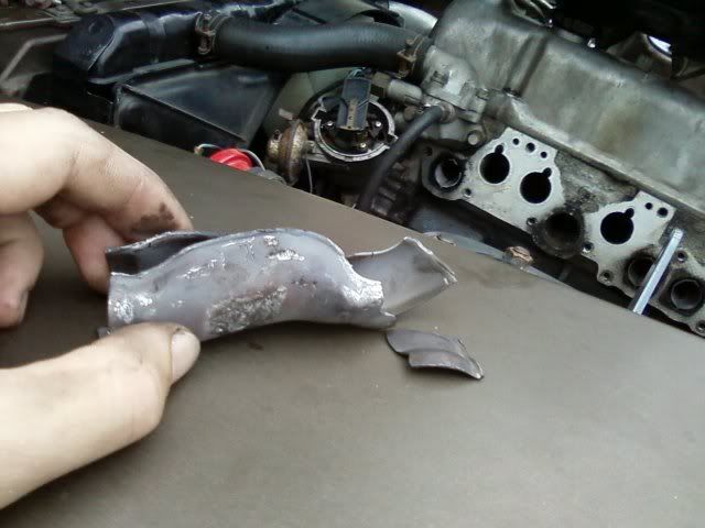

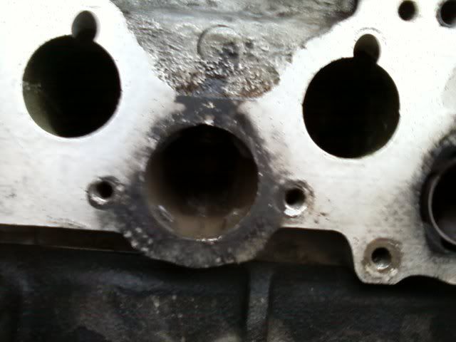

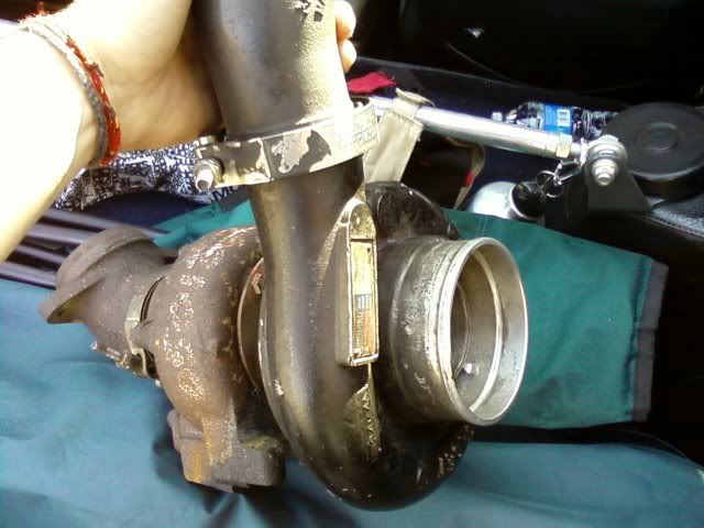

Anyhow, this Sunday was quite interesting... I was running some errands in the car, just enjoying myself, when as a pull onto a side street I hear a "ting ting ting". I didn’t think much of it just sounded like a rock hitting my IC piping. I knew something was wrong when I no longer built boost... I pulled over immediately checked everything no blown joints everything is in its place. I limped the car home, when I get there I take the filter off of my turbo to find that my compressor wheel is not spinning. I thought the turbo was toast; I proceeded to pull the sucker off to find out what went wrong. When I got the turbo off I spun the compressor wheel, somehow it was free again... while I was taking the downpipe off so I could checkout the turbine a piece of metal falls out of the turbine inlet. "The turbo is screwed" to the contrary I’m one lucky SOB. The piece of metal that came out was just small enough to reach the blades, yet when it made contact it wedged the fins instead of grinding the ever-living hell out of them. The turbine was fine, now to find out where the metal came from. THE EXHAUST LINERS! On this discovery I pulled the intake and exhaust manifolds to see which cylinder it was and if removing the liner was necessary. I found that the number two exhaust liner was so loose it was rattling. Pulled that sucker to find a gap where the missing piece fit. Upon more inspection none of the other liners were loose of fatigued so I left them in for the time being. I smoothed out the port and reassembled. I know this is far from optimal but the car is currently my only transportation so I needed it running ASAP. So on to pictures!
Ahhh, the port it as you drive technique ;)

Oh you know it! I'm just waiting for the other 5 liners to fall out to increase the flow sone more. ;)

I found this out the hard way the other day. When I left home there was no chance of rain, started down the interstate and it started pouring! I didn't notice any significant difference until I had to get in boost to pass someone... It fell on its face. I plan on making a front splitter that extends to the engine cross member. When i do, the filter is going to be boxed in.
