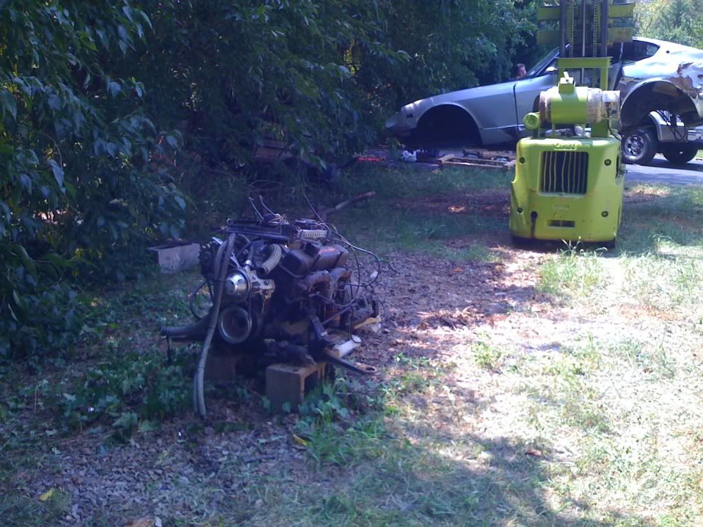

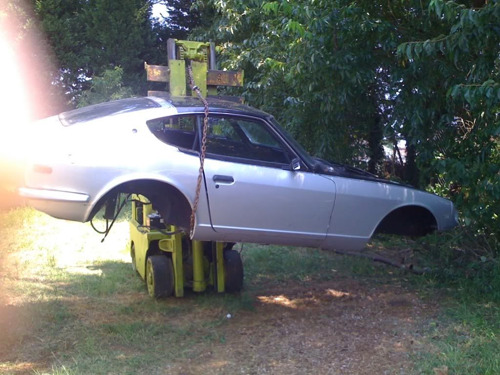

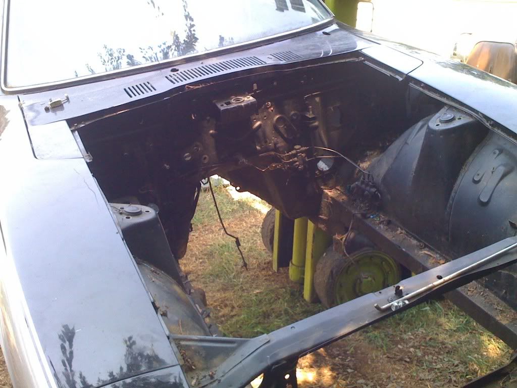

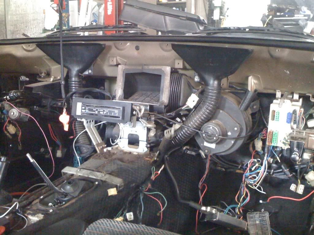

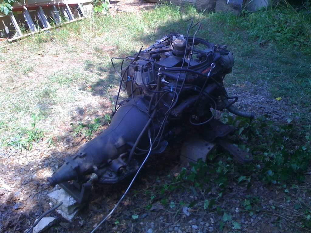

So, today with help from my daddy-o I finished stripping my wrecked 260. Were hauling the body off to the scrap yard, but not after the motor, dash, wiring, interior, and heater were removed. We kept the motor attached to the cross member and lifted the body over the motor/transmission.

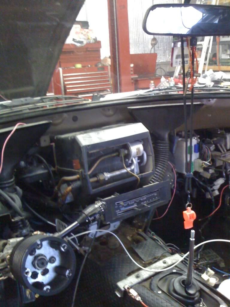

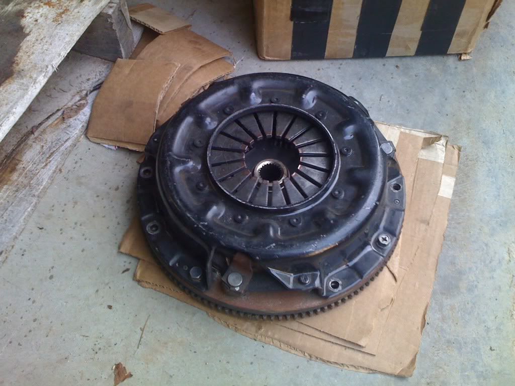

I also received my clutch today. I tore into my car but wasn't able to finish in a timely manor, Ill wrap it up tomorrow after school!

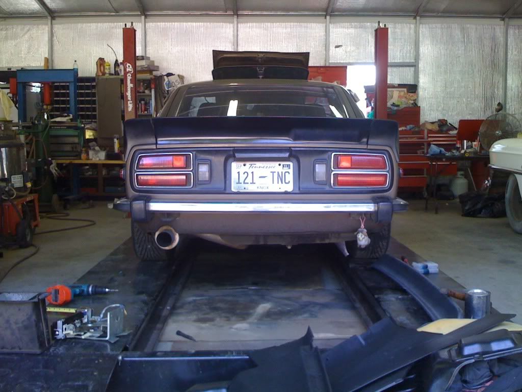

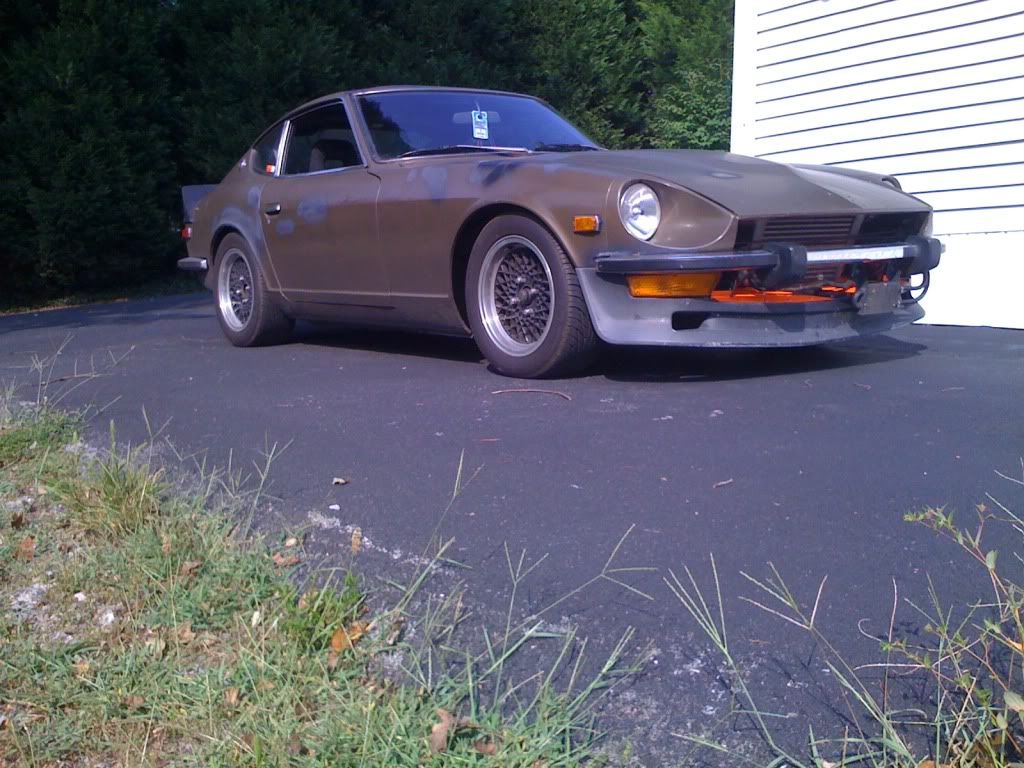

I also snapped a few pictures of my car while it was parked outside the house today. I figured since you all havent seen the stance of the car after the new tires, It was about time!
And the new clutch!

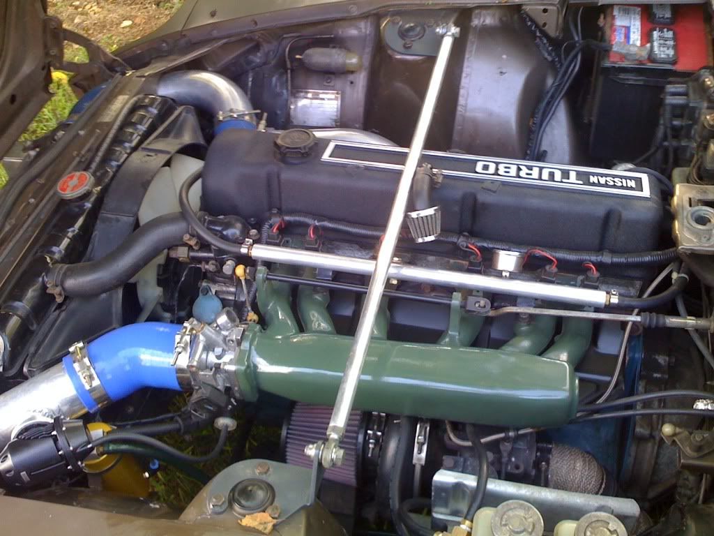

I'm not sure why I keep neglecting this thread. Since last time, I've installed my clutch, synapse bov, Taurus electric fan, and a gm cs130 alternator.
The synapse bov is one of the nicest units Ive ever used! top quality craftsmanship, and remarkably responsive. I absolutely love it!

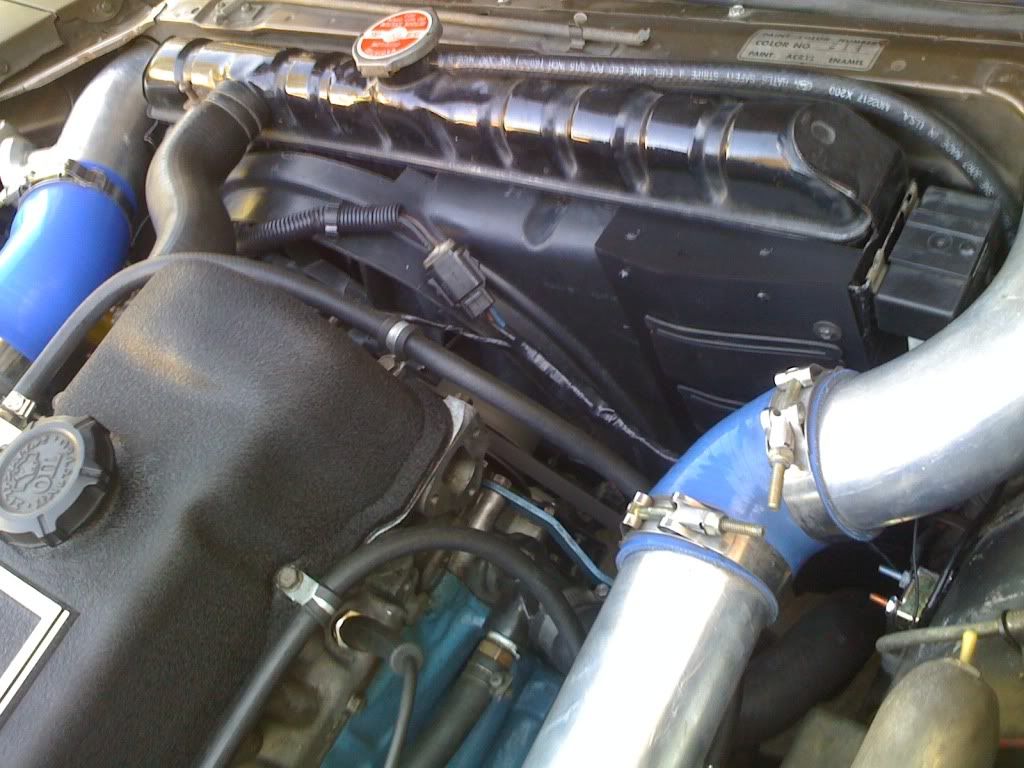

For the longest time my mechanical fan bugged me because it "didn't fit" with the clean-ness of the newly developing engine/engine bay. I finally took the leap and picked up a 3.6l Taurus 2 speed fan from the local pull-a-part. I also grabbed a CS130 alternator off of a mid 90's Pontiac sunfire. The CS130 is a 100-120 amp 3 wire gm alternator, I basically followed the instructions of another member on here and modified the lower alternator mounting bracket to align the CS130. After I got the higher amp alternator installed I went about "massaging" the taurus shroud to fit between the radiator and the water pump pulley. After a liberal amount of cutting I got it to fit with a little room to spare (like 1/4 inch clearance between the crank pulley and the fan motor). I used a Volvo 2 speed fan relay, in conjunction with a BMW 2 speed fan sensor/switch. I was fortunate enough to have the appropriately sized tap, to tap my thermostat housing so the sensor would fit. This fan is great! I should have done this modification a long time ago. Sitting in stand still traffic, nothing more than a slow cycling of low is needed to keep the car at operating temperature. The high speed will also lend its self useful when I finish my ac system. Anyhow I don't have many pictures to accommodate this update, but some are better than none I suppose?

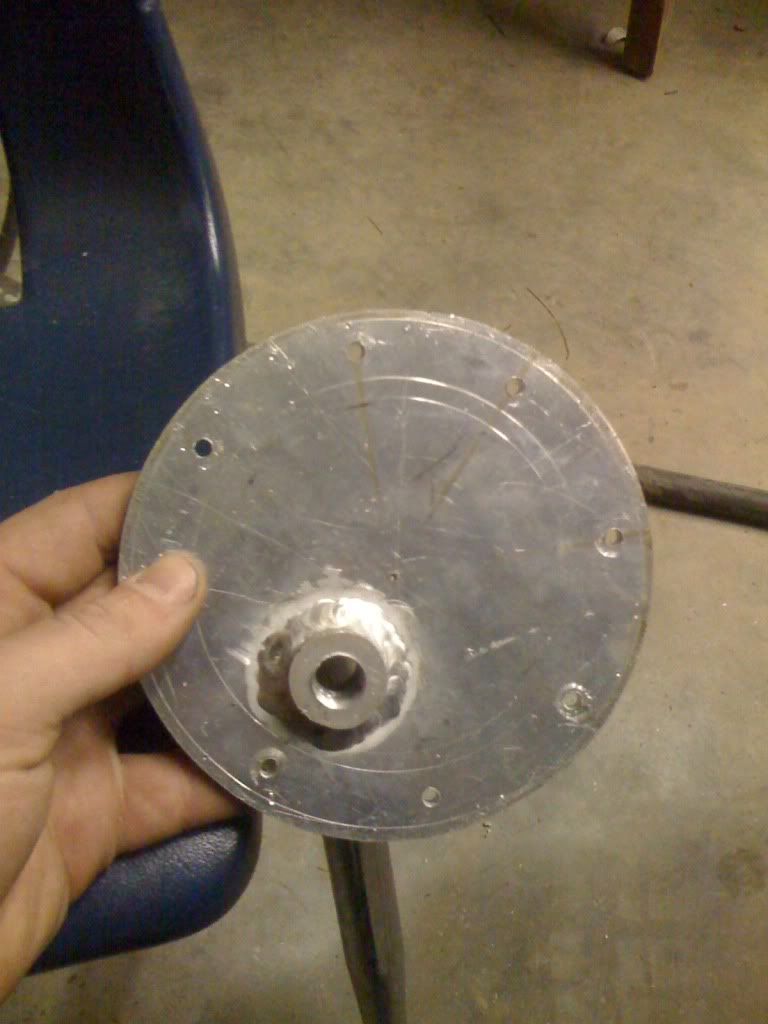

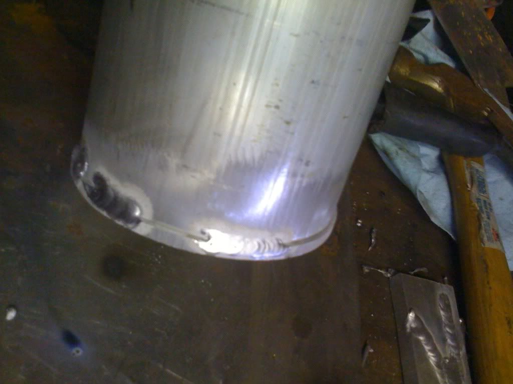

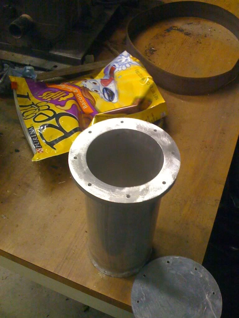

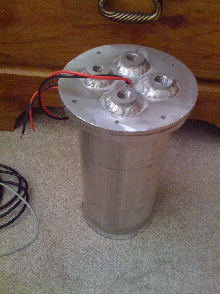

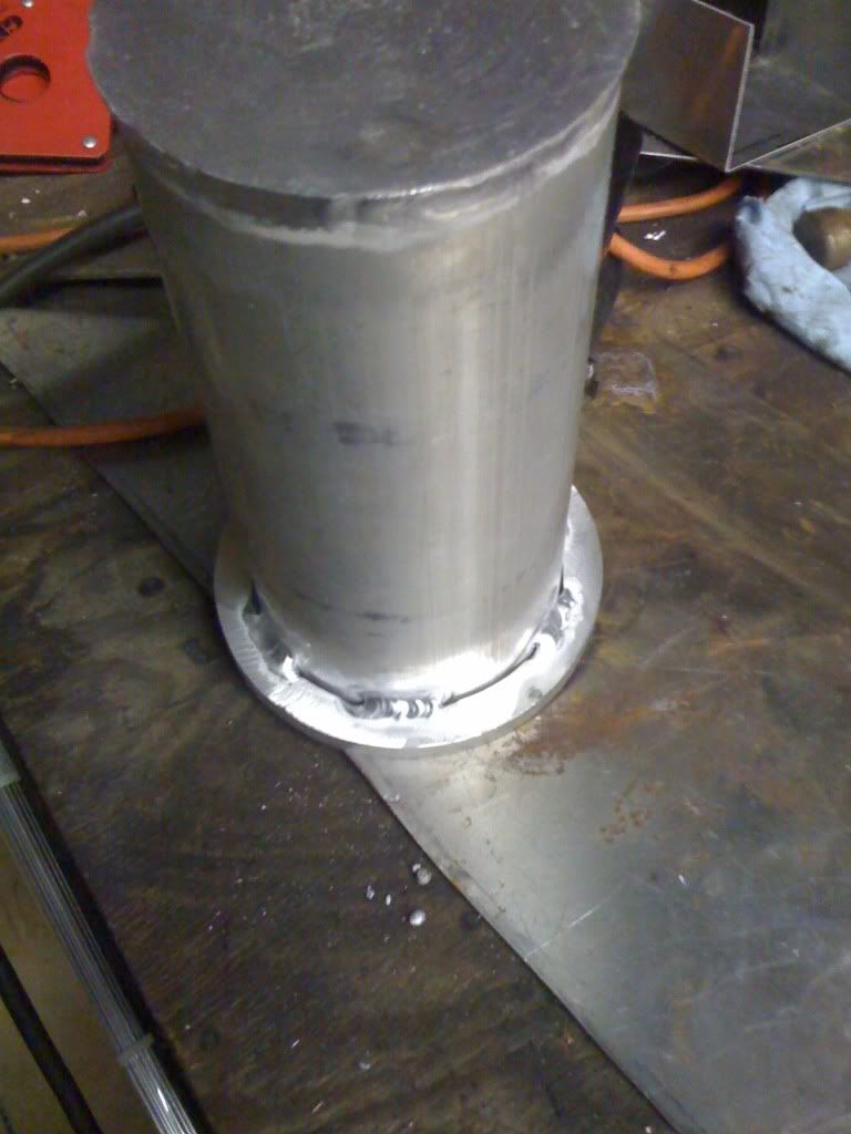

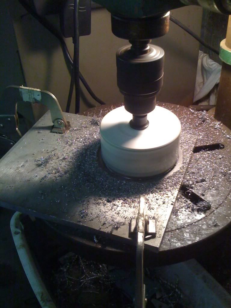

The latest project is the fab of a fuel surge tank. I started this project to finally to my fuel system right. When I first did my fuel injection swap,running NA, I ran a 90 degree fitting from the gas tank drain into a filter, into an aftermarket replacement pump, feeding the fuel rail. When I first installed the turbo with an FMU for fuel management, the one pump wouldn't suffice, so I added another pump in series to help with the high pressures. Fast forward to last week when I realized that around 5500 The car's AFRs' would start to rise into unsafe territory. I thought it was a fuel restriction so I decreased my timing under boost, increased the begesus out of the fuel table in the range it was leaning out, and took it for a drive. The drive backed up my assumption that I had a restriction. To finally put my fuel system to bed, I decided to fab a surge tank. For sake of packaging I wanted to go with an in-tank pump in the surge tank. I found a Walbro 255Lph fuel pump for under $100, I bought it based solely on the fact that the seller had great customer service and worked with me to include the filter sock I needed. The next decision was for the feed pump. I finally settled on a carter 72Gph pump. Summit was selling these pumps for $91.00 shipped, but lucky me found the same pump on eBay for $65 shipped!
I did some calculations that I would like to have a 1.5 liter tank including the lost volume due to pump. Finally I settled on 4in diameter tubing, after a call to the local metal company I procured a 4x12x.25 tubing and a chunk of 3/8in thick 6061 plate that the top flange was going to be made of. Picked everything up and went to work!

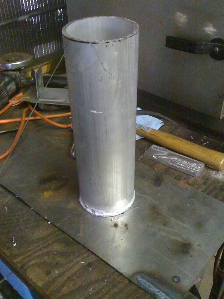

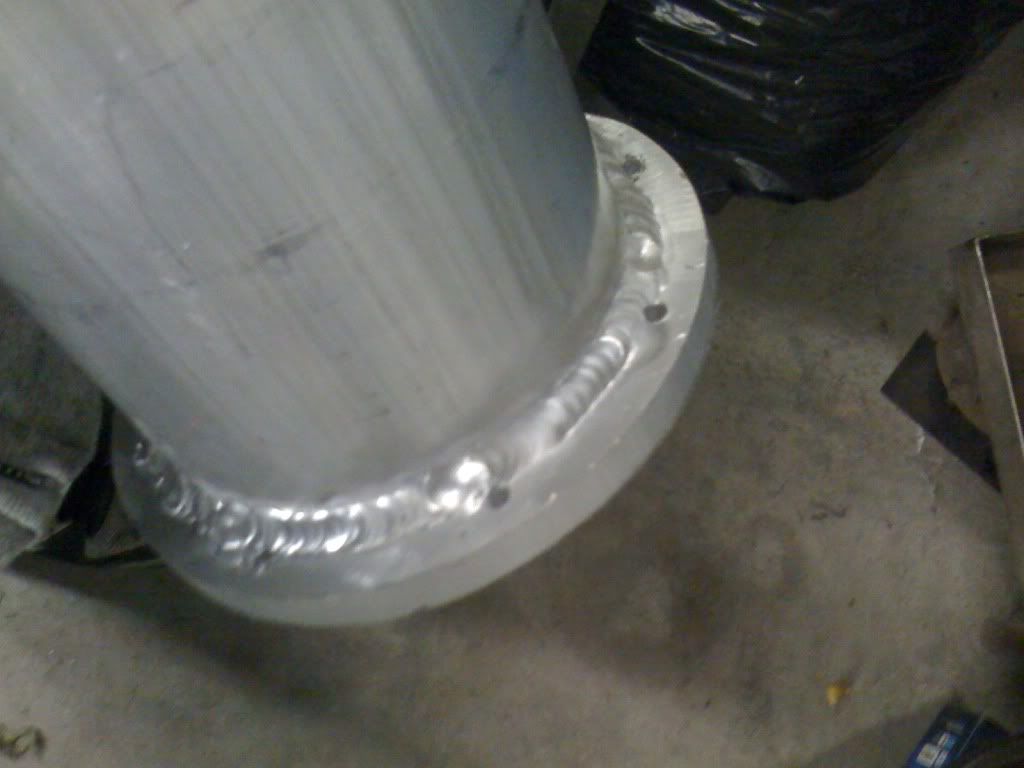

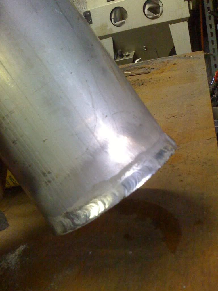

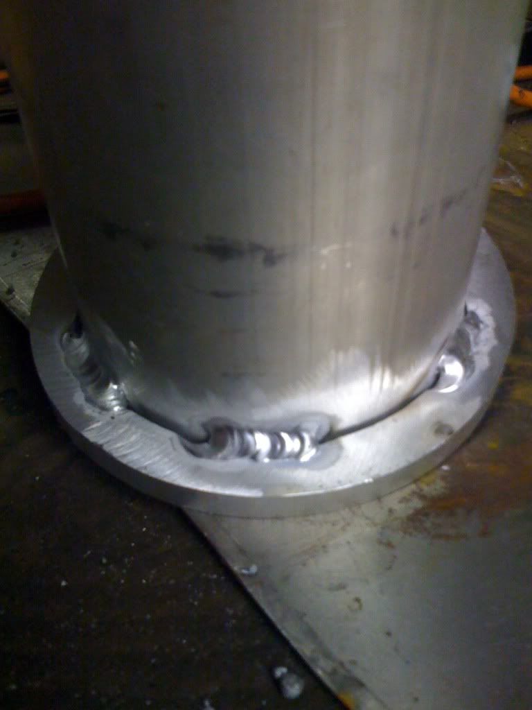

Tacking the .25in bottom on the tube.
All welded up!

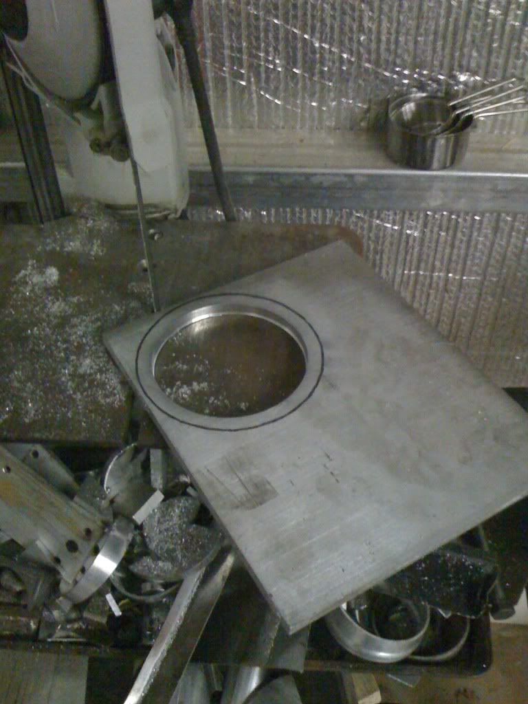

Cutting the center out of the 3/8in top flange:
Cutting the outside of the flange out:
Tacking the flange on
Top all welded up and the top plate made
All welded up, I'm still working on my tig welding. Not to bad for someone who taught their self.

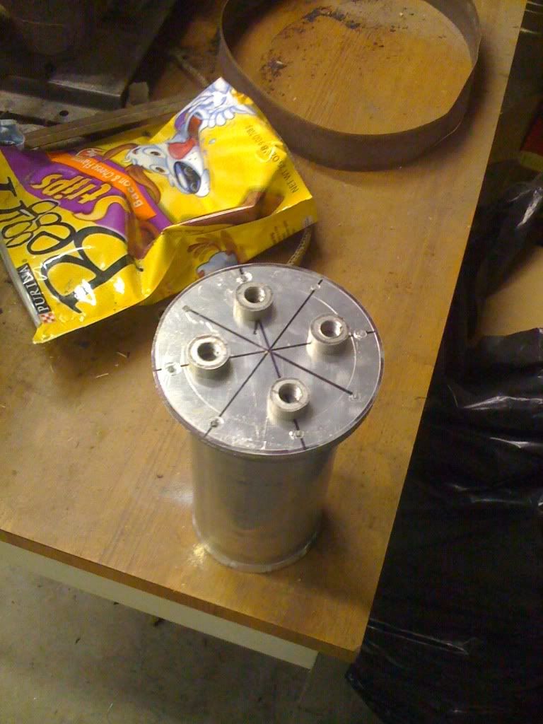

The top plate drilled and if you look on the table you will see the 1/4npt bungs I made:
Bung placement:

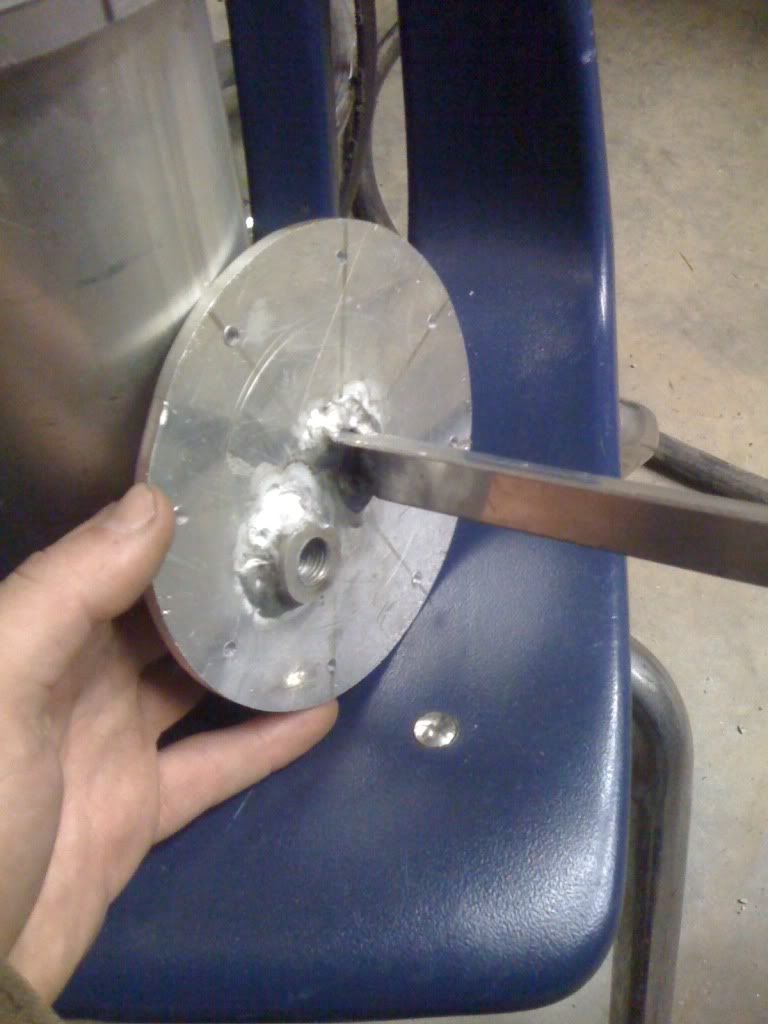

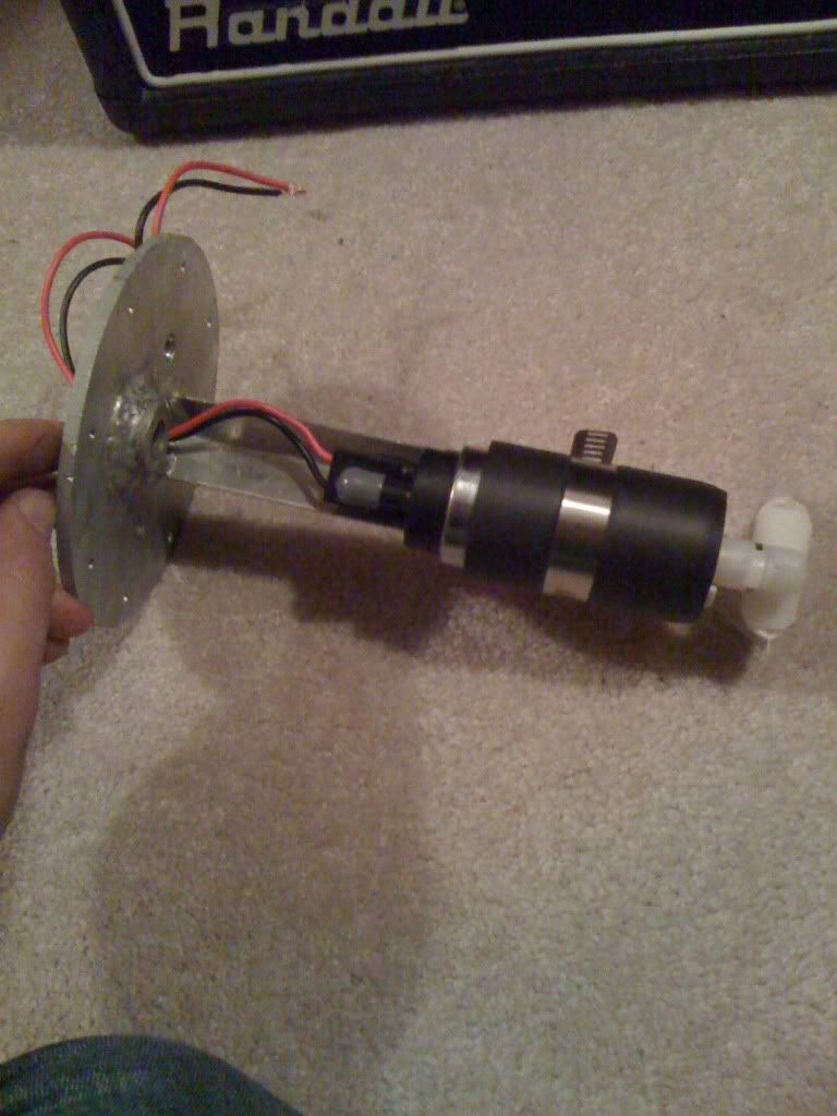

Fuel pump stay and bung welded on the underside of the lid:
Fuel pump bung welded on the topside:
Fuel pump mounted:
Everything finished and welded up:
When I get everything mounted I will post installed pictures. I still have yet to determine the mounting brackets but that shouldn't be that difficult.

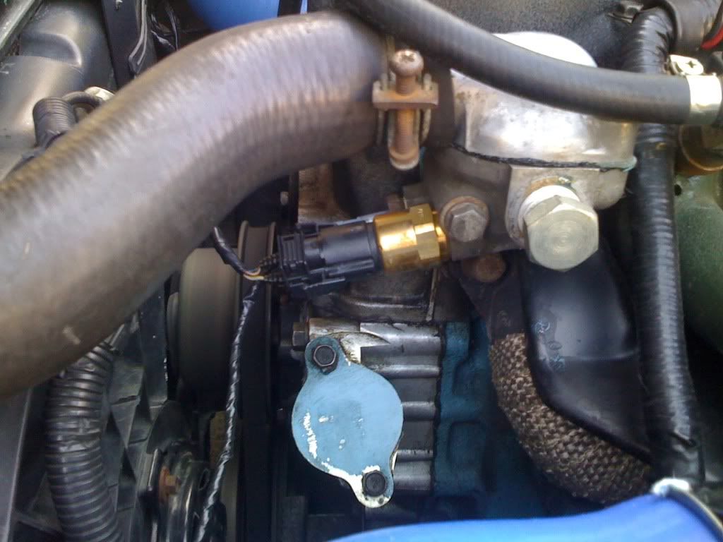

I have had some trouble with the car smoking when cold. I really didn't pay it any attention until it became too bad to ignore. The car would billow blue smoke when it was coming up to temp. I checked the plugs and they showed no indication of burning oil... the turbo. I pulled my air filter to see that the compressor wheel had contacted the housing, I pulled the holset to rebuild it. G-pop shop was wanting $195 shipped for a compressor wheel and rebuild kit. I found a store on Ebay that sold entire center cartridges complete with compressor and turbine wheels for $180 shipped, I went that route. The cartridge arrived on the slow boat from socal, it took nearly 12 days to get here. I put everything back together and it's back running strong again.

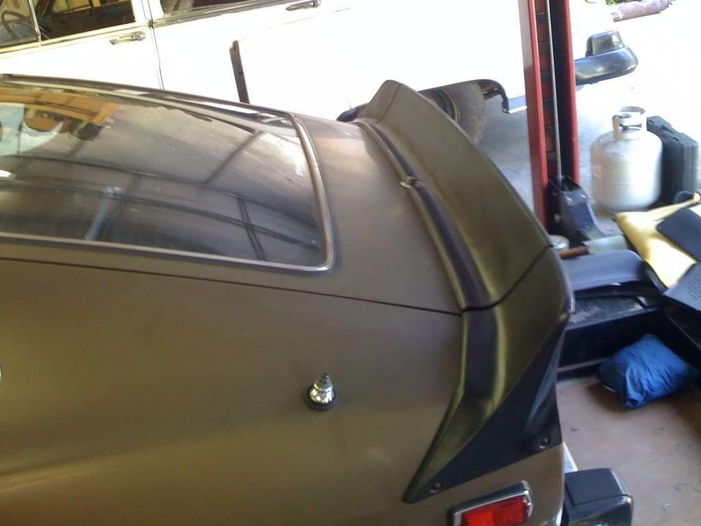

The fitment of the wing isn't bad. Its a little off in some places(its not drastic), but that is to be expected with a piece that old.
