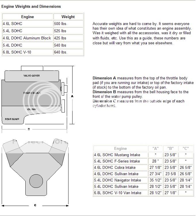

DOHC 4.6L's are 26 5/8" wide (5.4L is 28 1/4" wide.) I havnt found any specs on the Coyote yet but it is buzzing over at Mustangforums.

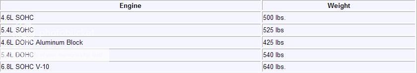

The weight of the engines can be seen at sullivanperformance.com

I have an 03/04 Mach 1 crate motor that I bought for my Mustang but went a different way with it. I was able to push it around my garage on its pallet without a prob, so 425lbs is pretty accurate not to mention I trust what SullivanPerf has to say.
I have been tooling around with the idea of putting my DOHC 4.6L into my 93' Z.
I've lurked on the forums for a long time now and decided its probably time to show that I am here. So w00h00 for my first post! :D
Dimension Specs: Credit to SullivanPerformance.

I was also just searching around and I found that the Q45 engine (26.771") is almost the same size as the DOHC 4.6L (26.625") infact it is slightly larger.
There have been a few people that have done the Q45 swap which means that we will have no problems with DOHC 4.6L or Coyote swaps. :D

Even though this engine has smaller more compact heads than other 4V mod motors it still ships at 430lbs (Where my 03/04 Mach 1 DOHC 4.6L shipped at 425lbs.)

I am a Z32 guy, if the slightly wider Q45 engine fits then the Ford DOHC 4.6L will fit.

The PI motor is 75lbs more than the DOHC versions.
