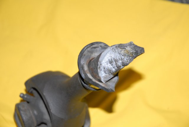

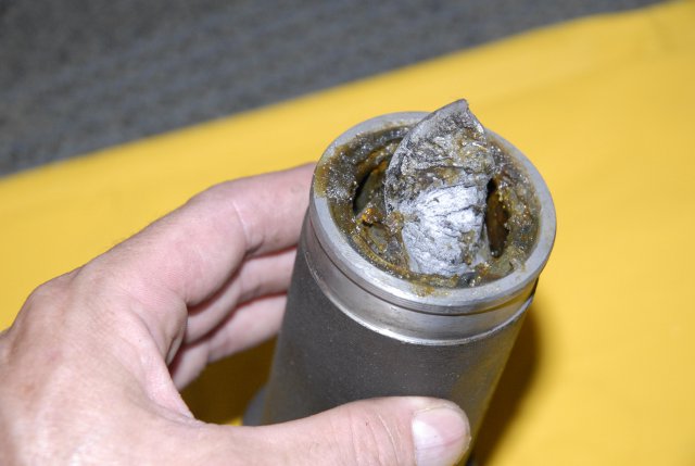

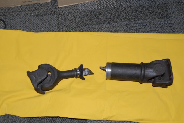

Completely missed 4th gear and coasted in neutral through the traps. Second run....launched at 4500rpm and snapped a half shaft...let off before any further damage. Here are some photos of the carnage below. Snapped the shaft in half. End of my day:mrgreen:

Not sure of the history of these shafts but my guess is they are well used! There are guys putting down a lot more torque than I do without doing this kind of damage. Ive seen quite a few posts about broken half shafts and most are the result of extreme shock such as drag racing with sticky tires or road racing. I would think you will be alright on the street as long as you dont dump the clutch too hard at higher revs. I will not do any more quarter mile stuff until I get the CV conversion done...I think I am lucky to have not done any damage to the underside of the car/lines etc. when it let go...
Seems the stock half shafts don't like hi rpm, rb launches. especially with a strong clutch and traction. I was ok with mine till i started adjusting tire pressure to hook up. the V-8 auto guys dont seem to have half the problems we do with twice teh HP:icon56:

Drew: Not sure if you have a 300ZXT R200 CLSD but Modern Motorsports (MM) has BEEFY Stub Axles that replace the 280Z stub axles (Eliminating design weak spot in 280Z stub axles). These together with 300ZXT half shafts should take MUCH more torque applied to the rear drive. They were designed to eliminate MM customer repeatedly SNAPPING new MM 280Z replacement stub axles.
Normally the failure mode is at the U-Joints.
It appears there was a section there which had a 'crack' previously. Hard to tell from the photos, but that would be my intuition. Especially since it looks like you have the 'zerk style' U-Joints, which generally frag-out at the tapped holes for the zerks!
