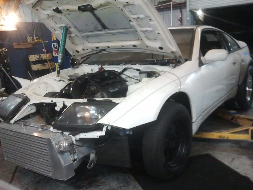

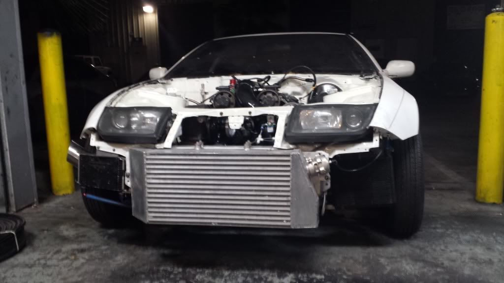

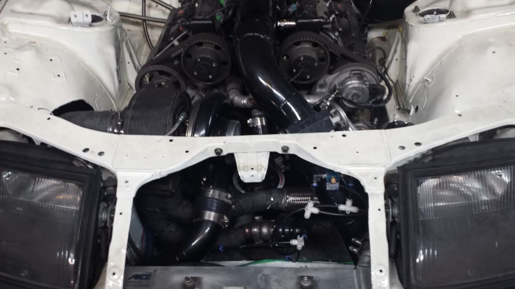

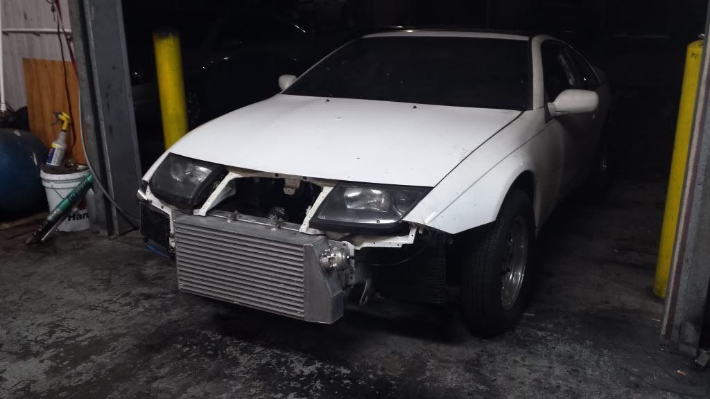

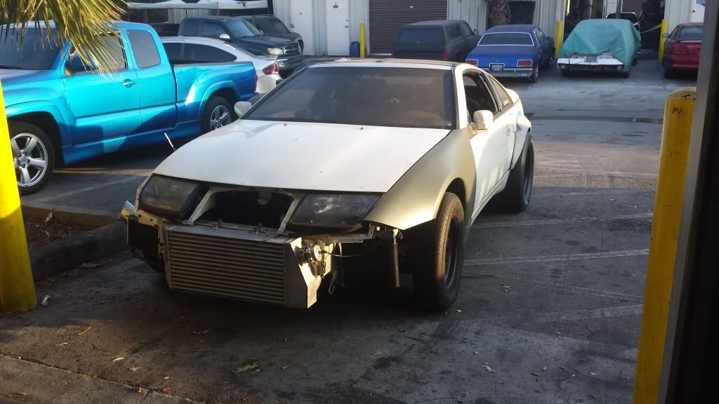

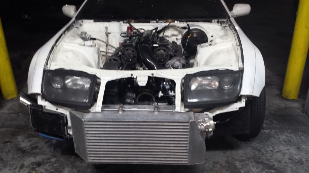

Well the car is almost done,
changed alot since my last update. Ditched the twin walbro's and the water to air and decided to go air to air.
Built the intercooler using a garrett core and made my own end tanks.
Posted Image

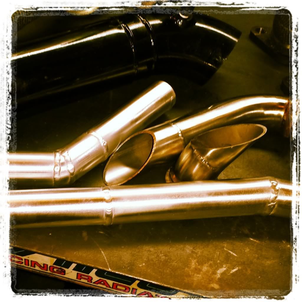

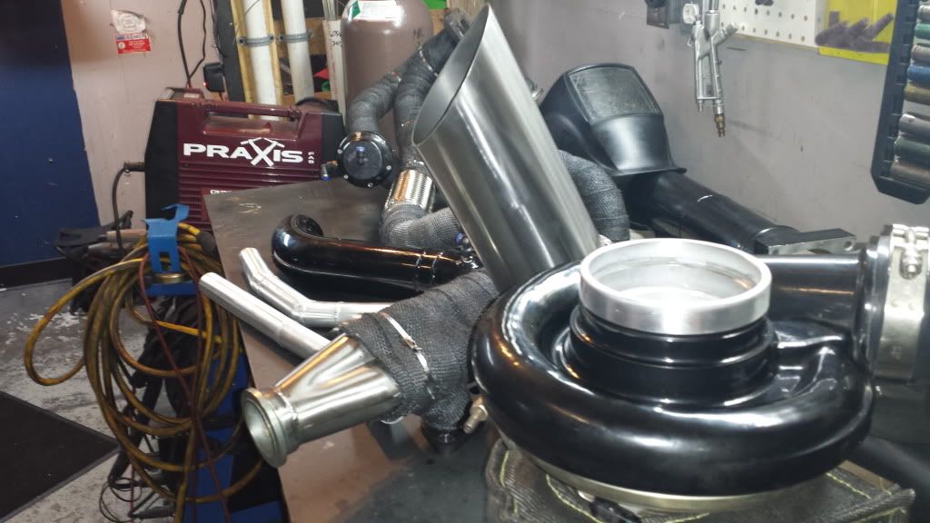

Also got the downpipe done.
Posted Image
Posted Image

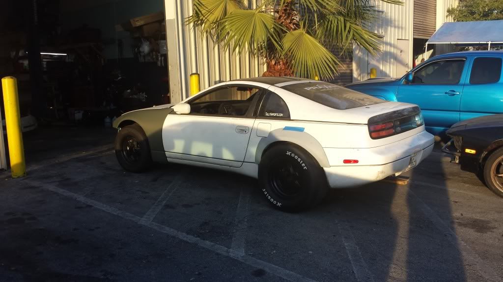

And here is how she sits right now.
[IMG]http://i63.photobucket.com/albums/h124/twinturboz161/IMAG0547.jpg[/IMG]
[IMG]http://i63.photobucket.com/albums/h124/twinturboz161/IMAG0548.jpg[/IMG]
[IMG]http://i63.photobucket.com/albums/h124/twinturboz161/IMAG0549.jpg[/IMG]
[IMG]http://i63.photobucket.com/albums/h124/twinturboz161/IMAG0550.jpg[/IMG]
[IMG]http://i63.photobucket.com/albums/h124/twinturboz161/IMAG0551.jpg[/IMG]

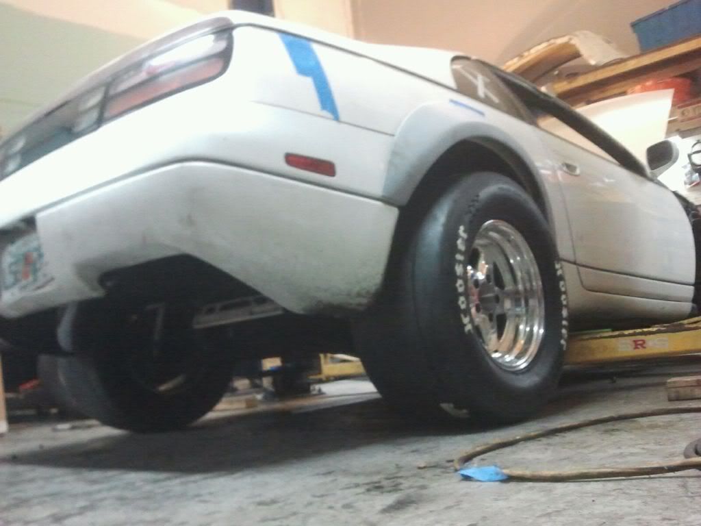

Posted 03 October 2013 - 09:13 AM
Wow been a long time since I updated here. I'm going to skip over all the boring stuff cause I have big updates :D
And how she sits now:
AND SHE RUNS!!!
http://s63.photobuck...2d4a0b.mp4.html

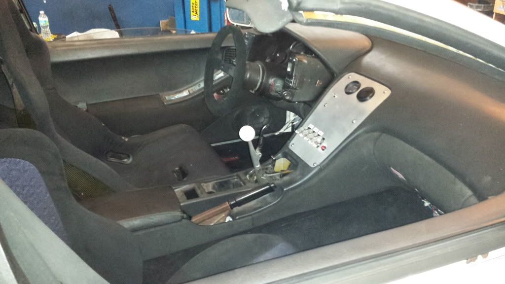

Posted 23 October 2013 - 05:38 AM

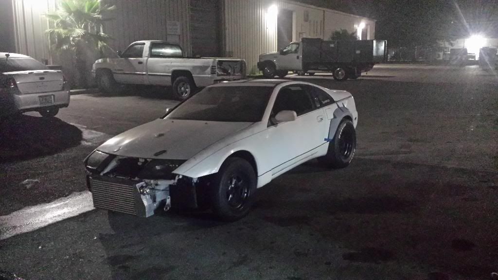

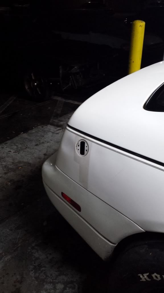

Little cutting here and there

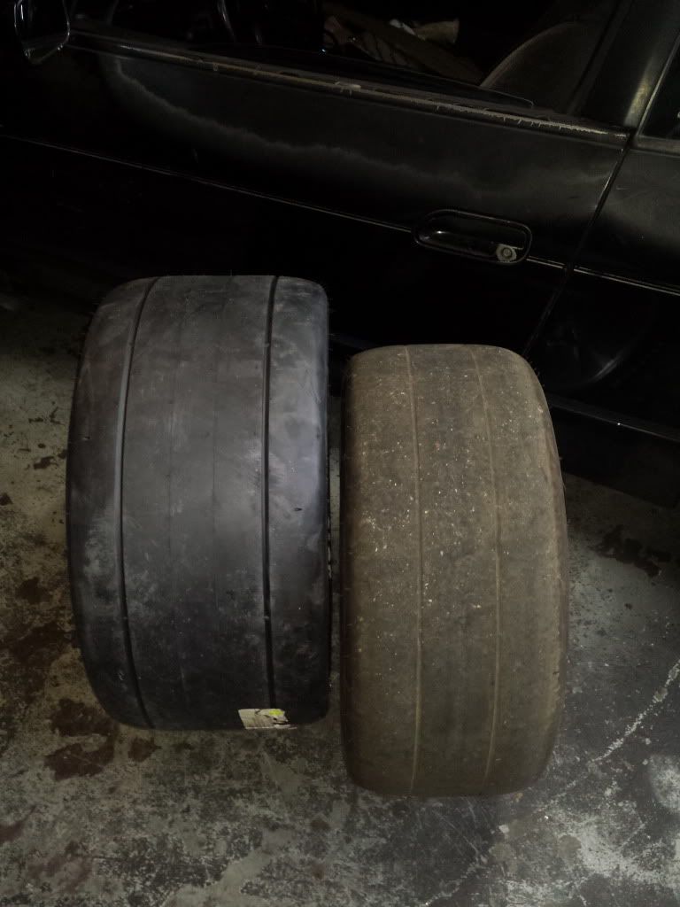

Posted 30 October 2013 - 10:38 AM

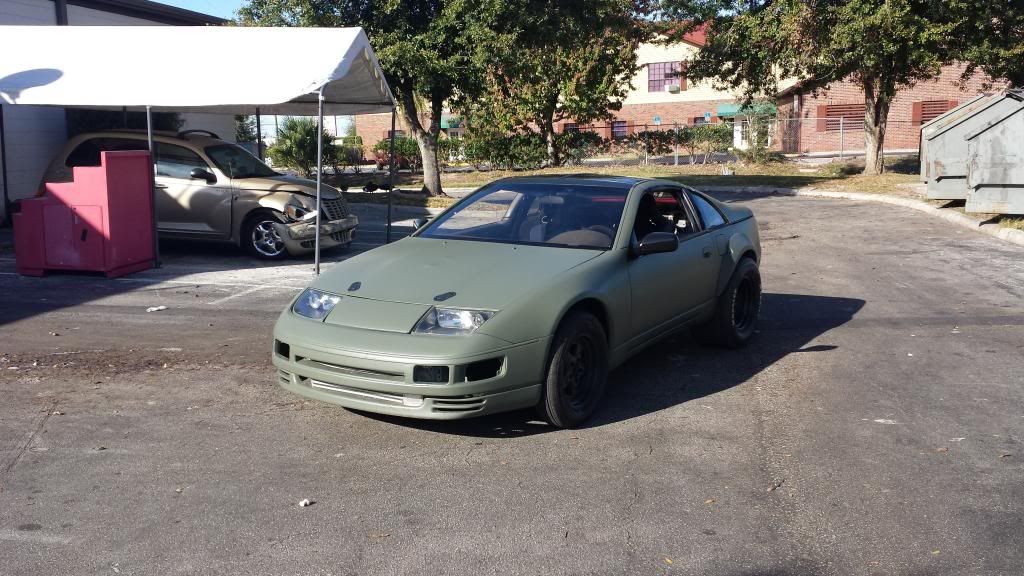

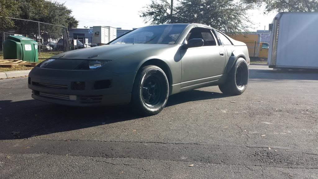

I then wet sanded the whole car, it was disgustingly dirty. Here is a before/after.

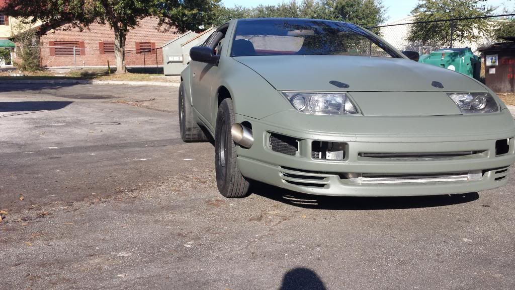

  • Members
  • PipPip
  • 36 posts
  • LocationTallahassee, Fl
Posted 30 January 2014 - 06:16 AM

#40 thatrutse
thatrutse
    Newbie
  • Members
  • Pip
  • 1 posts
  • Locationnorthcarolina
Posted 29 November 2016 - 06:26 PM
heat heat heat. thats a huge turbo hanging in front of the water pipes and the timing belt. awesome build tho just dont like the turbo placement.
