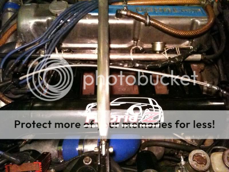

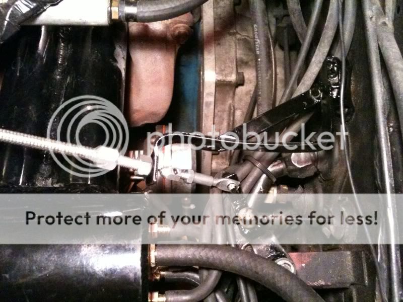

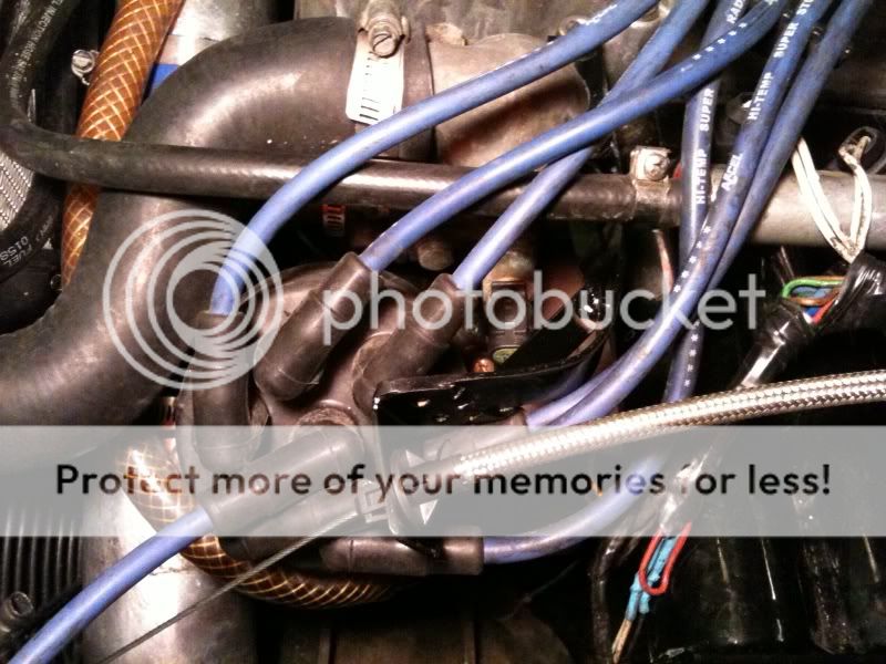

Yeah boosted it for just a bit a couple times and it was pretty much the same. I'm having a crazy time fabbing my throttle cable and it was not getting full throttle. I'm going to try to do the head today?? Still working on brackets for the throttle cable. I just got home so i'm heading out to work on it now.
yup, oh my back is killing me! Bent over that this for too long. I just want this done, I'm going to try to clean up the brackets or do them again with the head change. Fitting, cutting, fitting, bending, all took the toll and they look pretty bad I think.
What a nightmare of fitting, refitting, cutting, welding, and trying to be careful of my paint.
Just on the other side of the fire wall you could eliminate the last rod piece and connect the cable directly to the pedal assy. That might simplify things. As far as brackets go, I think they look fine. You can always redo them later (after you get it running) and you see if there are any changes or tweaks you'll need to the design.
Phil, I would really try to ditch the linkage altogether. I did that over 1.5 years ago and it makes a world of difference for low speed driveability. The linkage used to stick even though I took it apart, cleaned and greased it.

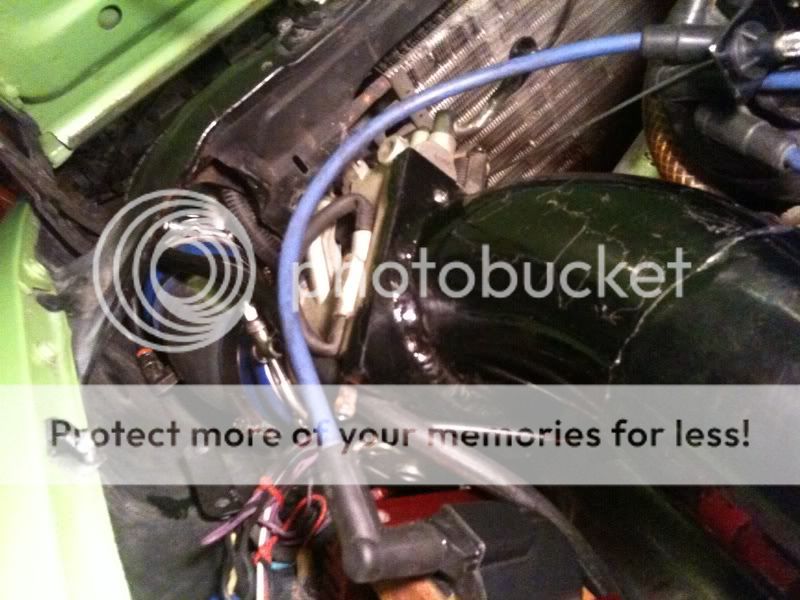

It took allot of work to make it bolt to the motor. Lots of grinding just to clear the stock manifold. And the TB is very tight to the firewall and radiator. Now that its on I like it!
