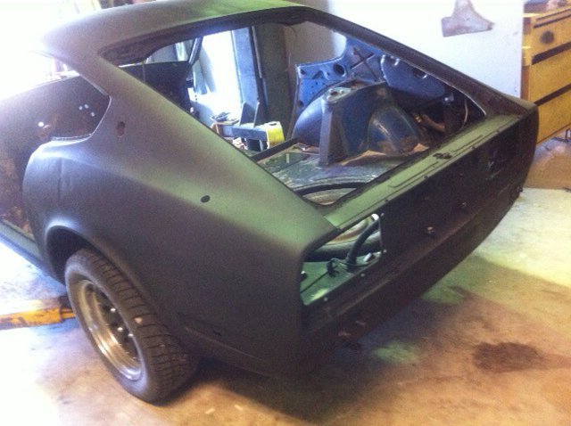

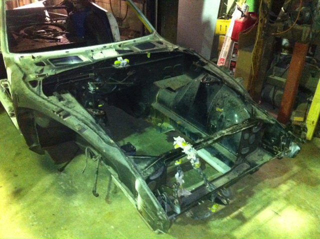

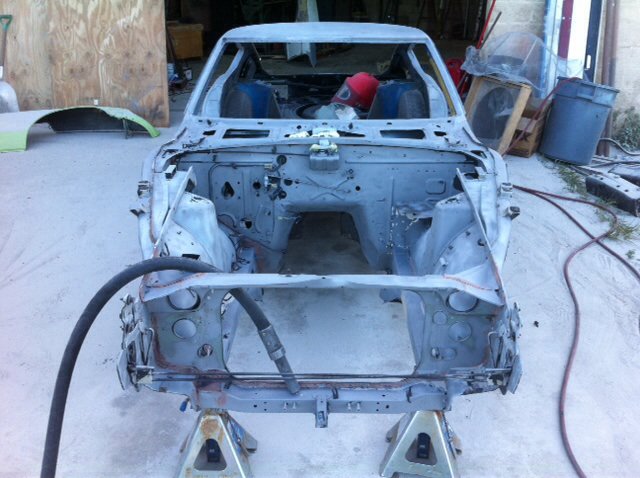

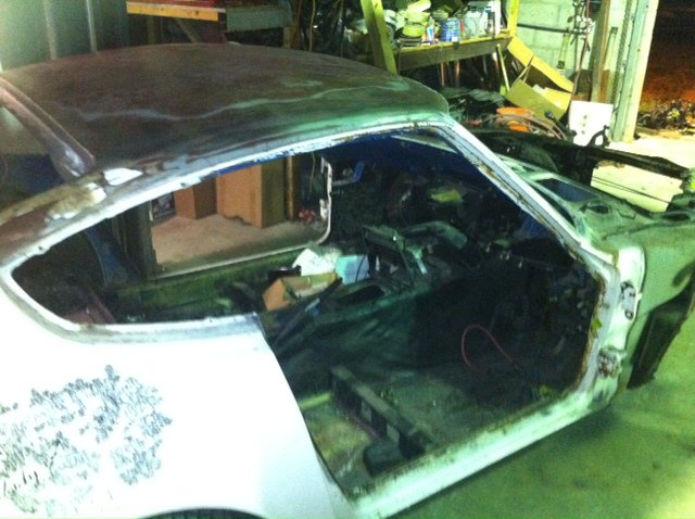

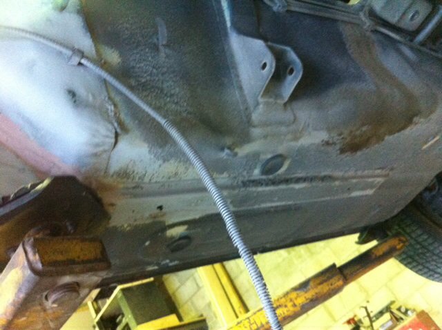

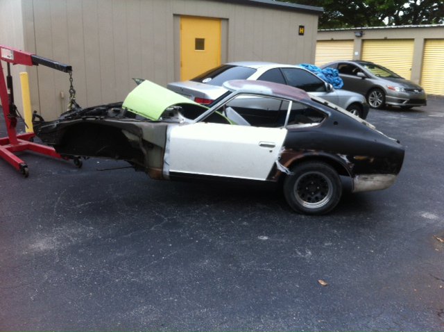

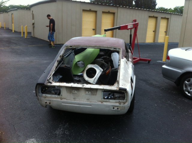

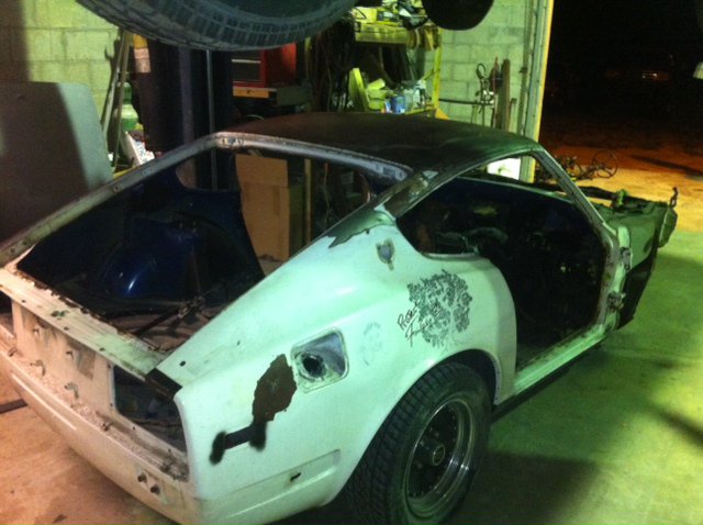

Posted 08 September 2013 - 08:14 PM
Back from the dead!!!!! I should switch the name of this thread to the zombie build, haha.
ANYWHO... Its pretty much been a year since my last post, buttttttt i do have some updates  :icon10:

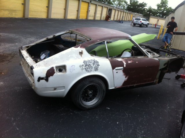

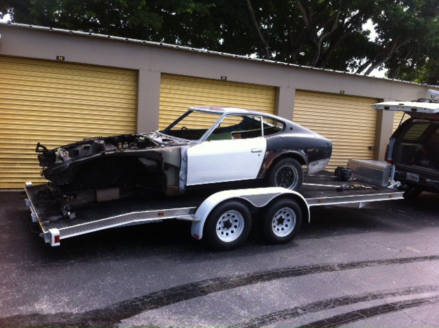

I had to downsize my work space to a one car unit, so i figured this would be a good time to start working on her again.

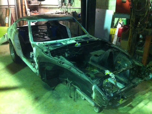

My Fairlady as i moved her to her new home
Attached File  update1.jpg   122.38KB   1 downloads
Attached File  update2.jpg   115.89KB   0 downloads
Attached File  update3.jpg   120.53KB   0 downloads

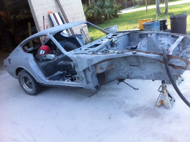

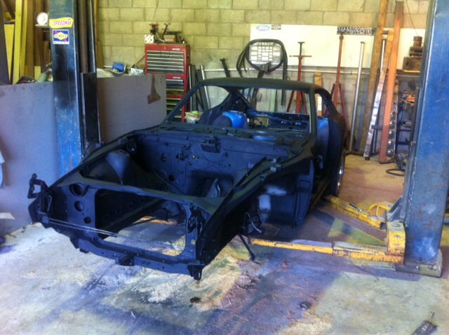

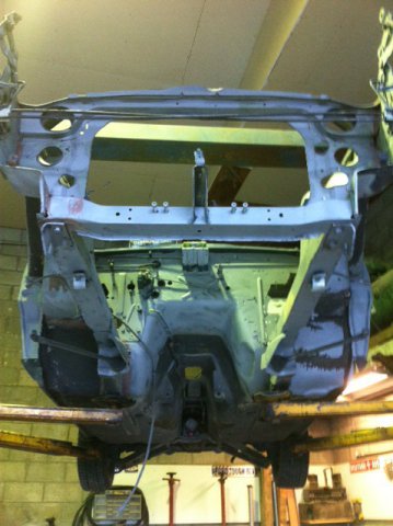

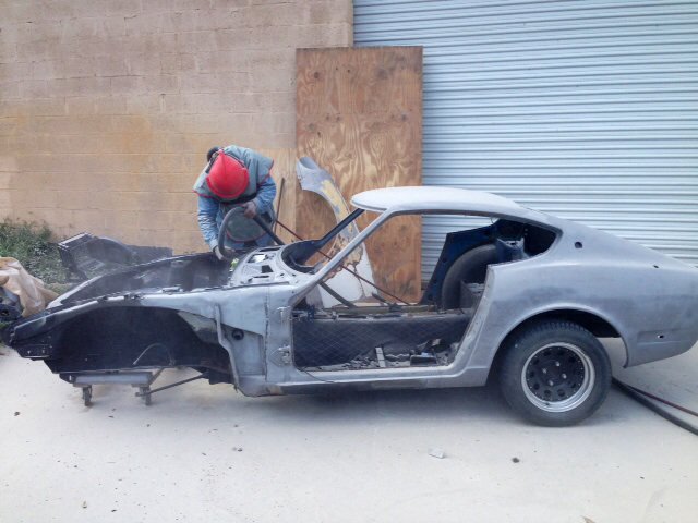

After accommodating her into the new space it was time to decide my next move. The following morning i started calling around getting qoutes for sandblasting, i found a guy, talked some numbers and struck a deal!  :icon54:
On her way to get stripped
Attached File  update4.jpg   147.14KB   2 downloads

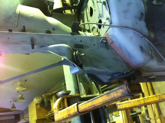

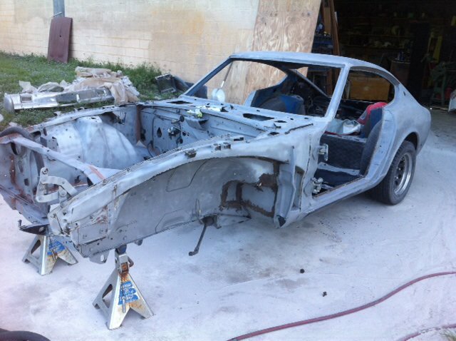

Turns out i still had a lot more things in the engine bay than i thought, so i headed to the sandblsters and got to work on pulling EVERYTHiNG that i could remove. This included booster, master, clutcth matser, steering, harnesses, brake lines, fuel lines... yeah, pretty much everything.
I will be either overhauling and refurbishing the booster and master or just ugrading to new & better parts. We'll see what my pockets allow.

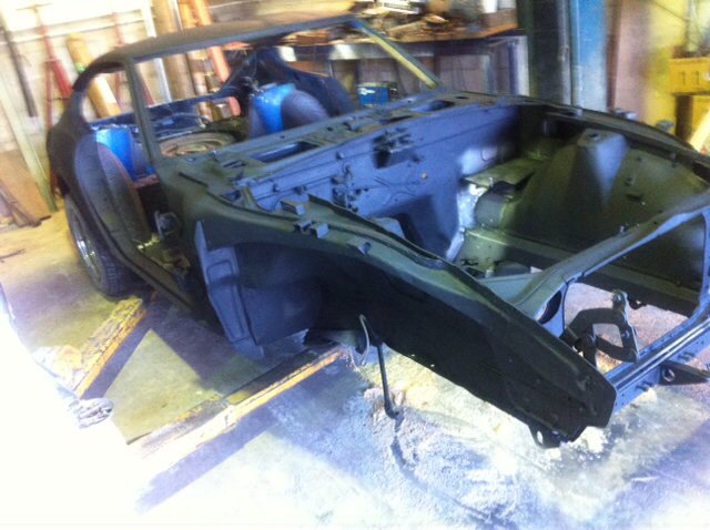

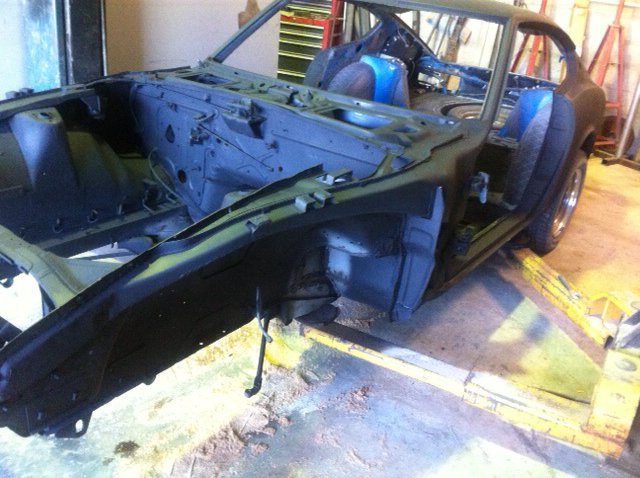

Here's the bay stripped of all its guts
Attached File  update5.jpg   133.24KB   0 downloads
Attached File  update6.jpg   150.51KB   0 downloads

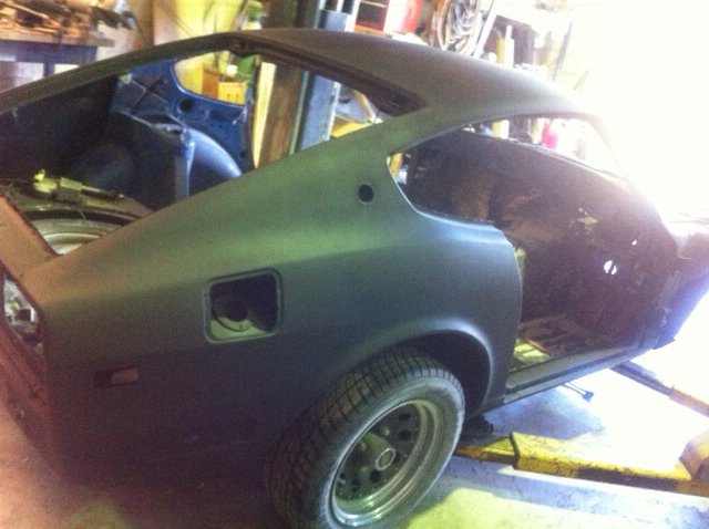

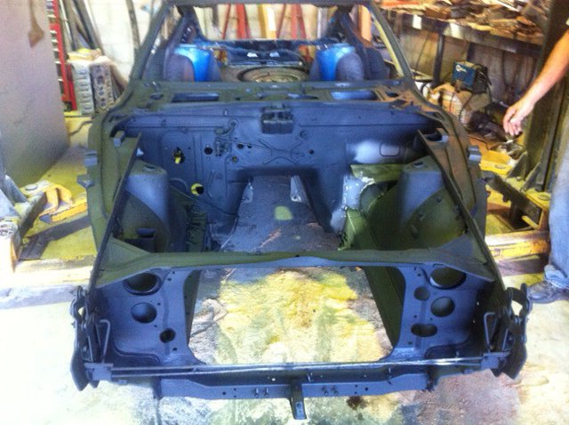

After finishing with the bay i went ahead and removed the doors for complete teardown & removed all remaining interior.
Attached File  update7.jpg   121.48KB   0 downloads
Attached File  update8.jpg   133.51KB   0 downloads
Attached File  update9.jpg   139.93KB   0 downloads
Well, thats it for now. She should be fully sandblasted and primered by tuesday so stay tuned for updates from here on out!  :cool:

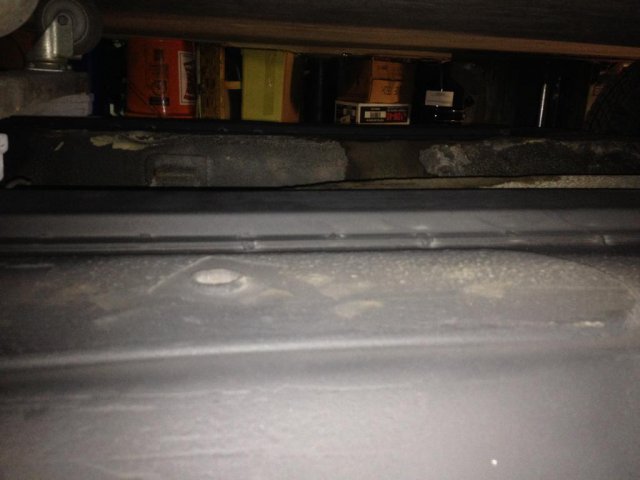

Posted 05 January 2014 - 07:12 PM
Alright, so picking up where I left off even though I'm not sure anyone keeps up with this thread. Here she is while she was being stripped.
Attached File  image.jpg   103.68KB   1 downloads
Attached File  image.jpg   121.22KB   0 downloads
Attached File  image.jpg   118.68KB   0 downloads
Attached File  image.jpg   116.27KB   1 downloads

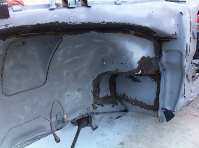

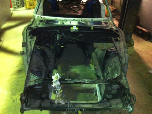

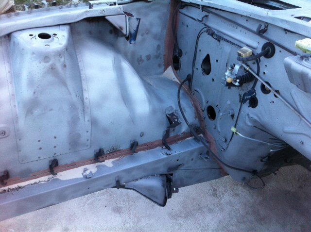

Finally and very long overdue she is down to her original state
Driver side wheel well and frame rail were perfect, actually there were no surprises period on the whole car.
Attached File  image.jpg   82.47KB   2 downloads
Attached File  image.jpg   115.13KB   0 downloads
Attached File  image.jpg   111.63KB   0 downloads
Attached File  image.jpg   116.05KB   2 downloads
Attached File  image.jpg   111.86KB   0 downloads

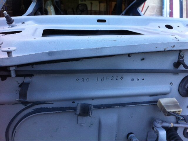

Gotta love the short vin.
Attached File  image.jpg   94.28KB   1 downloads

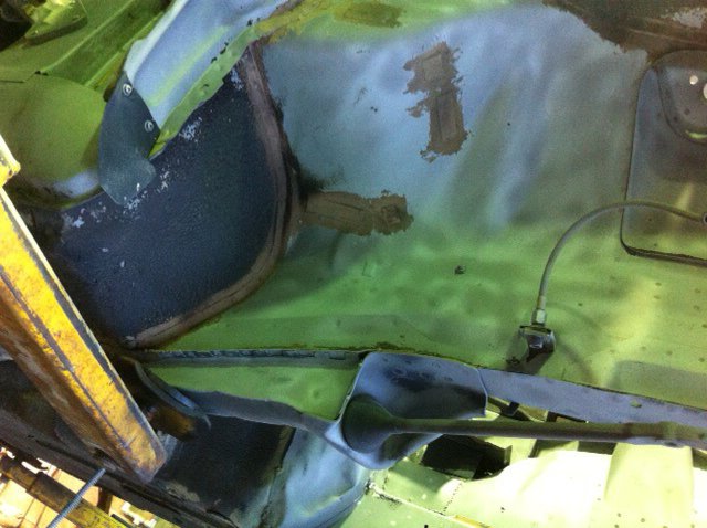

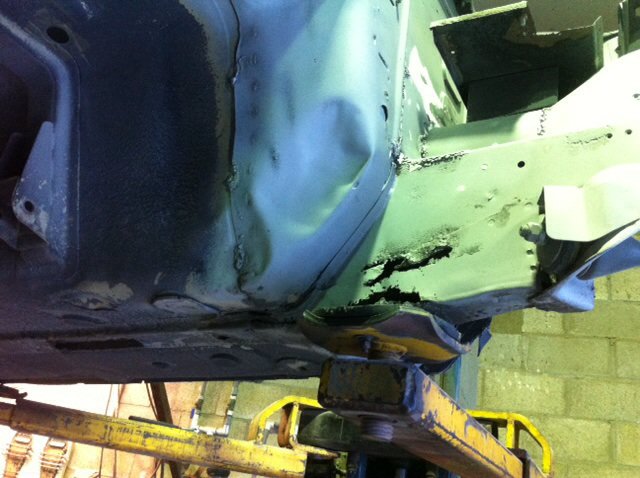

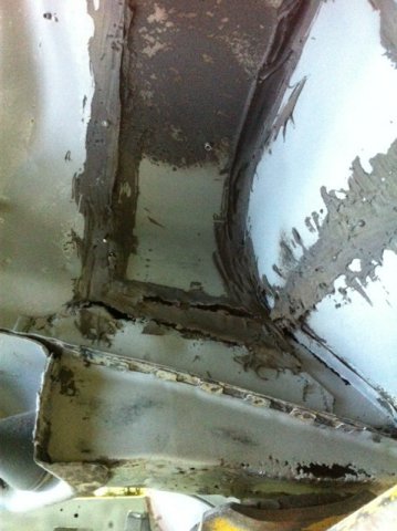

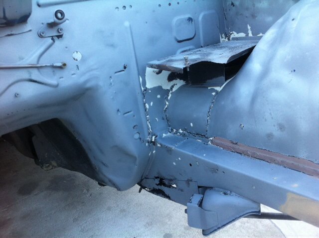

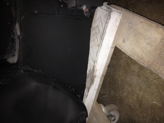

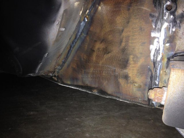

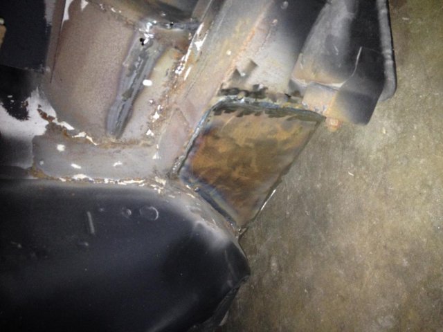

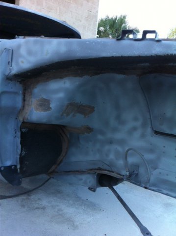

Now onto the passenger side (battery side) there are some issues from leaking battery acid.. Nothing to crazy though floors are still solid.
Attached File  image.jpg   97.45KB   0 downloads
Attached File  image.jpg   95.88KB   1 downloads
Attached File  image.jpg   115.27KB   0 downloads
Attached File  image.jpg   113.52KB   0 downloads
Attached File  image.jpg   119.22KB   0 downloads
Attached File  image.jpg   116.33KB   0 downloads
And then on went three coats of epoxy primer.
Attached File  image.jpg   128.4KB   0 downloads
Attached File  image.jpg   115.33KB   1 downloads
Attached File  image.jpg   124.21KB   0 downloads
Attached File  image.jpg   102.4KB   0 downloads
Attached File  image.jpg   97.27KB   1 downloads
Attached File  image.jpg   96.11KB   0 downloads
Attached File  image.jpg   123.29KB   0 downloads
Well that's it for today, I'll try and update more within the week.

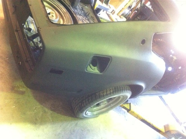

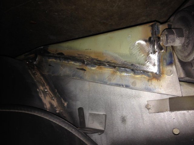

Posted 07 January 2014 - 08:56 PM

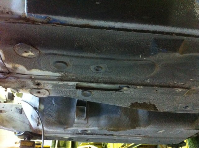

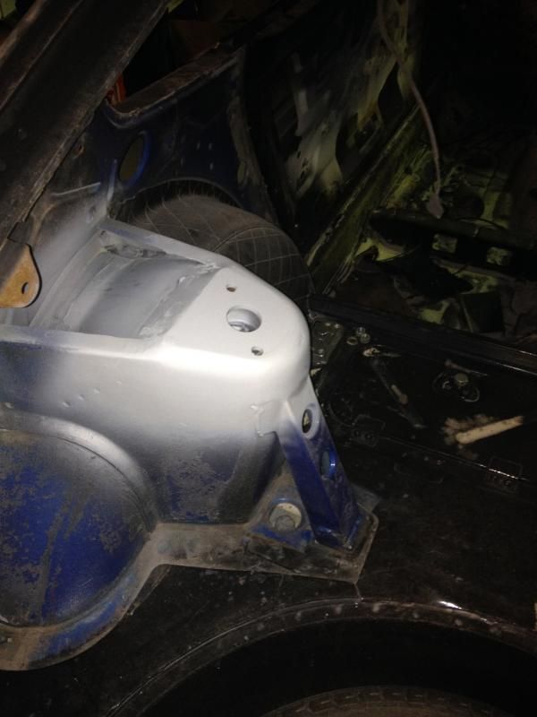

Glad to see people are still watching! Here are some more updates as promised. Installed the bad dog frame rails and repaired all the nasty rust from the leaking battery acid.
Attached File  image.jpg   86.47KB   1 downloads
Attached File  image.jpg   91.65KB   0 downloads
Attached File  image.jpg   75.77KB   0 downloads
Sandblasted all bare areas (didn't get pictures) and then hit em with primer.
Attached File  image.jpg   41.04KB   1 downloads
Attached File  image.jpg   70.68KB   0 downloads
Attached File  image.jpg   63.12KB   2 downloads
Finally the car is fully rust free! 😄

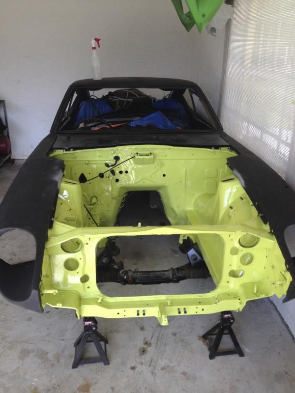

Okay, so the next thing on my to do list now that all rust has been removed was welding in the front camber plates and rear adapter plates for the coilovers. I didn't take any picture of them with just welds but they weren't anything beautiful to show off anyway, just functional. I ground down all the welds on all four strut towers and applied the first coat of filler to start the Beautifying process. I used a product that is called "Carbo-fil" that was recommended to me by the sandblaster. Really like this stuff, dries like metal!
Here they are with the first coat of carbo-fil applied and some primer so the bare spots wouldn't corrode before i got around to finishing it.
At this point months passed before i worked on here again. Actually all the following work i did in 2 days before leaving to china, decided i wanted to make a good push before she sat for a year.
After relocating her to my brothers garage for storage i decided i was gonna fully prep my engine bay and paint it before leaving, I had already decided on a color so i got straight to work.
This process took a FULL days worth of work, in just prepping. I'm pretty anal so my main concern was making those towers look as smooth as possible. But I'm happy to say I think i accomplished the finish i was going for.
The following morning i prepped the rest of the bay. (yes i really spent an entire day on just the strut towers)
And Then it was time to start laying down base color...
NOW i know this color will cause controversy, some will hate it some will love it (at the time i loved it, I'll go more into that in a bit)
112 Lime Yellow =D
You guys have no idea how good it felt to finally be getting ready to lay down some paint on my z after all this time of her sitting around with no progress. I was like a fat kid at a candy store that was left unattended, happy.
Base coat on! =)
I gave her three coats of base, then it was time for the fun part to start..
Time to give this color some life. CLEAR COAT! (also three coats)
Not too shabby for a self taught hobbiest
And then here's my pride and joy. I'm very pleased with how smooth these towers came out, shows that prep is everything. That long day was definitely worth it.
Gotta have cool angle shots =)
Sorry for the excessive engine bay pics, but i was very pleased with the outcome so i went picture crazy.
After everything dried we made room for her in the garage and i started tacking the front back on to save space while she's stored.
Removed all the tape, and reinstalled the crossmember (which my very supportive gf painted black for me while i was doing the bay)
Then me and my brother CAREFULLY mounted the L swap back in place, again to save room.
And this is how and where she will sit until i get back to the states.
NOW my dilemma... There's always a dilemma.
I choose this color because I've always loved it (and still do) but at this point i was planning on staying stock fenders, without running flares since everyone is always busting my balls about cutting up the rear fenders on an original Fairlady. But while I've been here I've had a lot of time to think of what i really want out of the car, and fact is i want it to be wide, and i want at least 10 inch wheels on the rear. At the end of the day its my car, my build and although people may not like me cutting up the fenders, thats not my concern because i have no intentions on selling it so i have to build it to my liking. At this point I'm sold on flares, problem is i don't think this color will flow good with flares...
Let me know what you guys think, but i just don't think it'll work.
So as of right now I'm considering going with another color that was a possibility before i decided on the 112 lime yellow.
BUT i am open to suggestions, Oh and one more thing. I also plan to use a gnose..  So gnose and flares in 112 yellow? Maybe two tone with dirty silver? I don't know opinions appreciated good or bad!
Well i hope you guys enjoy the update, and I'm super excited to get back home and start making progress again.

For example if you look closely I don't believe that orange z with the gnose and flares has the wheel arches cut. And still has wider wheels on it...

Yeah, his flares are uncut, but the drawback is that your car will always look a bit like a 4x4 if you don't want it to rub. Easier to leave them uncut, than to cut them, and then decide to go back though. Do you have pics of the works flares? If they're the ones I'm thinking of, I think they're a bit overkill.
I suggested orange since it seems like you want a fairly loud color. I don't know what you have in mind, but I think 907 green, 901 silver, or the burgandy color that came on the factory 240ZGs would all be good choices if you decide against 112 yellow. You should be able to fit a 10" wheel under a standard ZG flare with the right offset. If that isn't wide enough there's wide ZG flares too.
Anywho, more pics. #1, I believe these are wide ZG rear flares. #2, 112 Yellow, with gray/gunmetal bumpers, to give you an idea of how the two colors look against each other. More here http://inzane240.blogspot.com/

Actually, I'm not looking for anything loud color wise.. I guess i could see how it'd come off that way with the lime yellow haha, i thought 112 lime yellow would be a little softer, but maybe i was thinking of 919 yellow. I'm a big fan of the Pastel like vintage looking colors, I will have to decide about the flares. Someone should reproduce a panel starting from below the body line And the whole wheel arch area to make a easier repair for the cut quarters. That way it wouldn't be as big of a deal to patch it back up to original if for some reason i had a change of heart years later.
And thanks a lot for all the good feedback rturbo 930, it really helps to toss around other ideas.

It's been 2 years and almost 8 months since Angel updated the status of his Z above. My story involves Angel.
Now I'll tell you my story. First notice my ID here, ZcarS30-00039. The S30-00039 was the VIN of my first Nissan Fairlady Z. Oldest Z I know of. Anyway, she was purchased in Tokyo by a US Air Force officer. He shipped her to the states. Couldn't keep her so was going to trade her in on a Datsun in early 1970. The dealer couldn't accept the trade-in (no smog BS), so a salesman at the dealer bought the Z and put it on the market. This was when there was a months long waiting list for a Z. Anyway I saw and add in the paper for a Fairlady Z. Doubtful then anyone even knew a Firlady was the Japanese version of the 240. I did because I was telling a fellow I worked with how much I wanted a 240Z, but he had no idea what it was. One day we saw one on the street as we were driving around Miami. I told him that's a 240Z. He said, no. He said when he was just in Japan, they were a Fairlady Z.
Anyway, I contacted the fellow in the ad and got my Z without a wait, although used a bit. I had it until 1992 when hurricane andrew dumped half a pine forest on her. We got the trees off, but she was about a foot and a half tall. :( Also at this time the therre were hundreds of abandoned cars in Dade County. The county as well as scrappers were picking them all up. I didn't know it was gone till I got back from a long trip tp Ohio. Zero luck finding out what happened to her.
That's the front story, except I still missed my Z. Flash forward to 2001. I see on the internet a '73 Fairlady Z for sale in Texas. After some work, a trip to Texas, and some money exchanged, said Z arrived at my home on a transport truck. Loved that car. I was SLOWLY working on getting it back to as stock as possible.
Then I discovered my love of Harley's outweighed my love of that Z, Kids were grown and lots of free time to ride with the wife. The Z was eventually relegated to not being garaged. Hated that, but that's the way it was. Now I wish it hadn't been, but that was then and now is now.
Well, I wanted to sell her, but not to just anybody. One day I was contacted by this young fellow named Angel. Yes, I am the old dude he first mentioned and his story about his buying the Z is spot on! Well one thing isn't really true. The part about getting in and out was really true. I think we both loved the car so much that I concocted that story to cover my crime of allowing a Harley to push it outside!
I've been in contact with him since, very OFF and on. The last I had seen of the Z was on it's way to be blasted.
He just told me today about this site, so here I am. My thoughts on the Z. I hope he does not cut up the body and goes with orange which he said was one of the colors he was thinking about. The reason, my original "00039" Z ended it's days being orange. Miami to West Palm, less than a couple of hours. I need a road trip, I think!
If you got this far, thanks for reading and I, more than anyone here, including Angel, NEEDS to see the Nissan Fairlady Z looking beautiful and back on the road!!! Take care...Bob
