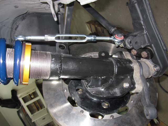

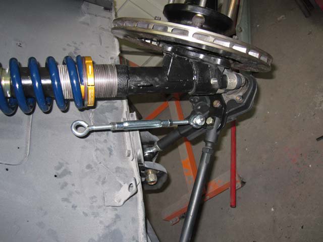

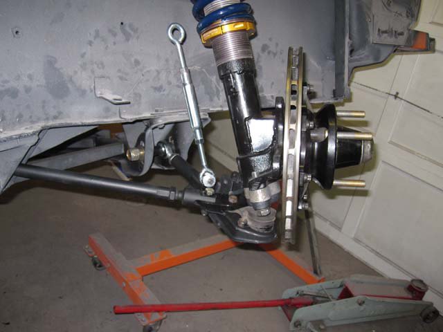

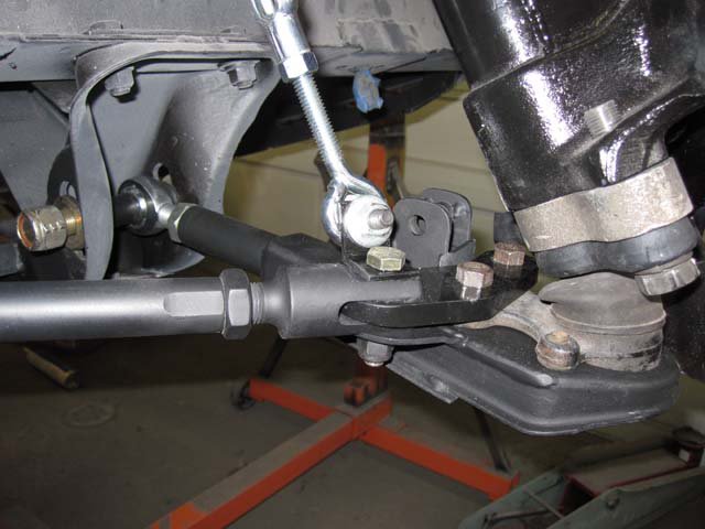

Working on final assembly of my suspension and realized that I never got around to making droop limiters. I had purchased some small, lightweight cable and a couple ends, but it turned out that in order to get all the parts I would spend about $40 per corner just for the fittings. Cary suggested that I use tailgate stay cables that you find in the Help! section of the auto parts store. Then I was left looking for turnbuckles. Looking at mcmaster.com it seems about the cheapest you can find is in the $15 each range for something that would work with the relatively large cables, so I wanted to find something cheaper. Went to buy some hardware at Tacoma screw and they had some cheap 5/16" thread turnbuckles for $2 each. I figure I'll have about $15 per corner into the whole thing at this cost. Starting in the front I took a piece of angle stock and drilled it to attach to the TC rod and to the eyelet on the turnbuckle. I had to bend the angle iron so that the turnbuckle didn't interfere with the strut. I really don't like this long, heavy turnbuckle, but I'm more interested in getting the thing running, I can always redo this later. I did check for clearance with the caliper and also the wheel, and looks like it is OK. I'm a bit concerned that the turnbuckle may hit the inner fender well at full compression, I may have to pull the spring off to check that out.

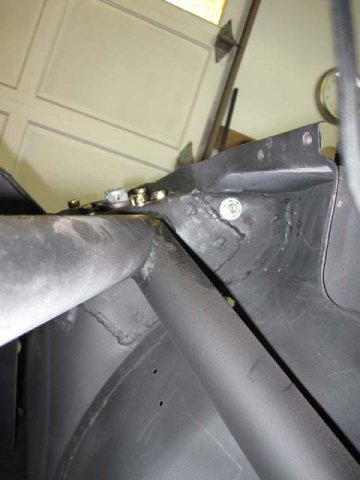

Put the whole droop limiter together and found that the limiter had to bend inward to clear the inner fender well/strut area. Bent it to clear and now there is about 1/4" between the bolt and the coilover adjuster. I can flip the bolt around and get maybe 1/2", but it's still looking pretty tight. Anchored the cables at the top as far inward of the camber plate as possible, just to alleviate any issues with adjusting the plate into the cable.
I'm thinking a slightly longer cable would work, there is still plenty of adjustment in the turnbuckle, so I could probably get a cable that is an inch or two longer. At this point I have to compress the suspension a bit just to fit everything together, but I don't think I'm going to be running the coilovers way up at the top of their adjustment so I don't anticipate this being a problem.

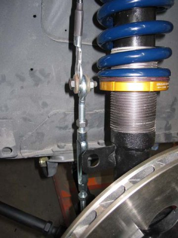

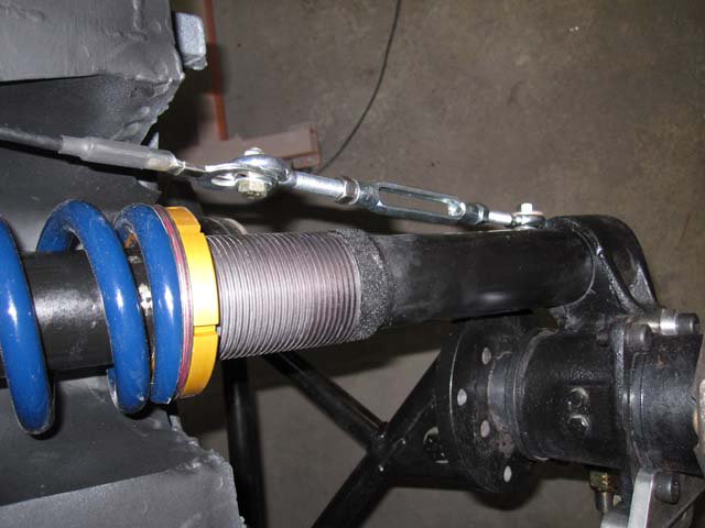

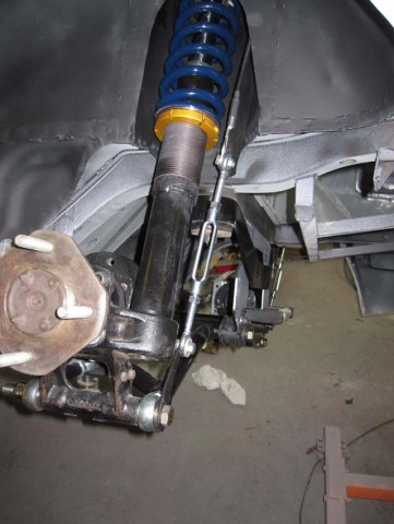

Did the rears today. The cables were a bit short so I made my bracket a bit longer and put a couple holes in it for adjustment. I wanted to do the cable to a bracket attaching to the ebrake cable holder bolts on the strut housing, but that looked like it was going to be really close to the CV adapters, so I did it to the spindle pin instead.
All I have to say is thank you to whoever invented the step drill. Drilling a 5.8" hole in sheet metal with a standard bit or a hole saw is such a pain, and with the step drill it was so easy.
Pics:
Make sure the limiters don't interfere with the brake lines and find some way of keeping the turnbuckle from rattling around of they loosen a bit. Looks like it should work just fine.
Not sure how I would keep them from rattling. I suppose a zip tie through the upper eyelet and around the strut maybe? I did grind the ends of the turnbuckle flat so that the jam nuts could get a better purchase. Hope that's enough.

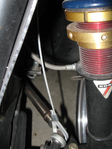

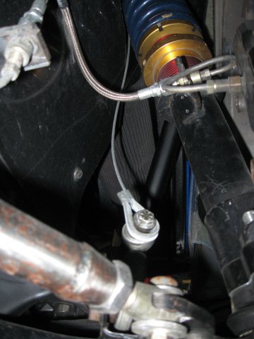

My front suspension is droop limited using cables, but only to the point that the front springs are at their free length when the cables are taut. To make mine, I attached a 1/4" clevis yoke to the top of the strut tower inboard and forward of the upper spring seat, and connected this clevis to a sway bar end link using a 1/8" cable and thimbles. I've attached some low quality pictures that show the set-up with the car at ride height (slop in the cable). These cables are not as close as they look to the brake lines. In two years of autocrossing with these cables installed, I have seen no evidence of contact.

I wouldn't be as worried about cables. The turn buckles kinda (a little bit) worried me on Jon's setup.
If they're close I may just do something else entirely. I don't think I can flip the whole assembly, but I might be able to figure out my small cable with adjusters, which would be more like Dan's but with a smaller turnbuckle.

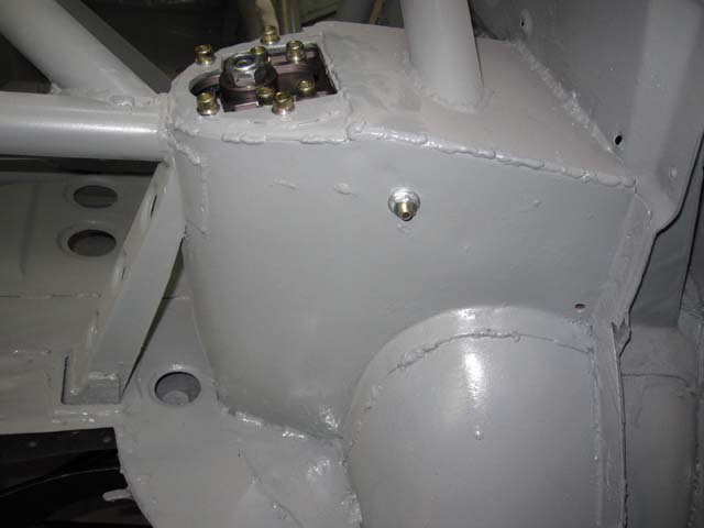

I have my limiters attached to the chassis through the thicker steel at the top of the strut tower (you can see it if you look from underneath), as far from the camber plate as I could get it.

Question Jon, in this picture is the suspension compressed at it's normal ride height?
The reason I ask is because at full bump what prevents the turn buckle from rotating outward and contacting the tire? Or is it not going to compress enough to matter?
The bracket doesn't rotate on the spindle pin.I don't know exactly what ride height will be, but I imagine it would be an inch or two lower than what's in the picture. Probably will depend mostly on the rear roll center height.
Edited by JMortensen
Mine were flipped, turnbuckle mounted on top so it wouldn't move and the cable on the bottom. Nothing ever showed signs of touching anything rotating.
