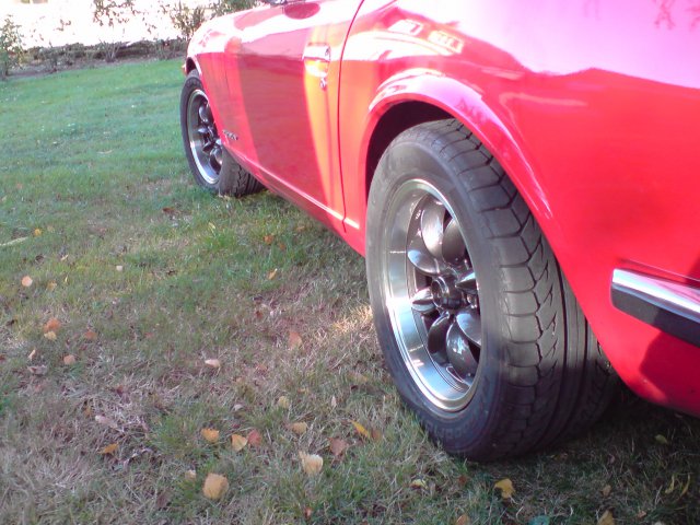

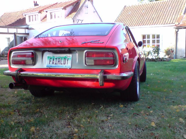

Another feedback:
I run 225/50-15 with 15x7 ET04 wheels (Rota RB) with no problem. ET0 would even be better since I'm very close to the strut.
The clearance would come with my setup from the tires, not the wheels. So you also have to ask which tire brand you'd like ;)
As fas as I'm concerned, I run BF Goodridge G-Force and they fit. I've discussed with other members having Falken 512 with no problem either.
If you check on tirerack, you'll see that same reference on tire does not always mean same exact size wink.gif
Regarding suspension setup, I run eibach lowering spring with tokico struts.
Here's couple of shots showing you the fit.
I don't have any picture from the back side but there's roughtly 5mm of clearance between the strut and the tire. It never rubbs but it is close... I'm checking regularly to make sure

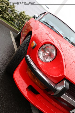

Here is the look I would like for my 240Z.

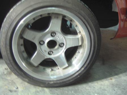

And those are the wheel I'll use. Those are ROH.

I think you should be fine with a 15x8, 50 series tire will leave more room for movement when cornering.
By the way, those look like the 15x8 (-9 offset) Performance Challenger wheels on that red Zed, does anyone know where you can purchase these or know anyone who might be selling?
