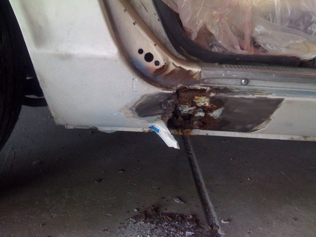

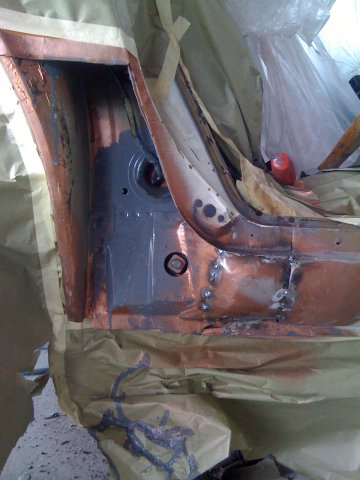

I replaced the rocker panel end only. What I did was clean off the paint where the spot welds would be. Then took a grinding wheel and grinded through the metal till the weld broke, and that way I didn't put a hole in the bottom metal. After everything was off I cleaned up everything to test fit it. It is very important you have the door on when fitting it so the gaps look good. Put some weld-thru primer on it and weld it up. Oh I added por-15 under the panel before I welded it back up. The grey stuff is por 15, and gold is weld thru primer.
I hope this helps somehow.

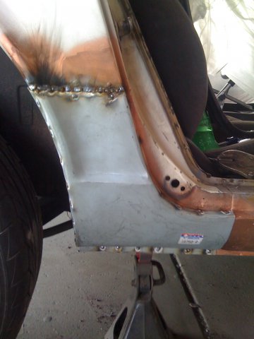

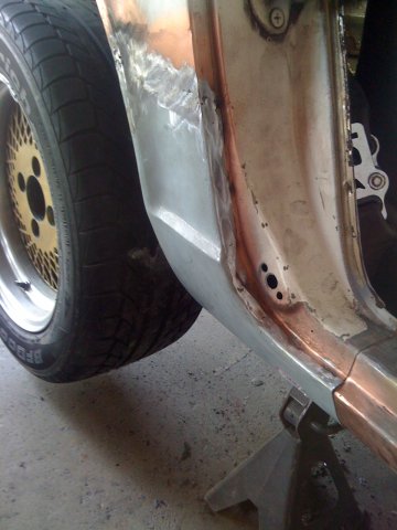

More pictures of rear rocker fix.
Wheelarch: spot weld a piece that is just a little too large, then cut both the new and the old in one cut to get it perfect before welding, same trick with the new TABCO parts, spot weld and cut together with the original material.
Best regards ESS
