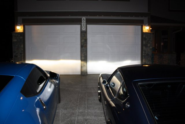

<Photo from FricFrac>
Edited by 240Z_Master
So is that picture you included of your Hellas? If so what's your opinion? I'm looking to purchase a set from the Rallylights too.
That's not my setup, that's FricFrac's setup using Visionxusa VX-7RD housings with HIDs. My recommendation before ordering from Rallylights is calling them to check if they have housings in stock... I ordered mine mid-May and they are back ordered.

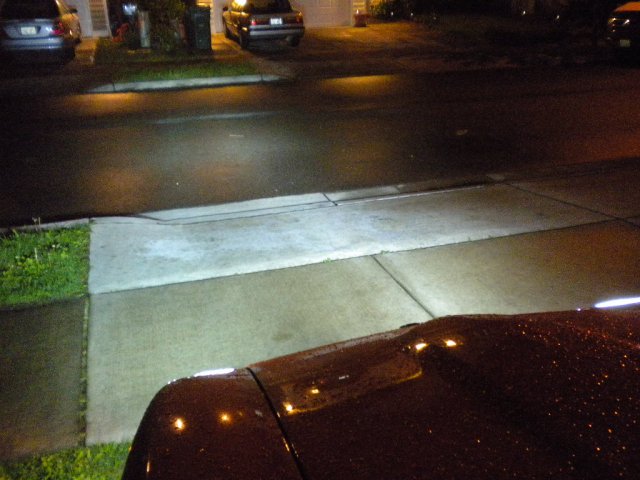

Hella ECE Housing, with step on the right side (for left side driven vehicles)
Re-using my previous H4 Piaa Bulbs, and NOT HIDs (for now... still deciding)
As for a previous picture to compare I didn't take one (doh!)
Low Beam
High Beam
I'll clarify your statement as to 'right drive' and 'left drive' meaning where the car is on the roadway...
The beam pattern you have is Continental (and USA/Canada) meaning for cars intended to be driven on the LEFT side of the road.
Where the driver is seated (RHD or LHD) will not make a difference in beam pattern selection (low beam) as it's road position of the vehicle which will dictate the pattern required.
Nothing like having to pull out perfectly good Koito Housings because they were Right-Drive pattern...
Yeah I was meaning to say Left Hand Drive vehicles... but I just was in a clusterfck for words
