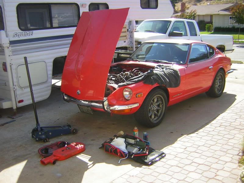

Thanks for the comments guys. I won't be able to do the swap for a few weeks because of prior commitments so I figured I would try to get the stocker L24 going. Turns out I needed to get a new starter because the one that was in it had seized up. After changing the starter with a new one, I go to start it and she cranks over. Problem is I just couldn't get it to start. I glance over at the fuel gauge and it says empty. Duh! So I go get some gas and fill it up. She fires right up but is blowing a lot of white smoke out of the exhaust. I figured what the hey, it's been sitting around for a while maybe it just needs a good run around the block. The white smoke persists, so I may have a blown head gasket on my hands. Might be high time for the swap after all.
So, I pulled the head off after what turned into somewhat of a headache and noticed that I do indeed have a blown head gasket. Good news is that everything else seems to be ok. I snapped a head bolt in the process so I have to go to the junk yard and wrench one out tomorrow morning. Got my hands on a felpro gasket for under $20 today which is nice. Its not the RB25 swap yet, but i need to collect a few parts and put aside some time to get that done. I was hoping to get the L24 cranking so I can use the Z to get around for the time being. Work continues...

Yeah I know haha. When I felt it snap I just sighed and envisioned myself drilling it out and going through that drama. A couple threads were stuck in the head so I had to get a pry bar and man handle it a little bit :rolleyes:
Found a guy on craigslist and was able to get a head bolt. I cleaned the surfaces up a bit and switched the head gasket. All the snapped head bolt took was a swift blow with a hammer and a pair of pliers and it came out. Cranked it over and didn't notice any white smoke this time after revving it up a little. I got to finish putting the exhaust manifold back on and a few other things and I think it should be good to go. After it was all said and done, I have to admit it was a bit of a pain in the ass :lol:

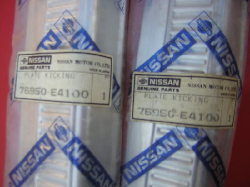

Changed the weatherstripping guard to a brand new one on both sides. I had some sitting in my garage.
Got some brand new kick plates from Nissan today, I got the hook ups from the factory...not ;) They were laying around. I havent installed them yet because the screws are stripped :fmad:
"Plate Kicking" haha
