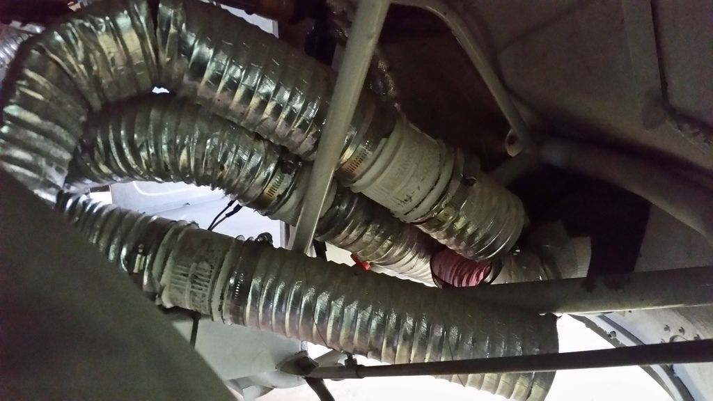

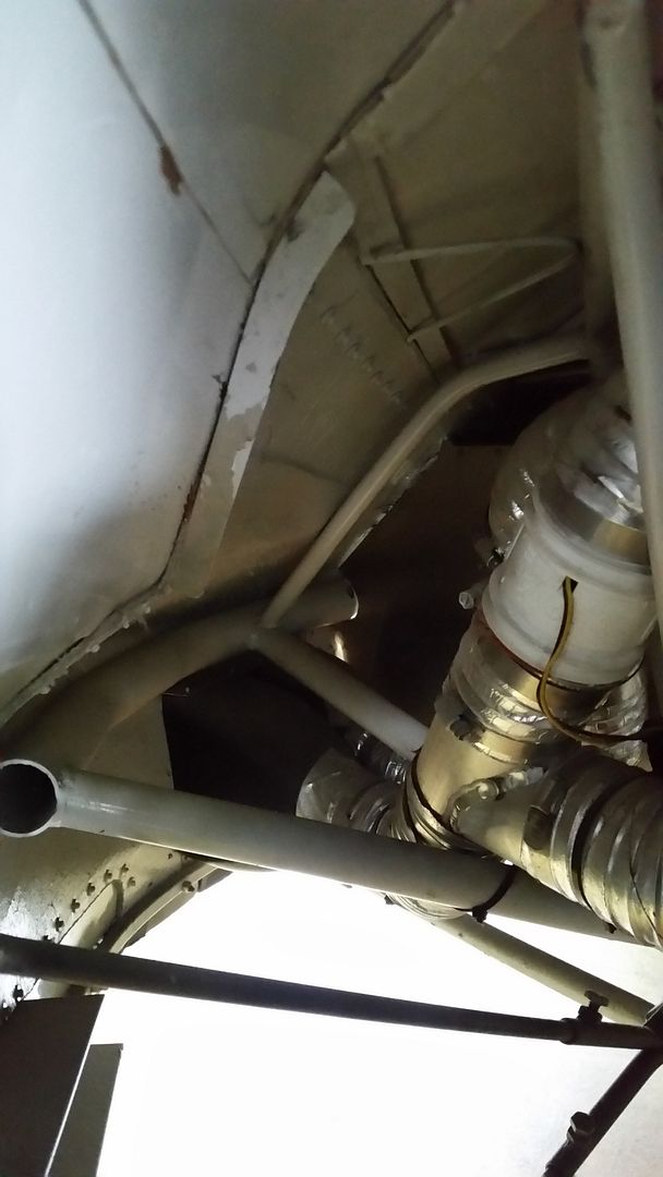

I have a brake vent motor that I used to make a defroster for my Z. I was surprised with how much air it moves. 4 or 6 of them would probably work decently well for keeping underhood temps down.

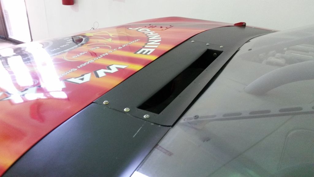

The other option would be to use the airflow around the car with louvers or flaps to get the air out. Louvered hood vents should help a bunch, or since you don't mind cutting holes in the fenderwells you could cut holes behind the radiator on the sides and then use S flaps on the front fenders to pull the hot air out of the rad out to the sides of the car.
