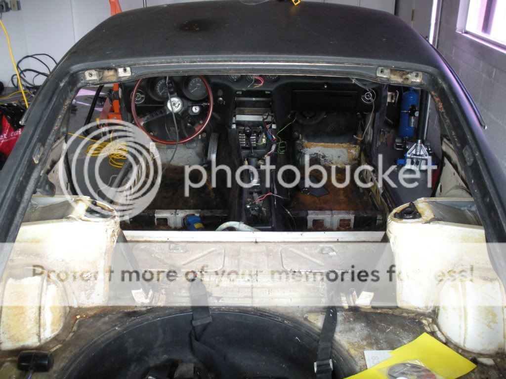

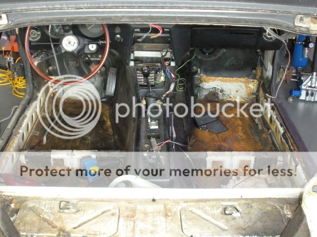

Well, I decided to take some pictures of the progress, and decided while I'm there to start taking a hammer to the spots I suspected of rust, I was give a very good hint by a rebuilder, that if I hit somewhere I suspect of rust the under liner or paint just starts flying off, i'm looking at a heavily rust infested spot.
So I went at it. Under the battery tray (yup), the rusted passenger frame rail (duh), left rocker panel (yup), right rocker panel (yup), right door jam (yup), passenger seat mounts (yup), and then it hit me, most of the rust was on the right side of the car! So I started frantically searching for signs of damage, and I remembered the right and door didn't line up quite right. Low and behold, the actual passenger side frame of the car (the beam that runs along the bottom of the door with the holes in it) had been pushed in about and inch in the middle and about 3 inches up in the front, probably years ago, cracking the protective coatings and exposing the right side components to water far before the left side.
Not sure what to do at this point. Welding in new panels and the frame rail seems like it would be easy enough, but the actual unibody? Where would I even source a beam like that? I shall upload pics when I stop moping around.

Your pics aren't coming through. You can buy the rocker panel from Tabco if I recall. They sell patches for most of the common rust spots on the Z.

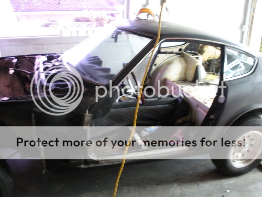

Notice the right side, and use the left side as a comparison. Weird part is, the outside looks really square.

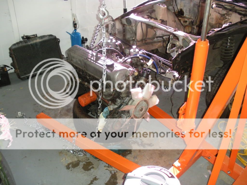

Pulled engine

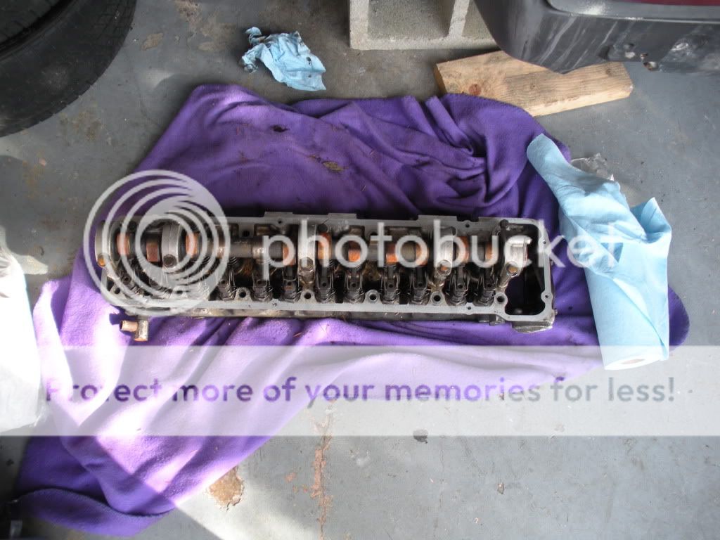

the "new" head, turns out the rust just comes off with some very light rubbing smile.gif
