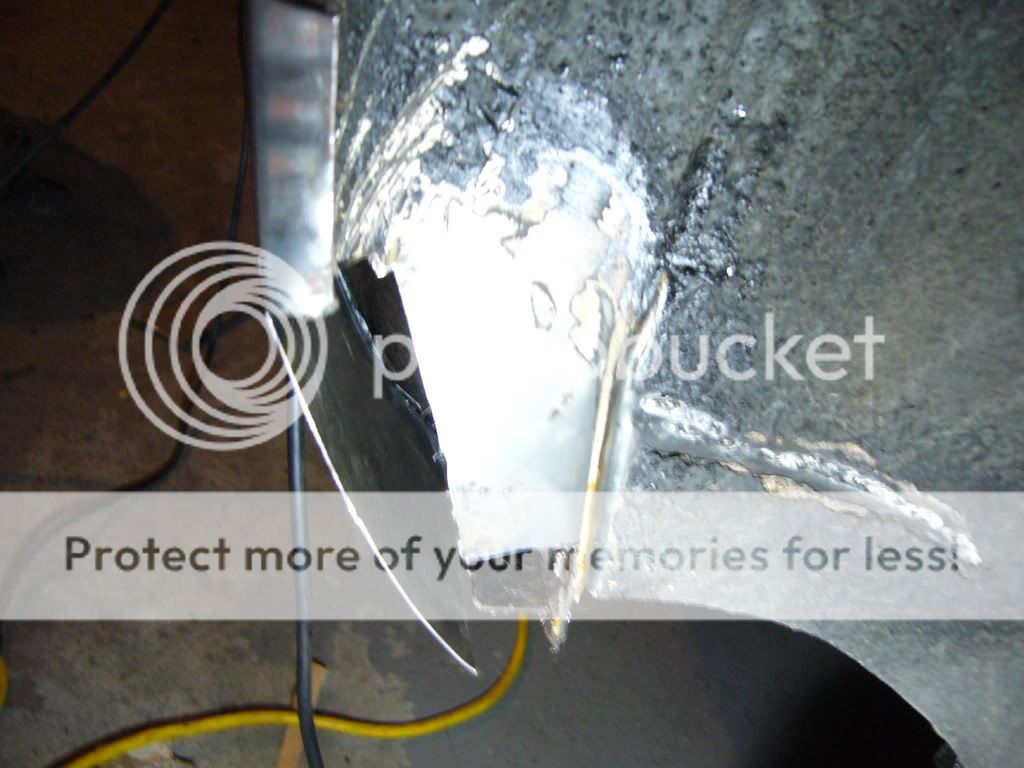

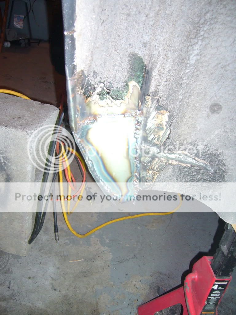

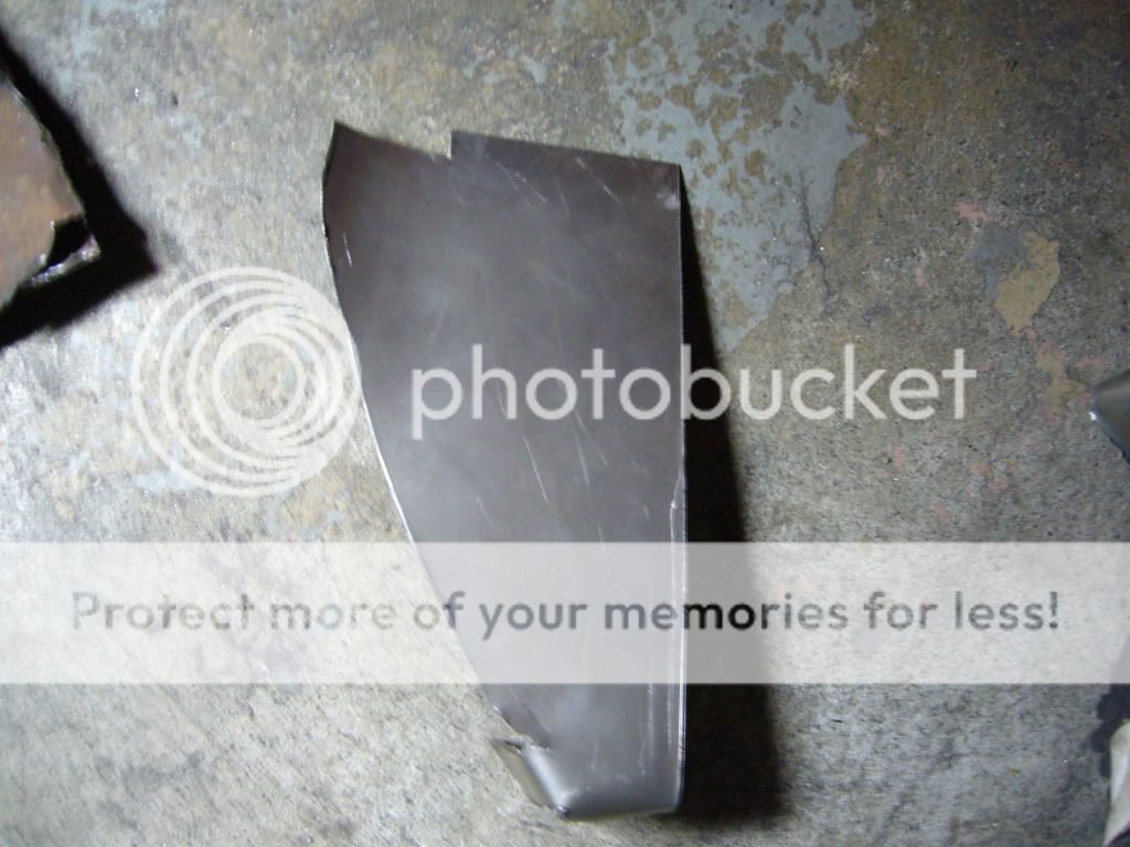

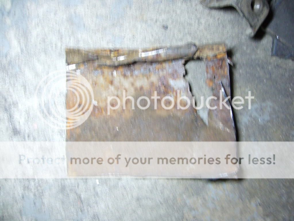

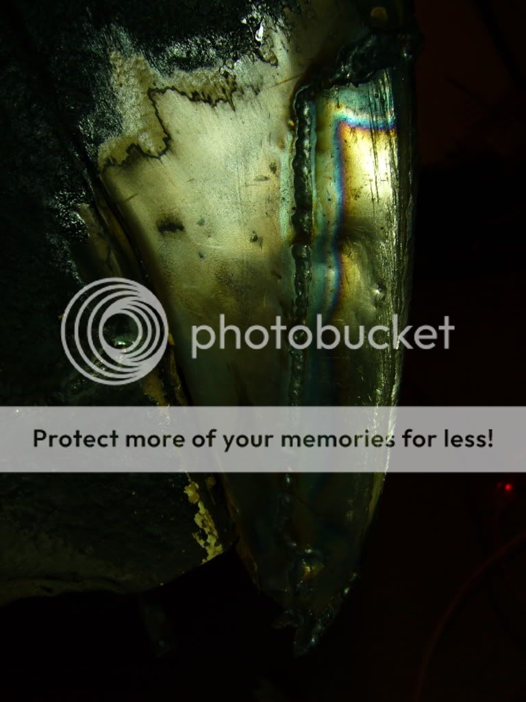

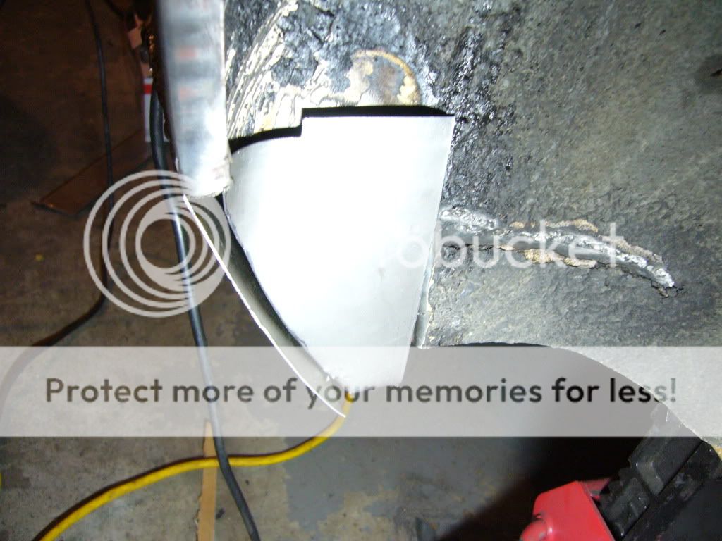

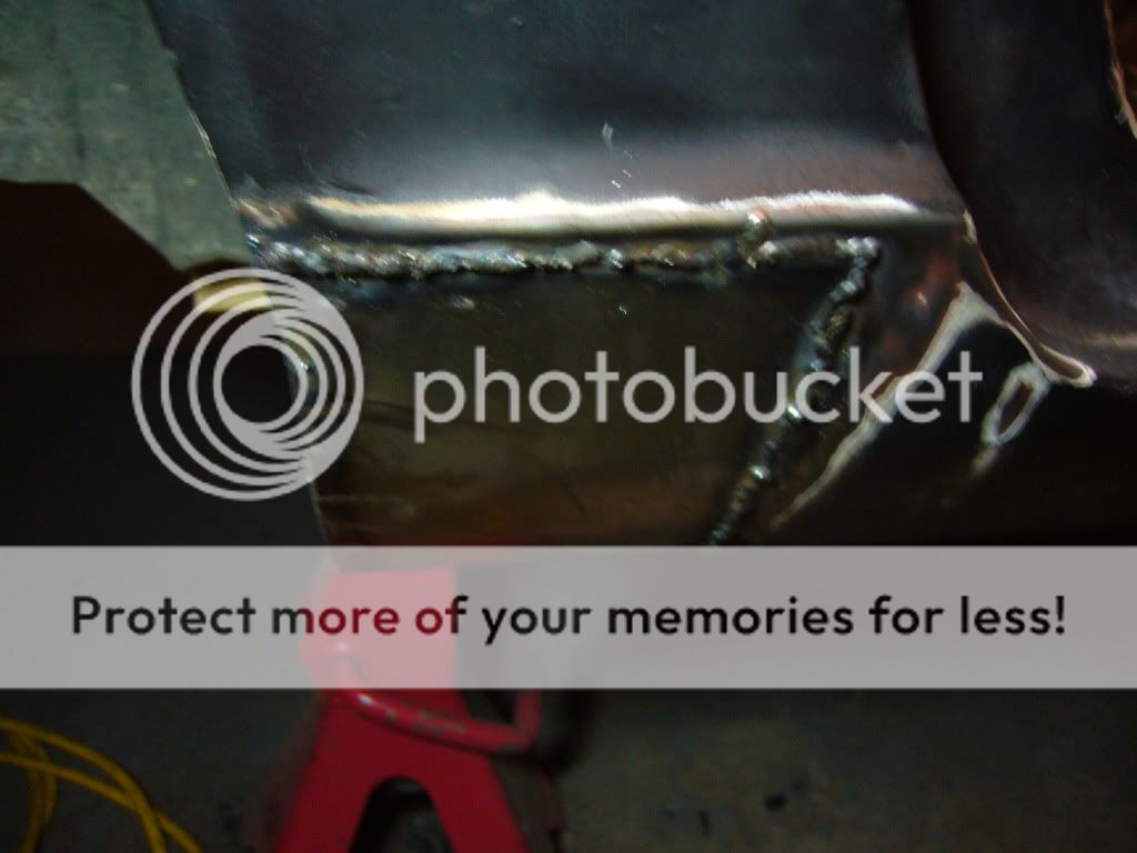

The lovely piece of the dogleg. Looked solid, but a little bit or wire brushing showed otherwise.
Wish I had taken A picture before I had put in the first patch, but alas.
My advice is don't be shy about cutting out rusted metal. It took me a few months and trial and error to learn that, but cut everything out you don't trust. A surgeon never leaves in part of a tumor just because. While it may be easier to cut out easy to trace shapes, a little ingenuity can make anything.
And test fit as many times as you can, I always like to cut a little bit larger and trim it down for a very nice fit.
Then weld the pieces in.
Almost done :).
And for anyone attempting patch repairs go slow! I ended up warping my floors a bit because I was too inpatient.

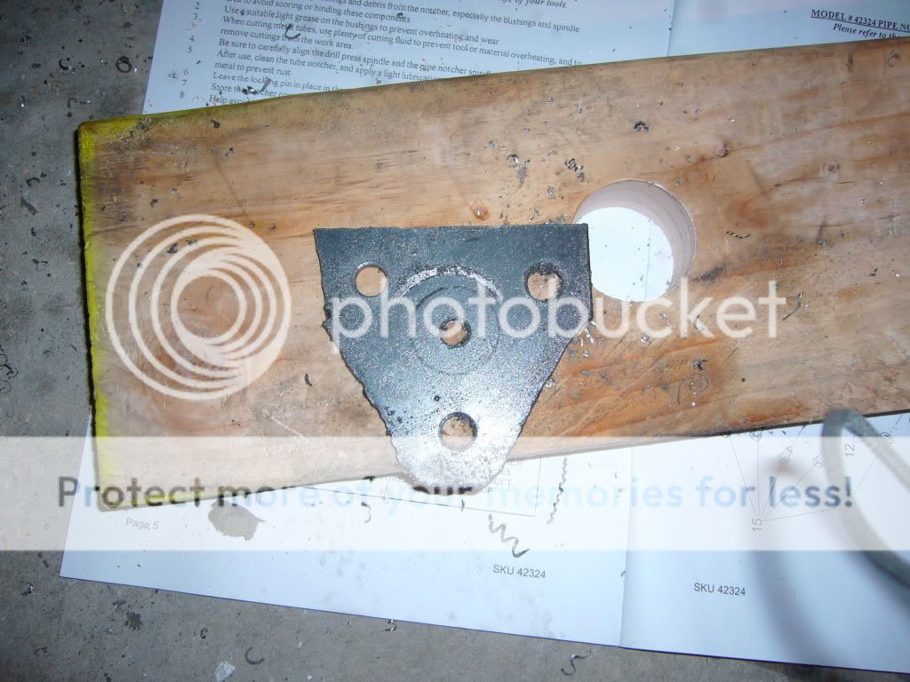

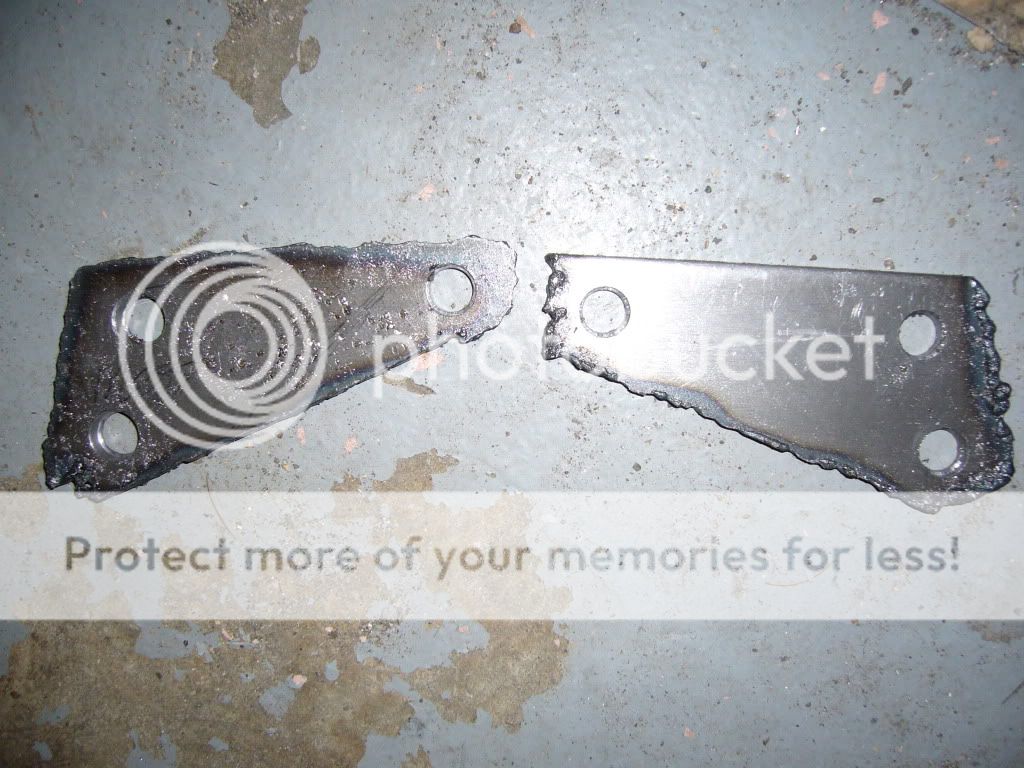

The holes were easy enough to drill, but I'm not sure how to go about making the large 2 inch hole for the center. I only had access to a plasma cutter for a day (the reason for the rough edges) and the 2 inch hole saw did pretty much nothing.

Can't find a way to drill a 2 inch hole for the strut tower plates, the hole saw is just skipping along the surface, and grinding it out with a dremel bit just sounds awful, any suggestions?
Not sure about the curvature of the dog leg-rear fender area. Can someone take a picture with a ruler in the rear fender to show how much the dogleg sticks out? I've been eyeing a few local 240's and am tempted to just walk up and ask some strangers.

Oh that 2" hole saw, is it skipping around because there's no center point to hold it in place? If that's the case you can screw a piece of wood behind the plate to give the saw something to center on. Aside from that you can use your angle grinder to cut a notch for the edge of the saw to seat into. then maybe it'll bite and you can cut. What kind of hole saw do you have? The carbide ones are pretty good for metal.
Looks like you've done a lot of work, but that you still have a lot to do. Gotta give props to you for being brave enough to paint it yourself.
Share this post
Oh, cutting an edge for it isn't a bad idea at all.
It's a bi-metal hole saw with a center pilot bit. Maybe I should be looking into a carbide one, it worked great on he 2 inch steel tubing, but on something flat it's giving me a bit of trouble, but I have ideas now, thanks!

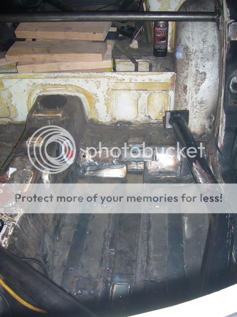

So I'm stuck and I need some advice.
Terminology I will be using:
Cross bar: the bars that go across the rear frame that will support the box and fuel cell.
Box: the steel box that houses the fuel cell.
Fuel cell: the fuel cell itself.

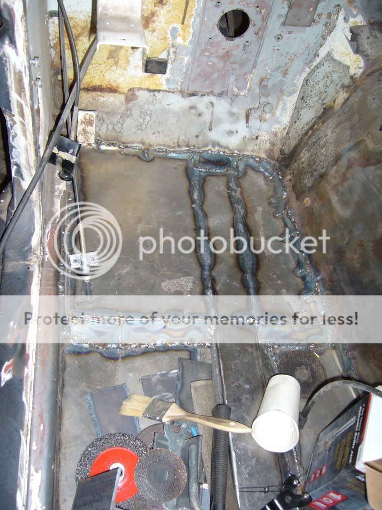

The fuel cell arrived, and I'm almost done making the box for it. I welded the cross bars to the box, the reasoning was since my box only comes up to the very top, I thought I could use the cross bars as a flange to mount the top of the box. The box is big enough that the cell slides in and out pretty easily, but after the top goes on, and the cross bars are welded to the rear frame, my only access to the actual cell is the hole where the spare tire well was, and the fuel cell will sit off center.
Picture below to illustrate the problem, but unlike this wise gentleman, I welded the cross bars to the box.
borrowed from gmac708
Looks like I have few choices, at this time, I'm not quite sure which route to take:
1. Don't worry about it and just move on, weld slowly to dissipate heat. If I need to service it in the future, drain the tank than cut the cross bars <-doesn't seem like a great idea if fuel cells need service often, and will put a bit of heat into the fuel cell.
2. Cut the rear floor into a square so I can pull out or put the cell in after all the welding is done (this would take care of the concern of melting the cell), then make an additional square panel <-since the rear floor isn't flat, this may prove to be very difficult/time consuming.
3. Cut the bars off, find a way to finish the box in it's own entirety, then make straps that will bolt the box onto the subframe <-the bars are almost completely welded on, will be very time consuming.
4. Weld mounts onto the rear sub frame, and bolt the cross bars into the mount <-this would work, but the mounts would have to be very thick and fairly wide, and since the tubing is small, I would have to find a sweet spot for a bolt that is wide enough to support the weight of a fully loaded cell, while being skinny enough not to compromise the cross bar walls.
Share this post
I found out yesterday, for the amount I spent, I could have just purchased a baffled aluminum cell and had a very very easy install, but I suppose I wouldn't have had the experiences I had. Just like I could have gone and borrowed a friend's bead roller (saved myself time and money), but instead I hammered the box into shape.
Anyways, I decided to go with the 4th option.
4 L-shaped mounts with bolts running through the mount to a welded nut on top of the fuel cell box.
I measured everything out at least 3 times, then started mounting them but somehow I was ridiculously off on some fronts, rechecked to make sure my box was relatively square and all my measurements remain the same still was off by a good inch or so in one direction and another 1/2 inch in another. I suspect that the rear subframe may not be equivalent on both sides, or I have some strange dyslexia when it comes to reading my tape measure :unsure: .

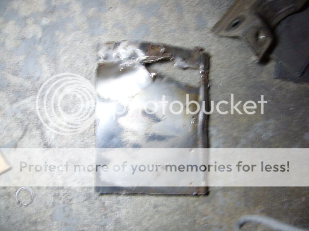

Made the fuel cell shield, not bad for just a hammer, but there is a definite presence of warpage.
I tried to be smart and save my self some welding by folding up the sides of the box...
Unfortunately that was a foolish attempt, especially without a bead roller, I really should learn to be patient, so here's the reattempt.
With the appropriate lid. Still working out how I'm going to attach it and make it vapor proof (there will be an external vent line so no worries about implosions).
Had a really hard time mounting the box back up since the holes no longer lined up (about 4 hours of work), the way I made it the first time was bolting the mounts up to the box then welding it in. Seems like warpage is not a myth >.<.

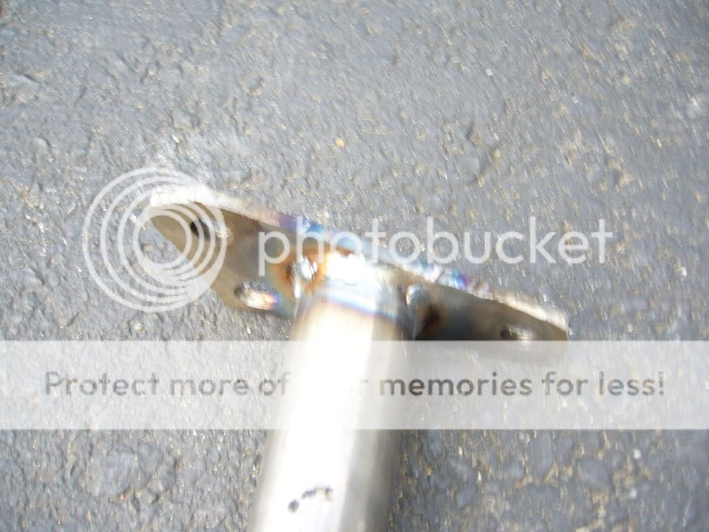

Started having trouble with welding upside down again. I swear it just depends on the mood/day for the welder. Since it is sealed from the top, and I do recognize the potential of warping all to well now, I think I will just use seam sealer on the bottom under the undercoat. I'll give it one last shot and if it doesn't cooperate I'll silence the overkill demon and just move on.
Most of the parts I wanted welded was welded. Including the spare tire cover, heater block off plates, door ajar holes, some pin holes here and there, the old exhaust hangers (they had ripped out and left holes), the gaps from the bumper delete when I was using a harbor frieght welder (lesson learned :lol: ).
The spare tire panel was a bit flimsy, so I decided to add a few braces, and somehow, form followed function.
It's still a bit flimsy, need to figure out a stronger brace pattern. Or just not put heavy things in the back.
