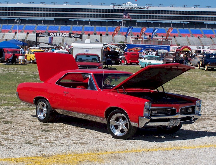

Seriously though, the 67 GTO looks pretty good, as does the 68 firebird (that was my suggestion since you were looking for pontiac to match the motor/trans... :D ) Good luck in your hunt, if I run across any Hupmobile lenses or anything down there like that, I'll send them on. :D
