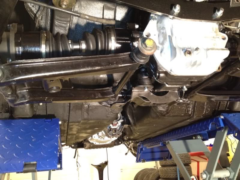

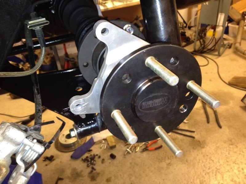

Have been alot at work recently, so there havent been much progress... I am just finishing the R230 install, had to modify the MM kit to make it fit properly. Have assembled the driveshaft and the cv-joints, and they fitted very well. I installed 280z stub-axels from MM to match up the rest... They took a while to get.....

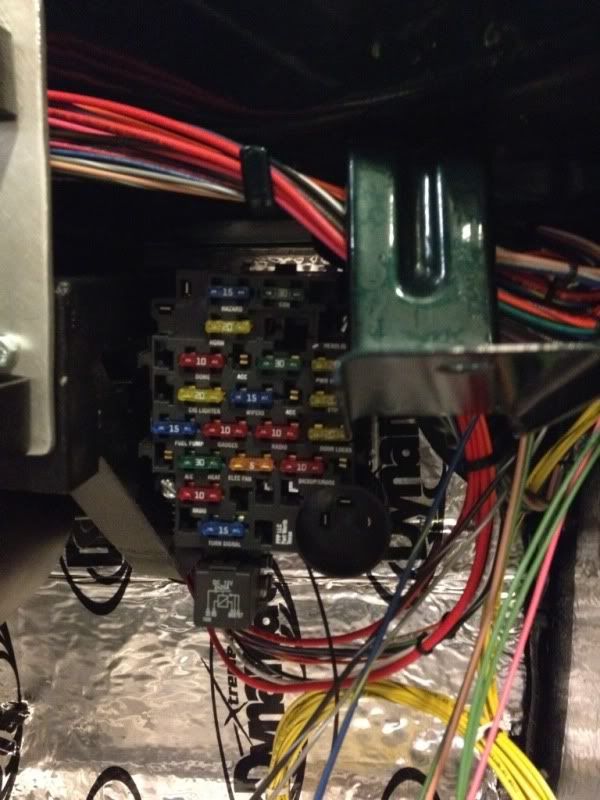

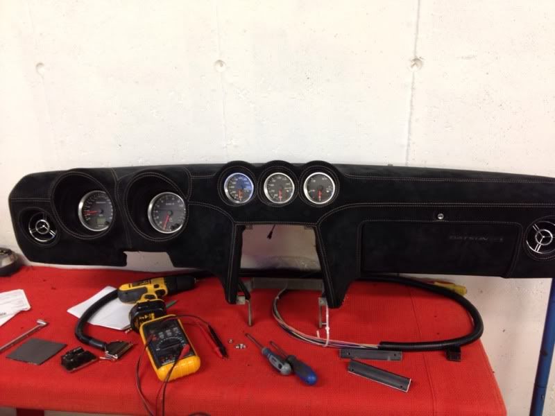

Posted 24 January 2012 - 08:18 AM

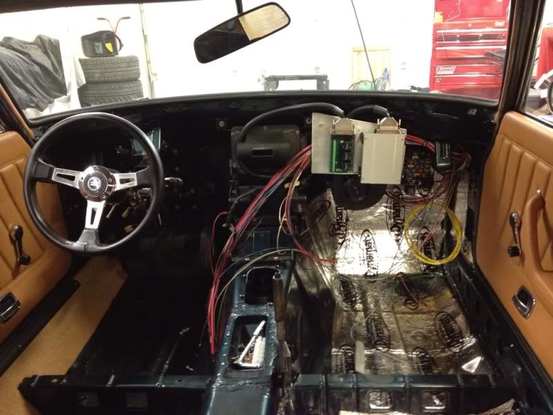

Have started wiring up a new 18 circuit harness from Painless. The new fusebox will be located behind the glovecompartment door, together with ecu and relays. Installed the Speedhut gauges in the dash too.
Posted Image

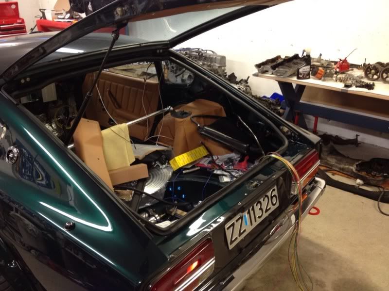

Posted 24 January 2012 - 08:28 AM
Will install fuelpumps and catchtank in the spare tire room.

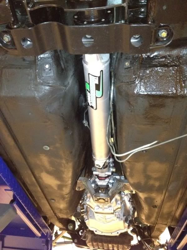

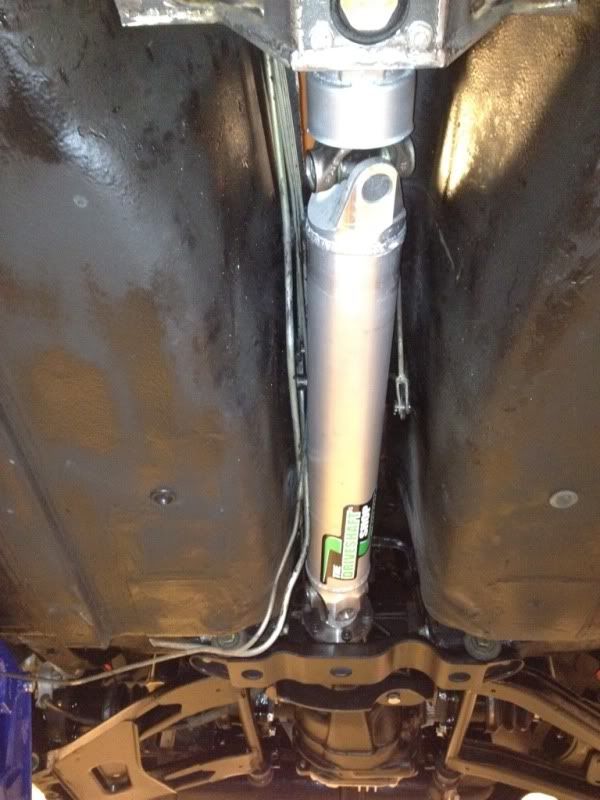

Recieved a new alu driveshaft from www.driveshaftshop.com

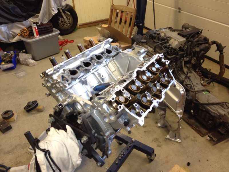

Posted 20 April 2012 - 05:57 AM

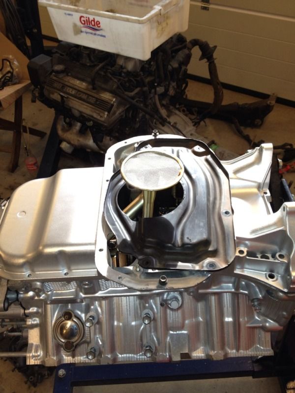

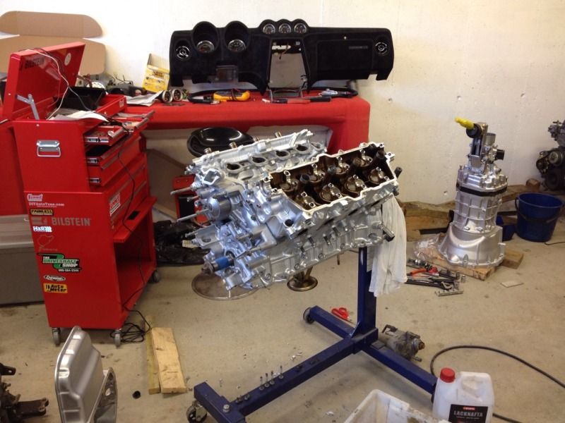

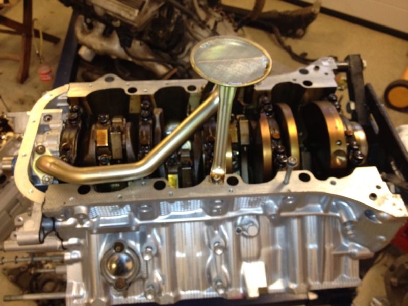

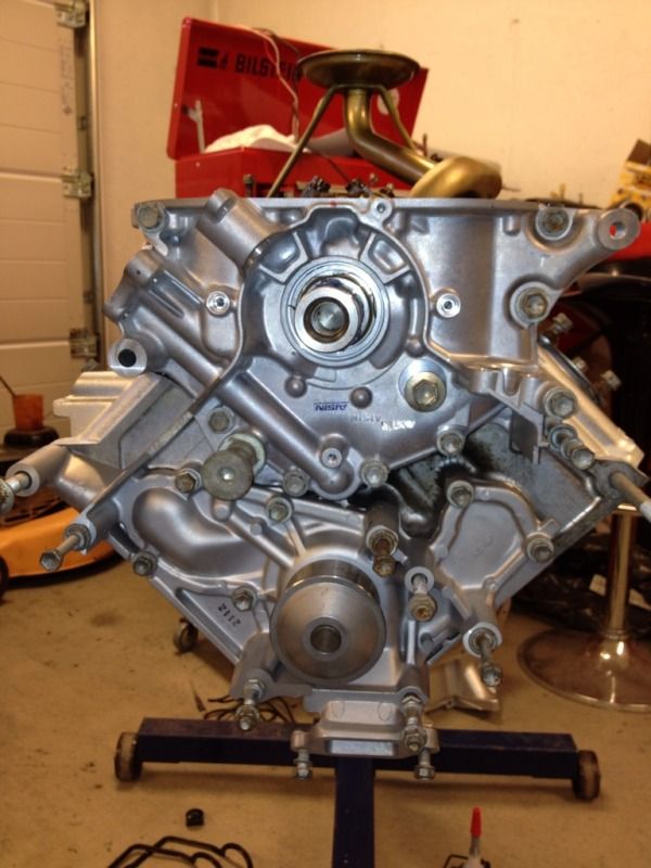

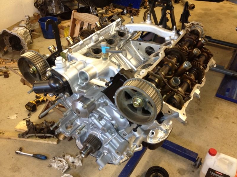

Some pics from assembling of engine...
Posted Image
Posted Image
Posted Image
Posted Image
Posted Image
Posted Image
-72 240Z

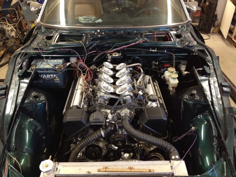

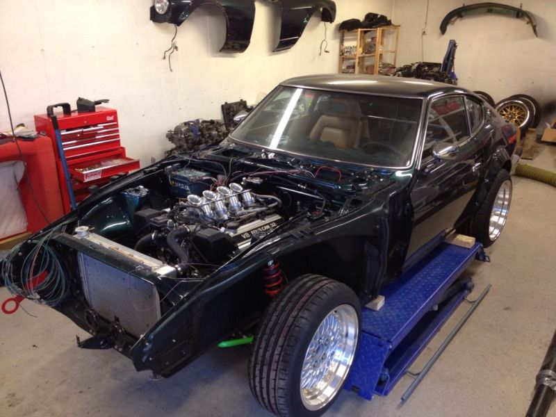

Posted 25 August 2012 - 02:49 PM
It's alive!!

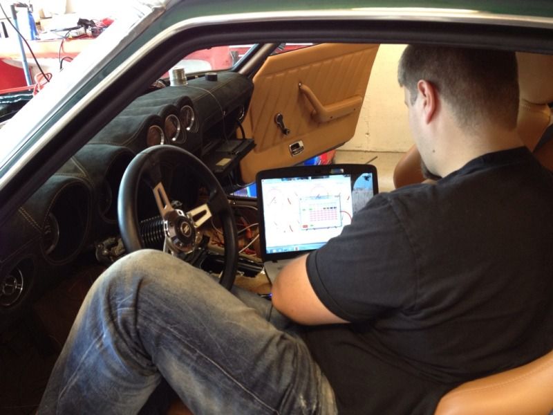

After a couple of weeks working on wiring the whole car, we had the first startup a couple of days ago.
Posted Image
Just some tidying up in the wiring mess now, and fix some fuel leaks... Then I will install fenders and front and start testing/mapping.
The sound of the engine with all trottles fully open is AMAZING! :)
Posted Image
Posted Image
Posted Image
-72 240Z

ITB's look cool, but won't your IAT's be through the roof? Or are you just not worried about that.
Super clean car. Neat to see something different.
1978 280Z - LS1 / T56
#33 ROVdriver
ROVdriver
    Member
  • Members
  • PipPipPip
  • 63 posts
  • LocationNorway
Posted 29 August 2012 - 05:42 PM
I will make up a plenum with cold air intake in front, but not just yet. Have to get many other things in place first.
-72 240Z

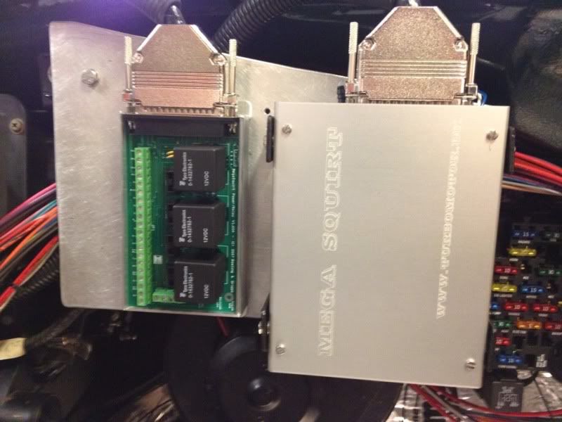

What are you using for engine management?
I'm using Megasquirt MS1 Extra with MS relay board
