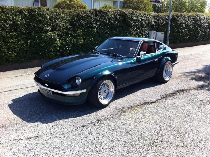

Posted 02 November 2013 - 01:14 PM
Some pictures from earlier this year
E6F534A9-CC37-4686-BEA8-418A6666AF8D-191
-72 240Z

Posted 02 November 2013 - 09:36 PM
My god. :shock:  I love it!

Posted 03 November 2013 - 12:03 AM
This is a superb  built Z, love the dash >>>> Attached File  a336a8f6.jpg   52.92KB   4 downloads  :2thumbs:

Posted 21 May 2014 - 12:38 PM
The z is out after winter storage...
10338728_860558833957512_140719261672676
Edited by ROVdriver, 21 May 2014 - 12:41 PM.
-72 240Z
