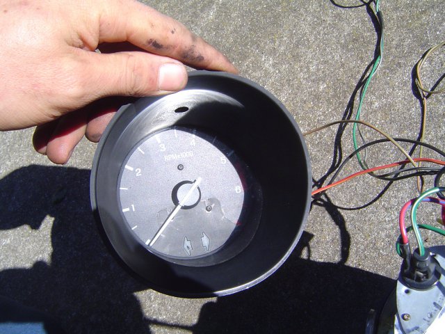

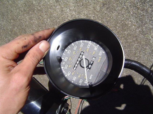

After who knows how many miles on my Z conversion (10k?), I finally tore apart the speedometer (1994 T-Bird) to see why the odometer didn't work, and it turns out all the little gears were broken.  Pretty cool how it does work though.  There's a little motor that 'pulses' once a second or so (at 27mph) and turns the whole mechanism a little tiny bit every pulse.  (Maybe a stepper motor?) Thankfully it's separate from the speedometer motor, so the speedo does still work.
FORD--->Speedometer and Tachometer checking/ calibration site:
http://www.accutach....achSpeedoR1.pdf
Took me about an hour to find that old link via google today.  BUT, the testing procedure for speedometers worked like a charm.  I happened to have a regulated 12v supply (use an old computer power supply if you don't have a formal unit) and a 15VAC wall transformer out of a 'jump start pack'.

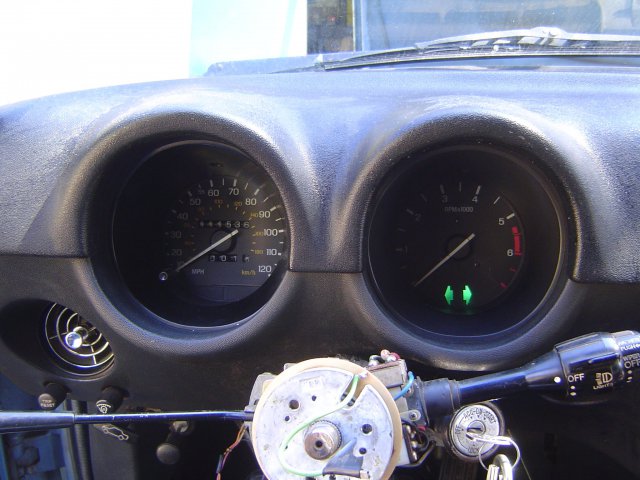

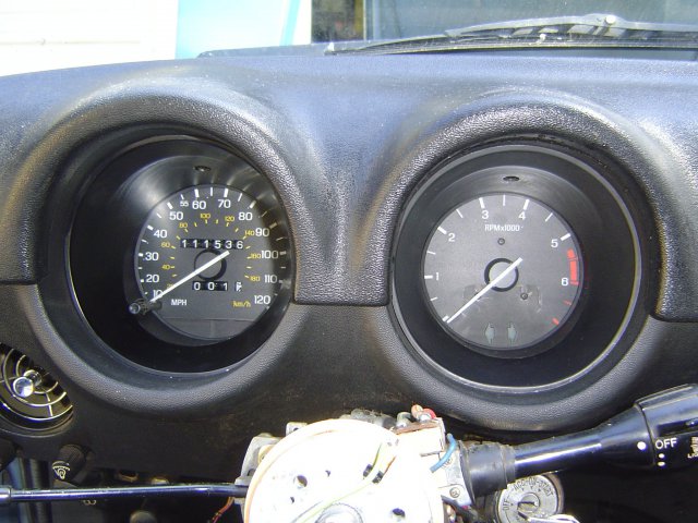

So, after about two dozen times taking the odometer drive all apart, and back together etc I finally got it working.  Took three tachs at the junkyard before I found one with good gears.  Guess this isn't such a rare failure, eh?   One of the gears I got looks like it's already been replaced too.  Beats the heck out of me paying for repops!  The cheapest I could find was $43 for the set.  Neither one is bigger than a nickle.  Crazy.
I also took about a day to spruce my gauges up, fixing the 'gaps' left at the bottom, and getting the turn signal lights working with the stock Datsun arrows and getting a check engine and hi beam light on.  They look really good in the car, down in the pods you can't even tell there's seams from things being pieced together.
This picture is with flash so you can see what I did to get things 'right':
I had my haz lights on to get this one.  Should have turned on the hi beams and ignition for the other two, but that's ok.
