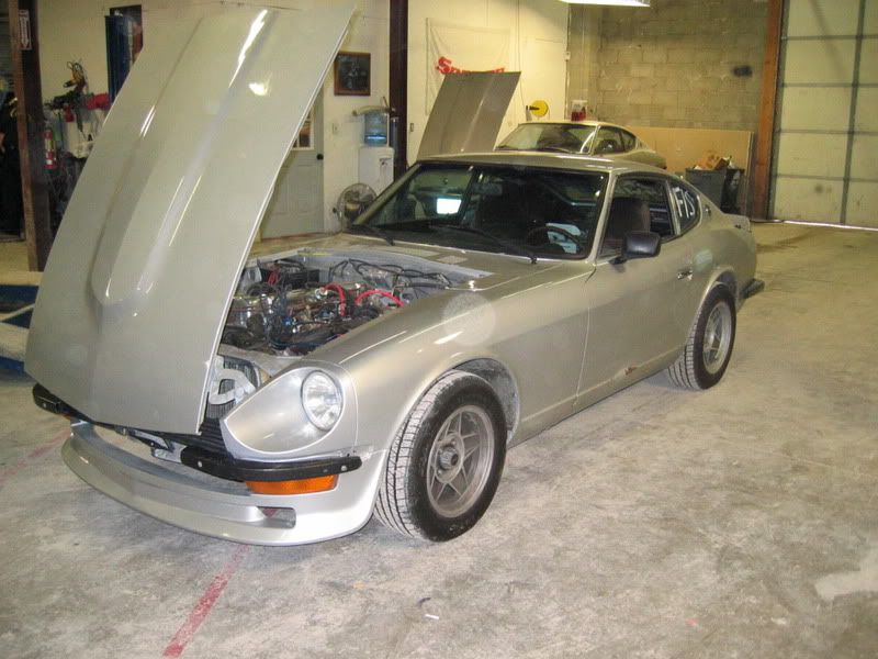

Photos from the day I got it home.

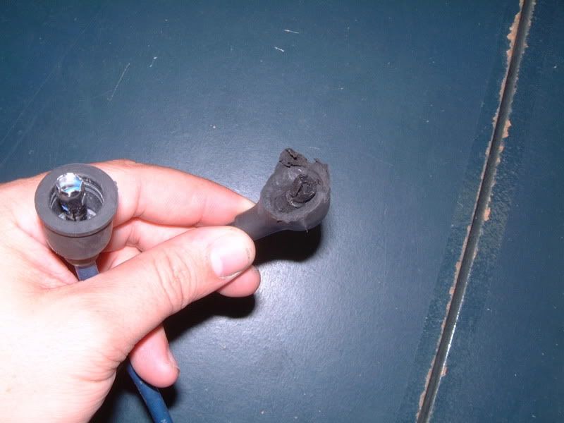

Or the condition of the coil and plug wire

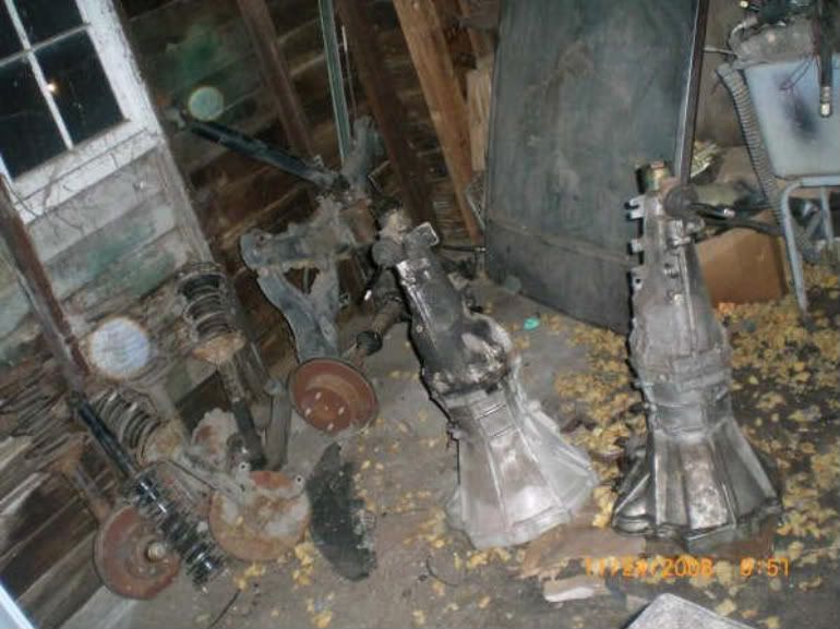

I found a dude in Omaha that had two 5 speeds in his garage. Said they had been there for 15 years but worked good when they were pulled. I took the gamble and the 20 miles I drove my car with it installed; it shifted great.

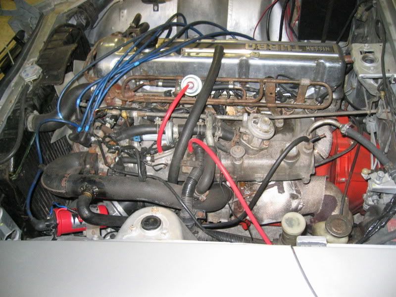

Got the car home and started to try to diagnose all the driveability issues and found all sorts of fun stuff. I think a 5th grader wired this car. Random things unplugged, bare wires, 13 individual power wires going to positive batt terminal..... It's ugly.

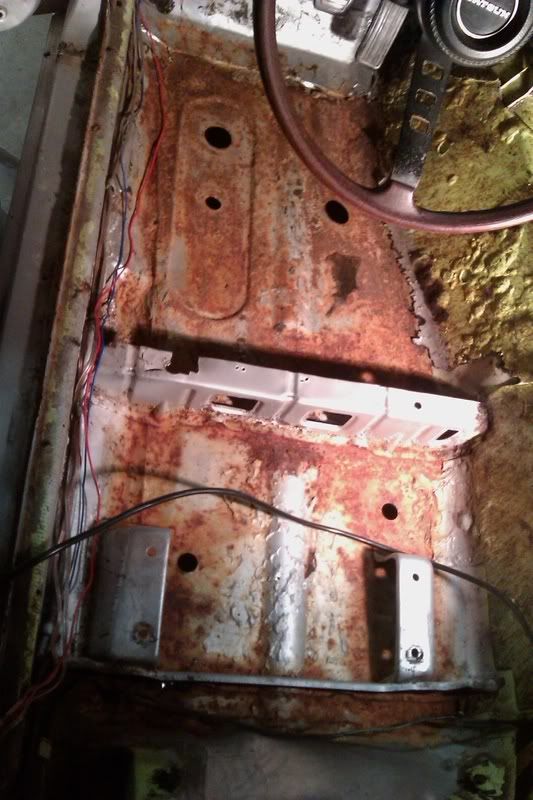

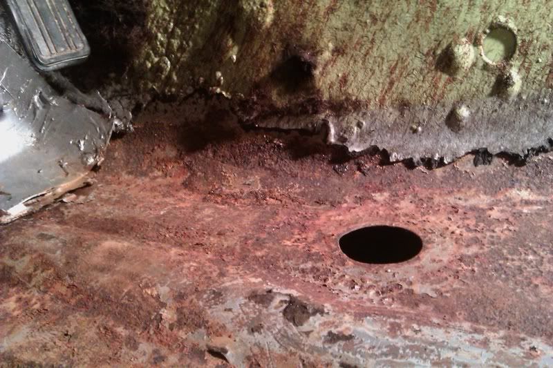

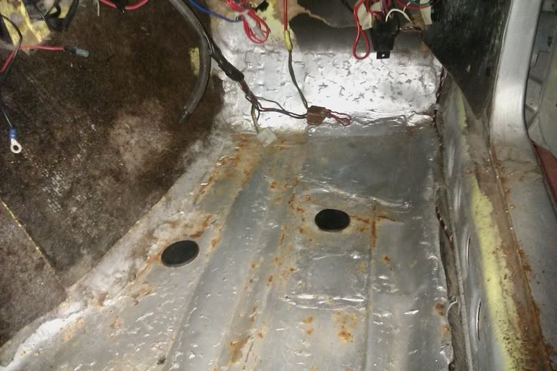

I bought the "How to restore" book by Wick Humble and it gave me a good guideline to follow. I started to strip away. I plan to build a rotisserie to do the underside and floor pans which will need attention. There is rust in almost all of the common places. My goal is to eliminate all the rust/fix body, paint the car, and get the engine running properly. Eventually go Megasquirt, but, one step at a time. Pics of floor
There are already patch jobs on both sides. They are riveted in though.

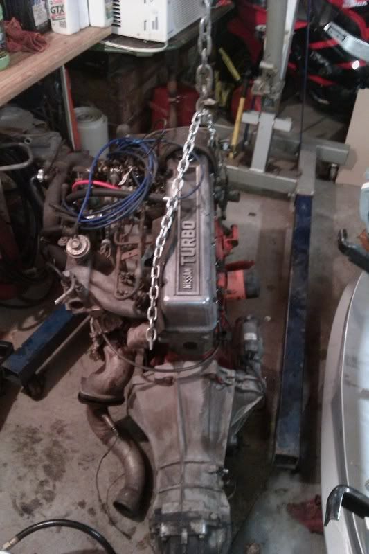

Next I removed engine wiring harness and pulled the motor/trans. Went pretty smooth, had a friends help. Not much to it.

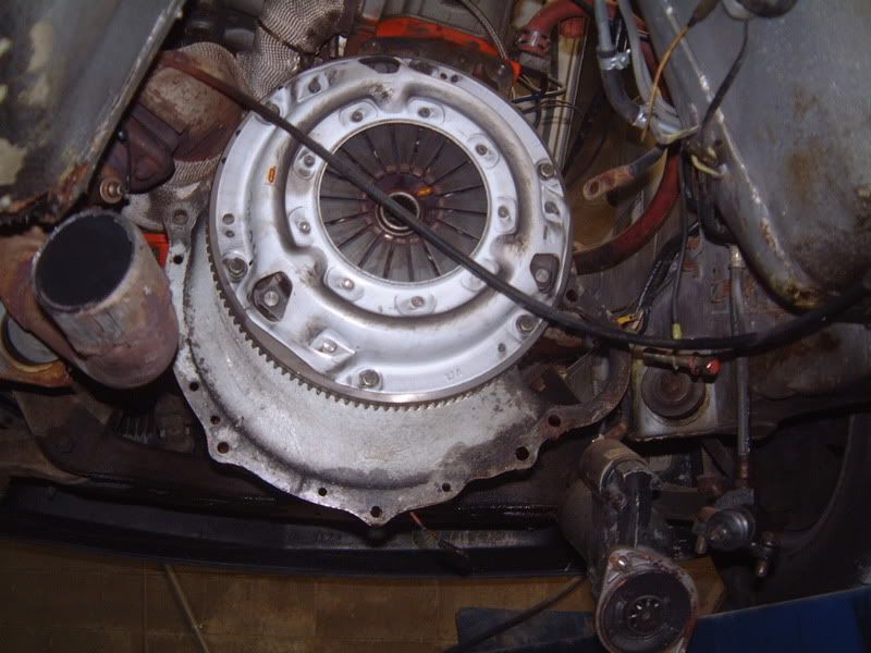

Separated the motor/trans took clutch/PP/Flywheel off. Put on engine stand.

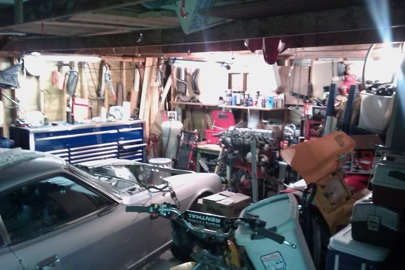

Even with the hood, cowl, interior all inside my house I am running out of room.

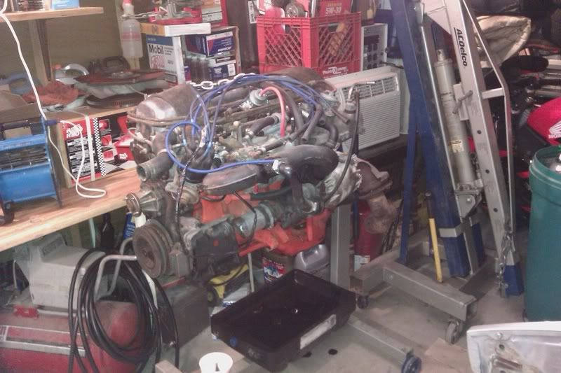

Took turbo intake off to look for problems and stripped the N42 bare. Will go with the N42, It will look good clean.

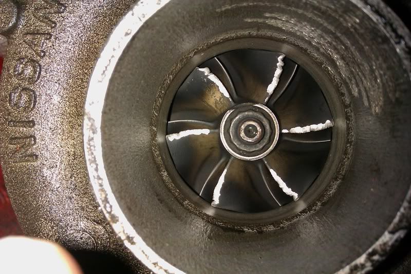

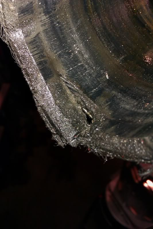

The boot between the turbo and J-pipe looked worn and I figured it'd be a good idea to peek into inlet of the turbo while I was so close and it was ugly. This is not what I wanted to see....Any suggestions on what to do about this? Replace, I assume.
Boot was torn too

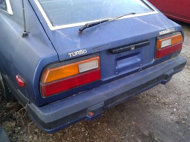

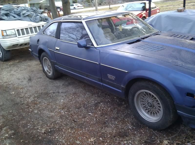

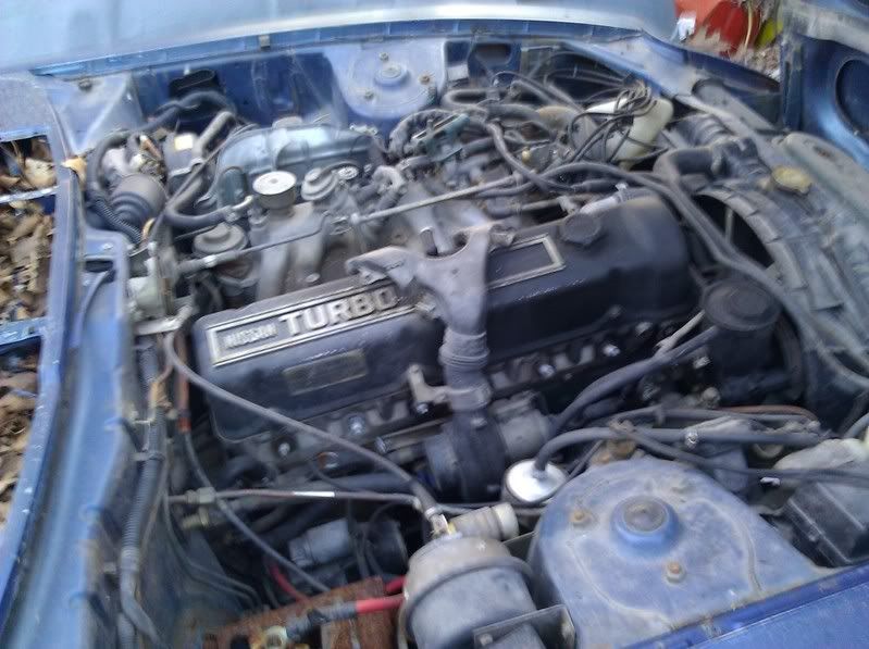

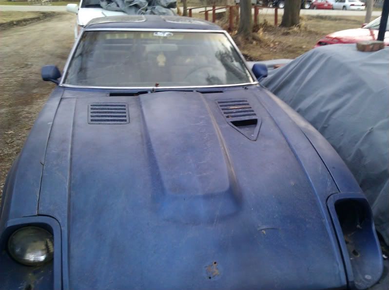

Minor Update: After years of harassment my neighbor sold me a complete turbo car he had collecting rust. It's an 82 and he said it ran when he parked it a few years ago. Now I have a spare L28et and R200! It has cool wheels too! I got it for cheap.
Nice score!
Excellent score. One thing I was wondering though, how did the impeller blades get that torn up that far inside? I mean I can see the outside edges getting galled if they come in contact with the housing or even the curved portion if the bearing allows the shaft to slide in and out. But looks like something must have been sticking down inside the intake tube for the blades to be that chewed up. I'm no turbo expert so I'm just thinking out loud here.
Thanks guys, I'm pretty excited about it! I was gonna drag it home today but it started raining then turned to snow.....Ugh, Iowa
I've spent some time pondering this myself. It is on the air filter side. When I bought the car the kid was bragging about how they were running it with an "open MAF". He thought it was cool.
My guess is something got into there, bounced around for a while and chewed them up. I am no expert either though.

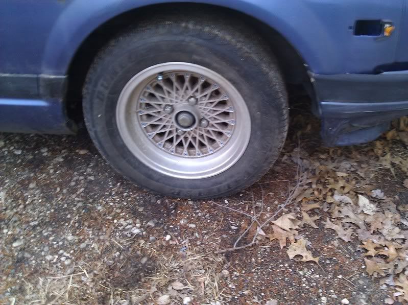

I really like the wheels on it. I'm not 100% sure what they are. They look similar to epsilon mesh wheels. I snapped a few pics after I brought it home. Here ya go :burnout:
Looks like they are the Carol Shelby wheels. They have the same ccs marking that google images shows on carol shelby wheels. Thanks for leading me in the right direction.
The wheels I got with my 240z seem to be impossible to find any information on also. I have gathered that they are ATS wheels from the 70's and that's about it. They are really light. Any info?
