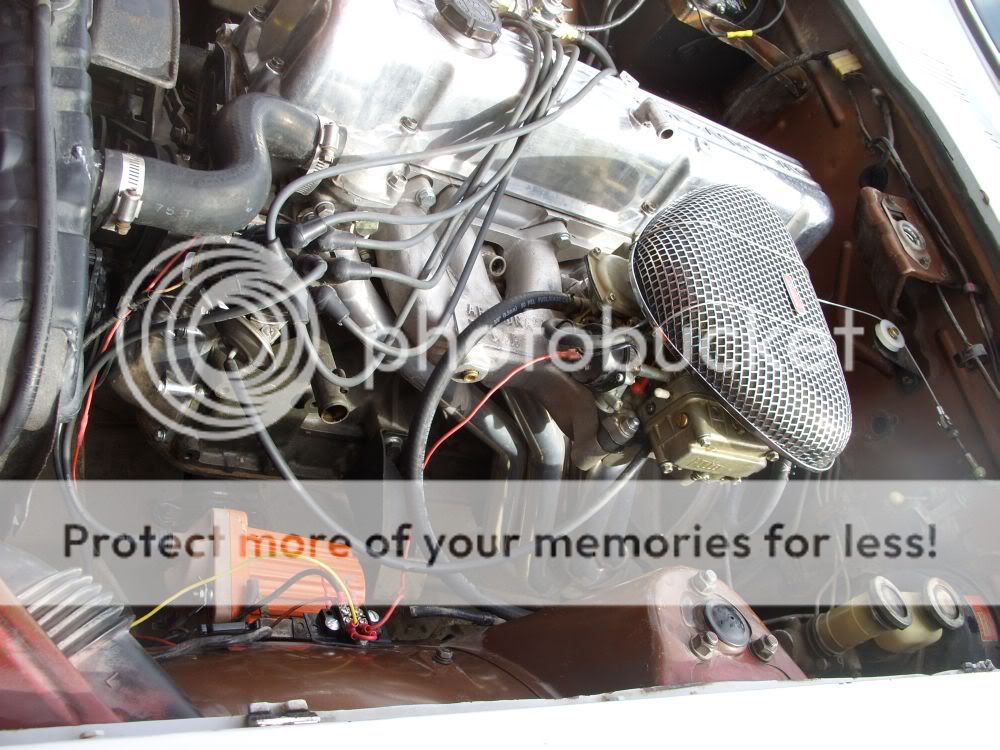

The gas was such a problem that I ended up tossing the original motor. When I put fresh gas in the tank, it reconstituted the funk from the old gas, which in turn started to hang intake valves. I probably could have just pulled and rebuilt the head but a local guy was giving away a L26 so I took the good L24 block and put the L26 rotating assembly in it. The L26 block was just too worn and would have required boring, the L24 just needed a good hone. It's a little loose but within specs. I also ditched the SUs and put on an Arizona Z intake and MSA 3-2 header. The ignition is a pertronix with an old Accel coil I had from another project. I reringed the block, fresh bearings, oil pump, chain, tensioner and guides.

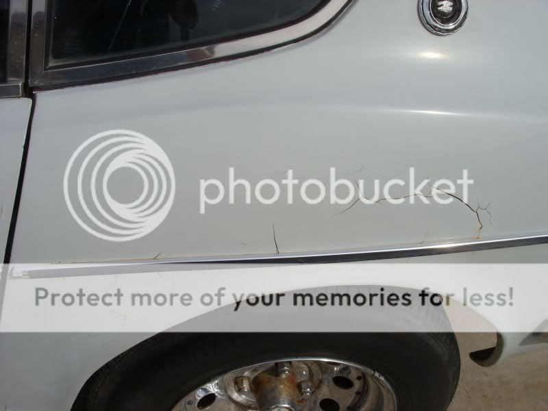

Sadly, the car has cancer. Both floorpans need some attention with the driver's side being the worse. I also have this nasty spot just above the driver's rear wheel which I suspect was originally body damage but the rust is cracking through the Bondo.

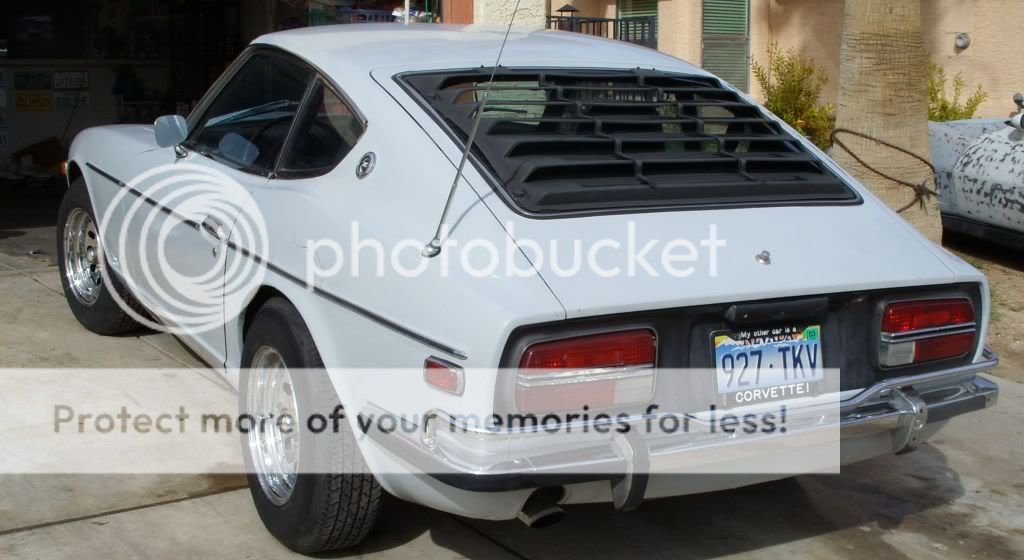

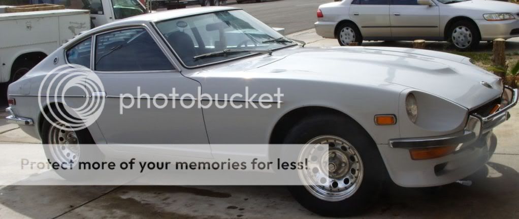

rightside.jpg?t=1299375122
leftrearquarter.jpg?t=1299375122

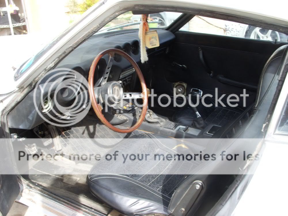

driverinterior.jpg?t=1299375122
engineleft.jpg?t=1299375122

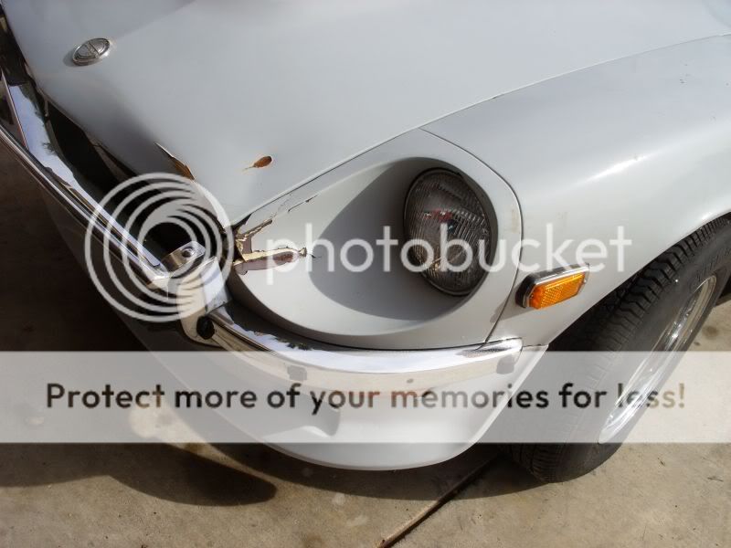

Here's some bodywork that needs repair thanks to my neighbor's F250.
hoodbucket.jpg?t=1299375122
