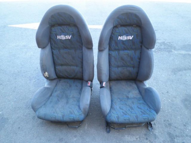

Only update on the interior is a set of seats I picked up out of a Australian Built Holden Commodore, in the States these are known by their export name being a Chevrolet SS
These came out of the hi-end HSV Clubsport and I will have them re-trimmed in Alcantara Leather.

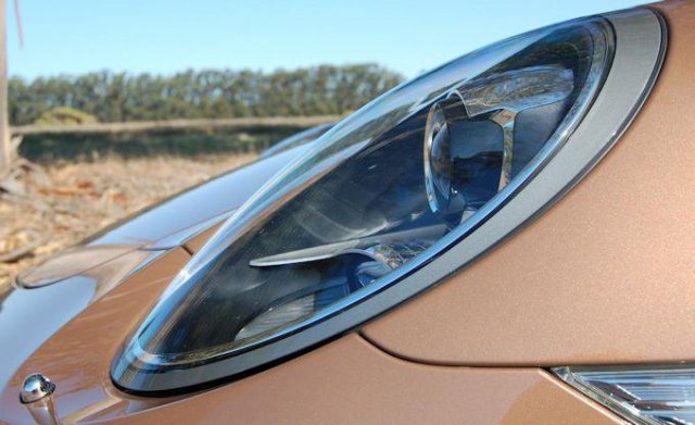

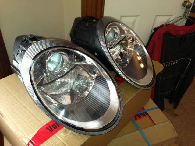

These puppies are off a 997 GT3 Porsche, think they will eventually make their way onto the new nose, new from Porsche $3,800.00, I swipped these brand new never fitted pair for $1,000.00.
P.S. + a side view shot of how they will sit from a web pic

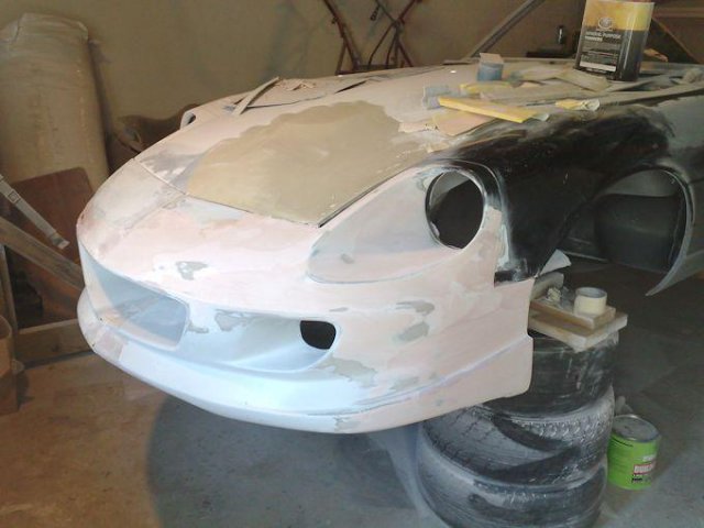

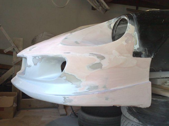

I used a FG 350Z front bar replacement, then disected the bottom, sectioned it into 2 and extended the 260Z headlamp buckets and built up the center upper valance then FG'd the entire assy together and began shaping it with Bondo.
I have about 100 pics of the process, long way to go but once its all done and I build up the new headlamp shape for the Porsche headlamps, then I will hand it over to have a mold made to reproduce it in caron Fibre.

The "Z" buckets are tight, and the headlamps will need to sit further foward to diminish the scoop effect of the actual buckets, I sat them in place but the rear housing of the new lamps dont allow them to slip into the buckets tube structure, I will have to form entirely new buckets around the dimensions of the lamps, nevertheless, the roughed out trial placement probably gives some idea of how they will look.
The spoiler will need some major rework and the lamps will need to sit lower into them as opposed to where the tube is dictating now.

I do also. I love all the other bits and pieces Porsche makes that go around those 997 lights as well.
Got to love Porsche / german engineering :-)

Headlights will be interesting. Have any mock up pics or drawings?
Correct, just a representation, proof of concept I guess you can call it for now.
I am interested to see how you incorperate the headlights too. The look very cool.
Even if I find they are unworkable, I figure they are a safe investment and I should earn on them lol

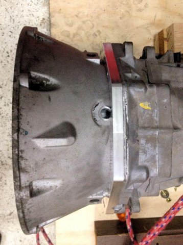

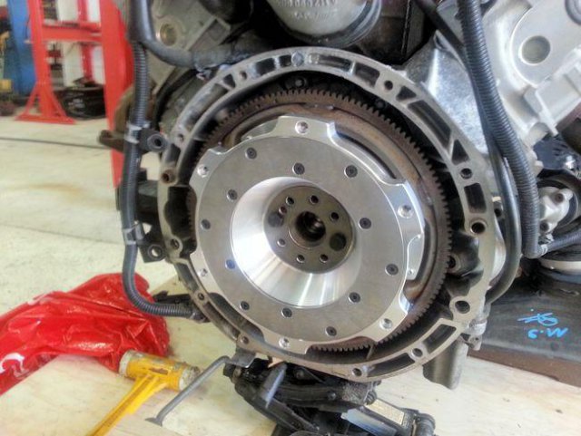

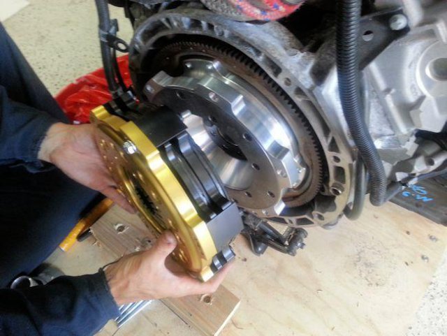

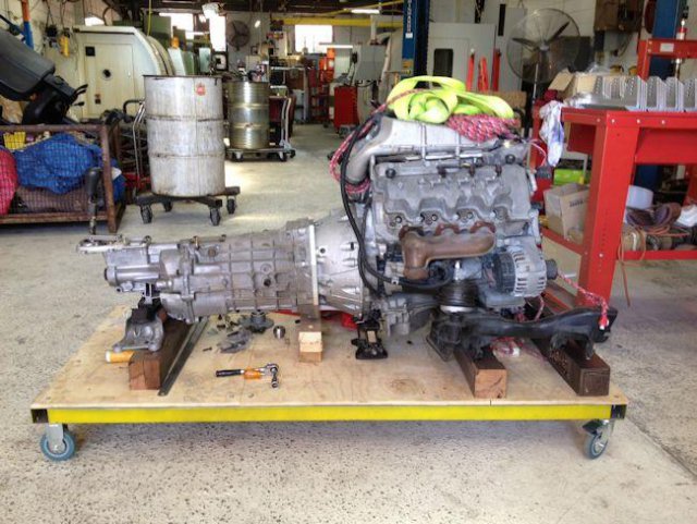

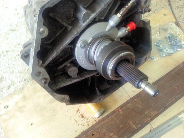

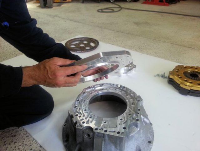

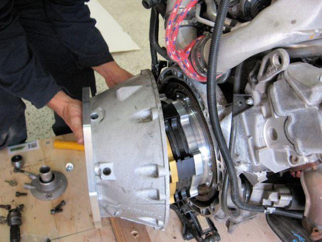

In the meanwhile, after months of sitting cross town at ARC, I finally reunited the car with its heart after picking up the engine in a 60 mile dash across town and back.

Thinking the worst that someone had broken into John's shop and taken off with the lot I made the call, John answers and says that I better pick it up post haste, asking why he explains that the receivers are coming in as he has gone bust after a major deal in the States to supply kits for the current model Vette's he had spent a few $100 G's tooling up fell through.

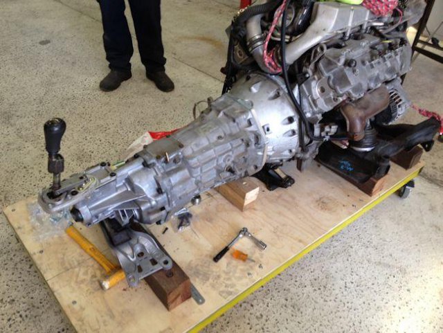

It was a mad rush to get it out of there but as you see by the photo, mother and child have been re-united and are safe and sound.
So yes, soon I start on the chassis and motor, scouts !

New bling
Courtesy of Yahoo Japan, the 997 GT3 head lamps are now on EBAY, hopefully I can flip them for a few pennies more.
