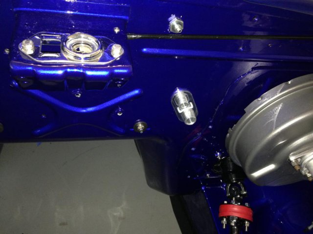

Thank you, they are Milspec connectors. Real easy to engage and disengage. The pictures are from the engine bay side right under the battery tray.

We had to relocate the wiper delay module to the driver’s side foot well due to spacing constraints in the passenger side area. I was able to get the Cable X Box as well as the T56 Reverse Lock Out Module in the same spot. That’s where the factory ECU was located therefore everything is hidden behind the original ECU cover.
We are using a Milspec connector to run all the T56 Reverse Lock Out Module, master cylinder, Temperature sensor (for Home Link Rear View Mirror), windshield washer pump and engine bay light wiring through the firewall next to the brake booster.
