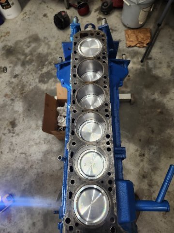

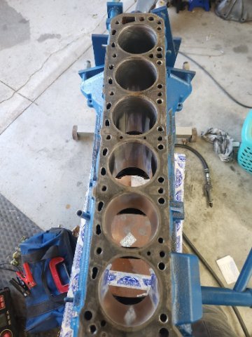

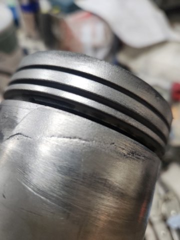

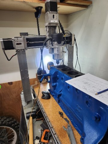

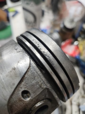

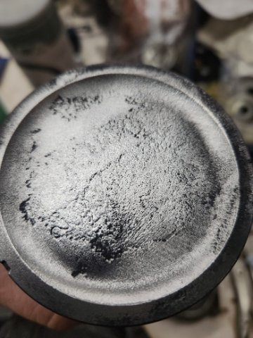

Slowly been chipping away at building this engine. Got all the oil pickup tube mods done. Then used my cnc router to plot out where to drill my block for the cooling mods for JeffP's head gasket. I'm cheap and not using his gasket but modifying a felpro to have all the cooling passages. My router isnt ridged enough to actually machine the holes but it allowed me to do a spot drill for the hole centers. Then came back and use the correct sized drill bits in a hand drill. Then used a die grinder to connect the 2 holes on the oblong holes. Worked well. Some time after that i was working on m wife"s car but wanted to keep going on the engine so I took my heavily carboned up pistons and soaked them in Superclean. DO NOT do this!!!! It eroded my pistons and made them unusable. Talk about a gut punch. The pistons where within spec and perfectly usable. Well I didnt know what I wanted for Christmas But I did after this. My mom and Aunt said they would go in together and get some new ITM's for it and where nice enough to let me have them now. Pressed the old ones off. New ones on. Gapped the rings. And install.
