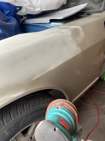

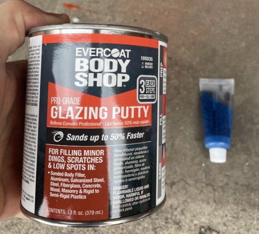

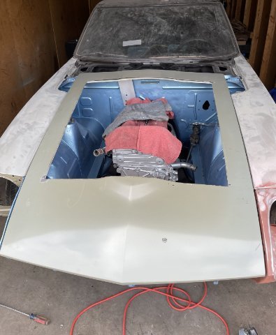

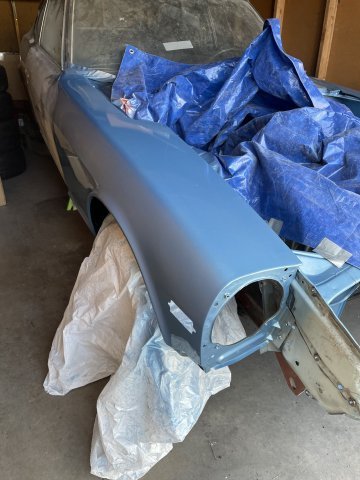

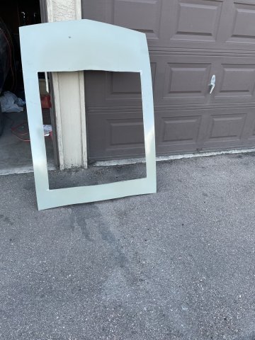

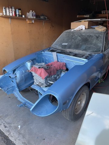

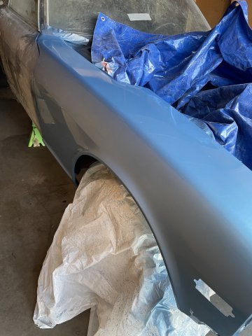

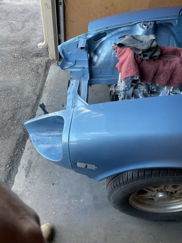

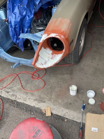

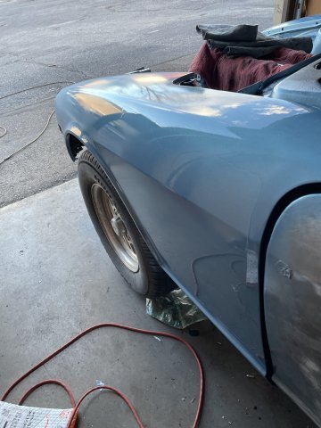

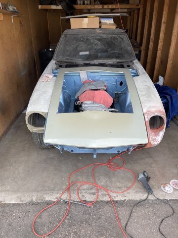

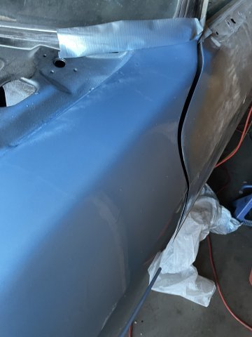

11-28-2025. I started today by sanding out and using some filler glaze on the left headlight bucket, and then sanded down both front fenders. Then I finished scribing out the hole on the hood and cut it. After that, I went ahead and primed and painted the front fenders and the one headlight bucket I currently have. There are 5-6 spots I will have to fix / paint correct, but progress is made. Pics:

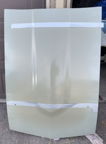

I can't tell from the tape what you're doing. Cutting a hole in the center of the hood for clearance? Making the hood into a donut or a U?

Happy Thanksgiving! I started the layout on my new hood before going in for the holiday. 13 1/4" from the front hood corners. this should allow for the radiator support to see seen, AND because some of the center bulge remains, those bends in the steel will help with keep the sheet metal rigid. I wanted to keep some the center bulge anyway, as it helps set the tone for how the bodies lines go back visually. the side will be cut to cover the tops of the struts, yet, show the tops of the frame rails and how there are no exposed brake lines. With the hood being black but the engine compartment blue, it will also set off the edges around the polished engine sticking up. At least in my mind.

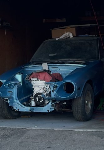

Thanks. That’s the fuel cell that came with the car, it’s too big (20 gal) and I don’t like it mounted on top of hatch floor. Going to explore Black Friday deals, thinking of going with an ATL because of the bladder and other safety features and I’ll recess it down as far as I can, hopefully it’ll sit flush. Trying to decide if I should go with 10 gal or 12 gal, 12 gal is a little cheaper for whatever reason. I should burn approx 5 gal a session at Sebring, the track I’ll frequent most. -

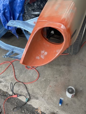

11-26-2025. I got the rear tires mounted on the wheels and balanced, and I was able to attach one headlight bucket and then started painting several coats of filler primer for deep scratches. The bucket has deep scratches in the metal in the bottom of the scoop portion, so this will get a start on filling them, and then I will put some glaze on there and sand it smooth and sealer prime it before color and clear. The other headlight bucket, after sandblasting revealed a crease in it, and I don't have the moxie to want to fight and fix a crease and make it look good, so I ordered up a reproduction bucket. I then got a call from J&S Polishing, and ran down there and picked up my intake and valve cover. Pics heavy.

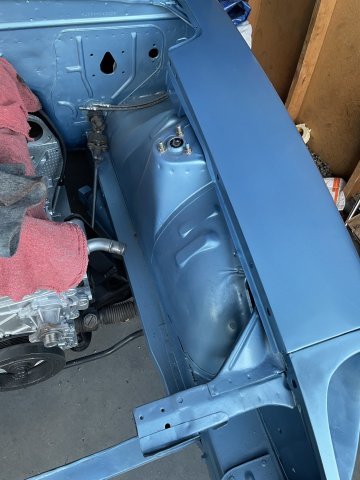

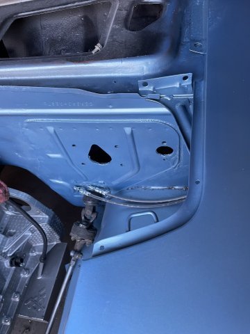

11-25-2025. My new fender and hood came in from Resurrected Classics today. I quickly hung the fenders on and took some pics to show how well they fit. Very impressive. High quality parts. The box does say "Made in China", but they are VERY nice pieces. I also went ahead and got the front tires mounted on to the front wheels. The wheels are 16X8 with 0 offset, the tires are 205/55R16.
