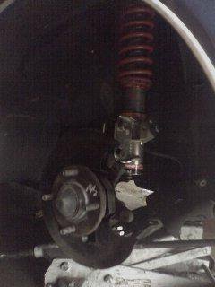

My S13 swap got put on hold... I found a fantastic deal on a set of Enkei 92's so I picked them up and invested in refinishing them. My coilover budget ended up going into the wheels and tires. I have everything needed to do the swap except the coilovers and tie rods. I plan on saving up for a set of Stance GR+ coils. So for now, I sit back and wait to see how every one else is coming along with their swaps...
As you can see, my S130 is in dire need of some coils!
