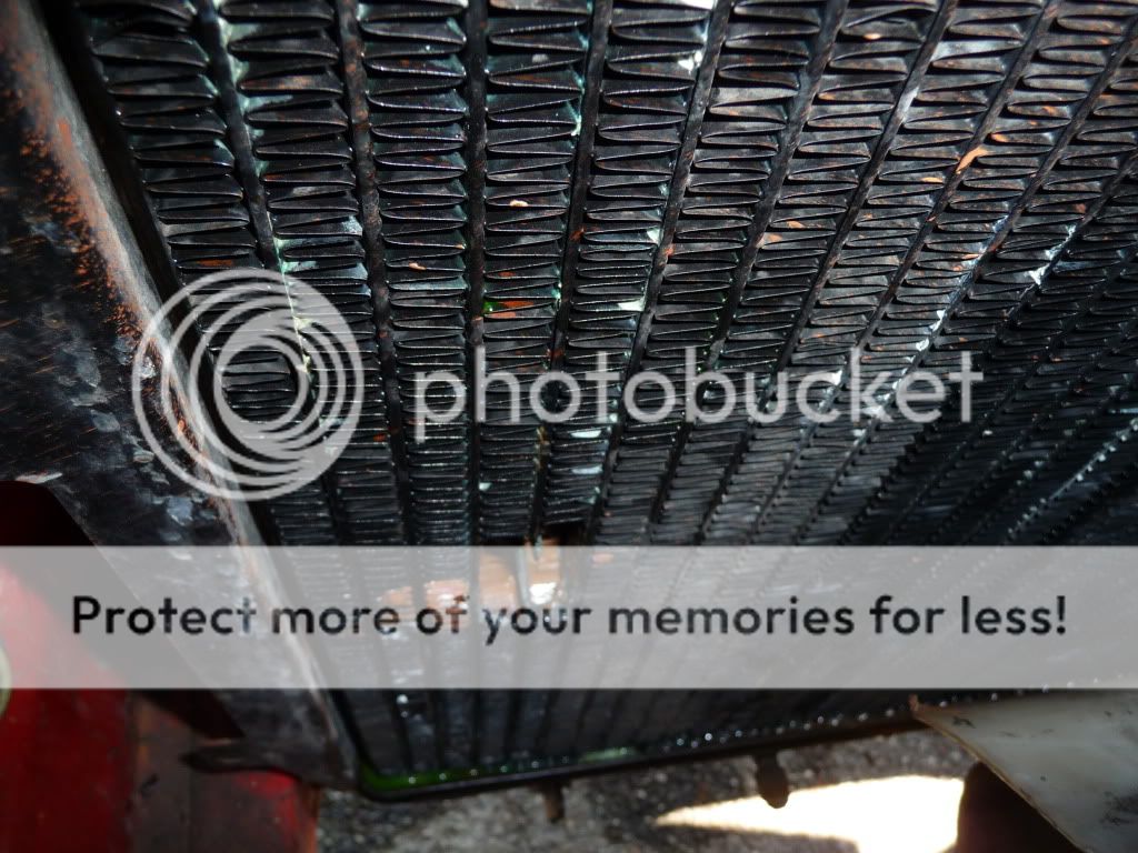

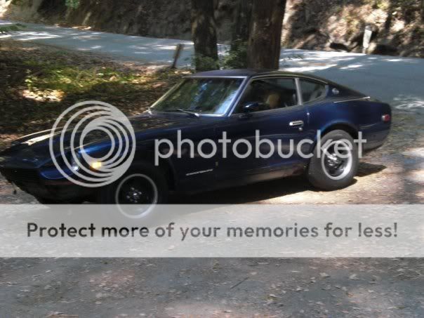

First off, on the way home I start smelling coolant and decide to pull over at the Edgewood Road exit of I280. Sure enough, I forgot to put the radiator cap back on after topping off on coolant :banghead: ! Moreover, the radiator had barfed out some brown sludge that didn't even resemble anything that should be in an automotive cooling system. Clearly, this car was neglected, as if I couldn't tell by the hole in the radiator...
Luckily, my girlfriend had come with me and we were driving back in our cars together, so we went to a gas station, picked up some water and eventually made it home. Here it is sharing space with Red Z (the 240Z) in its current state.

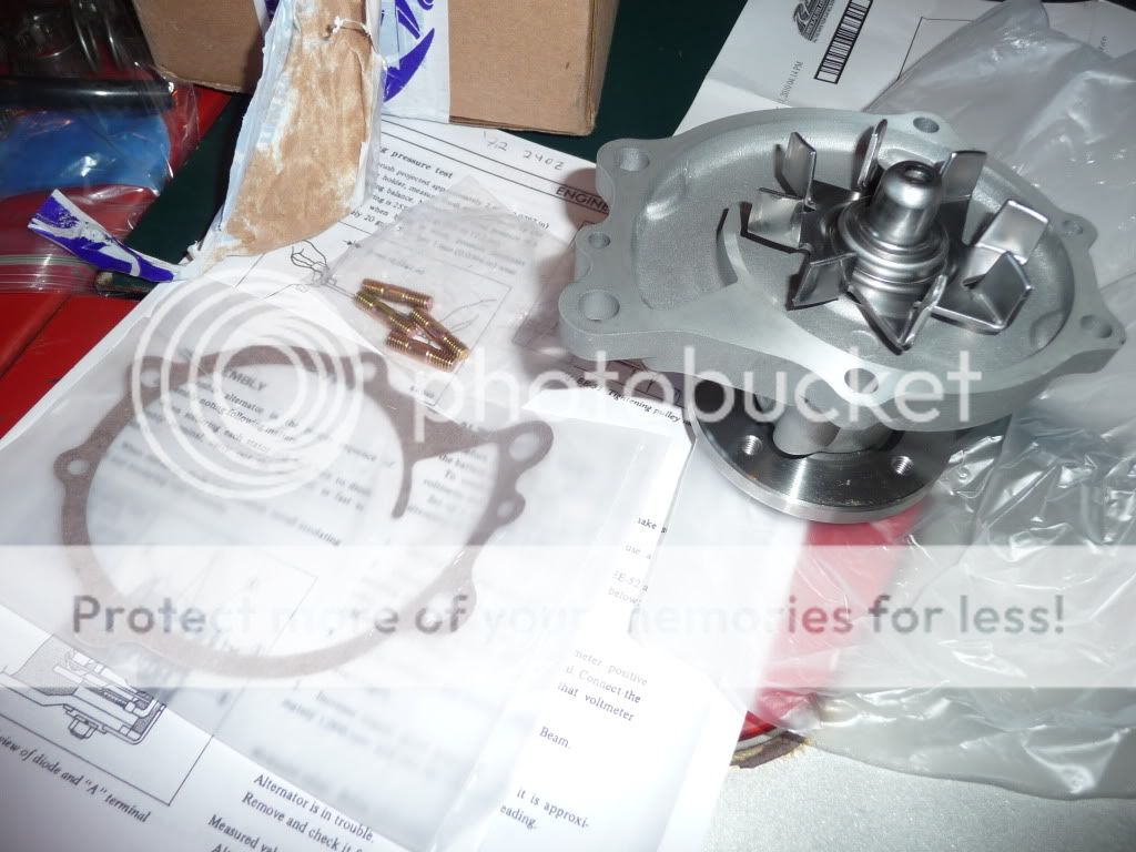

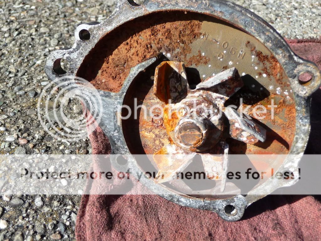

Obviously, The cooling system was the first order of business. I decided to replace the water pump, fan clutch (since the one on the car was stuck), radiator and coolant hoses. I ended up also replacing the water inlet and thermostat housing because of corrosion damage. I got a nice surprise when I removed the old water pump:
Did I mention it was neglected? Indeed.
New Pump was installed along with hoses and the ol' ebay special aluminum radiator.
Yes, a hole in the radiator.
Oooh, shiny!

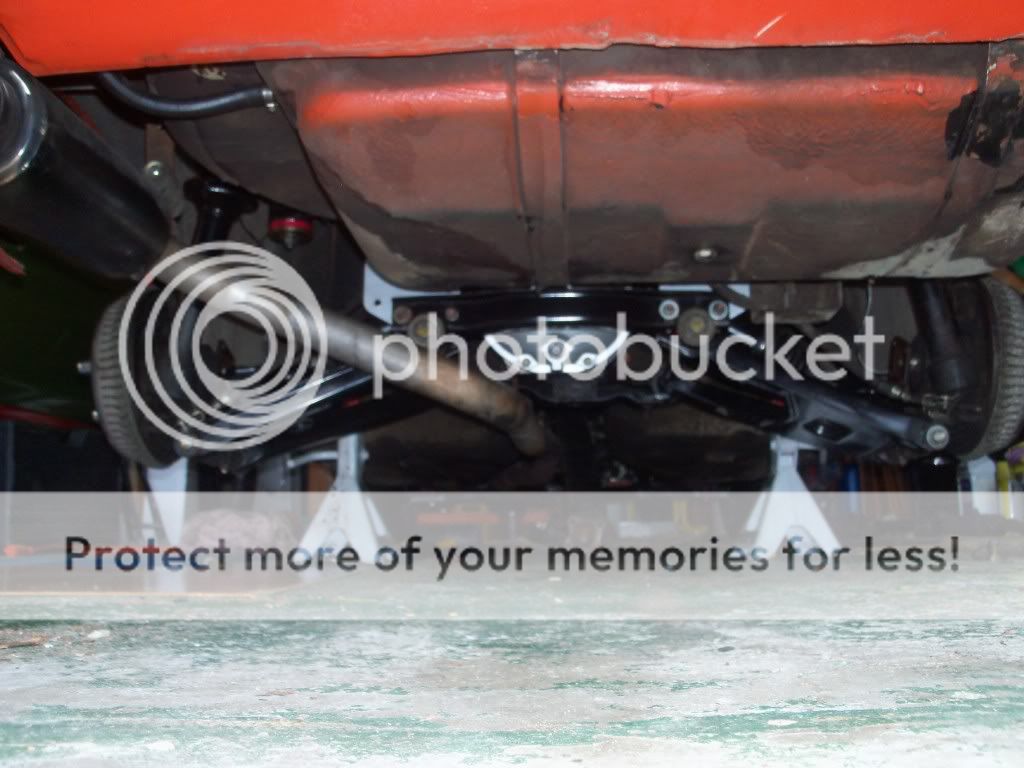

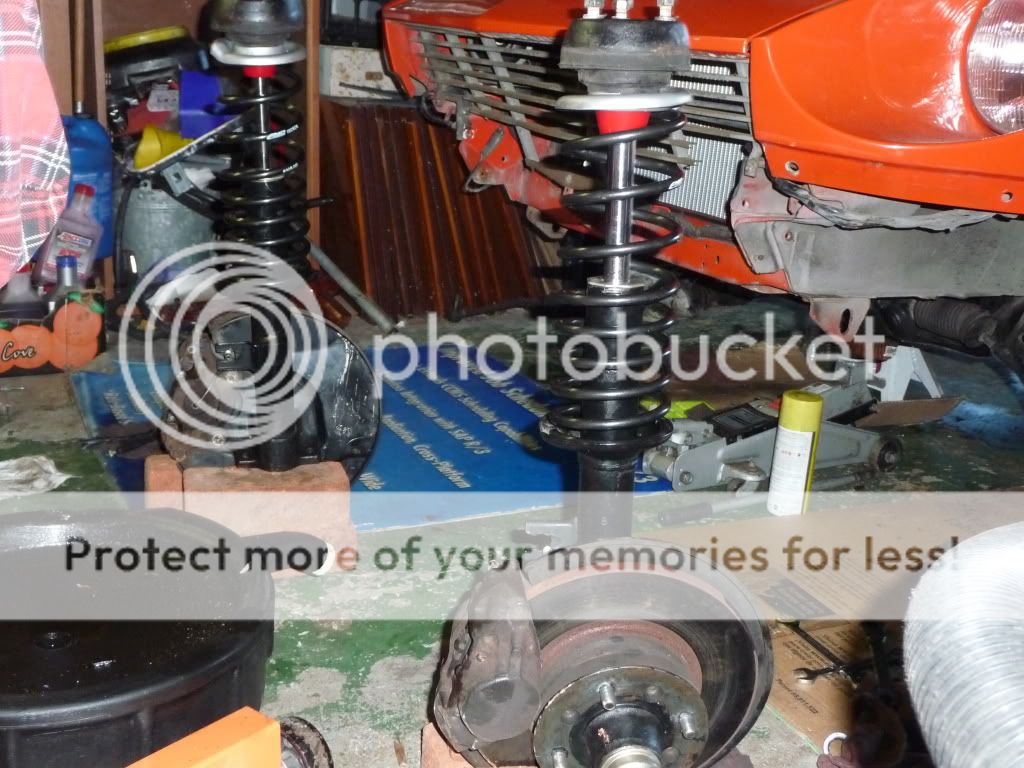

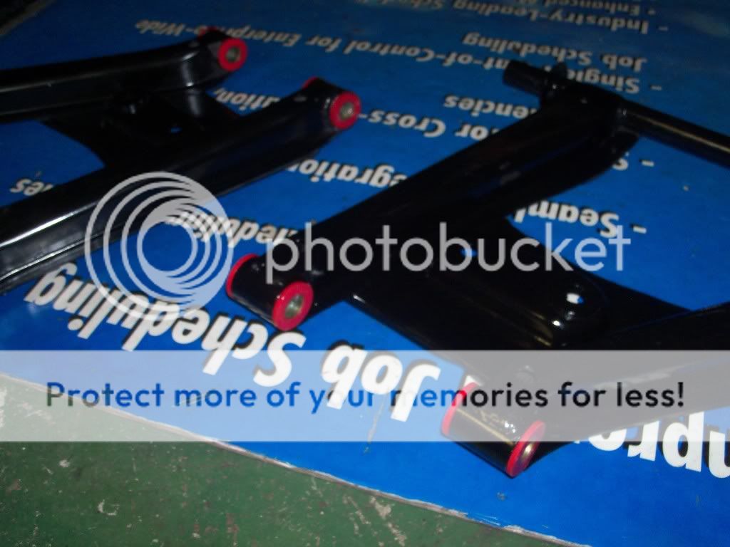

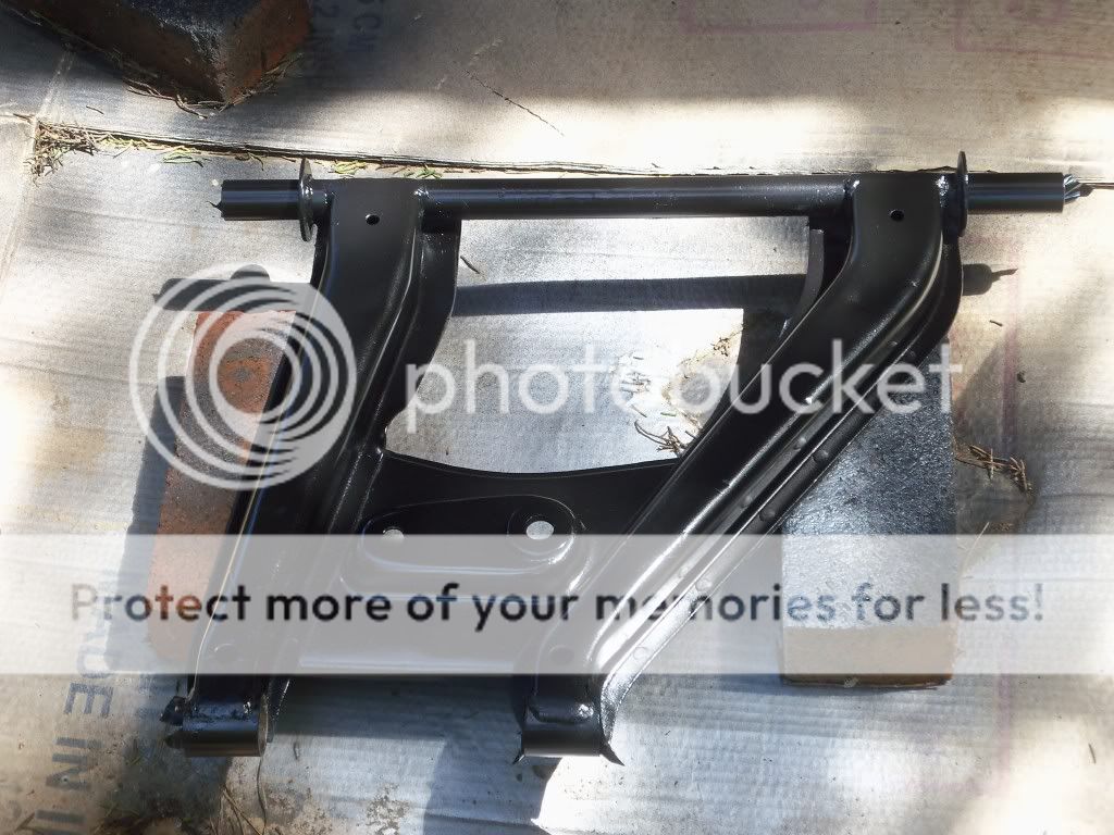

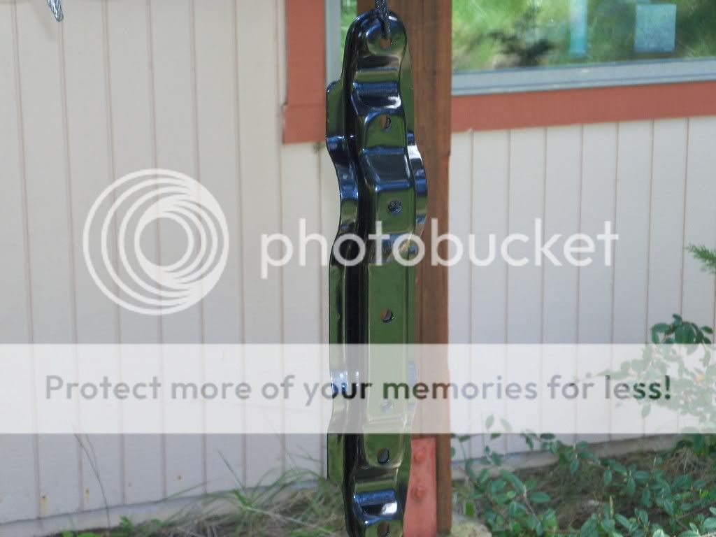

I mentioned that the car was lowered, but the way that it was done was by cutting the stock springs. The rears easily bottomed out and there was a lot of squat on acceleration. It definitely did not ride well. I decided to change the shocks and springs, but of course that turned into a full-fledged suspension rebuild. Over the course of the first 5 months of 2011, the car was down for Eibach springs, Tokico HP dampers, poly bushings, ball joints and tie rods. I painted the parts while I was at it, and switched out the 3.54 rear diff for a 3.9 R200 I had.
I did the whole suspension but didn't take very good pics of the front. I apologize for my crappy camera as well!
Front
Rear
Old
Smoke 'em out!
Diff crossmember
Control Arm
New spindle pins
Poly bushings
Looking good
Before
After

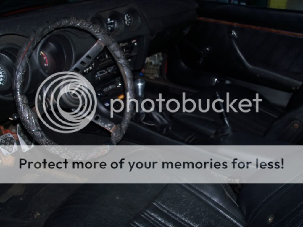

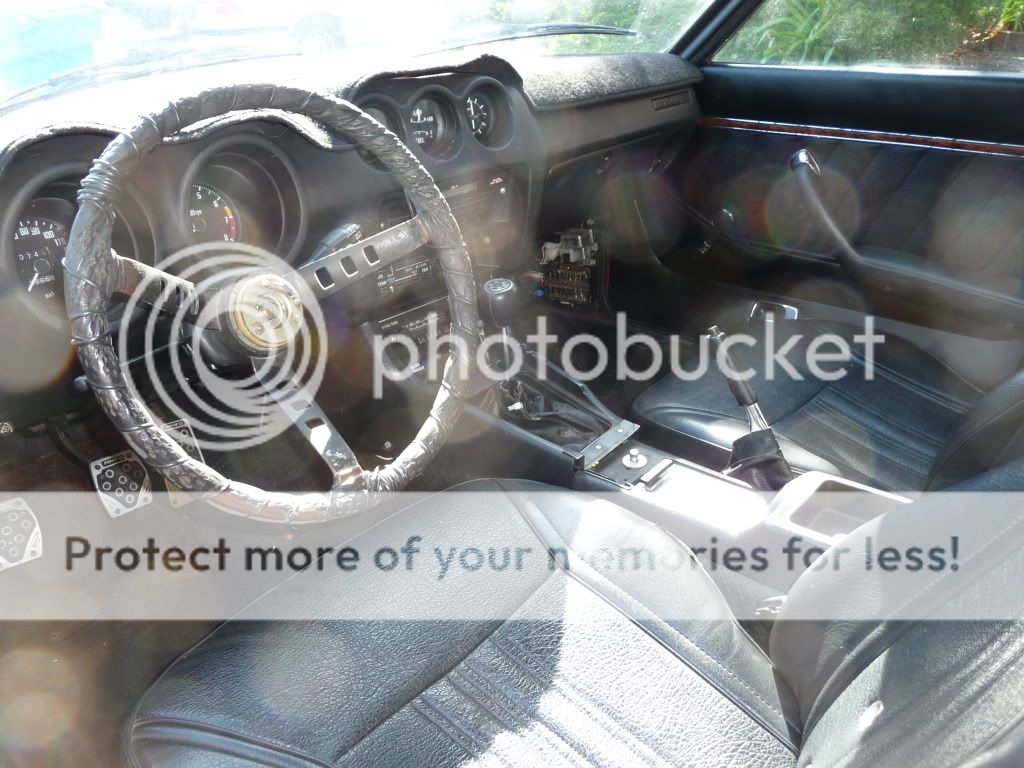

At the same time, I fixed up the interior. It was essentially complete but the center console was absolutely butchered. I replaced it with a brand new console, new shift boot, ZTek billet shift knob and a 240Z steering wheel (looking for a Momo now).
Old
New (need a better pic...)

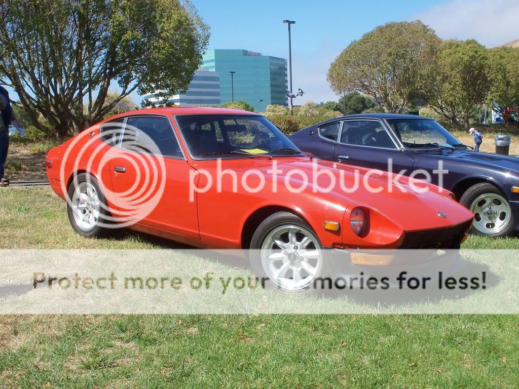

The Z was getting even closer to where I really want it to be. It was dropped back on its wheels in the end of May, go it aligned early June and drove it a week until I got some new wheels!
I attended the ZONC show a few days later on July 10th, the first time actually taking a Z to a meet or show of any kind!

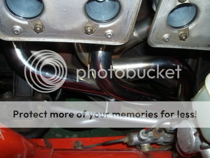

The exhaust setup is a Nissan Motorsports header with long, equal-length primaries dumping into twin 2" pipes, with two glasspacks in the tunnel and two in the back. I love twice pipes!!!

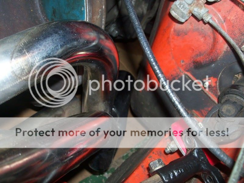

The previous exhaust was just a pipe off the stock manifold to a straight-through muffler at the end. It was loud and had terrible resonance. Currently, each pipe has a glasspack in the tunnel and a smaller one at the end. There is very little resonance, and it's not too loud on the freeway anymore, which is great! I can have a conversation and somewhat hear the radio as well. It's just really loud at WOT, especially past 3500rpm, and while it sounds good I think it might attract some unwanted attention.
The one thing I don't like about the install is that one of the pipes passes under the differential, effectively blocking the rear jacking point. I suppose I can jack it up by the curved transverse link bar (the one that hold the back bushings of the LCAs), but I feel iffy about placing a bending load on that bar since it locates the LCAs.

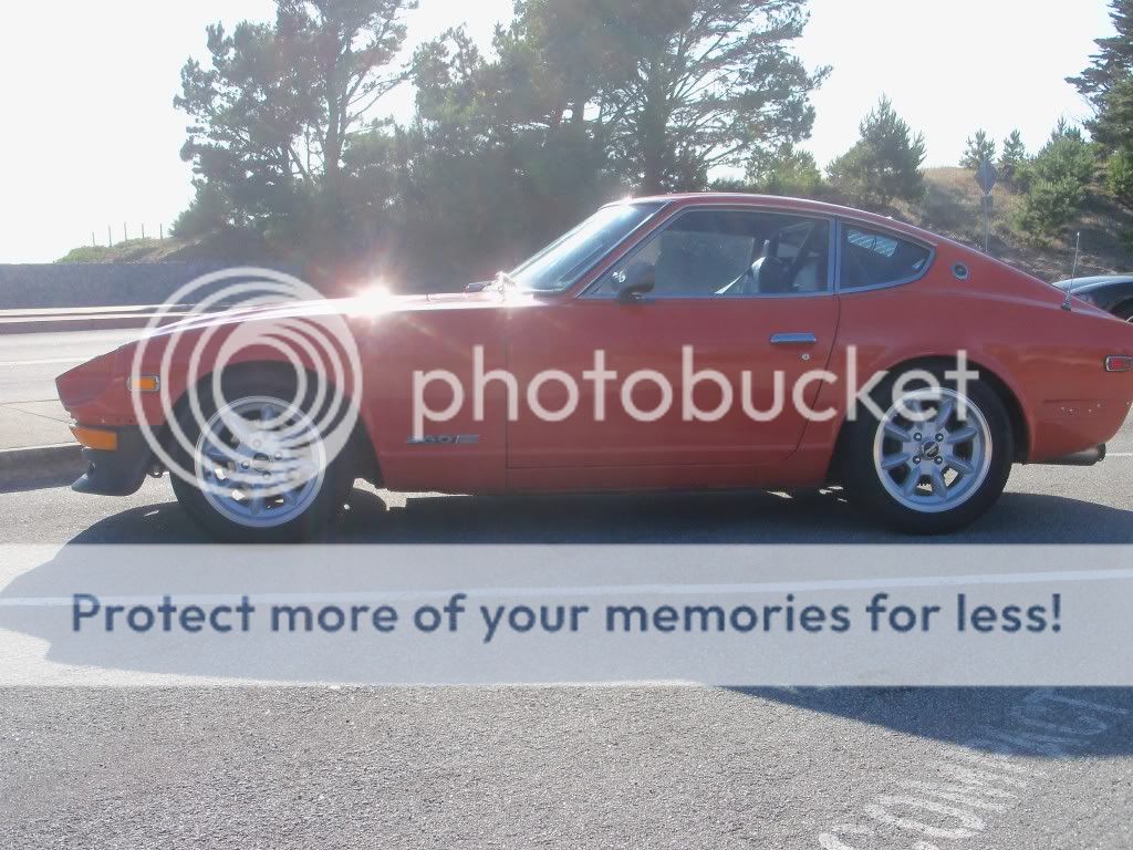

On September 10th, I took the Z to my first autocross! The week before the event consisted of coming home after work and working on to-do items into the night. The day before the event, I was fiddling in the garage until 2am. Then woke up at 5am to go to the track...
The event was a "test day" at Infineon, which consisted of punishing the car on a course set up in the paddock at Infineon Raceway for 4 hours or so. I drove the Z an hour there and back, and it survived. Goal 1 completed.
Early start, on 101 North
Almost there!
Here we are, I drove up with a friend of mine in his Mazdaspeed3
As an aside before continuing, I've been dealing with vapor lock/fuel issues recently, so I taped a fuel pressure gauge to my windshield on the way to Infineon. You can see my "custom pressure gauge mount" in the next pic.
Custom Pressure Gauge
I'm running the stock mechanical and electrical fuel pumps. I found out that under moderate load, pressure drops until it hits zero. After driving on the freeway for a while, it tends to hesitate especially when climbing hills. I drove with the hood popped which may help a bit, but the issue persists even in cool weather, although heat does exacerbate the issue. I'm planning to install a Holley Red that I have and hopefully it cures the problem, along with the heat shield that I'll be making.
The day was a ton of fun. About 30 cars showed up, with everything from a Cobra replica, to the typical Miatas, to a supercharged El Camino. In the morning, the course was split up into the "A" section and "B" section and we ran each configuration for over an hour. There were some really cool people at the event, with one guy letting me flog his Porsche Boxster around the course. I have to say, that car really surprised me. Outstanding handling, outstanding brakes and great torque, even for a "base" Boxster. Very impressive car. Adding to that, his friend let me take his Lotus Elise around the course a few times as well. Great guys and what a blast!!!
At lunch we took some parade laps around the course, and it made me really itch to stretch the Z's legs on a full road course. That definitely needs to happen in the future.
After lunch, the A & B sections were combined into a full course and we ran it for a few hours. The Z began to struggle when doing the full course (45-50sec). It was warm, but not really hot out, but after a run or two it would start to hesitate at the end of the run. If I stringed 3-4 runs together it would just stall at the end of the course and not start for 5-10 minutes. I did get a couple of nice, satisfying runs at the end but there is plenty for me to work on.
Here is a video of a not-so-good run of mine. You can hear it start cutting out half-way and again towards the end of the course.
Nearing the end of the event, I retired the Z and started bumming rides with those that were left. Got to ride along in some sweet cars, including an '80 Porsche 911, '00s Miata (awesome car), and a prepared beast of a Porsche 914. It was a long, very fun, memorable day! Goal 2 completed. :2thumbs:
