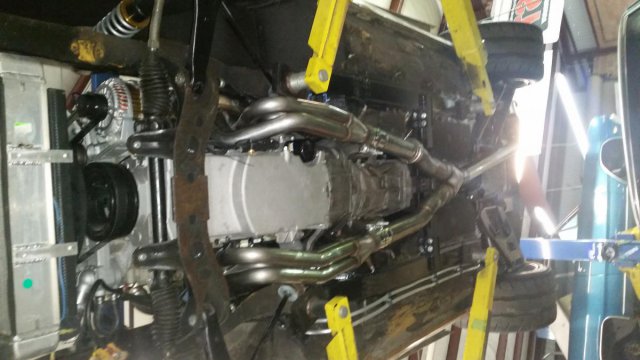

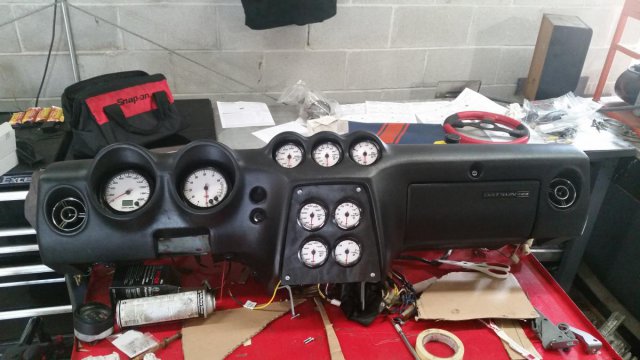

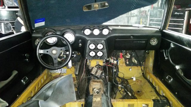

The harness for the car is now back.  Gauges are installed in the dash.  For now all gauges will be in the dash, I am potentially working on a triple gauge pod for the driverside windshield pillar.  ( working with a friend..) I sent the Supra in for AEM v2  standalone.  I just might have a chance to get it back before the end of the year.... but I am not holding my breath

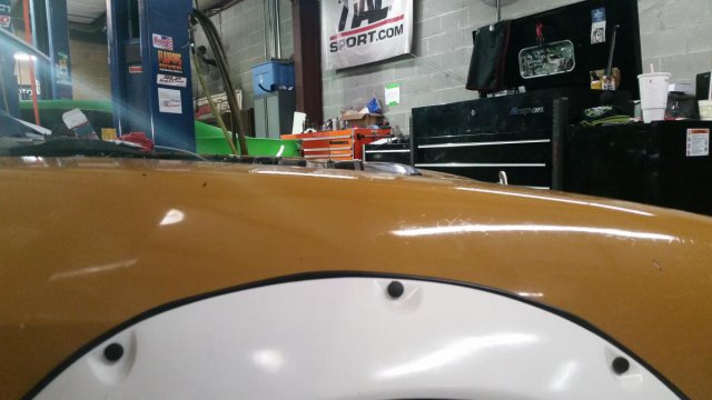

Just some clean up left to do.  But I like the silver.
I know the feeling man, mine was the same way except my doors were good and I was able to find a pair of brand new OEM fenders. You would be better off buying a good hatch for it than spending a bunch

The dash is back in, all gauges are installed in their present location.  There will be some eventual changes on locations ( I will make a triple gauge pod for the driver's pillar as well as a custom piece for the dash where the HVAC system was originally).  I am adding sound deadening materials to the car as I can or as I have them available.  We took the OEM heater and all associated heating equipment out as I am going with a Vintage air system eventually. The car will hopefully start up tomorrow, at the very least this week.  Then a once over before the dyno and street tunes.  I am heading out to Nebraska tomorrow for a few days of work.
