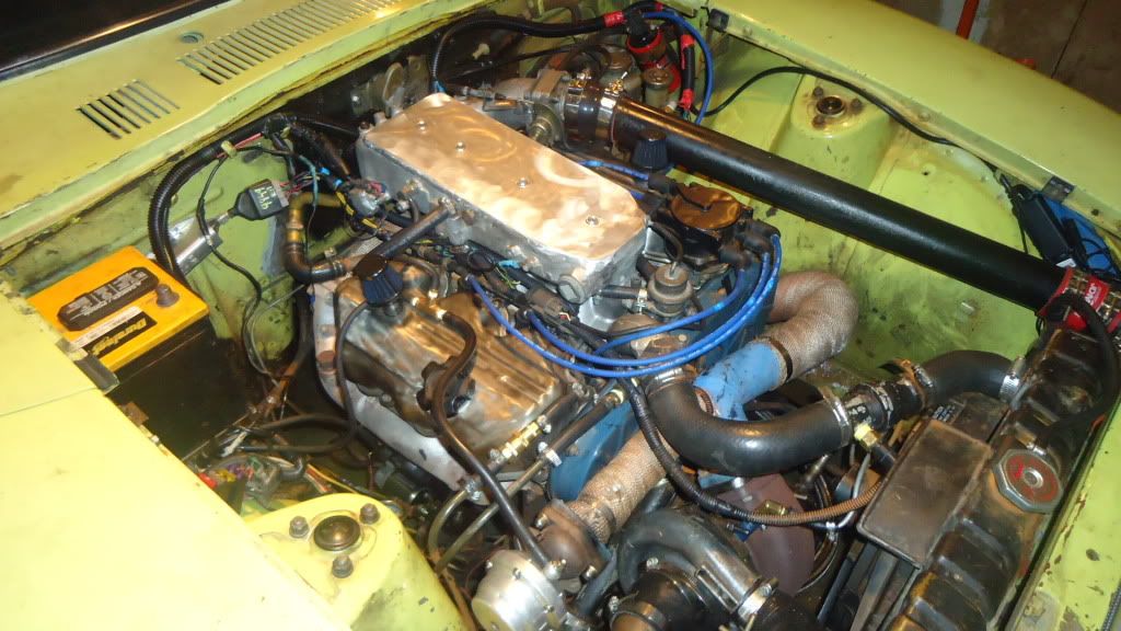

Awesome man, there seems to be a few of these swaps catching on- I'm in the midst of dropping in the same motor in my 280. Would you happen to have build pics showing mounts, relocation pipe, etc.? Running megasquirt? Noticeable lag with the added piping for the turbo? Keep us updated with the progress, cheers
Cool. Yeah it seems that more people are coming out of the woodwork with these swaps. I'm just finishing mine up here too.

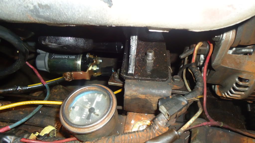

How did you get the alternator to fit? Is the motor raised enough? How high is the crank bolt from the crossmember? Mine is as lower as I could get it--the belt comes off with a bit of effort, the clearance is that tight.
The alternator cleared fine after I cut the stock motor mount bracket off of the crossmember. My Crank pulley is just under 2 inches from top of crossmember. The tightest clearance would be between the turbo relocation pipe and the steering shaft around 1/2 inch.As far as the motor being the right height I just lowered it as far down as possible after locating transmission mounts, everyhing fits good.I have driven this setup for about a year with the stock ecu with no clearance problems. Now it is Megasquirt time, so I can take advantage of my big turbo.

It's only worth it, in my opinion, if you put the VG30ET in. And to do that, you need to figure out where to put the turbo (this guy and me), or move the steering shaft (like ZR8ED).
I just finished my swap and am still working on small stuff. I haven't really been able to drive it and have fun (mostly just tuning and worrying about breaking things). I think I blew mine up as well, but it's in storage for an indefinite amount of time, so I'm it's in limbo right now.
Edited by BLOZ UP
That's gotta be the most beautiful-ugly engine bay ever! I mean that in the best possible way. :-D
I've always loved VG conversions. Sure the NA doesn't make a ton of sense, unless you're only shooting for 200hp and just want the weight amount/placement benefits. But the turbo motors are beasts! Always love seeing more swaps done.
