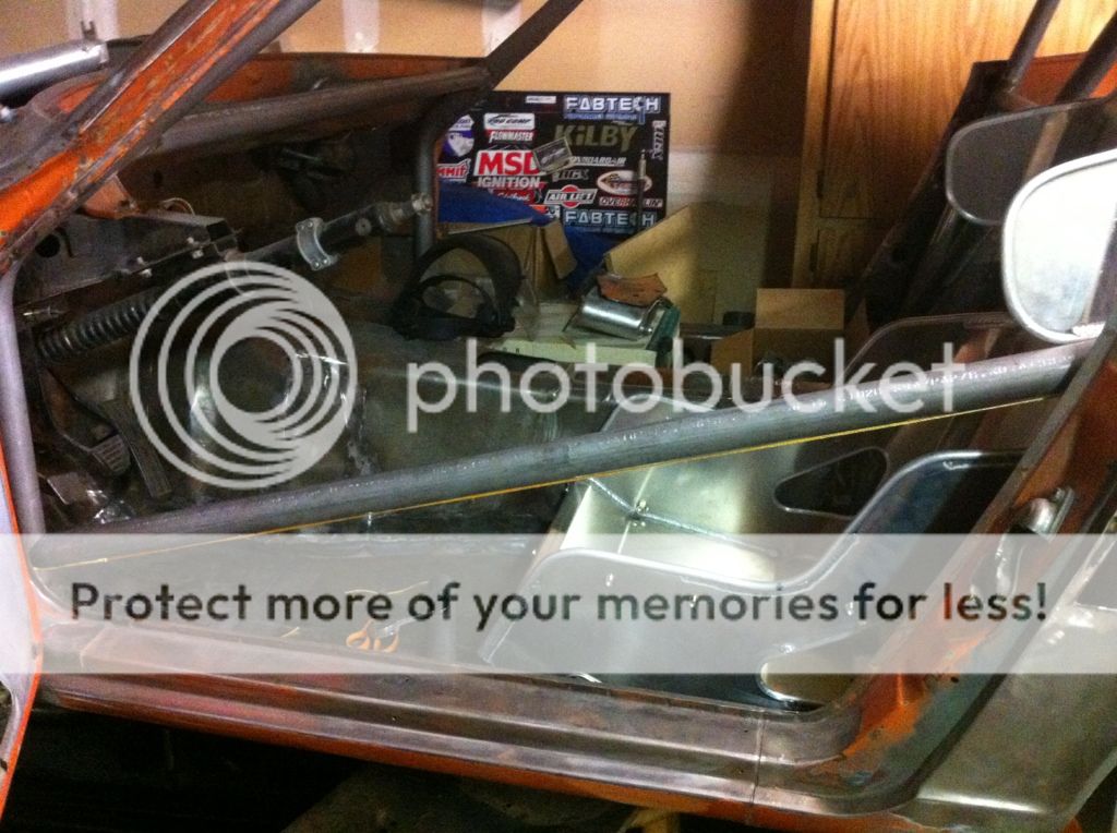

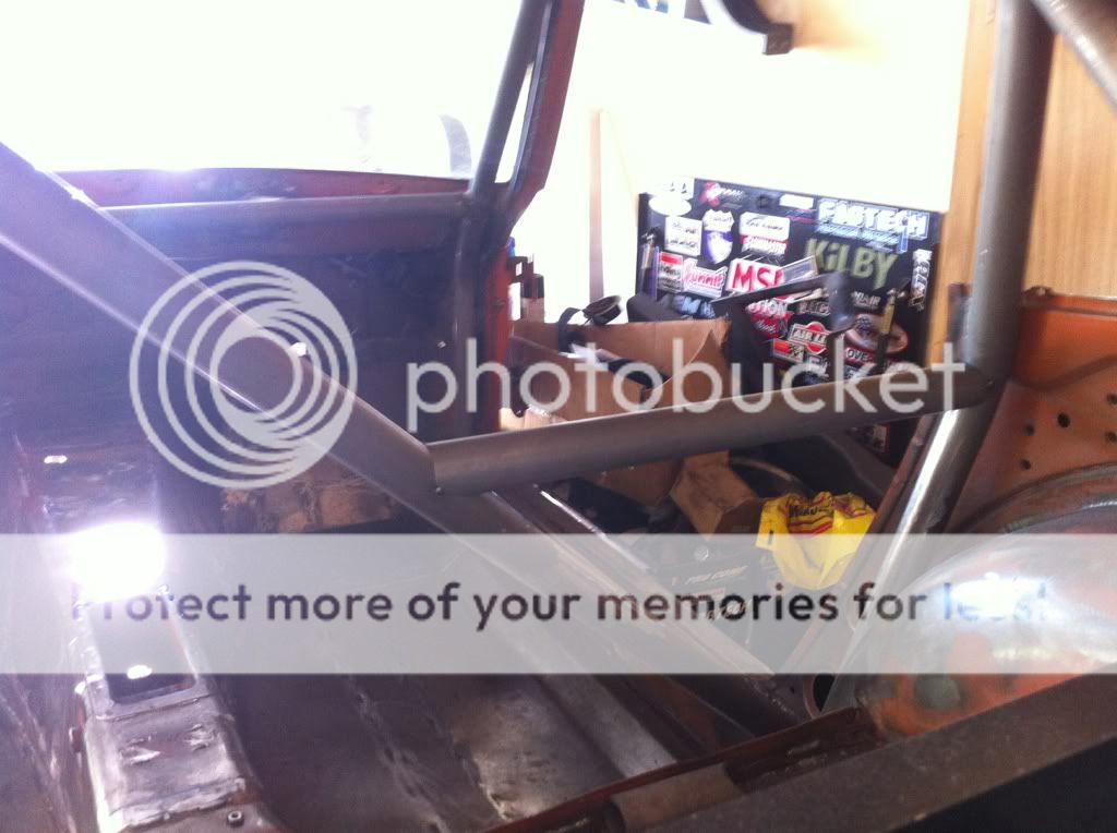

Well it has been a while. Had my second kid on Sept. 1st. So was very busy for a while. Also bought a new Jeep and had to do some building on it. But I am finally back to my madness. Started doing the door bars tonight. Had to cut the body out for welding access of the cage. Guess thats what i get for making the cage so tight in the car.
Enjoy!
This is why I had to cut the body
DEF6719C-C468-4730-BA94-E2198CD052F1-127
Here is the first design
Just at lower shoulder
E002211F-2959-43E6-9624-22D934533D2D-127
Second option
Lowered the door bars at the seat side a little
over an inch.
Prob going to do this option long as all is legal. I have to double check the rules later before i start putting them in. Still got to hang the doors.

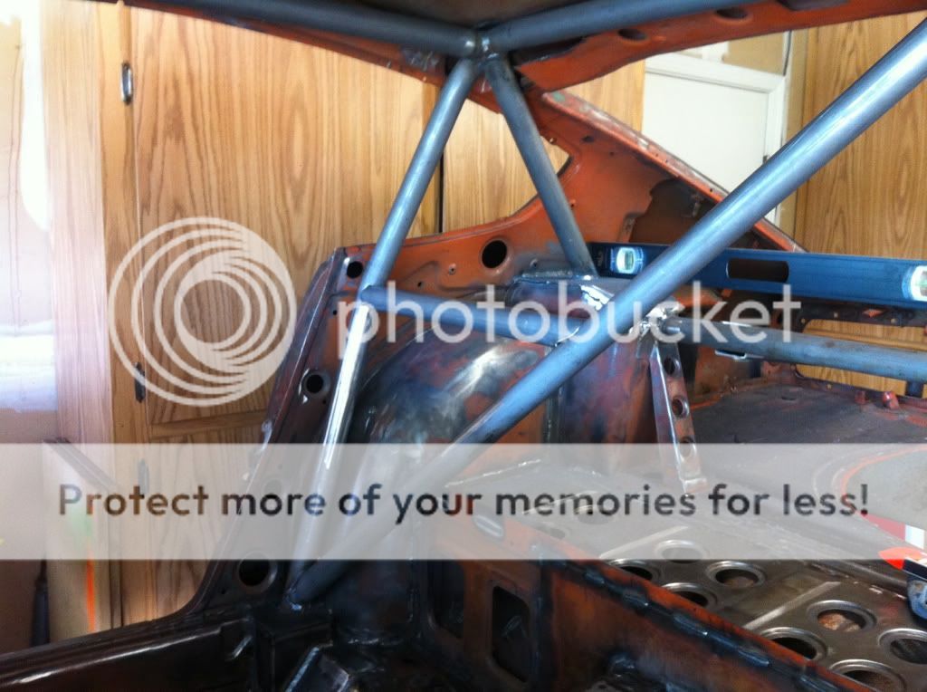

Tonight only got yo work on the car for sbout an hour. Got one door bar notched and pre-fitted. Still need to put a slight bend in it to give me a little more room. Tomarrow will hopefully get the othe section mocked up and tack weld everything into place.
Enjoy
72A08AED-27A2-4450-AD6C-9CB5B8015A5D-135
Nice tight notches
8E4E0D6A-B2E4-49C0-82F8-92DB5E6667BA-135
9B51F26E-495B-4A22-90F5-F6E92E2918B0-135
