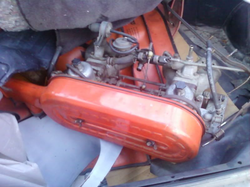

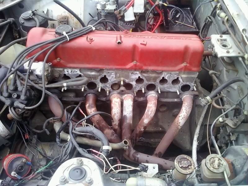

I then proceeded with the carb install...

Annd....SUs with temporary fuel line setup......it has the proper fuel rail and such now:
