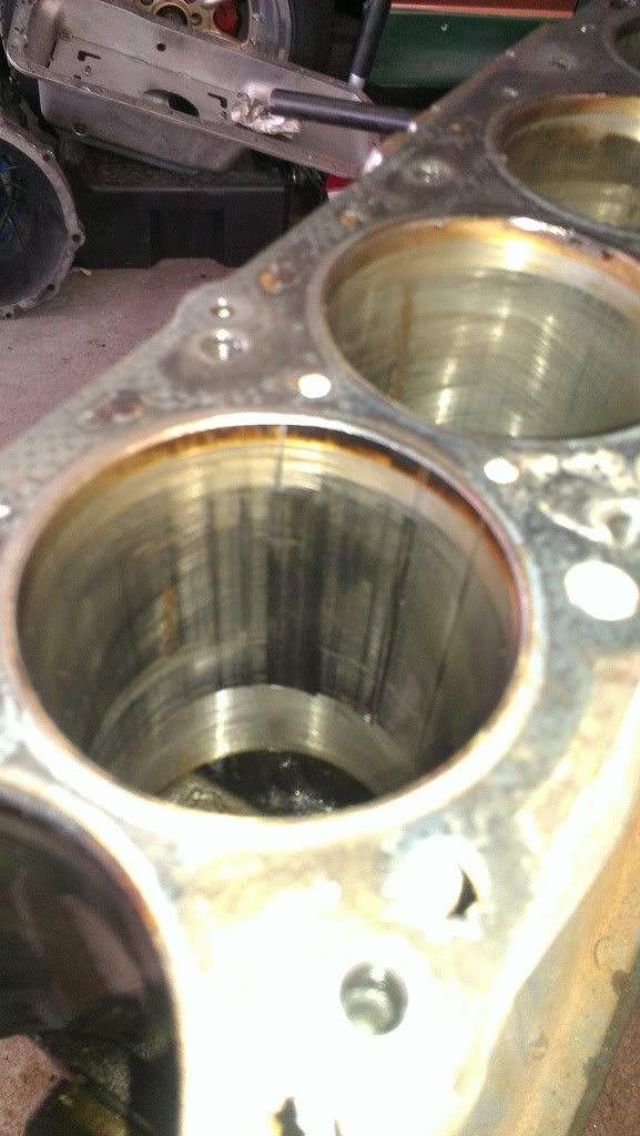

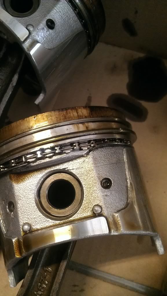

calpoly-z Posted August 12, 2012 Author Share Posted August 12, 2012 Finally got around to tearing the short block apart and discovered the culprit. Cyl 3 lower oil control ring was pretty mangled up, destroying the piston and deeply grooving the bore wall. Definitely going to have to find a machine shop locally. I'm already bored .5mm over so hopefully it only needs another .5mm of bore to remove the grooves. I know +1mm pistons and rings are available, but I'm not sure thats going to be enough to take out some of these grooves. Anybody know what the largest oversized pistons that are available for a standard crank L28? Not sure what would cause this to happen. I assume I screwed up somehow when assembling this engine several years. Any idea what I did so that I can avoid this issue in the future? Quote Link to comment Share on other sites More sharing options...
Xnke Posted August 12, 2012 Share Posted August 12, 2012 ITM pistons are available in +1, +1.5, and +2mm, I think. If you have a set of L24 rods to prep, then some of the truck pistons with a 35.5mm pin height are available in a dished piston as well. Quote Link to comment Share on other sites More sharing options...
Lazeum Posted August 12, 2012 Share Posted August 12, 2012 I see 3 explanations: - Defect in piston casting (very unlikely) - Ring gap was not in spec - Ring did not overlap properly the center wavy ring (I forgot the correct name ) Quote Link to comment Share on other sites More sharing options...
calpoly-z Posted August 12, 2012 Author Share Posted August 12, 2012 Good to know that pistons should be available regardless of how much needs to be bored. All I have are the stock L28ET rods right now and they have already been balanced and prepped with ARP studs so I would prefer to stay with them. The main issue I think I'm going to face now is finding a machine shop locally with some experience working with these engines. West Texas is pretty much a domestic only market. Quote Link to comment Share on other sites More sharing options...
