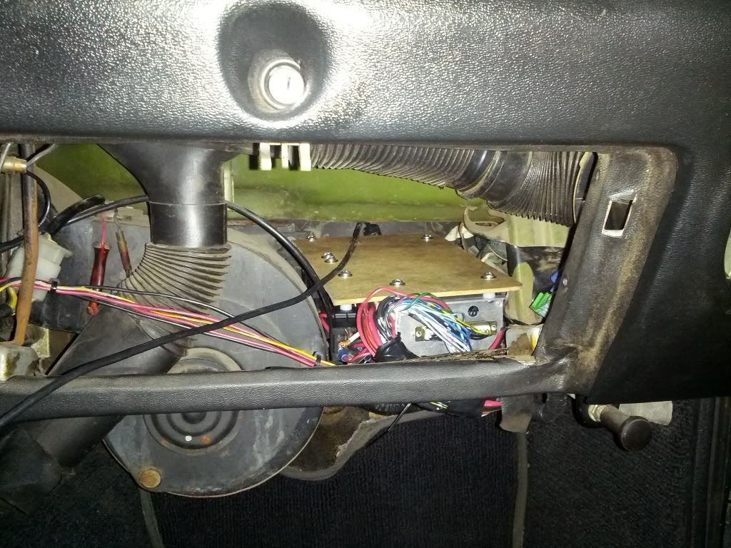

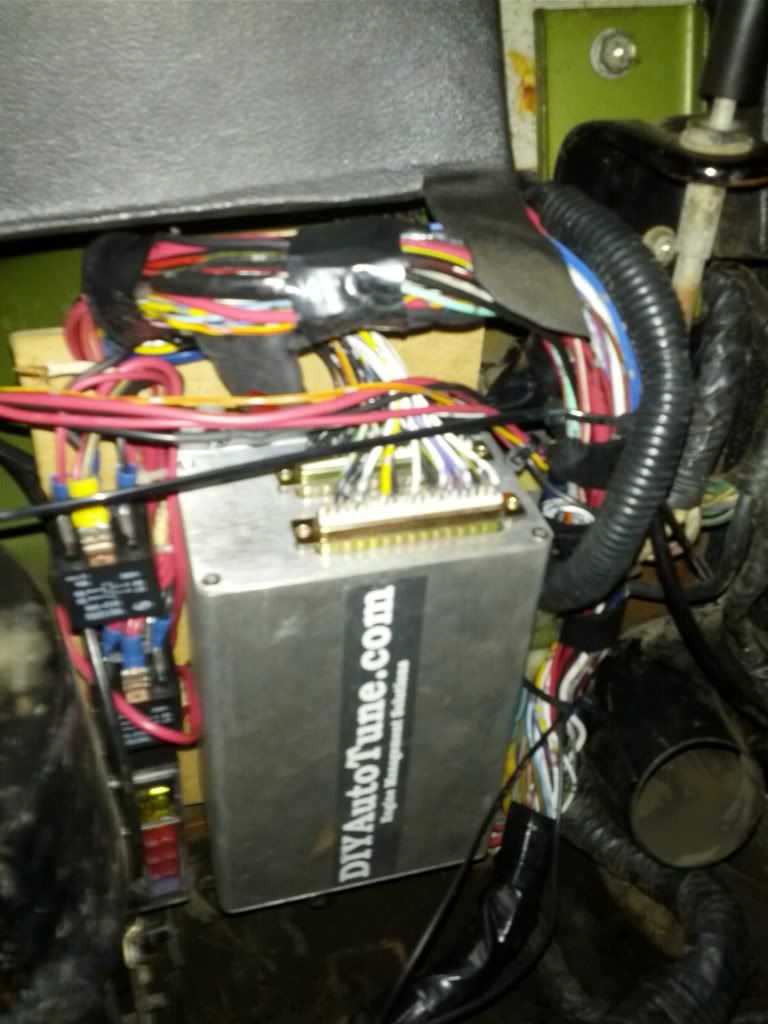

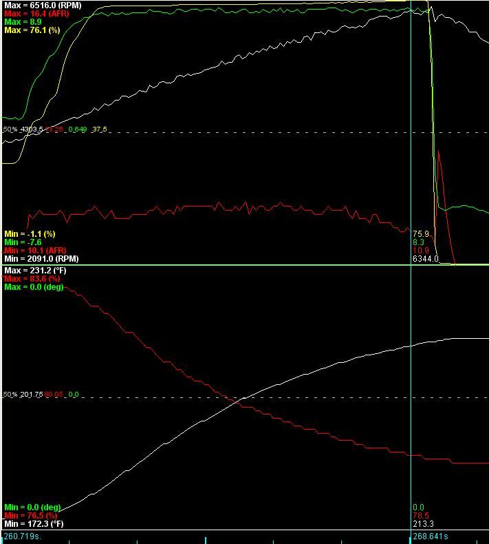

After I got the wideband hooked up, I couldnt get it to rev into boost without it leaning out. I traced it to the injector resistor being wired wrong. I fixed it and had another issue, it would randomly cut out and shoot huge fireballs out the tailpipe. I read some things online and turned on the noise filtering on the Megasquirt and got it to not cut out. I guess the wiring is a little more noisey than the Skyline was in Oki. Now the computer is tucked up under the dash where it will be perminently. I also installed an MSD tach adapter to get my tach working. The stock tack is off a little, it will read 6500 at 6000rpm. I had to wire the power to the tach from my internal ECU power or it would keep the car running after the key was turned off, that was a suprise when I took it to the PX, haha. The tune seems to be coming along, the fuel map seems to be working its way out. Its starting to looking like like all the other MS L28ET maps I have seen on the net. One thing I really really need is an intercooler. Blasting down the 15 freeway today at 100mph, boosting 8psi, check out my Air Intake Temps, 213*F, haha. It also doesnt help that the turbo had no intake pipe on it and its sucking in heated air from the exhaust mani. The injectors are at 50% duty at full boost/rpm right now, so I estimate with an intercooler I would be at 200hp at this boost level (8psi)
