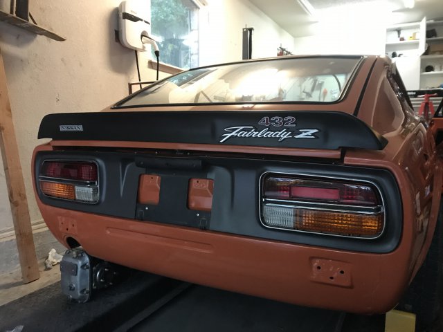

Well, it's been a while since I've updated my progress and as with most of us life has gotten in the way of what I want to be doing which is finishing my Z.  Here is where I am now:
Dash is in
All electrics lights, wipers, etc. are installed and work (however both wiper and headlight switches are a little glitchey but will do for now)
JDM Tail lights are rewired to light properly.
Brake system is installed completely (just needs to be bled)
I found some Sumitomo MK63 twin piston brakes that I believe are a direct bolt-in option for the Z's of this era.  I'll get some pics in the next few days.
The fuel system is in process now.  I am just waiting on a couple of ordered parts to get the tank in.
Once the fuel system is complete I'll be ready to drop in the drive train.

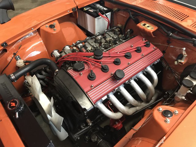

The motor is engine dyno tuned and broken in and ready to go at 209hp @ 8,300 on pump gas.  With a redline of around 9k rpm!  I have a sheet I'll post soon.
My goal is to have it done by christmas.
