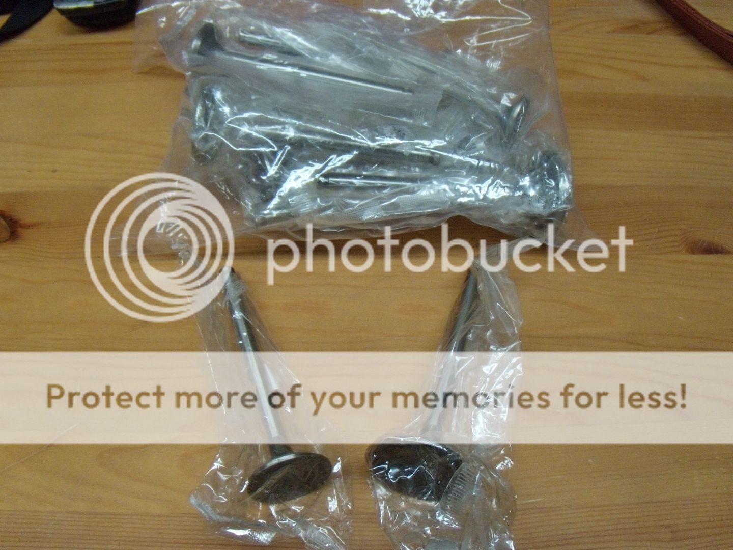

- sourcing longer valves (SI has great prices)

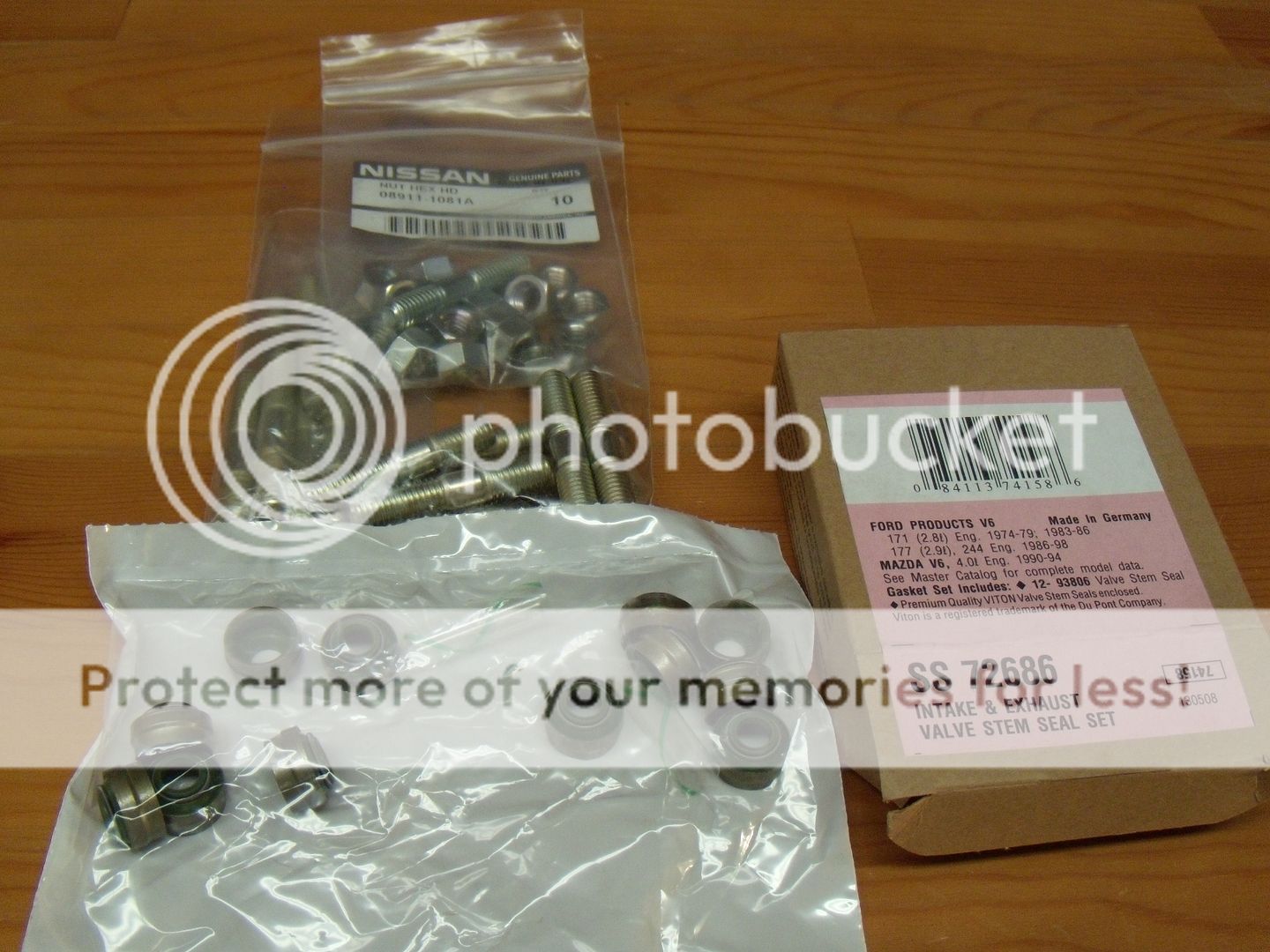

- low profile valve stem seals (FEL-PRO SS72686 bought on ebay)

- Manifold gasket (turns out I have spares)

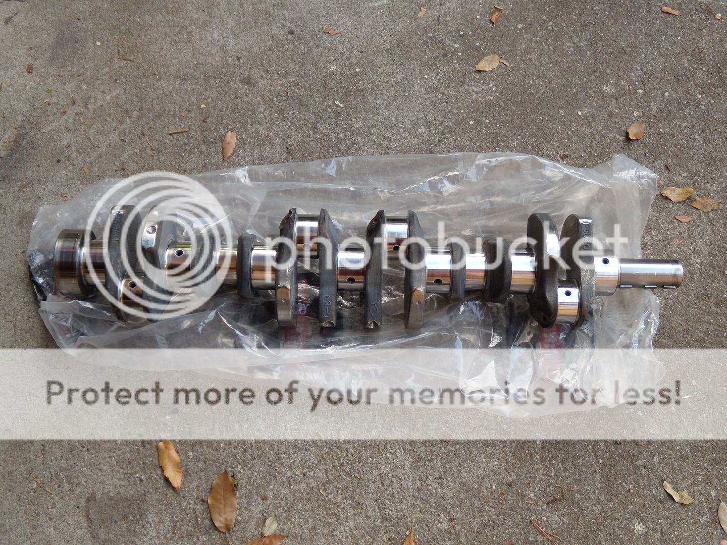

Today, I finally took my crank to a shop close to work who will polish it and send it off to be checked for balance. I'm including the flywheel with it to be balanced as well. Figured the crank pulley should be in balance, but I'm thinking of taking it in as well.

The good news is that I picked up my crank, flywheels, and balancer from the machine shop today. The crank looked great and just needed a polish, the Tilton FW had to be balanced but the Fidanza didn't need it, and the harmonic damper also did not need balancing as I had suspected. This was all done as a double-check really, so it's mostly for peace-of-mind. The bottom end is ready to assemble, besides the main bearings which I ordered today.

Towards the end of Sunday I switched to the head and put the valves into their guides, and worked the stem seals onto the valves. The stem seals aren't fully installed yet, but that's the next job on the head. These Ford seals are a bit of a PITA to do right. Then I can temporarily install the outer springs and check the cam wipe pattern. I'm anticipating the need for thicker lash pads.
