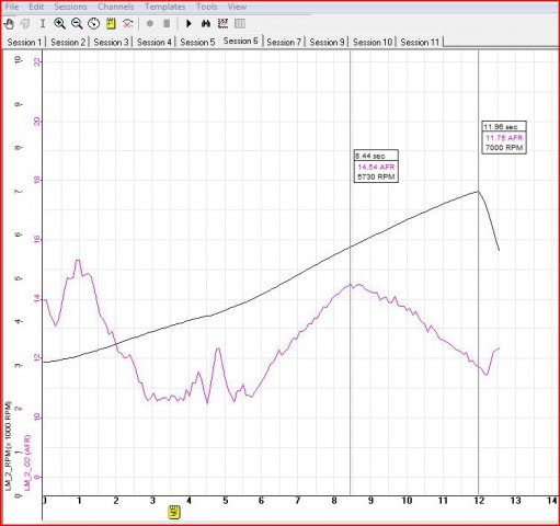

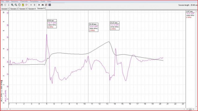

I was able to work on the tuning some more yesterday.  I started the day with:
Main 180
Air 250
Pilot 57.5
Pump 45
Choke 37
Last change was going from 240 to 250 air correction to try to produce a leaner AFR above 6700 RPM. Here is what actually happened - the dotted line is the previous run with 240 airs - the solid line is the current run with 250 airs, both are in 3rd gear:
Interesting that the bigger air jet caused the range between 5300 and 6000 to lean out more while causing the range from 6000 up to get richer.  Isn't that the opposite of what you'd expect?

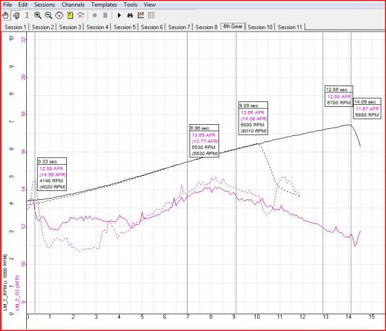

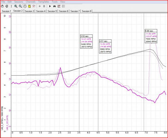

Because the AFRs were at or above 13 for all of the graphed RPM range except above 6600, I decided to try upping the mains another step to 185:
The dotted lines are the 180s from the previous run.  Only the mains were changed - again in 3rd gear.  The AFRs were made richer across the test RPM range.
Here is a comparison of two 4th gear runs.  The runs differ only in that the prior run (dotted lines) had 180 mains.  This run has 185 mains:
Interestingly, when I went to full throttle on the 185 mains run, AFR didn't dive into the 10's as has typically been the case. I am more conscious of the problem, however, so it may just be that I am squeezing to full throttle over a couple of seconds instead of snapping to full throttle.
Since going with the bigger 250 airs richened the top end and leaned what has been consistently the leanest RPM area on many plots, I'm thinking the next step will be to lower the airs to something like 230.  My prediction is that my plot will flatten out - richer in the 5300 - 6000 range and leaner in the 6000 plus range.

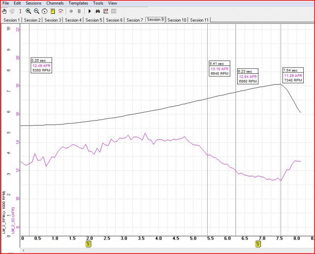

I managed to get a few runs in despite the rain showers.  One goal for today was to check to see if tightening down the intake manifold and header nuts changed anything.  I saw essentially no change due to that.  Next, I discovered that the front carb was being held to the manifold by only the top two nuts.  It took me forever scrounging around my boxes of Nissan hardware to find a couple of 8 X 1.0 mm nuts for the carb isolator studs - what an uncommon size!  I also changed out the pumps to 50's because I have seen that anything less causes a spike on full open throttle for the tuning runs I have been doing.  Here is a comparison of 45's to 50's:
The brief "jump" to lean at WOT, is essentially gone with the 50's.
This is a run in both 3rd and 4th:
It's not exactly easy to see, but the AFR curve is actually very consistent - just compare the same RPM in 3rd vs. 4th.  As you can see with the stat markers I have, it doesn't matter what gear, the curve is essentially the same.  I've logged a large number or 3rd and 4th gear pulls now, and I have overlayed them and compared the differences.
Right now I have this combination in the car:
Main 185
Air 250
Pilot 57.5
Pump 50
Choke 37
By looking at 3rd in this chart, all I am dealing with is revealed.  Even with many main fuel and air correction jet combinations, the shape of this curve generally does not change.
I have low 14's at steady state cruise 3100 RPM in 5th.  I have low 13's at steady state 4600 RPM in 3rd.  I can snap open the throttle at 4600 RPM in third without a lean spike.  The AFR drops very briefly to low 12's, then climbs.  It crosses over to the 13's around 5200 RPM.  5800 RPM is often the peak in lean AFR around and is about 14.4.  Then AFR turns downward again.  I don't see below 13 until about 6500 RPM.  AFR keeps marching downward linearly from there until about 7000 RPM - where it hits low 11's.  It does pretty much level off right at 11... I have rarely been going much above 7200 for now.
Since low 12's for WOT through the power band of this cam is the goal, my next move will be to throw some 190 main jets in.  250 airs are as big as I own at the moment, but it looks like I'm going to need to buy something bigger.
300 airs is the largest size - I am at 250 now.  Perhaps I need to start thinking about some larger outer venturis to reduce the "pull" on the aux venturi.

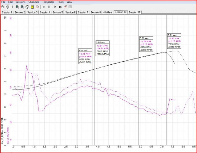

Spent the time to adjust the accelerator pump lever throws to the Mikuni manual spec. - 7.5 mm.  They were about 4 to 5 mm prior to doing so.  I went out after that change and got new baseline curves.  That is the solid line in the plot below.  Interestingly, my lean spike at WOT is back now.
What I had in the carbs for the baseline:
Main 185
Air 250
Pilot 57.5
Pump 50
Choke 37
Also in the plot are the dotted lines which is the change to 190 mains after recording new baselines (no other changes):
No matter what jets I throw at this thing, I can't get that hump in the middle hammered down.   Stepping up the size of the mains is making the curve richer for the entire RPM test range.  While the bump in the middle shrinks, the AFR at the ends - just after WOT and full throttle above 7000, also descends.
