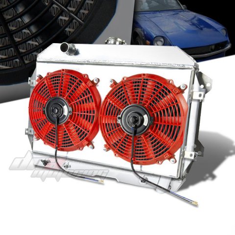

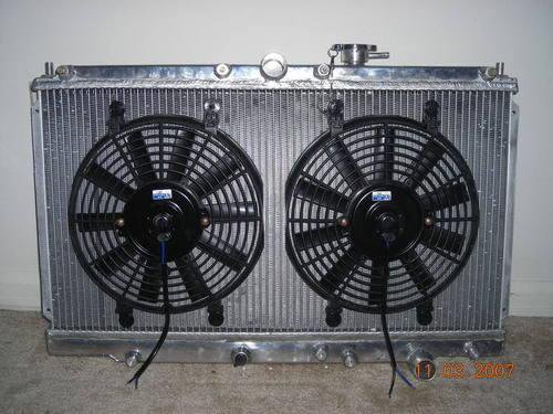

Mace.un 0 Posted February 18, 2013 Share Posted February 18, 2013 Hello, Yesterday my radiator cracked and spilled coolant all over a mountain road. I'm now looking to replace with a 3 row aluminum unit. The only question I have is about this particular unit on ebay: http://www.ebay.com/itm/70-75-NISSAN-DATSUN-240Z-260Z-Z-3-ROWS-ALUMINUM-RACING-RADIATOR-RED-FAN-S-HROUD-/150951825762?pt=Motors_Car_Truck_Parts_Accessories&vxp=mtr&hash=item23256e1162 It looks like the fan shroud is blocking the radiator except where the fans are. Is this ok? I could also get a radiator without this fan/shroud combo and just get some universal electric fans that zip tie to the radiator. Like this: Is that fan shroud helping by accelerating air through a smaller opening or just blocking the flow? If anyone has any experience with this particular ebay radiator that would be of great help too. Thanks Quote Link to post Share on other sites
PLATA 19 Posted February 18, 2013 Share Posted February 18, 2013 (edited) I have this Ebay radiator , a 3 row , fit with no problem . My fans are from a 02 Camaro, 3 K miles with no issues Edited February 18, 2013 by PLATA Quote Link to post Share on other sites
Mace.un 0 Posted February 18, 2013 Author Share Posted February 18, 2013 OK. I googled and the shroud is very important to make the radiator cool correctly. According to what I read other people say about fan shrouds, it blocks air from going around or under the radiator and helps direct air flow through the radiator. Quote Link to post Share on other sites

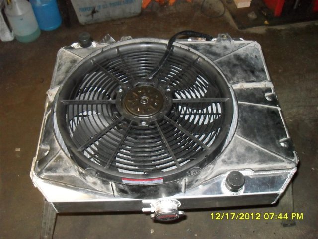

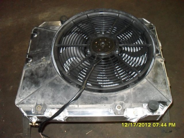

Domzs 9 Posted February 19, 2013 Share Posted February 19, 2013 Here's my Ebay 3 row radiator setup . Two speed electric fan by Hayden . Quote Link to post Share on other sites

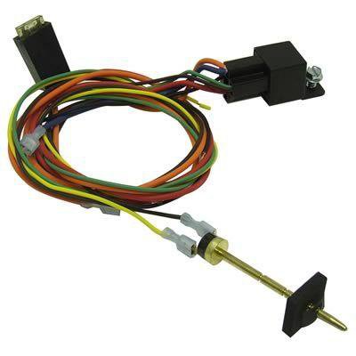

OldAndyAndTheSea 12 Posted February 19, 2013 Share Posted February 19, 2013 I'm ordering the Derale 14" puller fan, with the thermostat harness for my champion. It's like 125 bucks... 150 if you shop MSA Quote Link to post Share on other sites

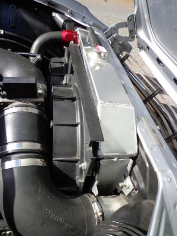

BluDestiny 11 Posted February 19, 2013 Share Posted February 19, 2013 I have both of my fans wired to a single switch, both with relays. I turn them on around town, and I turn them off at freeway speeds. For what it's worth I am using an sr20 rad with fan shroud, total cost was abotu $350. Made some custom brackets for the top and bottom with rubber insulators. Its in a 280zx but should have no problem fitting into an s30. Quote Link to post Share on other sites

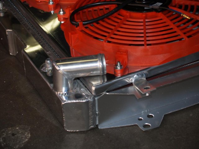

Mace.un 0 Posted March 14, 2013 Author Share Posted March 14, 2013 Well the one I bought from Ebay wasn't much better. Though I got the 3 row radiator, shroud and 2 fans for $253. But upon assembling it all a problem arose: Because they made the outlet pipe have a 90 degree bend, it butted up tightly against the very thin shroud and was centimeters from the fan. This made it impossible to put a hose on it. So it went to the machine shop (I don't weld) and they made a new outlet pipe that actually worked. Good news about the Ebay store I bought from is that I showed them this and the invoice for fixing it and they refunded me a fair amount to cover the cost. DNAMotoring was the store name. So after was all said and done it was still a very economical way to get a 3 row + shroud + twin electric fans. Quote Link to post Share on other sites
