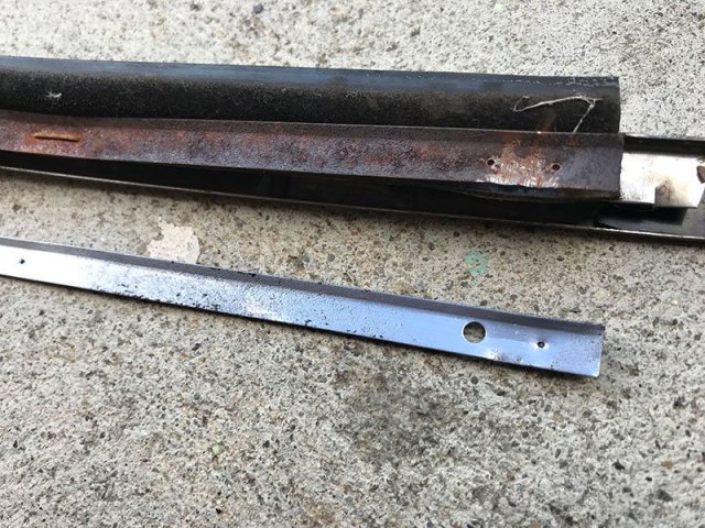

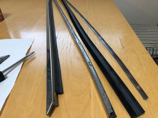

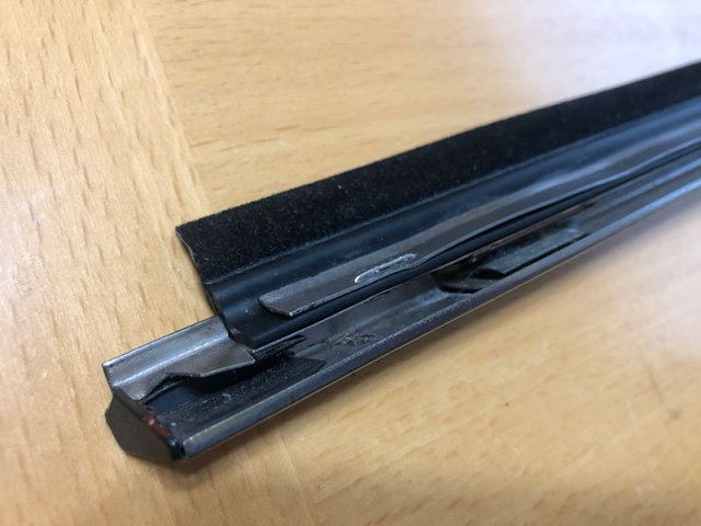

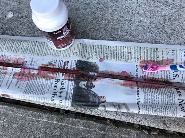

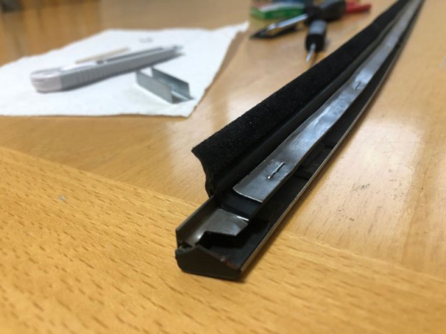

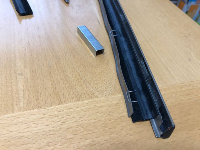

tamo3 2 Posted January 7, 2019 Author Share Posted January 7, 2019 Working on Door Glass Window Run Felt Rubber Seal replacement. There is a metal plate which old the felt inside was totally rusted. Using a wire brush to remove rust and use Rust Resolver gel to remove rust completely. You can see Before and After! The felt was hold by metal staple, but I don't have it. I used T21 instead. Quote Link to post Share on other sites

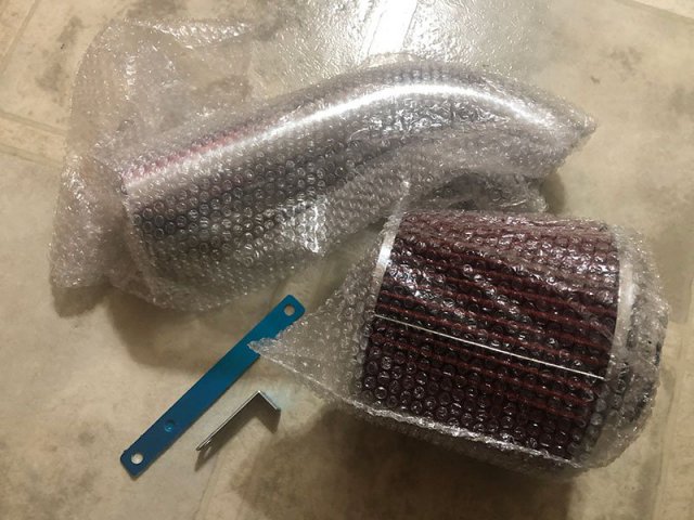

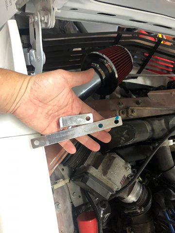

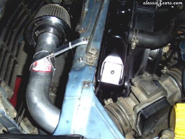

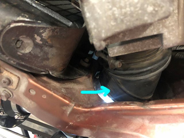

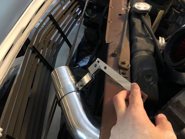

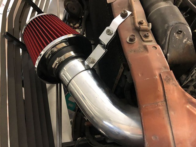

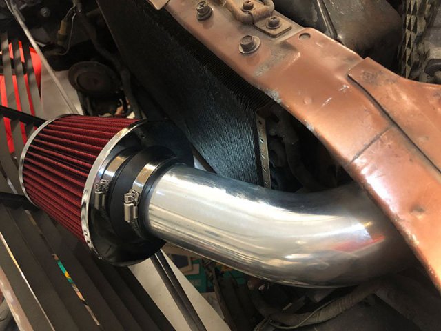

tamo3 2 Posted January 18, 2019 Author Share Posted January 18, 2019 Purchase $39 cheap cold air filter. It comes with air filter, aluminum pipe and small aluminum bracket. The pipe size is too big it won't fit to the rubber boot unless removing O-ring. Looks OK. but without bracket, it's hunging like a d*ck. Plan to create a bracket something like this Quote Link to post Share on other sites

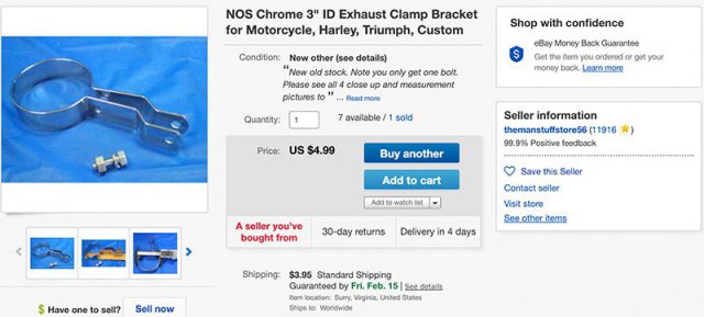

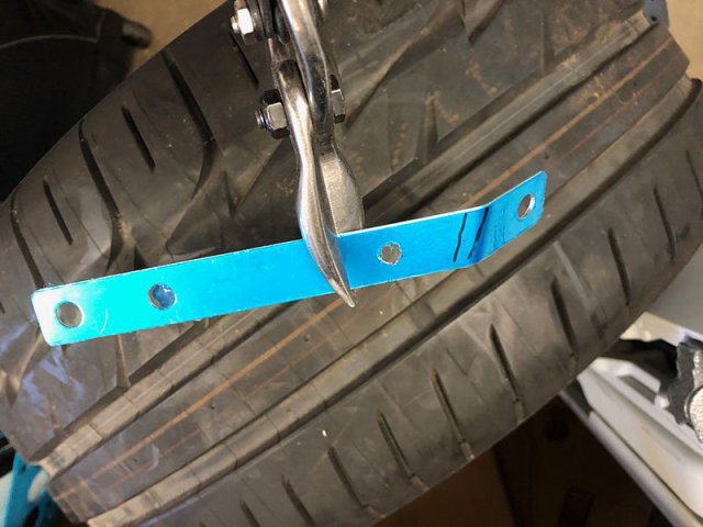

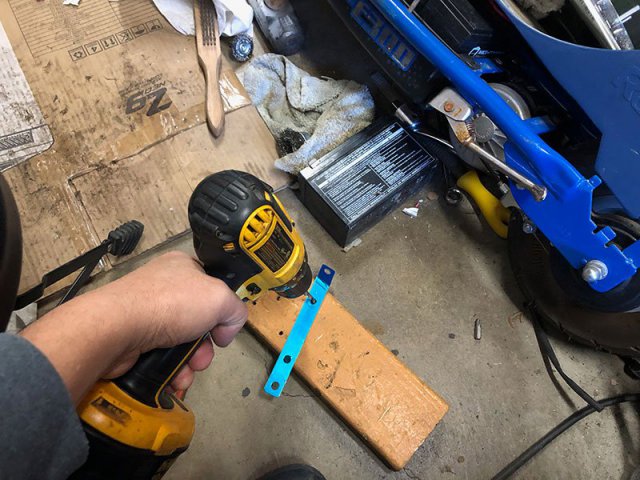

tamo3 2 Posted February 11, 2019 Author Share Posted February 11, 2019 Purchased 3" bracket @ eBay. Test fitting. drilled a hole ¥ Cut it Done. Quote Link to post Share on other sites

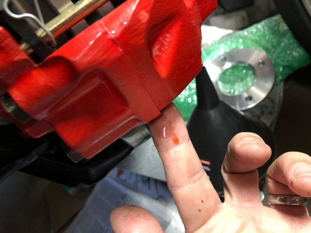

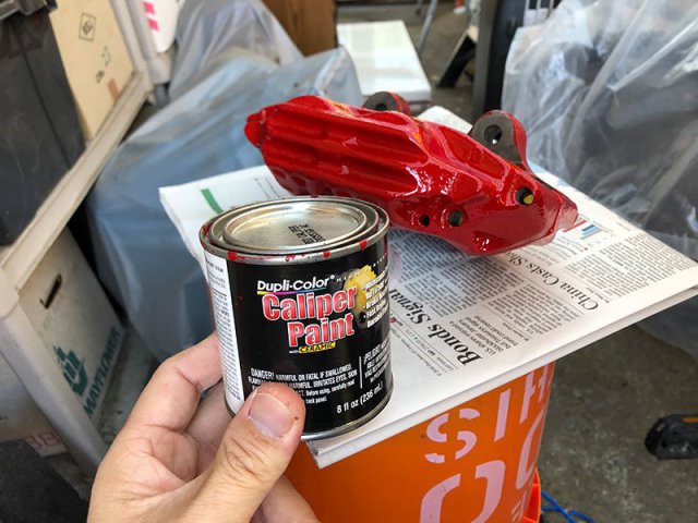

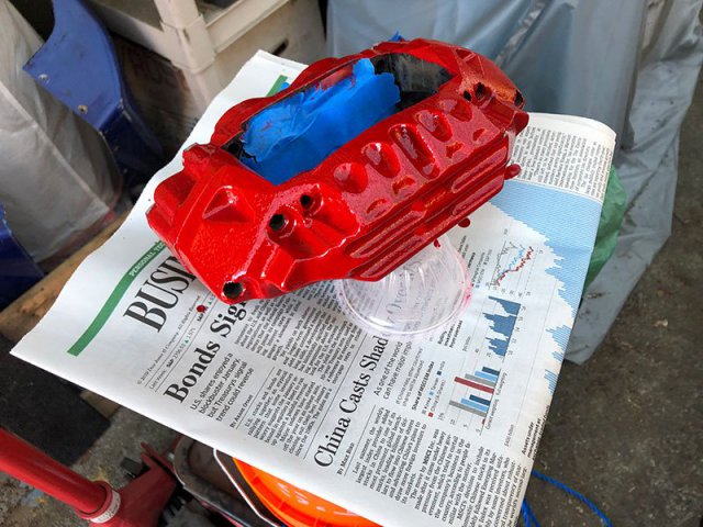

tamo3 2 Posted February 11, 2019 Author Share Posted February 11, 2019 found a leak from front right side of brake caliper. It leaks from the bottom of the caliper. Went to pick and Pull and get another caliper from 4Runner. It was pretty clean and looks like rebuild recently. Use wire brush to remove surface rust and use PRO15 metal prep to clean up. Then, paint Red using DupliColor. Need to wait a couple of days to completely dry. Quote Link to post Share on other sites

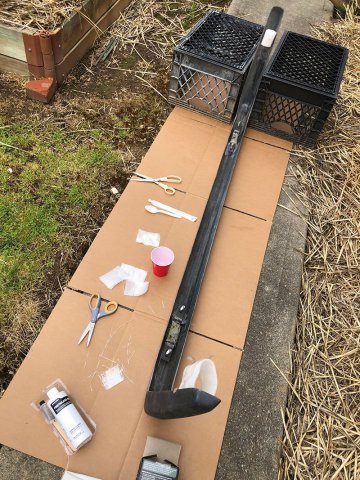

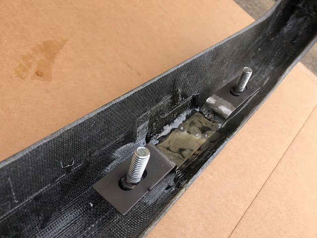

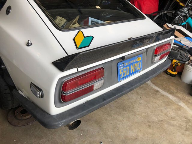

tamo3 2 Posted April 15, 2019 Author Share Posted April 15, 2019 Installing glass fiber bumper. I purchased this bumper long time ago through local Craigslist. For the body side bracket, I purchased from EuroDat @ Classic Z community. It's very strong and fit really well to the body. I welded the bolts to the bracket and put glass fiber sheets. Add a couple more glass fiber sheets to make it durable. Test fitting is great. But I need to think about what I should do for the side of the bumper. I don't have holes to bolt on to the body... Quote Link to post Share on other sites
Neverdone 31 Posted April 15, 2019 Share Posted April 15, 2019 Have you thought about adding holes? Quote Link to post Share on other sites
tamo3 2 Posted April 15, 2019 Author Share Posted April 15, 2019 HI @Neverdone, I don't know how I can treat that. Even though make a hole How can i bolt on it? Quote Link to post Share on other sites
Neverdone 31 Posted April 15, 2019 Share Posted April 15, 2019 Weld nuts, or nutserts. As you'd be mounting directly into the thin sheet metal, I'd weld a backing plate onto the area you're thinking of mounting to. Quote Link to post Share on other sites
tamo3 2 Posted April 16, 2019 Author Share Posted April 16, 2019 @Neverdone, Thanks for your advice. Since there is inner sheet metal, I cannot use weld nuts. I will check nutserts. Quote Link to post Share on other sites
ZHoob2004 2 Posted April 16, 2019 Share Posted April 16, 2019 I don't know how it is on the 75, but on the 77 you can reach down into that panel from above in the trunk area. I can touch the factory bumper nuts on my 77 from behind. Quote Link to post Share on other sites
tamo3 2 Posted April 16, 2019 Author Share Posted April 16, 2019 @Zhoob2004, I don't remember whether I can access from trunk area on my 75. I already closed interior panels ☹️ Quote Link to post Share on other sites

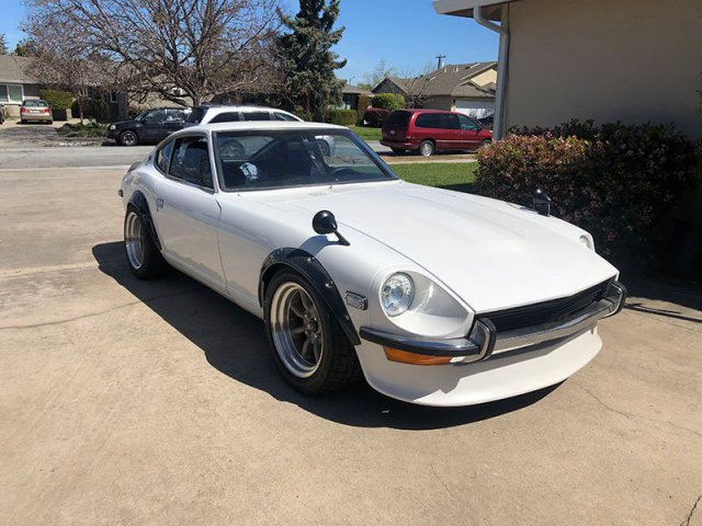

tamo3 2 Posted April 16, 2019 Author Share Posted April 16, 2019 (edited) After 6 years of working on rebuilding this car, finally, she went outside of the garage for test drive. Edited April 16, 2019 by tamo3 Quote Link to post Share on other sites
Leon 43 Posted April 16, 2019 Share Posted April 16, 2019 Congrats Takashi, a big step! Quote Link to post Share on other sites
tamo3 2 Posted April 16, 2019 Author Share Posted April 16, 2019 Thanks Leon! Look forward to driving Z cars together! Quote Link to post Share on other sites
