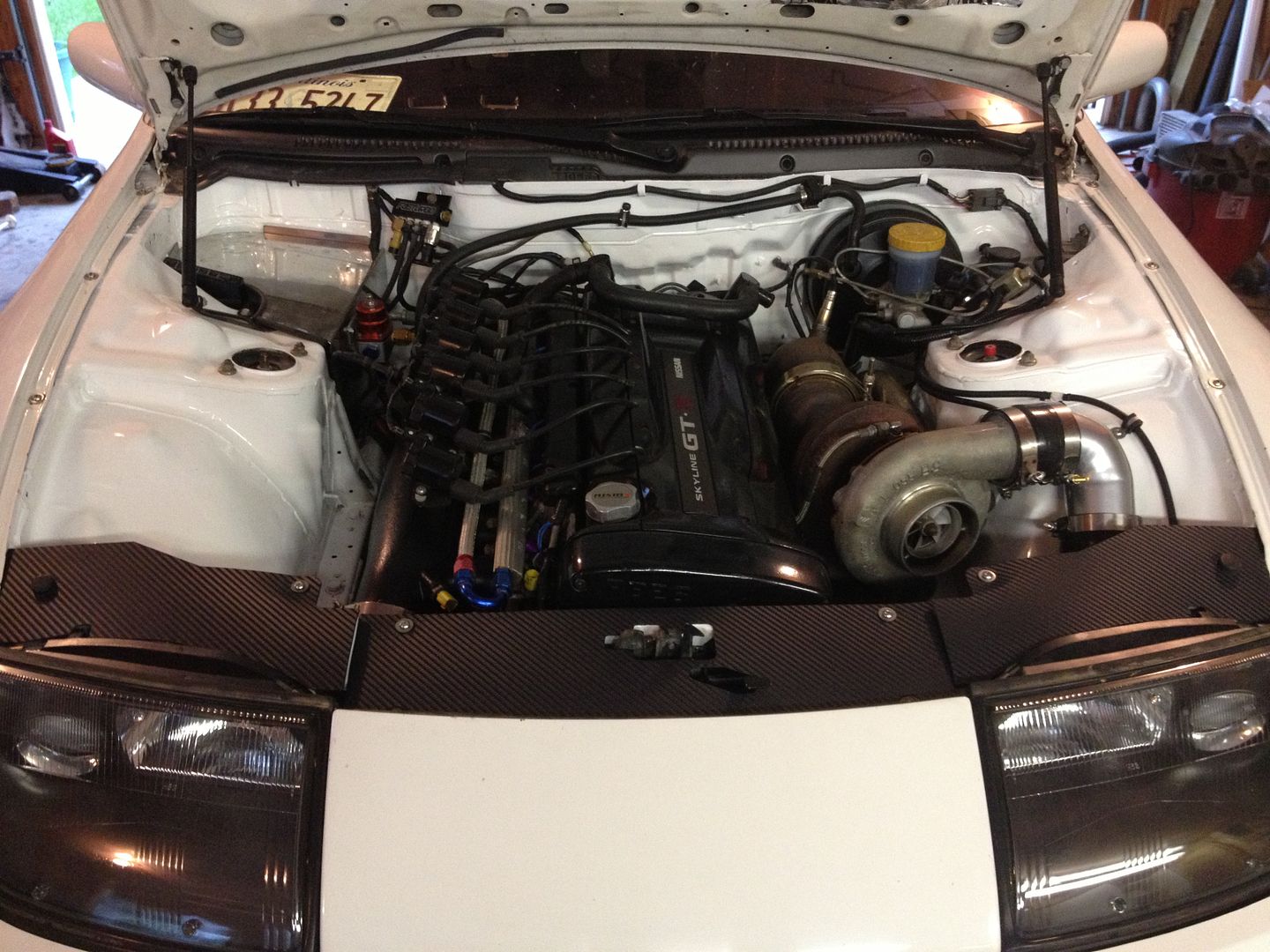

One of the biggest undertakings over the winter was I painted the engine bay. I pulled everything out and did it right - Used a single stage PPG in superwhite. I think it turned out great after doing a bit of house cleaning
