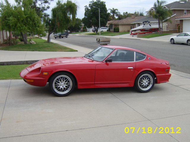

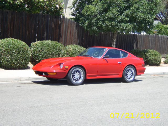

Anyway I finally went with the Eibach progressive springs from Motorsport. Shocks are from Sears (believe it or not). I've owned the car for 42 years and around 20 years ago Sears had these heavy duty shocks "guaranteed for as long as you own your car". Well they lost money on me as this is the 3rd set I've gotten free! The shocks are pretty go0od...made by Gabriel.
The result is very satisfactory to me. A little stiff but not excessive.
I'm using the 17" Konig wheel from motorsport with 225/45-17 tires. Looks great too.
Link to comment
Sorry I've been gone...some family problems. Lost my Mom.
Pictures?
