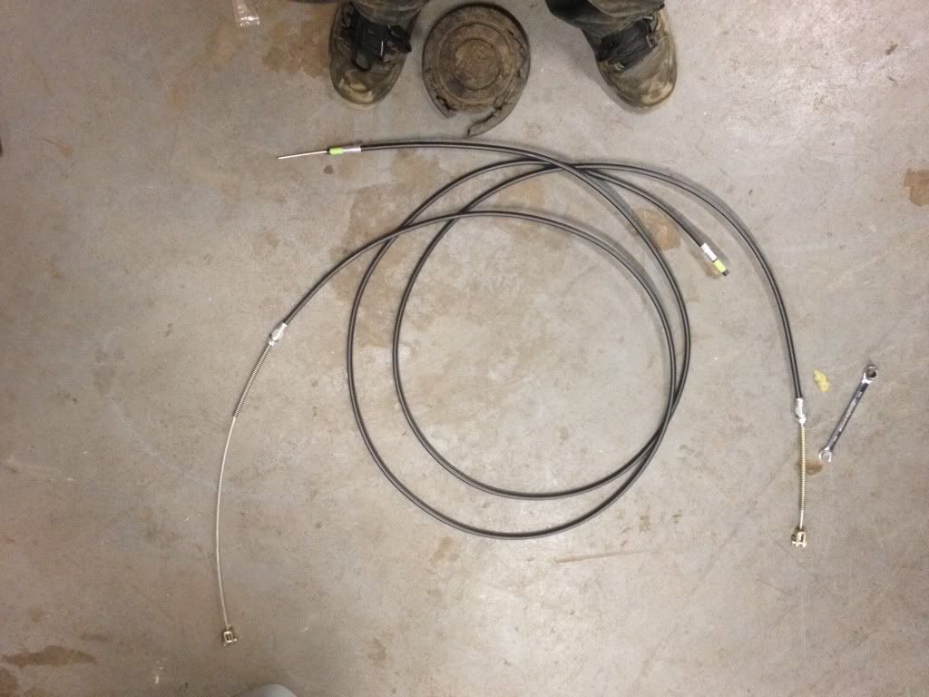

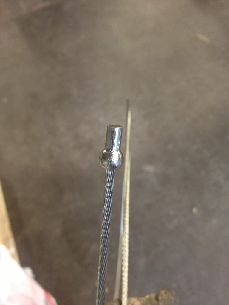

So these are the cables i got, Lokar 8ft u-cut cables
B6FFB0CD-1DC4-40F0-A984-A0796228964A-127

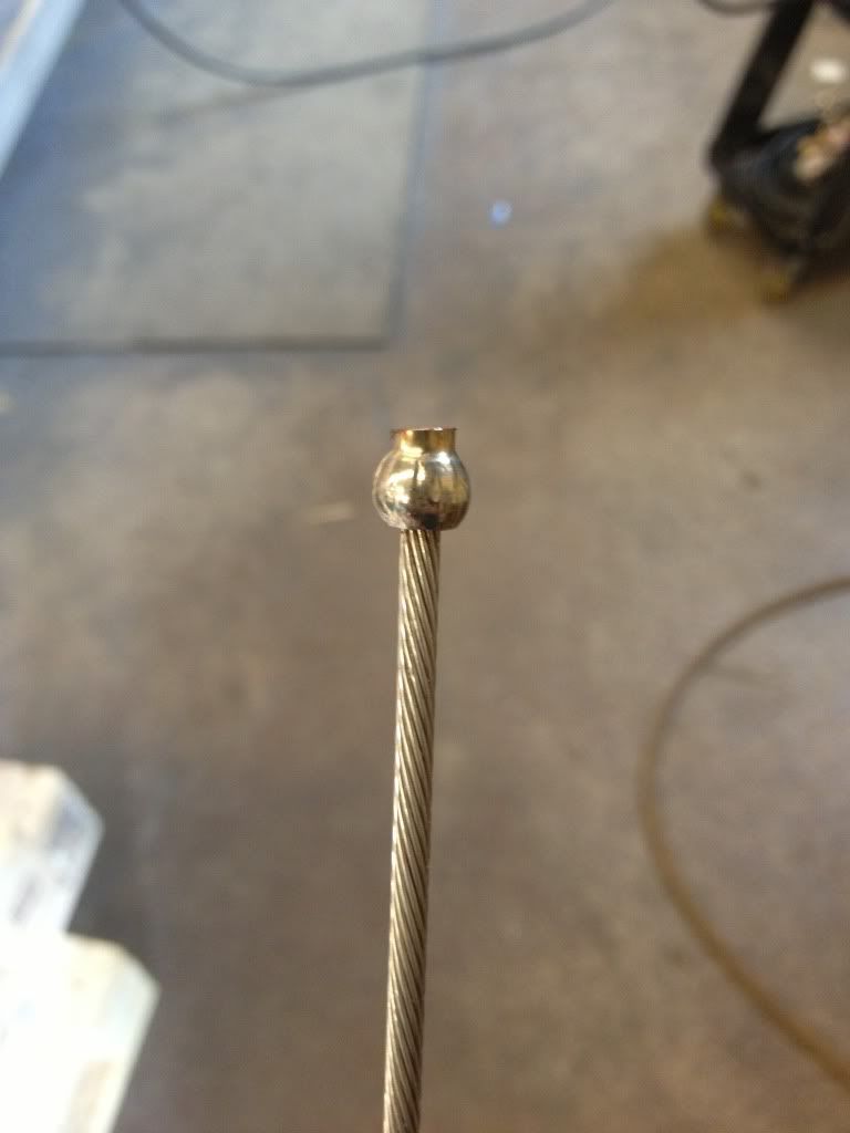

First issue i had involved the longer end on the cable. It would interfere with the black alum bracket that attached on the caliper
1650F2A8-03AE-4BA7-BEBE-337D8E065B5B-127

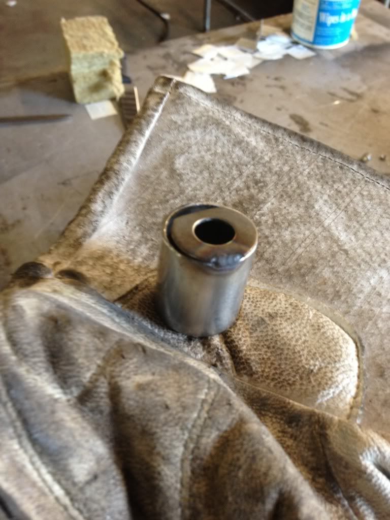

I took the end to the grinder then used my tig to fuse back the material so i still have a strong bond

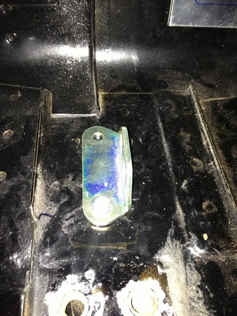

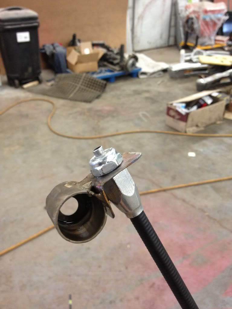

Afterward i when to figure out how to atched my cable. Keep in mind we built our z for show not race so i always have to make sure it eye pleasing. I tried first off to see if i could use a piece of angle and go off the caliper but i realized that there was no room in back of the 6 piston willwood we have. I found a piece of scrap stainless steel kicking around our shop.
C107F4A1-2516-49F7-B368-91D6CE6434BA-127
Once i found that it would work i then attached the angle so i could attached the cable side to this bracket. End result was this

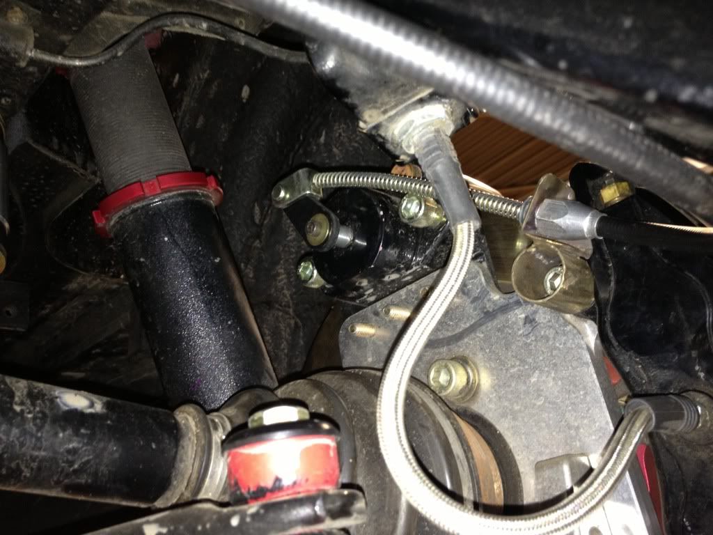

And here is it when it was attached to the caliper with the steel cable in it

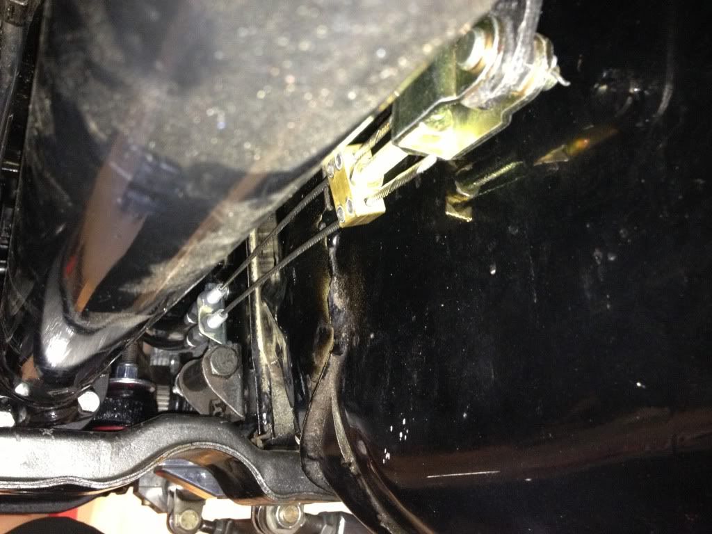

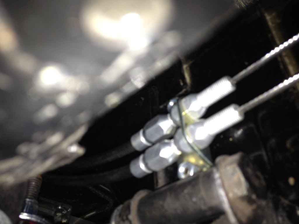

Once i had the caliper side done i when to figure out how to make the other end. Now from what i know i think we got one of the first set Dave had made. These required around 2 inches of travel. To compensate for this i removed the pivot located on the top of the drive shaft. I then secured the bracket were the 2 black casing cable went to the driver side near the drive shaft.
93DF4900-87C7-4718-9607-6F4E28E5A8F7-108
After i inserted the black casing for the cables
