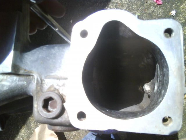

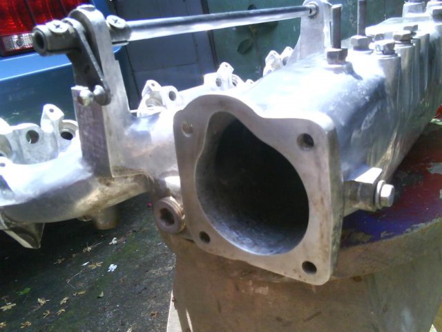

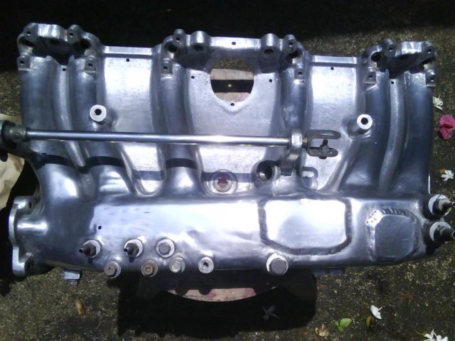

Sharing my intake shaving n polishing pics :)
  Hello there z people:
  I was replacing the manifold gasket,  and remembered some very nice pictures of shaved and polished intakes you have around here, pretty clean works, so i couldn't resist imagining it on my z he he!  :icon7:

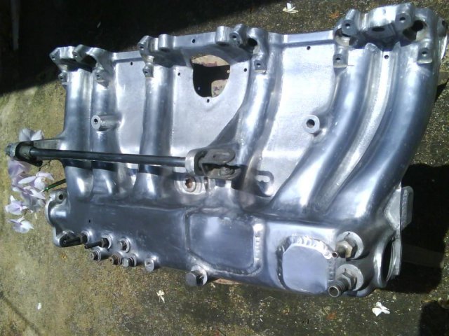

          So i went crazy with a hacksaw on it and cut the egr, pcv, cold start, etc...  then cut sheet aluminum pieces out of the blades of an old v8 fan i had lying around and welded them in place with a tic welder.
       the intake started to look nicer and so i followed with the next step,  ...polishing it..... THATS WHERE THE NIGHTMARE BEGINS!! LOL
      i been polishing the thing for almost 2 weeks and im nowhere close to the finishes i seen here!
      Hands down to all those z lads who did this themselves! they have my deepest respect   :hail:
       Well, here are a couple pictures of the intake so far:
    Every tip and advice is well recieved,   CHEERS!

That doesn't look bad. I would double check what vacuum sources you need. I only had 4: Brake booster, PVC (underside), fpr, and dizzy.
   Thanks, im using 4 vacuum sources too and left 2 more plugged in case for future stuff.

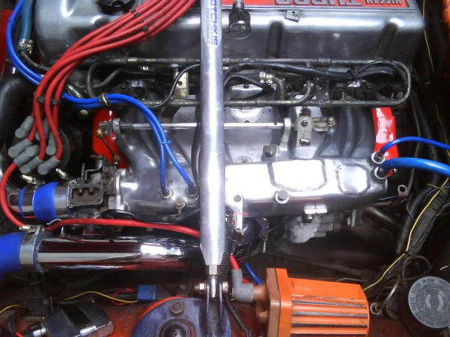

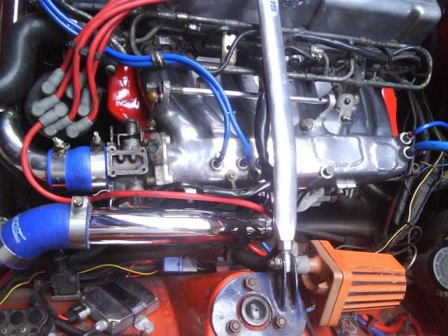

   intake installed   ( am i the only one who considers bolting the underside manifold screws a royal P.I.T.A. ?? )
   now the fuel rail stands his ugliness, lol
                that will be the next project i suppose

Thats exactly the neat finish i was talking about!, my respects to you man it looks very smooth, what do you use for final polish?

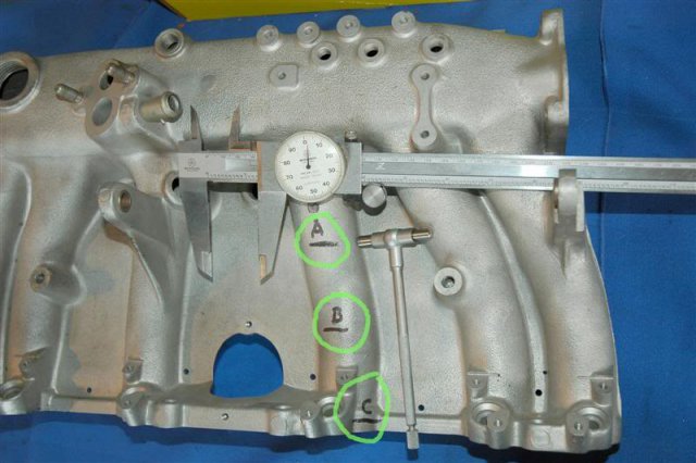

    So im with the intake out again and couldn't stop thinking about braap's intake runners restriction info, honestly feel pretty dumb now about installing the 240sx TB without doing anything to the real flow problem which braap clearly demonstrates about the runner inside diameter...

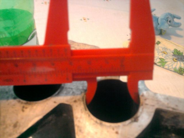

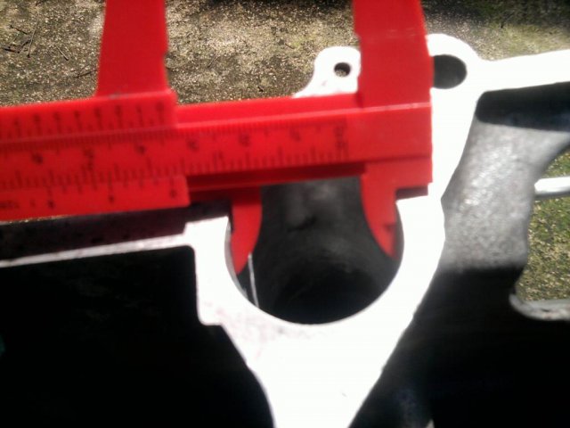

       took some I.D. measurments and here's what i got:
     -gasket intake I.D. = 35.5 mm
     -head intake I.D. = 34 mm (P90A)
     intake manifold runner I.D. = 31.5 mm (turbo)
      Braap says the runner has enough material to be opened .100'' safely but wouldn't be worth untill .200'' but thats too risky... so i was wondering about some middleground, .150'' maybe?   rather stay on some safe ground as possible,
  the goal is to extract some more drivable power from the engine by the combination of various parts upgraded as a whole (head, exhaust, intake piping, tb, etc..)   i don't expect to gain 20 hp instantly by just opening the runners, just want the intake to do its part when the rest of the engine flows a bit better,
    im not also after extreme horsepower numbers since this is my daily driver, of course more hp is always welcome but i dont wanna go too far (already did to my camaro and now i seldom use the poor car).
   Do i need to open all the way though A, B, C, ?
    custom intake is way out of my league..
                                                                               any advice is helpful  :twak:

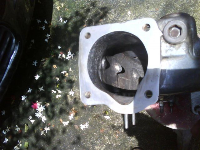

another update:
  i worked on the intake runner ports to open them from 31.5 mm to 34.5 mm from area C to almost half way to A, thats as far as the grinder reach. worked from there on to area A with a common long round grinding stick, not an exact science there i know but you can see the difference after a couple of hours and sweat.   Area A is squareish and after it began to look rounder.  taking in consideration Area A is a bit more open than B and C to begin with i believe this could help flow capacity improve.
   trying to make the real restriction less of the restriction here as braap says  :icon7:
    im probably just a dumb guy with a grinder.. lol
Before and after. (sorry for the crappy pics)
