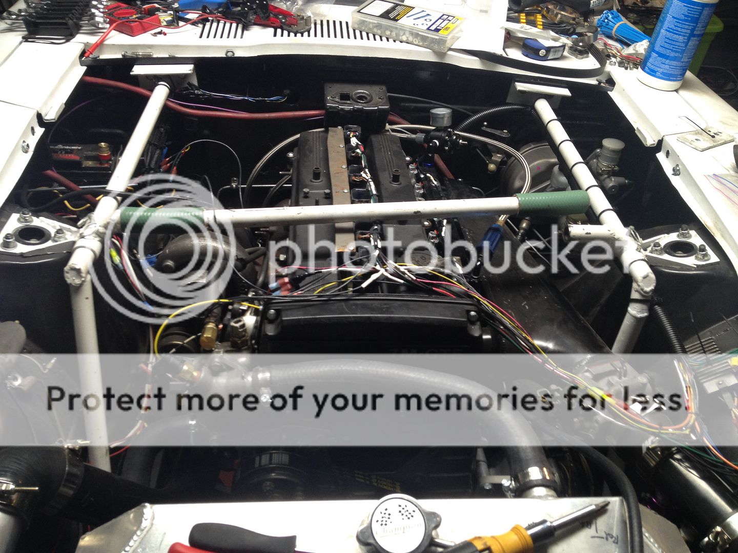

I actually didn't have a harness when I wired up my car. The PO never had one, and he wanted to keep his new one for later. I bought a used harness off of craigslist, but it wasn't as advertised, was in worse condition then I thought, (broken plugs, corroded wires) etc. The wires actually cracked when I bent them (and that is a 20 year newer harness), so I ended up making/buying new plugs/pigtails and rewiring the whole engine bay harness.
So my options revolve around how you will wire a new harness.
The options are either...
A: Use the long MS harness and wire it directly to all the sensors, replacing plugs and connections as necessary (as the guy mentions new plugs etc or soldering to really short pigtails, most new plugs will come with short pigtails or crimps and a plug). Essentially your connections will be only at the accessory, i.e. to take off injectors you will have to physically remove the injector plug.
B: Buy the short MS harness, make really long pig tails from the sensors and run all that wiring into the cabin and make the connections there. More along the lines of what your mechanic may be suggesting, the old wiring harness is old, that and you won't be using quite a bit of it, won't have to figure out each wire, etc. All the connections will be in the cabin so weather proof in that regard.
Both methods require new wiring, it is just a matter of where the connections will end up being. I actually combined both methods. I made some pretty long pig tails and had them meet near my throttle body. That lets you unplug the harness and remove the engine without having to pull everything from inside the cabin. Or pull of plugs from different locations on the engine.
E4598CD8-22BE-4246-84F3-6A75A8DAF5E4-330
You can see some connectors right above the throttle body, all the connectors are within a few inches of that area.
The way I thought about it was like exhaust. It was cheaper and easier to have the exhaust shop do a full front to back in one piece. I had them make it into a 3 piece system. Came in real handy when I had to add my o2 sensor and I didn't have to drop the whole exhaust.
Oh, and please tell your mechanic I meant no disrespect, definitely do what your mechanic is willing to do/familiar with as previously suggested in my post above. He is physically there and will be doing the work, most forum members are not. If he is familiar with reading pinouts and is more comfortable with working with the stock wiring diagram, more power to him. The work is all done (assuming the wiring harness is good), it will just take a bit of time to figure out exactly what wire does what.
I think in the end I had to make 12 connections or something if I had to condense it down, maybe 3 hours for mockup and pretesting (soldering longer pigtails to plugs etc), and maybe 3 hours for final assembly. And that is my first time making an engine wiring harness.
