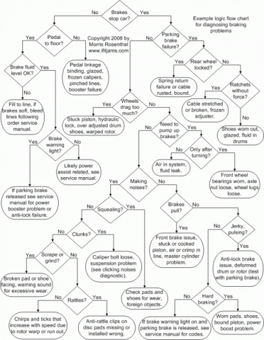

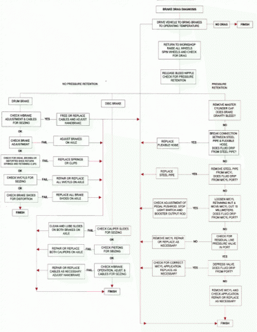

Here are a couple of brake diagnosis flow charts that may help isolate the problems you are having. Make a check list and go back through your brake system part by part and take notes.  Be methodical.  Check off each item as you complete them.
