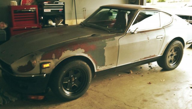

Here is the XXR 532s 16x8 with 0 offset with 225/50 tires on it on stock suspension. At full turn the tire just barely touches the inner body. Outside that, They fit pretty well. Its winter here in Ohio so I have yet to drive on them.
