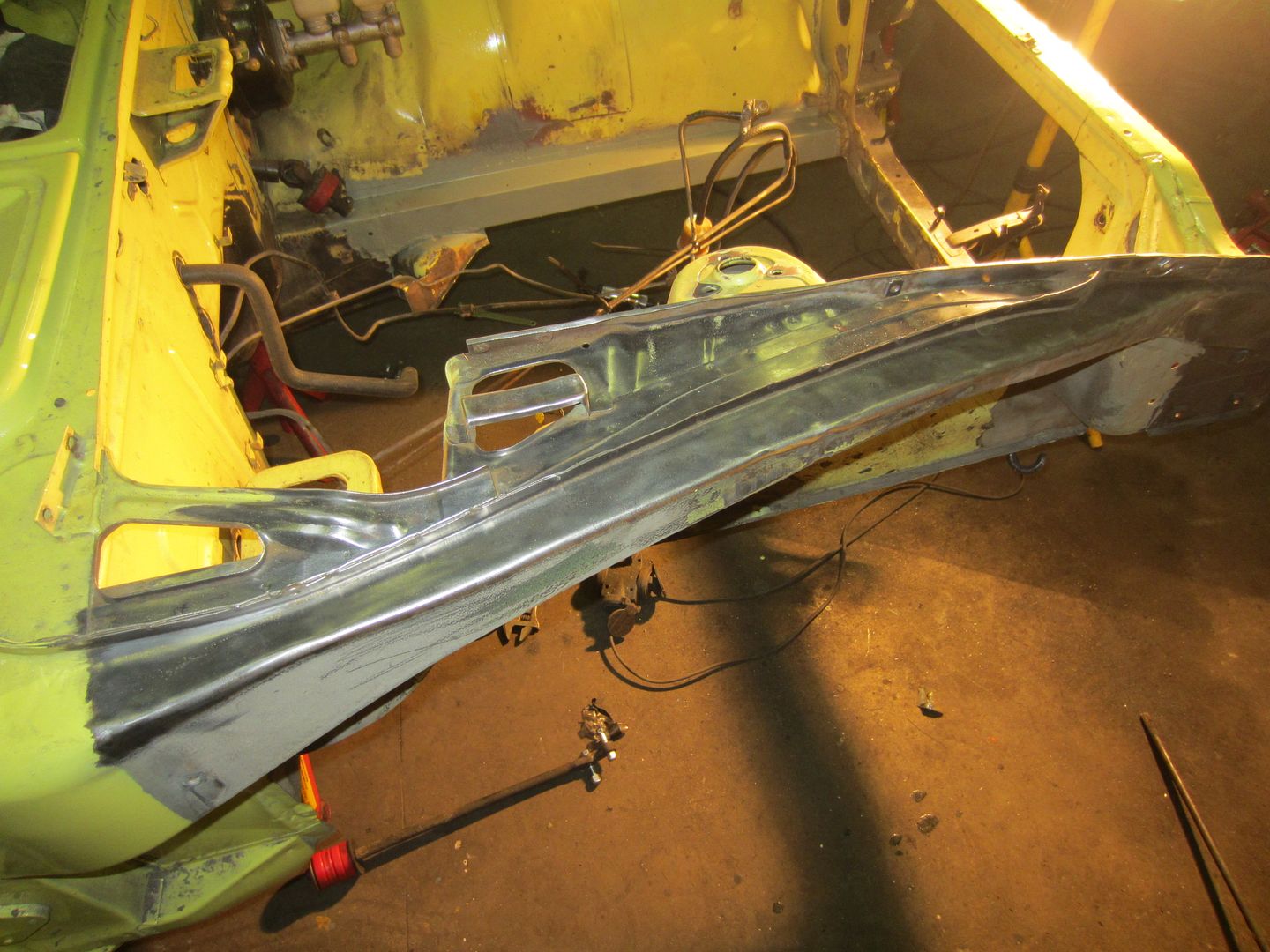

As I Was mounting the front suspension back together with new bushings I noticed everything was a lot harder to mount on the left side than on the right side. Clearly something was wrong, and I was very dissapointed when I found out that the front left framerail looked like a banana seen from above =( It was obvious that the car needed straightening and the left framerail needed to be replaced, so I ordered a new one from zedd findings and stripped the front end completely.

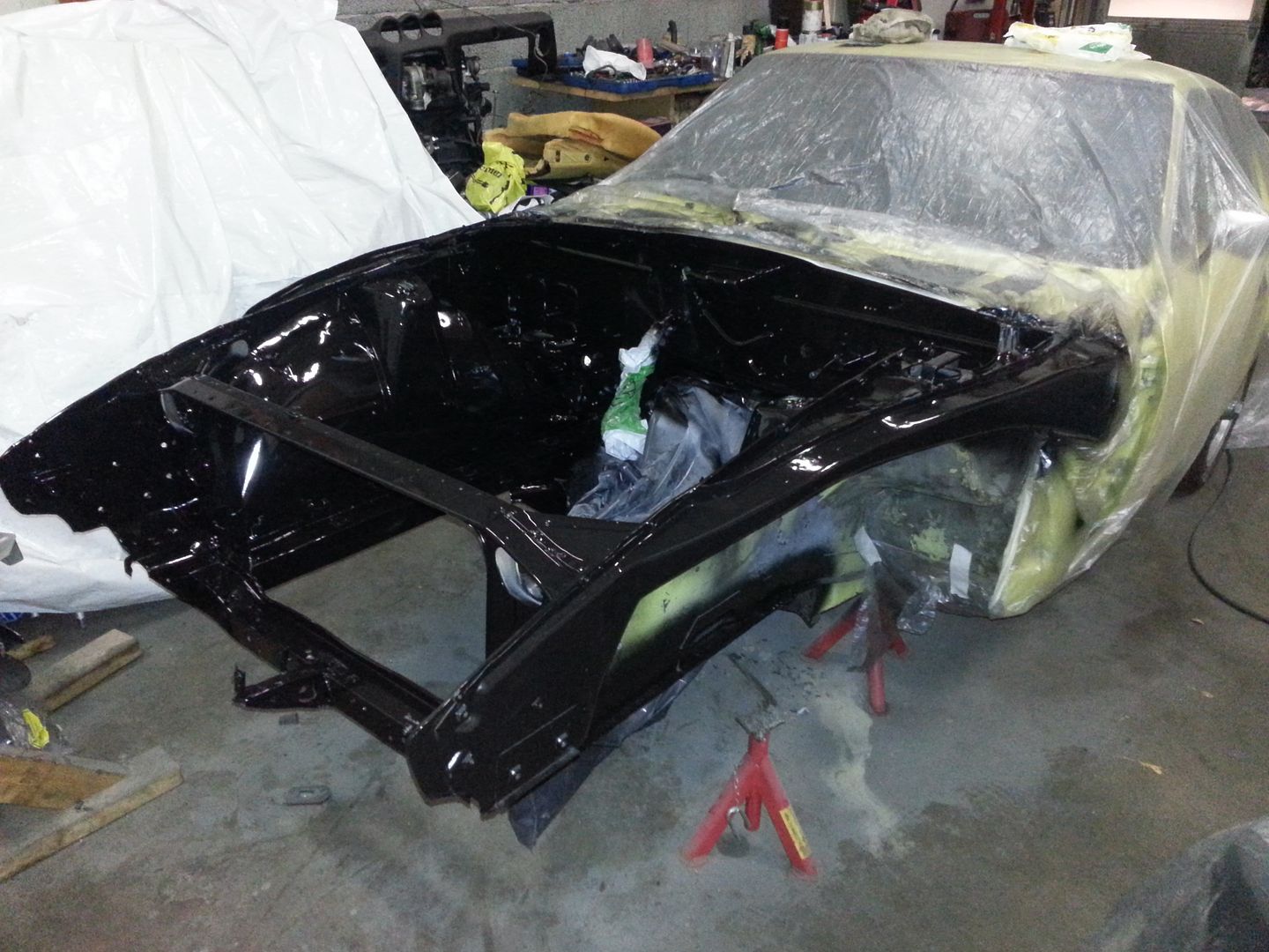

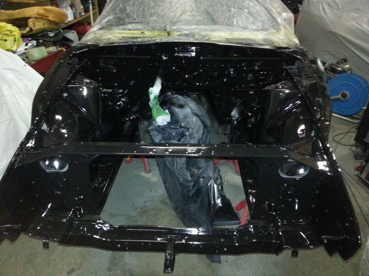

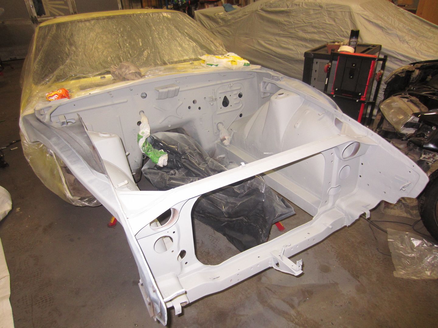

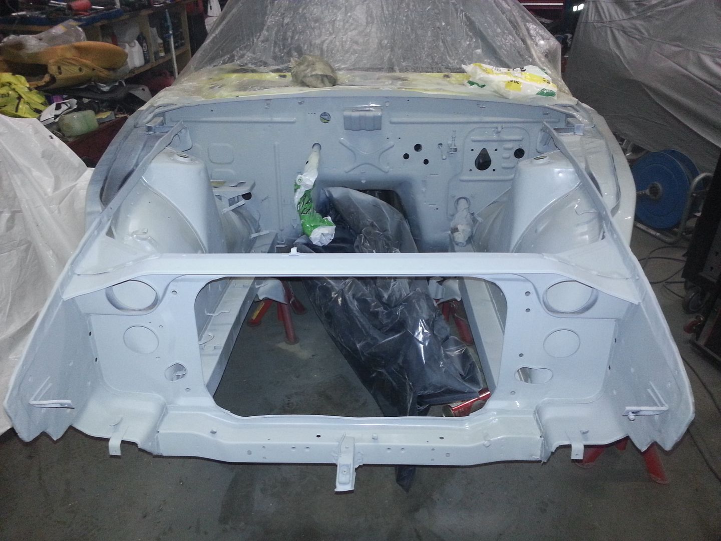

Since the front end was almost completely stripped anyway, I decided to paint the engine bay before mounting it all back together, so I started preparing it for primer and paint
I had to remove all the black 1k shitty spraypaint in the front of the car. That was a painful timeconsuming job, but it turned out very good. 2K primer went on after a long preparing process:

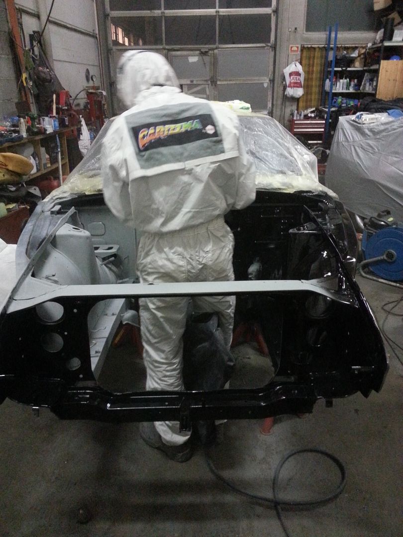

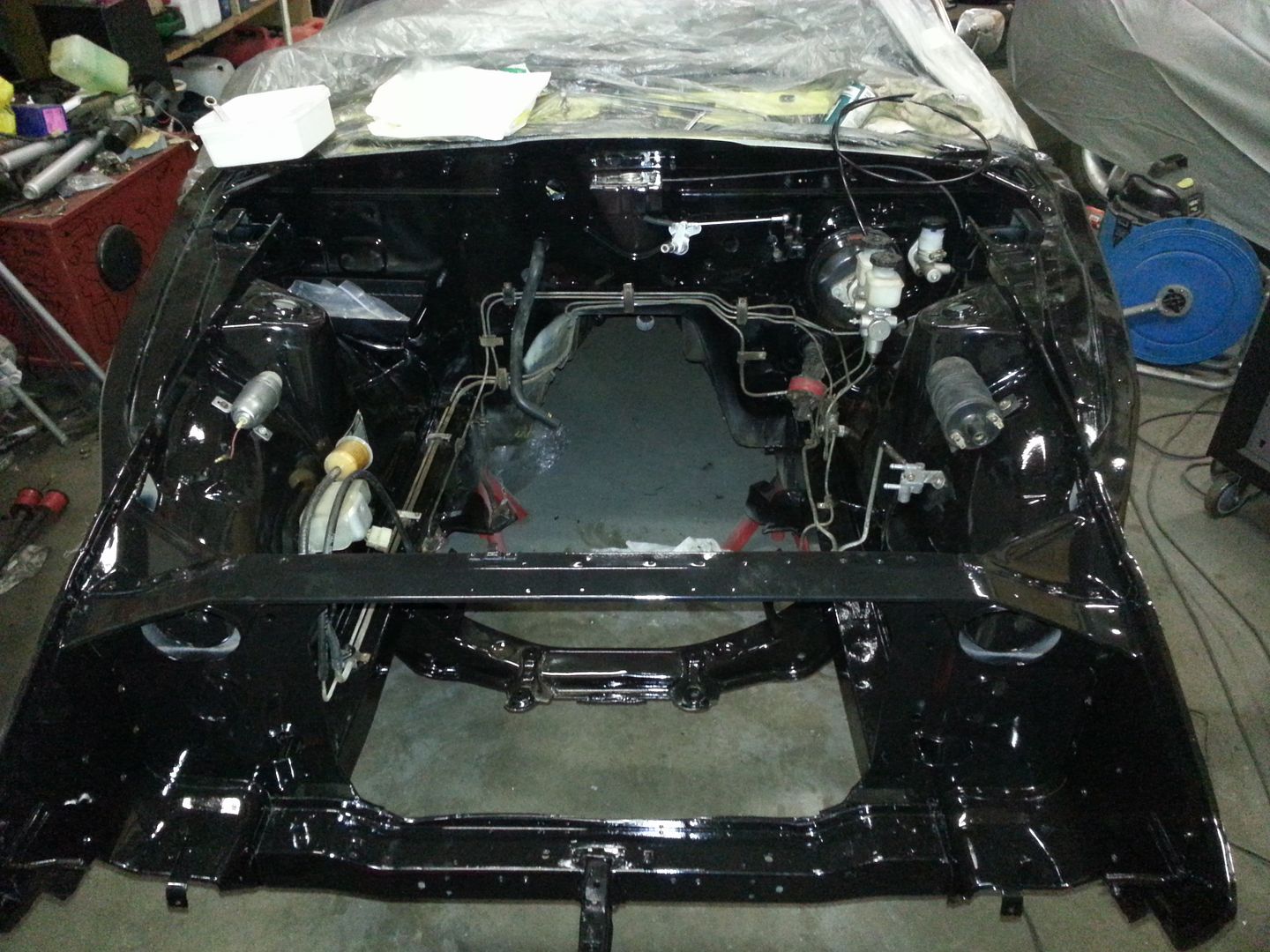

When it was time for some color I went with black 2K polyurethane paint, and got a professional car painter to spray the engine bay for me. I am very happy with the result! :)

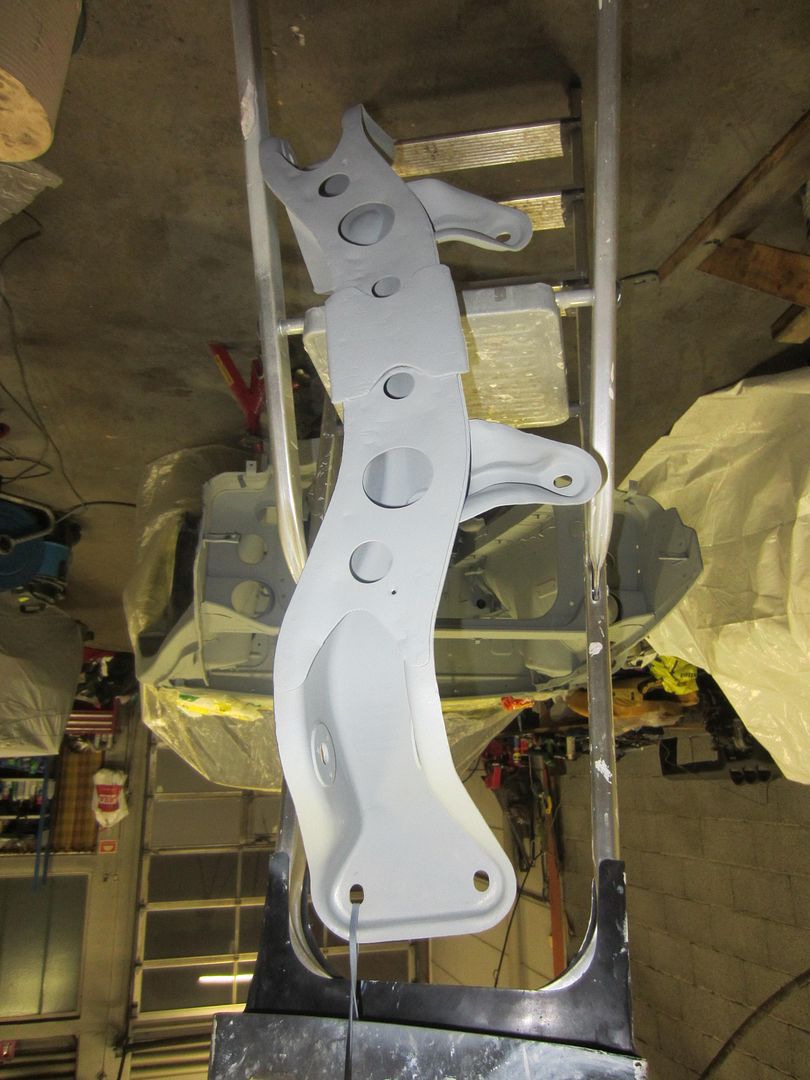

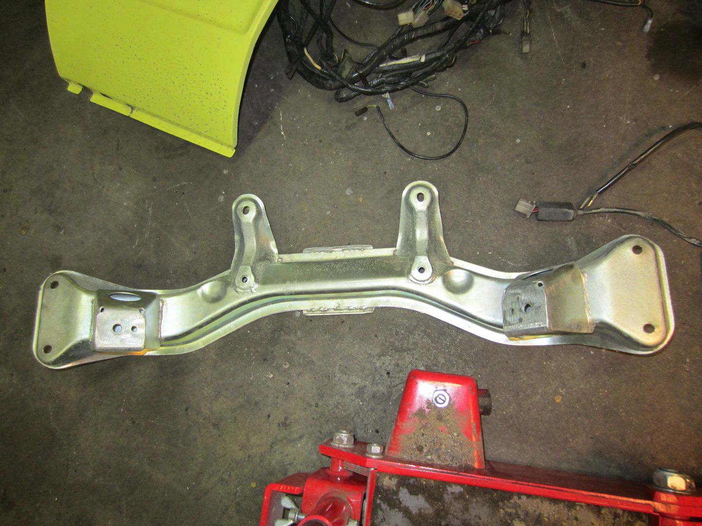

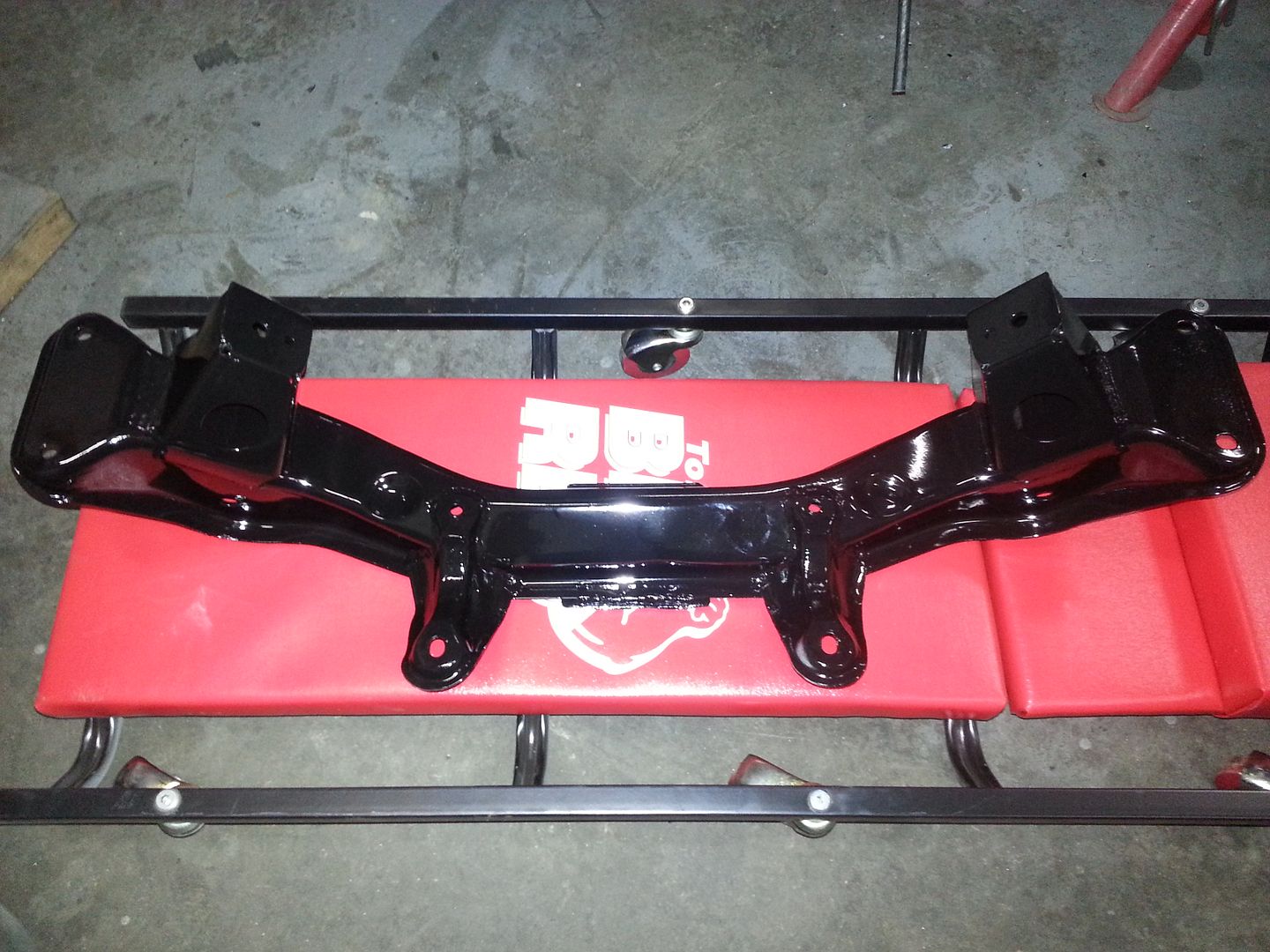

Because the car had been crashed, I could not reuse the old crossmember, so I bought a refurbished one from a guy here in norway and painted it at the same time:
So now I have come to the point where I have started to mount it all back together.

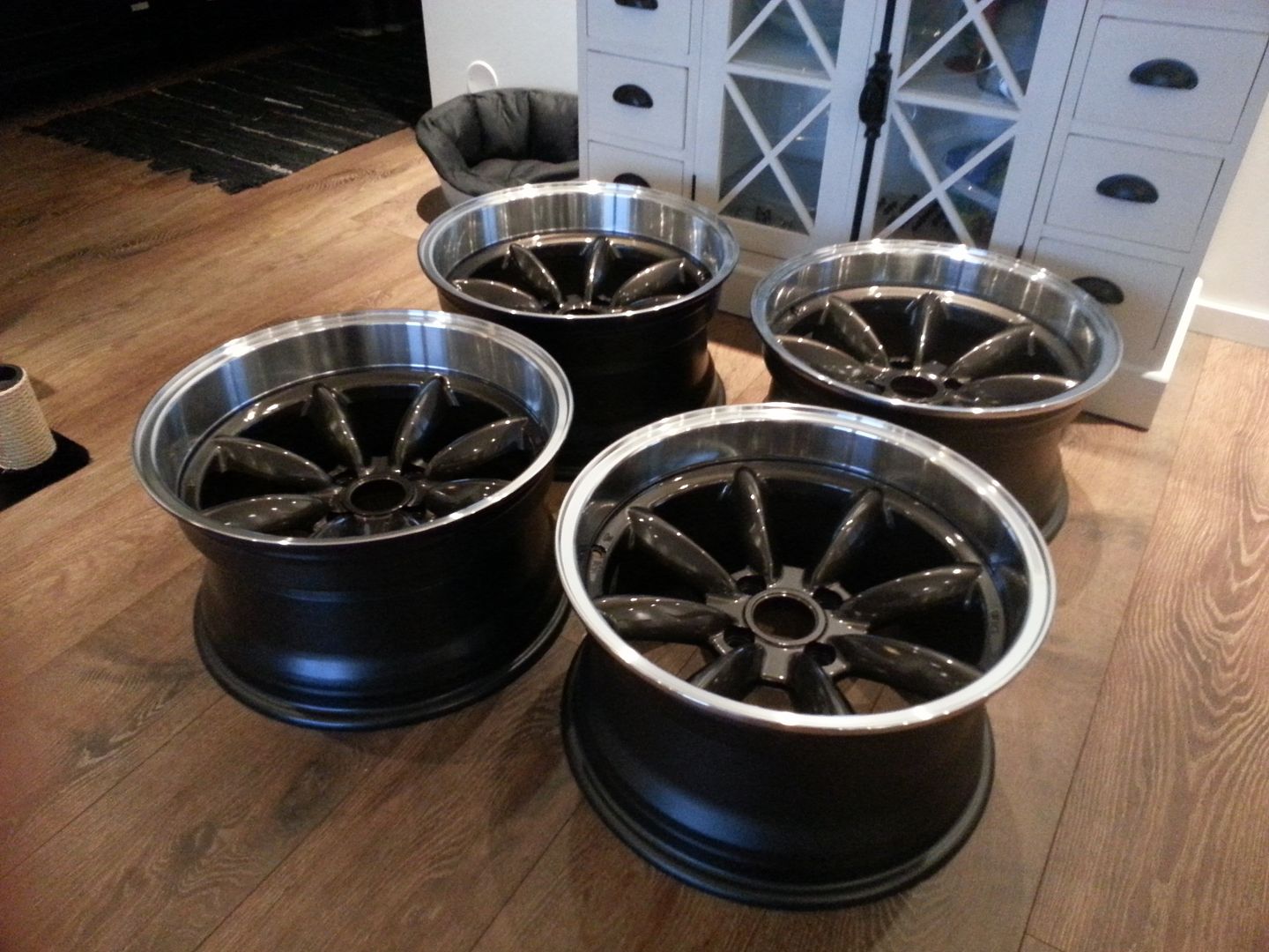

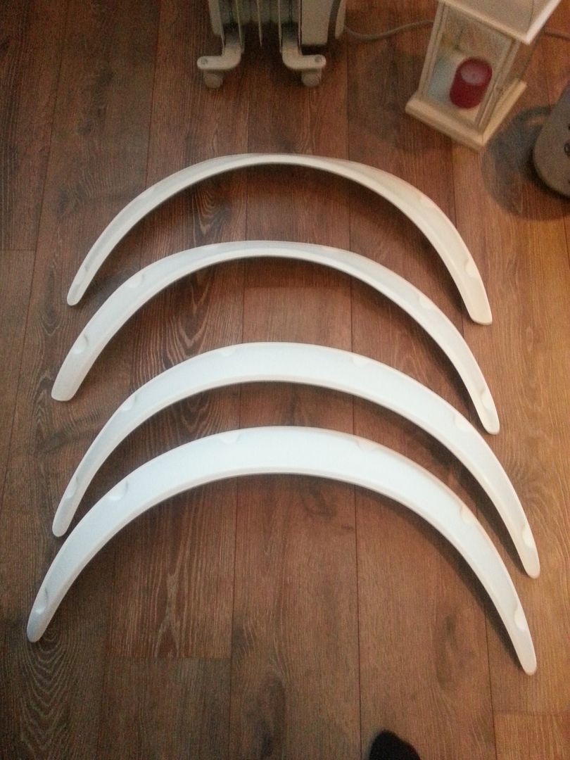

I have also bought Rota RBX wheels and ZG flares. The plan is to have the car yellow with black flares and bumpers. Ground control coilover kit will also be ordered.

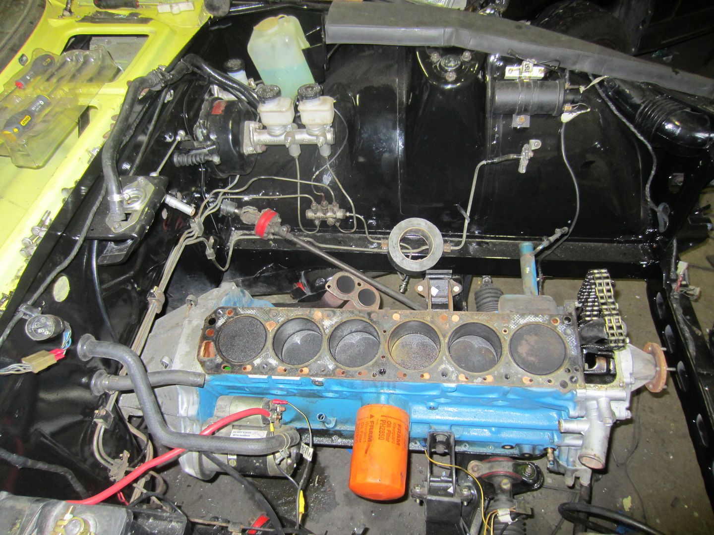

Quite alot has happened since last update. I mounted the engine that came with the car, hoping to get it to run good enough to use it this season, but I could not get it to run on all 6 cylinders even with good spark on every plug.
A compression test revealed ZERO compression on cylinder number 4, so I lifted the head off and both the head, and cylinder no. 4 did not look good. It looked like there had been water in the cylinder for a long time because there were small pores and marks on the wall.
Some pics:
Head came off:
Bottom end went out:

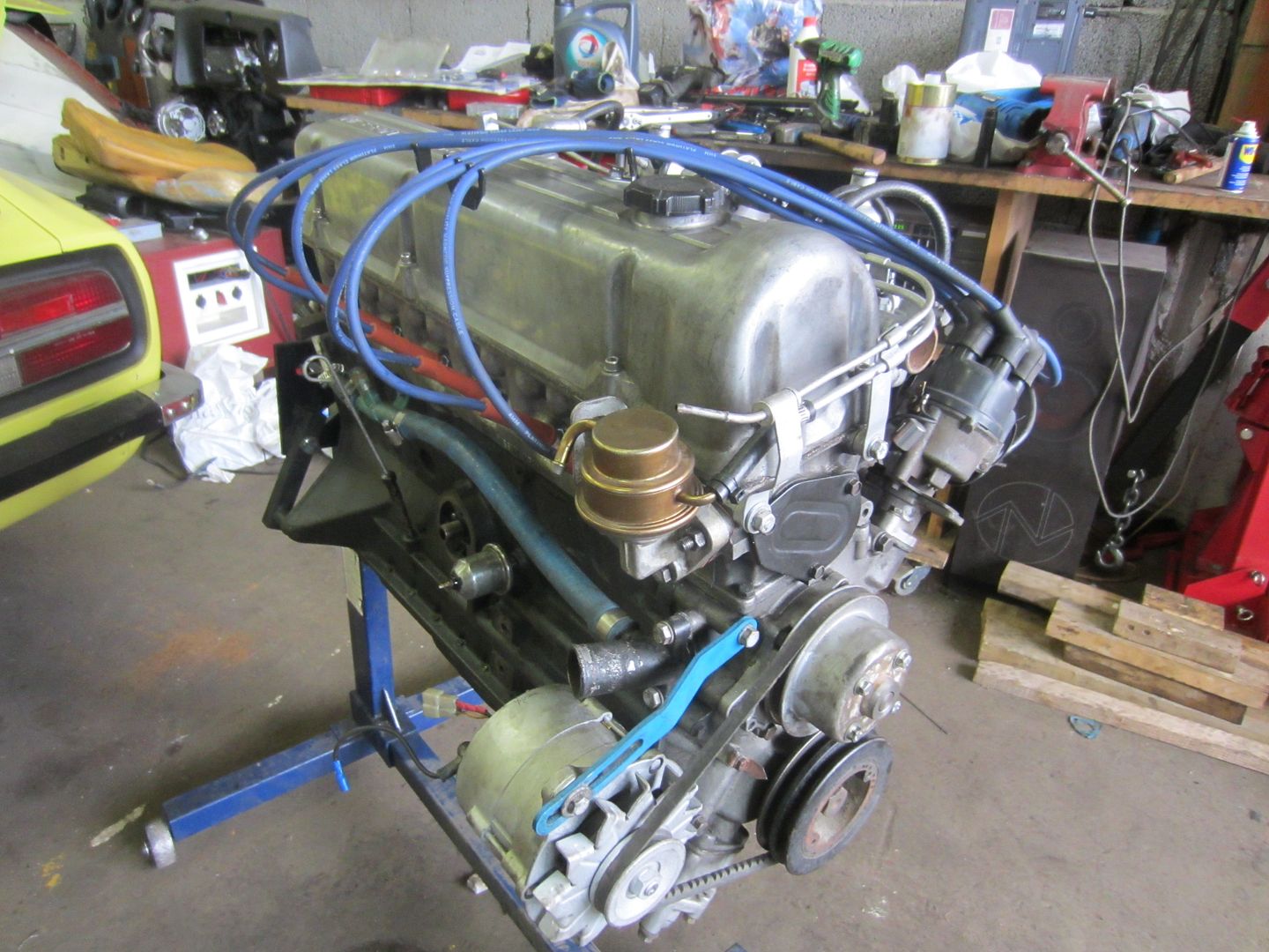

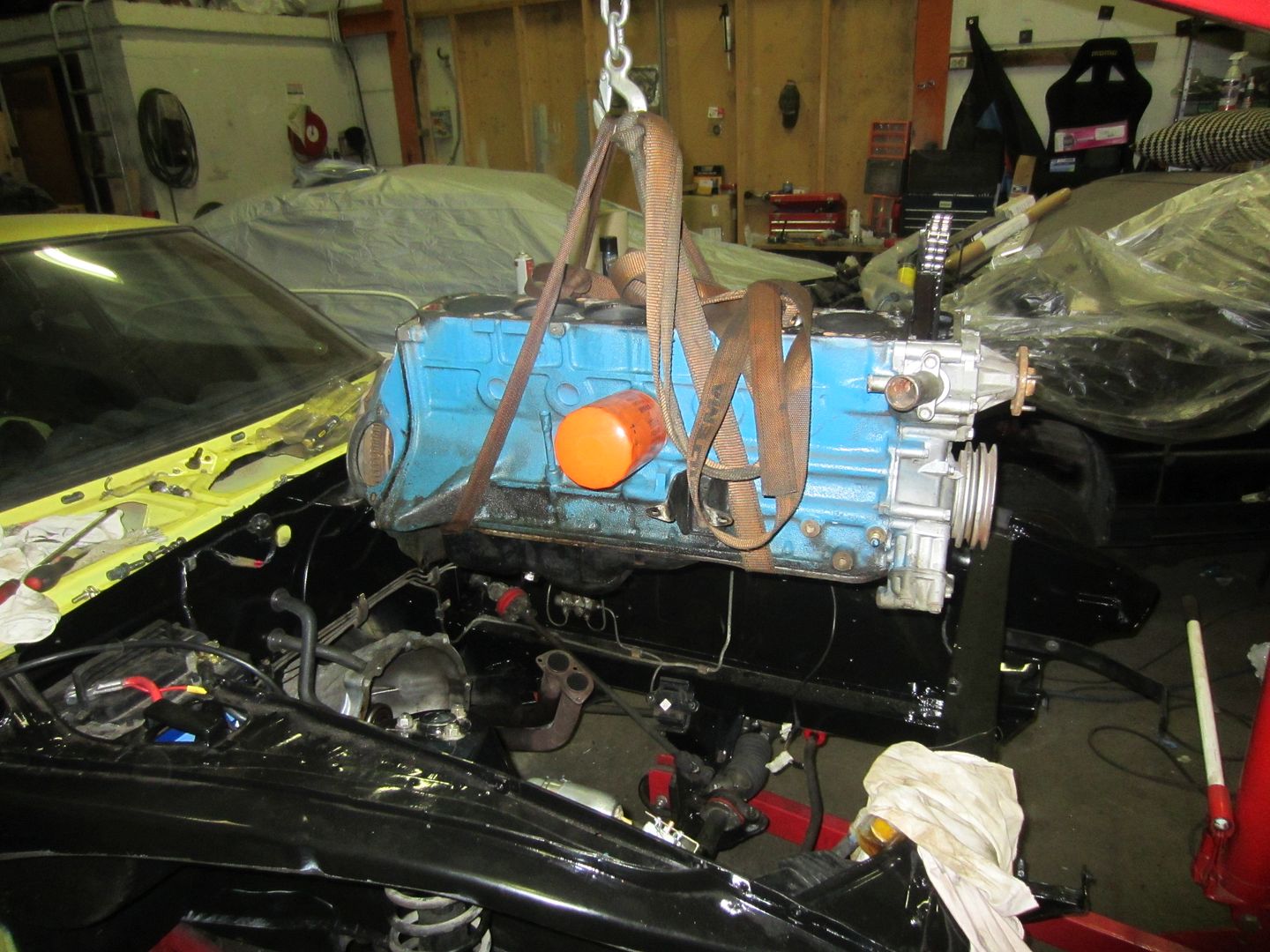

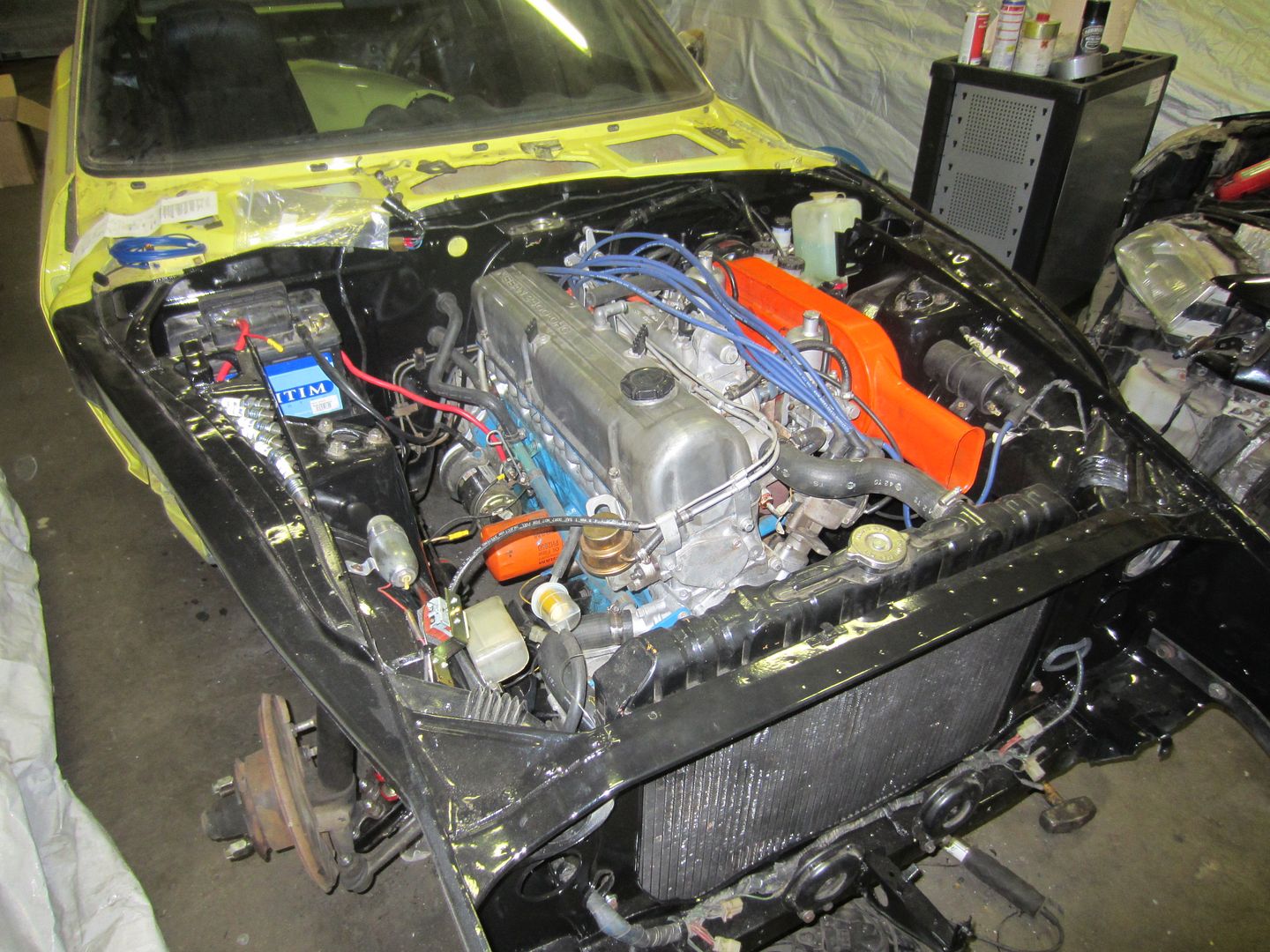

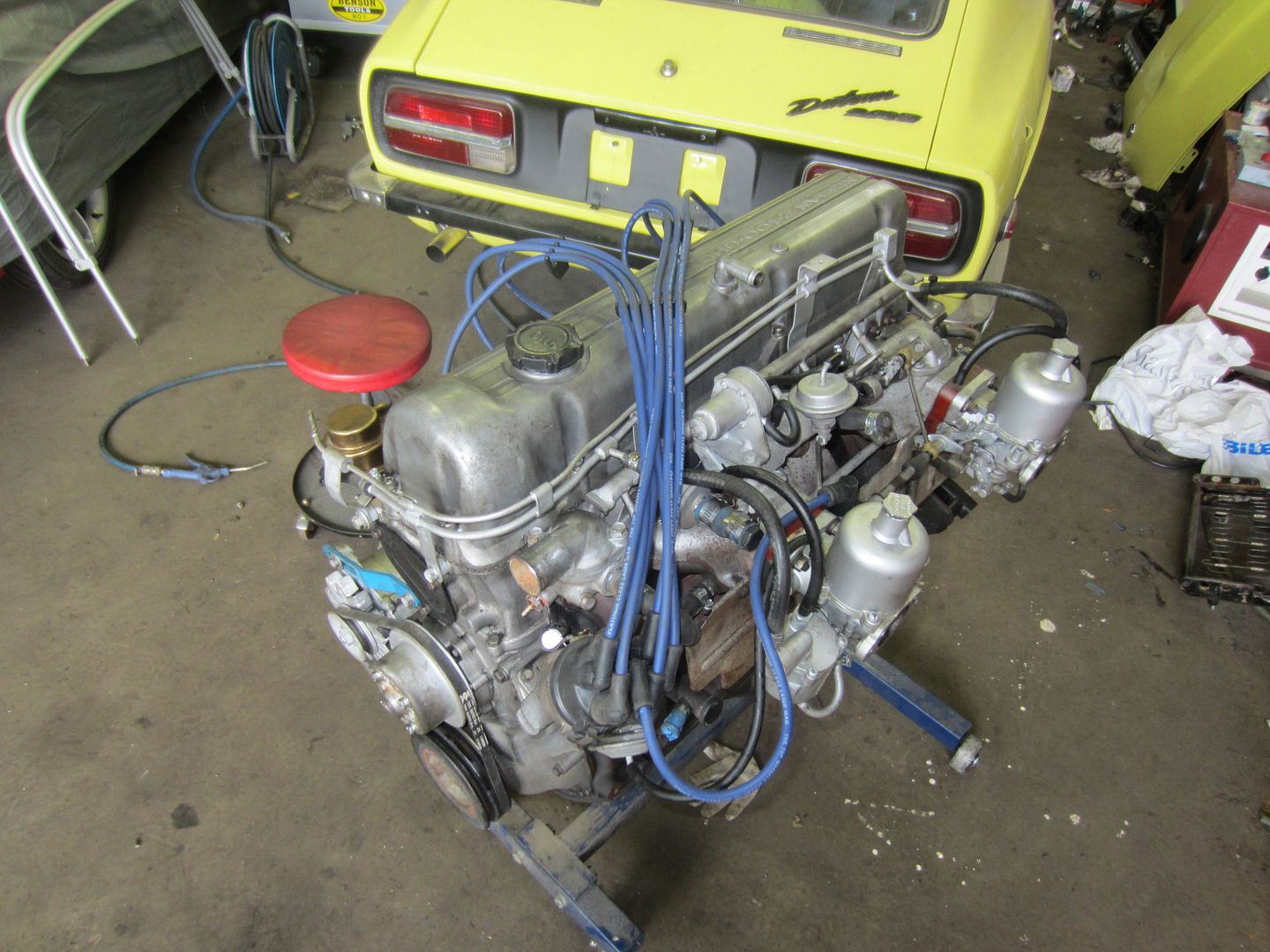

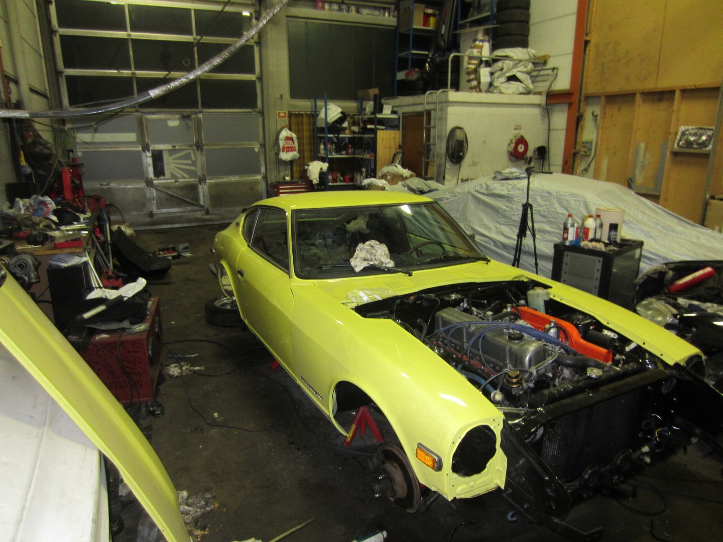

Since I have an early-vin car and the engine number matches the VIN, I will keep this engine as a backup and rebuild it to perfect condition over some time, but I was in need of a quick solution to this, so I went and bought an L24 longblock for a hundred bucks from a local Z-guy who had sold his Z and needed to get rid of his "spare engine". He told me the engine had not been used for several years, but it ran good the last time it was in use.
The "new" engine in my workshop as it was when I got it:

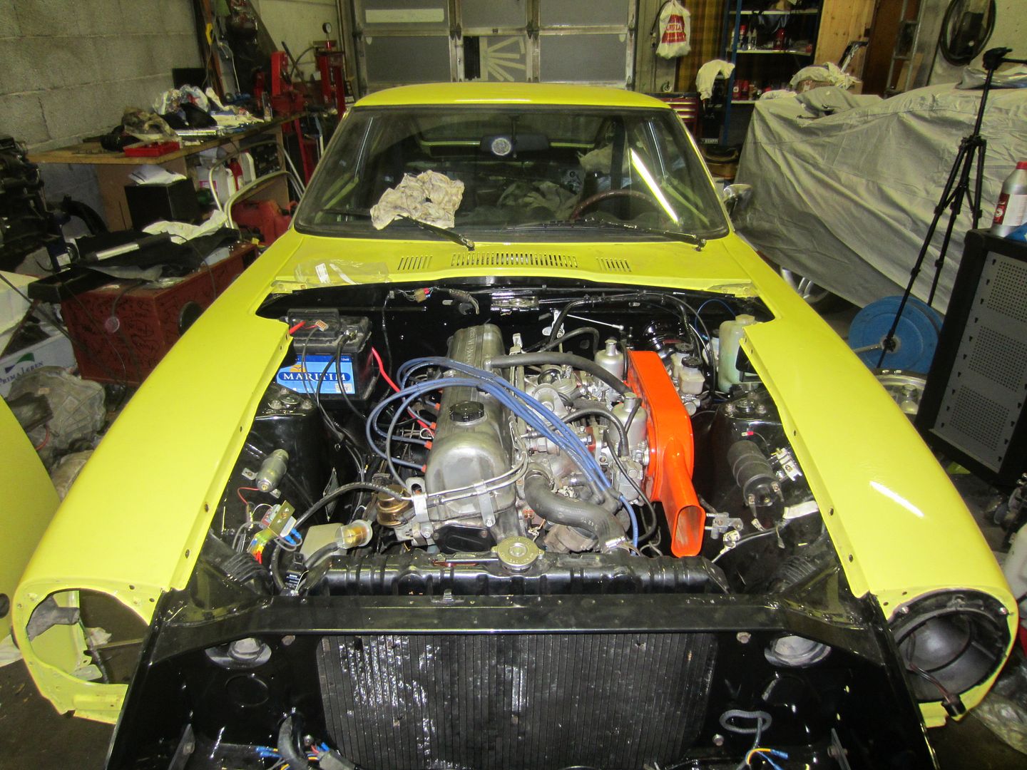

For that price I just took the chance, moved all of my outer components over to this engine and mounted it back in the car.
Ready to go into the car again:
Voilà=D
It runs good, but I have a bad ticking noise that I believe is coming from either intake valve no. 5 or 6. I searched with a stethoscope and that is where the sound is strongest. I have adjusted the valves cold, but not hot. Judging by the frequency of the sound I think it's just one valve. What do you think?
The sound is almost non existent when the engine is cold, but as it heats up it becomes stronger and stronger....

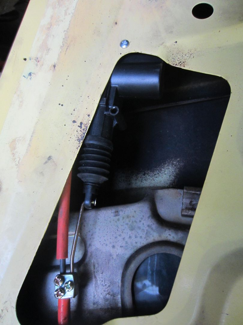

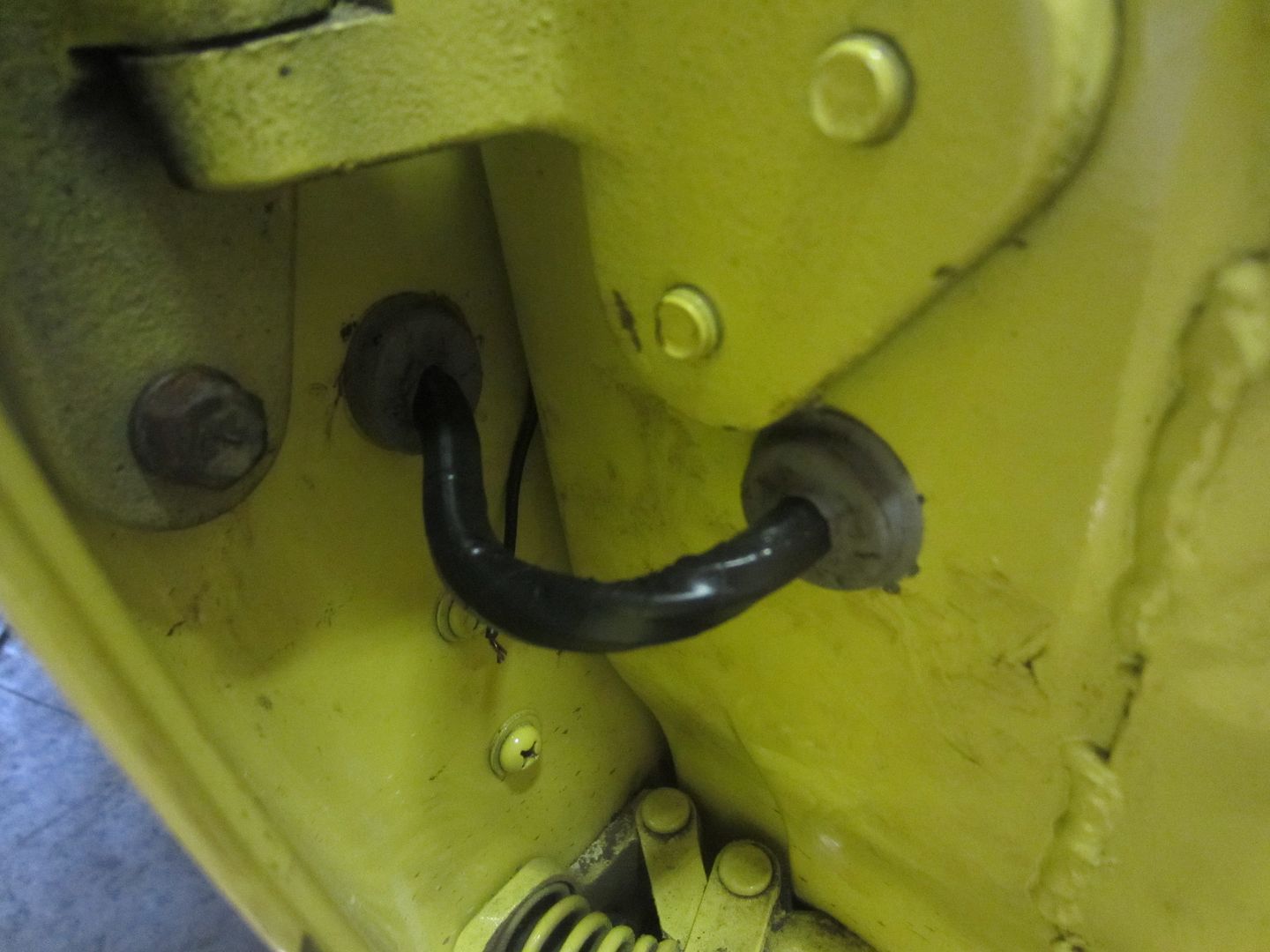

I have also mounted a central locking system with alarm in the car. It works very good :)
Actuator placement:
How I solved the wiring to doors:

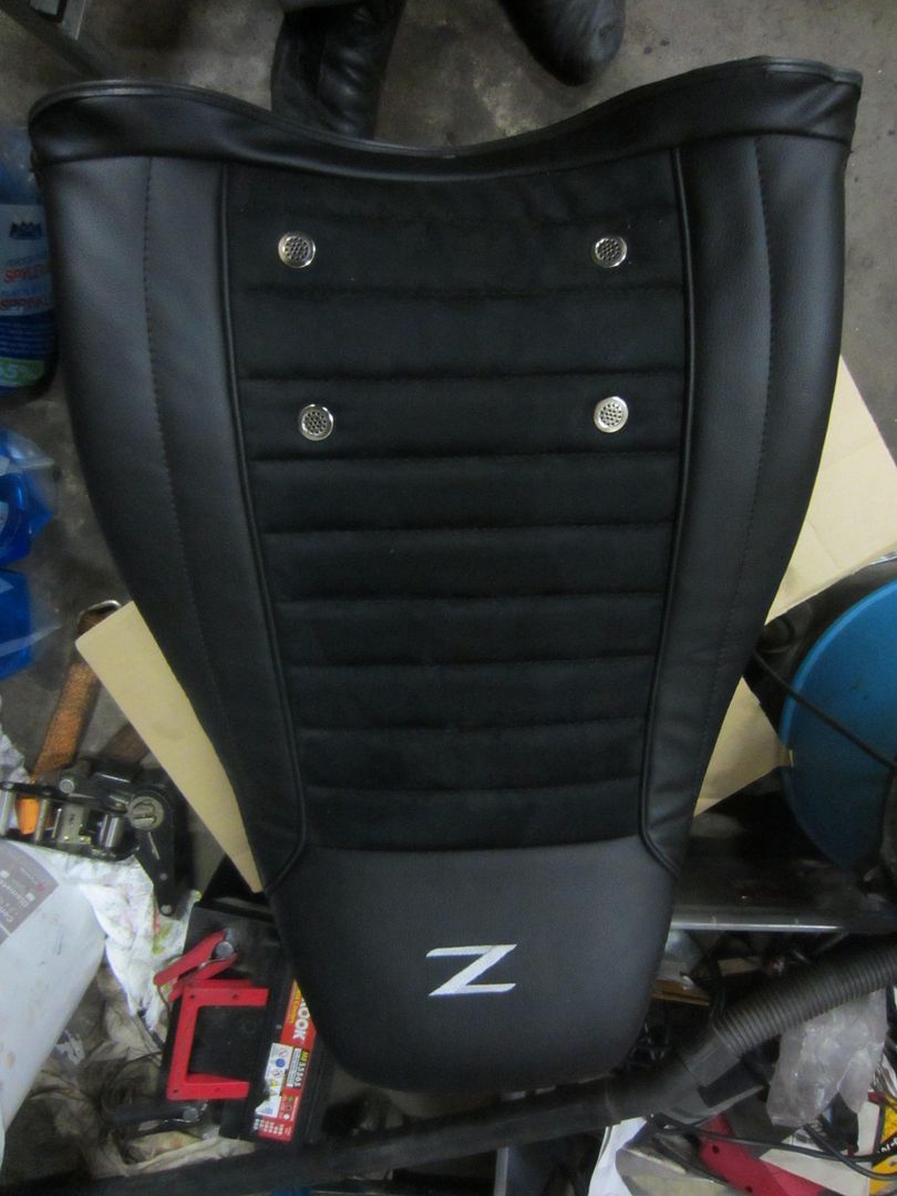

I also got my custom seat covers which I ordered from exotikleather on eBay. I have not mounted them completely yet, but I had to try one backrest to see how it looked, and I am very satisfied with both the look and the fitment :) What do you think?
